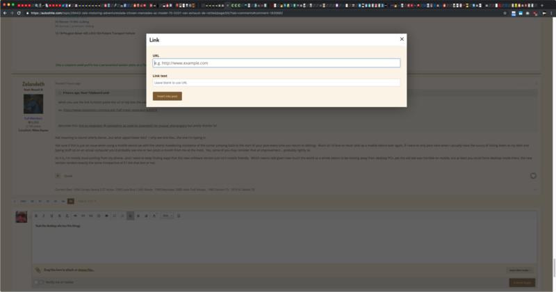

Not meaning to sound utterly dense...but what upper/lower box?  I only see one box...the one I'm typing in.
Not sure if this is just an issue when using a mobile device (as with the utterly maddening insistence of the cursor jumping back to the start of your post every time you return to editing).  Much as I'd love to never pick up a mobile device ever again, if I were to only post here when I actually have the luxury of sitting down at my desk and typing stuff up on an actual computer you'd probably see one or two posts a month from me at the most.  Yes, some of you may consider that an improvement... probably rightly so.
As it is, I'm mostly stuck posting from my phone...and I seem to keep finding ways that this new software version just isn't mobile friendly.  Which seems odd given how much the world as a whole seems to be moving away from desktop PCs..yes the old site was horrible on mobile, but at least you could force desktop mode there, the new version renders exactly the same irrespective of if I tick that box or not.
Yeah the desktop site has this thingy
perhaps on your Phone you could try force a different user agent to try trick the site into giving you the desktop version?
(honestly sounds like a website bug if it wont give you the desktop site when you request it, cc @Slartibartfast )
I think it's the website software being "too clever" to be honest.  I've been finding more sites lately which irrespective of whether you request the desktop site, if the site detects that the recipient is a mobile device it will force the mobile version... irrespective of if you've told your browser to load the desktop version.

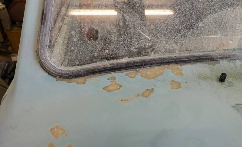

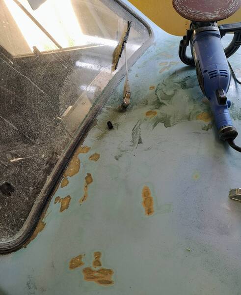

This paint removal process I think is just going to be a long slog.
Got a few better scrapers today and they're precisely zero help.  With the sharper blades they're just going straight through the paint and the gel coat, it's just too soft.  On a few of the larger flatter panels where there's a nice clean edge to the paint as it's been removed, using the blunt edge it's possible to work away at it...but I was successfully doing that with my old blunt scraper already.
Heat lifts the gel coat before the paint too, as I did poke it with the heat gun just to eliminate it as a potentially helpful tool.
I did bust the sander out again today just to see if I could flat back the area below the rear window where the surface was damaged by the paint stripper.  Looks like there's plenty of thickness to the gel coat to sort that out at least.
There's quite a bit of pitting on the one panel...you can clearly see where the paint stripper was sitting the longest...
No huge issue, it's nothing a really tiny amount of filler can't hide...just annoying to have made more work.
Next stop will be investigating soda blasting.  Either getting the kit to do it myself or getting someone in to do it.

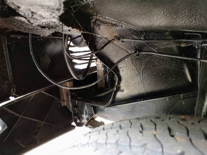

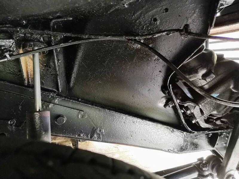

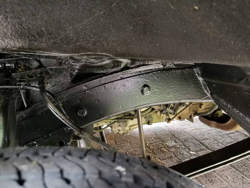

Had a bit of an experiment with the paraffin gun this afternoon.  I still had some old underbody wax floating around, so I let it down a bit to a more spray friendly consistency then had a mess around with it.
Can't see me ever messing around with aerosol cans for this sort of job again.  The spray is far finer and just generally well behaved.
Didn't do a huge amount, just gave the front wheel arches and engine bay a blow over.  It's a bit hard to see as it's clear wax that's gone on over the black stuff already there.

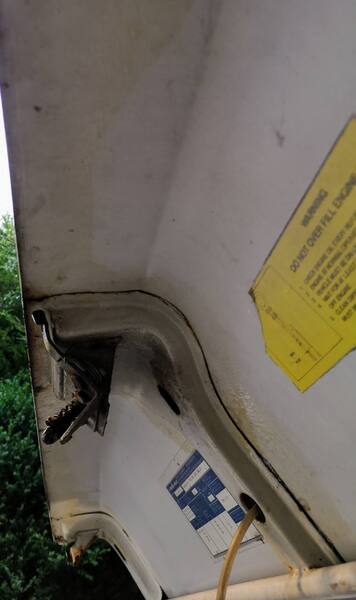

The top dust cover on the shock absorber has fallen off again.  I'll need to get inventive with a cable tie to make it stay in place I think as it's obviously not going to behave.
Hopefully this should keep the rust in the bulkhead under the windscreen from getting worse too quickly until it can be cut out and replaced.
Worked into all the little gaps under the struts and the cavities thoroughly misted.  Bonnet really needs replacing in the long term, but hopefully this should help it remain stable for a bit longer.

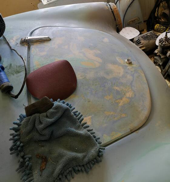

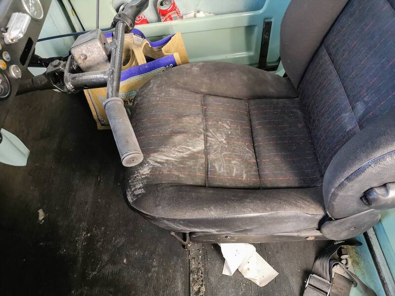

The Invacar has had a little more sanding work.  Have been going very gently with the P120 discs on the sander at low speed over the front of the car.  Unlike the rear this has no coloured gel coat... it's been painted from the factory.  It's also far thinner, so I'm aiming to just remove the loose areas here then I'll see how things look with some high build primer on there.
While it looks horrible, this is actually smooth to the touch.
Bonnet is still a mess, but is far closer to flat than it was!
Then forgot to dust myself off before sitting in the driver's seat.
Just a bit of dust about...
Going to give one of those cheap soda blasters a shot for the rear body and roof...if it works it works...if not it's no huge loss and I'll just need to persevere...

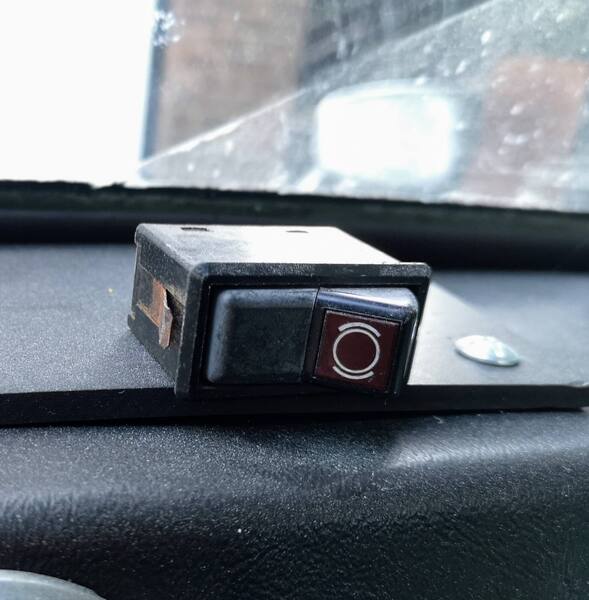

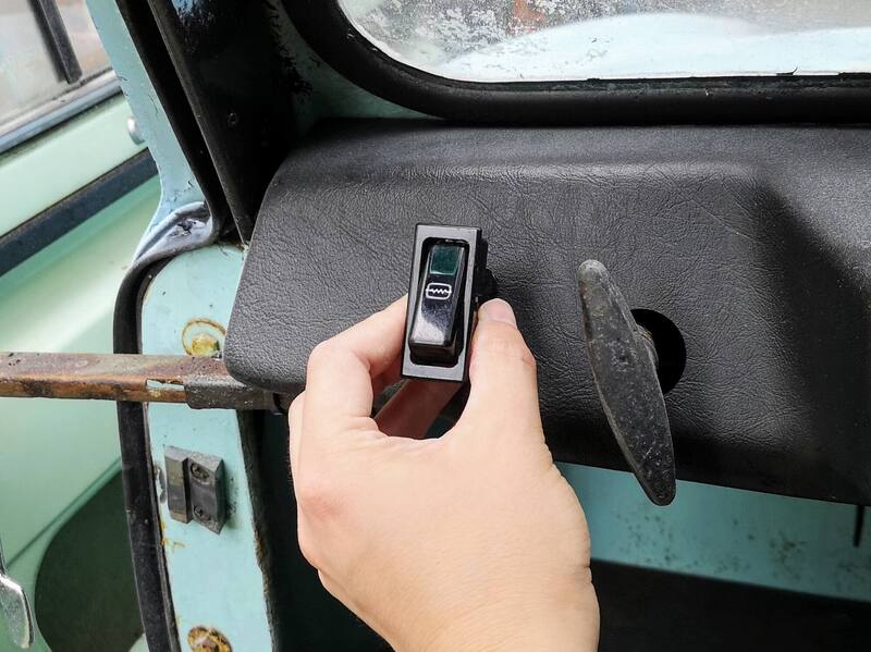

Here's a question for you lot.
Heater and windscreen demister switch will be getting fitted in the not too distant future.  It's of a type which is visually identical to those already on the dash so should look like it's meant to be there.
The question is where to put it.
There are three options as I see it:
[] Immediately to the right of the speedometer.
[] To the far right over by the no passengers sign.
[] To the far left, between the handbrake and door.
I'm currently leaning towards the first option...seems most in keeping with the original switchgear.  Should still leave me room to add the brake fluid warning lamp when the hardware for it is fitted.
Any votes for other locations?
May well fit this to my spare dash as I want to take the dash out to sort a couple of wiring bodges I've seen under there.  Will make it a lot easier though as being off the car will vastly improve access.
defo first option by the speedo for me, as you say, thats how they would of done things originally :)

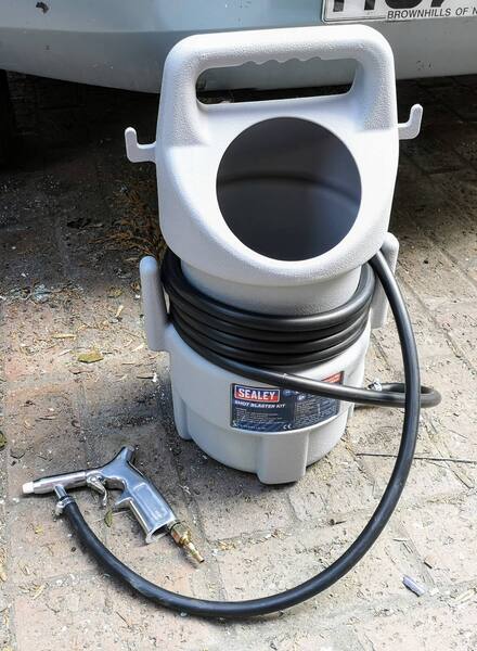

Was just about to close the garage up when this arrived in the most comically oversized box I've seen in a while.  I should have taken a photo of it, the thing was nearly the size of the wheelie bin.
Hopefully will have some soda blasting media arriving in the next day or two so will be able to give it a test run then.  Just didn't seem worth not giving this kit a shot at less than £40 delivered.  If it works, aside from saving me a lot of grief on the Invacar it will be an all round useful thing to have.  Bit like having a compressor...I doubt it's a tool I'll really appreciate until I've got used to having it around.

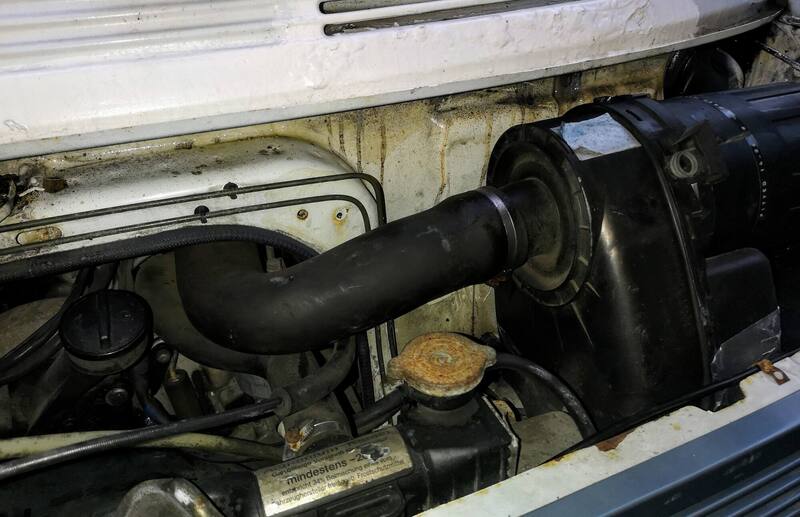

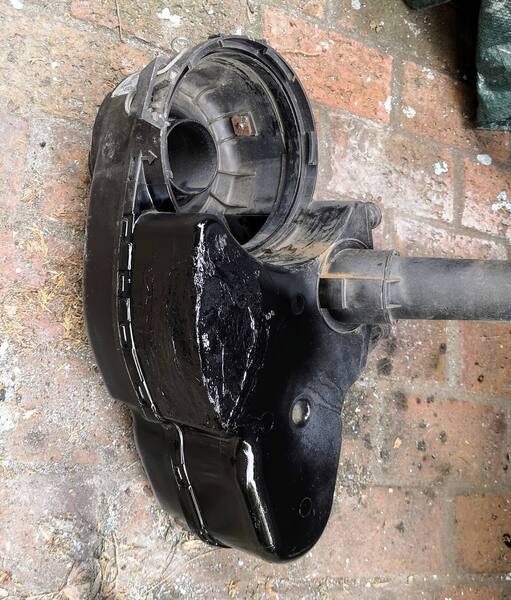

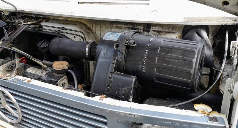

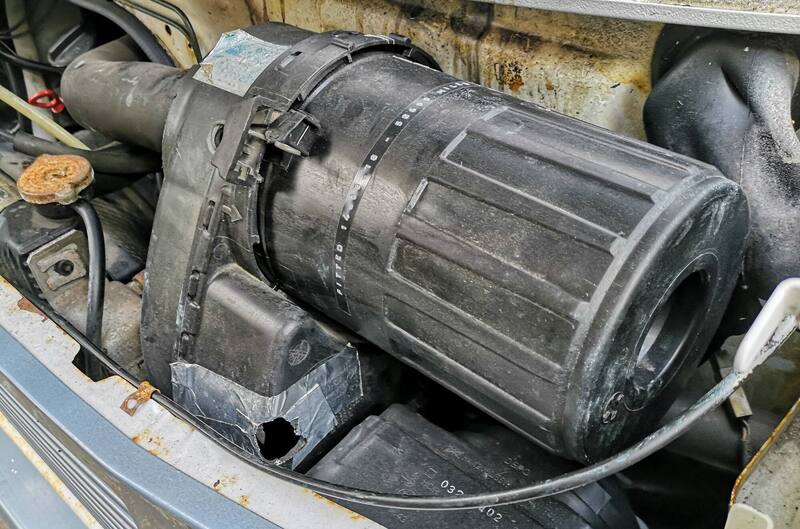

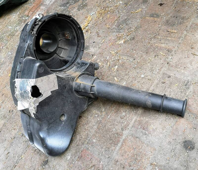

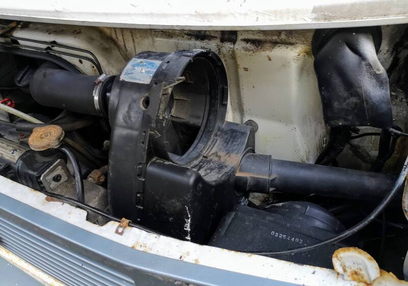

Felt that I had to *make* some time in the late afternoon to have a look into an issue which had become painfully obvious in the van on the way back home yesterday - an absoltely maddeningly intrusive boomy resonance from the engine.  This is an issue which it had when I originally picked it up and had been bodged a couple of times so I knew the likely cause was the fact that there's a stinking great hole in the air cleaner resonator chamber.
Being a normally aspirated diesel, Mercedes have done quite a lot of work to ensure that as much air as possible is forced into the engine, hence there being a not insubstantially sized box in the air cleaner assembly.  The effectiveness of this is immediately apparent when you try to patch up a hole in the wall of said box.  Initially I went for duct tape (as you do), which lasted all of about ten seconds before being blown off.  Putting your hand over the hole honestly feels like you're blocking off the exhaust rather than the intake.  The aluminium foil tape I tried next last lasted longer but the racket I was hearing suggested that it too had failed.  Let's take a look.
Yep, that would do it.
Actually getting the airbox out of the van was a little more involved than I expected as Merceds seemed to think that bolting it to the bulkhead by no less than four M6 bolts.  Three of these are accessible once the fuse box is removed (four screws), the final one however is low enough down that you also  need to remove the kick plate in the passenger footwell, which means another two nuts being removed, peeling the carpet back and disconnecting the electronic box which lives under there which is something to do with the brake lights.
Then I just had to disconnect the air intake hose (which came off at the engine end first...apparently whoever had that off last didn't tighten up the hose clip) and wrestle the thing out of the engine bay, which was actually  harder than expected as it's a far bigger assembly than it looks when in place.  It just fits into the gap between the slam panel and bulkhead when rotated in exactly the right way.

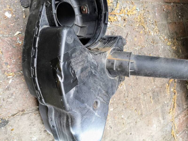

The big difference between me now and when I originally bodged this up is that I've got more materials to hand now.  My intention this time was to go with the fibreglass loaded resin I've been using to do a lot of the repairs to the Invacar bodywork.  If that doesn't work I'll just have to take the whole thing apart and either bolt a panel onto it or mess around plastic welding a patch over the hole.
Step one (fine, step two...One was to remove all the foil and clean the area in question up) was to apply a small duct tape patch.  This isn't actually going to play any part in the final repair, it's just to stop the resin from falling straight through the hole I'm trying to cover.
I then roughened the area around it up with the wire wheel to give me the best chance of getting the repair to stick - though I'd done a test before with this and the resin seemed to adhere to the surface just fine.
Then slathered the area with a liberal helping of resin.

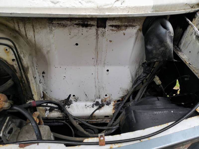

While this was setting I took the opportunity to give the area behind the air cleaner a clean and to thoroughly blast the areas it's normally in the way of with rustproofing wax.  Also tidied up the wiring a bit as whoever did the repairs to the cab floor in that corner obviously never put anything back in the clips so the wiring was all flapping around everywhere.
The photo there is obviously the "before" image for the work mentioned above.
Once the resin had set I gave it a very quick and dirty blast of matt black paint just so it doesn't stick out so obviously - if it proves durable I'll sand it back smoother at a later date.  Not going to worry about that just now though.
It's really interesting to see how much effort they went to to optimise gas flow here.  Looking into the inlet manifold you can clearly see how things taper as you pass the branch for each cylinder, meaning that while the volume of air being carried drops by 25% for each cylinder they've clearly tried to ensure that the velocity remains constant.

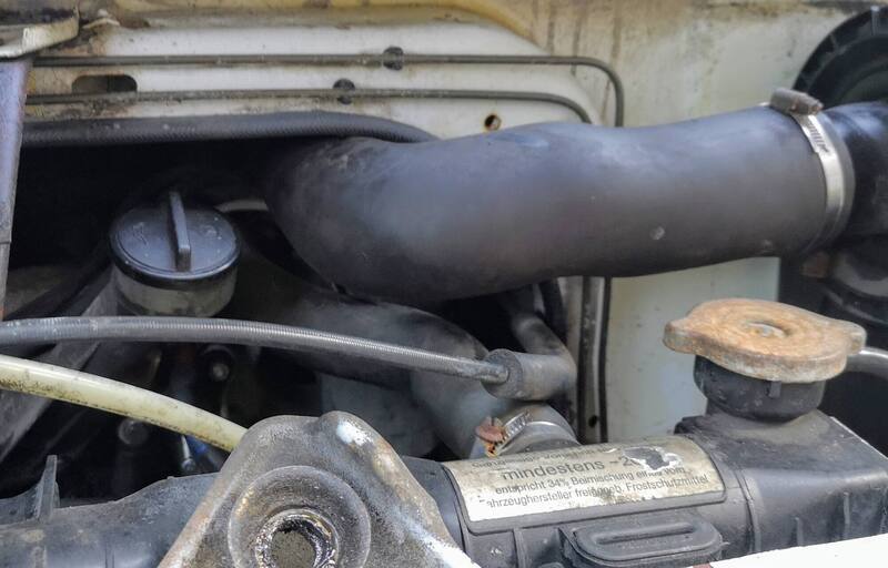

Given I wasn't 100% sure of whether the intake pipe had actually been properly attached I was glad to see this wasn't full of dust and gunk like the rest of the engine bay too.
Then was just a relatively simple matter of putting everything back together again.

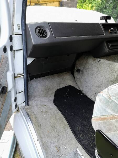

Definitely want to think about using some modern sound proofing under the carpets here.  The stuff attached to the kick plate under the carpets here must weigh the best part of 5kg - it honestly feels like the plate is made of cast iron it's that heavy.  Pretty sure there are alternatives available now which will do as good (or better) a job for a fraction of the weight.  There's also absolutely zip by way of soundproofing on the actual bulkhead itself.
Airbox back in place and reconnected.
I came to the conclusion that the hose between the airbox and the intake manifold had been fitted backwards before.  The logic behind this was that it was always pressed up against the top radiator hose.  I didn't like this as I've had issues with hoses failing due to rubbing against stuff in the engine bay before.  Rotating it 180 degrees left a good inch or so clearance under it.  Much better.
You can see the witness mark on the radiator hose where it's been rubbing for goodness only knows how many years.
Finally, air cleaner reattached as well and we can call it a day.
A quick test run revealed that this has indeed got rid of the horrible boominess.  Hard to tell if there's any improvement in power delivery, though I wouldn't really expect it to be that obvious given the power to weight ratio delivered here at the best of times.  It can't hurt though!
Yes I did of course snap a quick idle video for those of you who like a bit of old school diesel clatter.  Even if I did get momentarily distracted by discovering where one of the worst buzzes in the van at idle was coming from - the awning.  I'll need to get another couple of straps to secure it when not in use.
The camera seems to pick up a lot more belt noise from the front of the engine noise than there really is in person.  First time I think I've managed to actually get the camera's mic to pick up the nice deep burble at idle from the exhaust.  You'll probably need either headphones or decent speakers to really hear that though.
Just have to wait and see if the repair to the airbox holds or if I'm going to need to get more inventive.  There's no risk of anything getting sucked into the engine if it fails by the way, the hole is on the atomospheric side of the air filter.  Prior experience has shown that it's more likely to blow it off too rather than actually suck it into the engine anyway.  If this were downstream of the filter I'd have been being a LOT more careful.

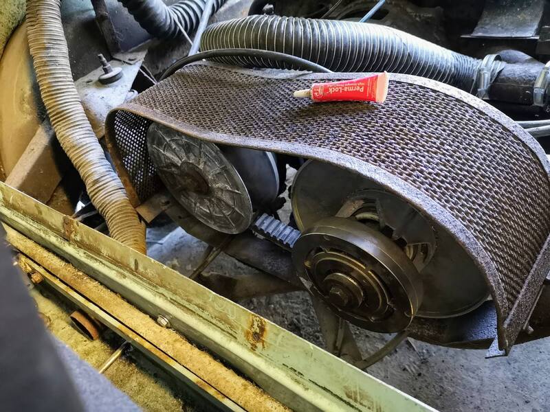

While the secondary pulley was ready "out of the box" so to speak, the primary one needed a quick clean up first to deal with some aluminium oxide on the running surface.
Five minutes with the wire brush later it was much better.
For those playing along at home, here's a clear photo of the markings on the new primary pulley.
Getting the primary pulley off was precisely as much of a pain as I'd expected it to be.  Simple reason: there is no easy way to lock the thing in place while you try to crack the retaining nut off.  After snapping one large screwdriver and bending another, I finally managed to get it to cooperate.
Yes, that is a crowbar.  It later came into its own again while I battered it with a hammer to get the pulley off the shaft.  The secondary one slid off pretty easily once unbolted, the primary was really quite a snug fit.
With it off it immediately became apparent that something wasn't right.  The reason it rattled was because it appears to be completely devoid of any springs.
It never ceases to amaze me how knackered this sort of setup can be while still working to at least some degree...this felt absolutely fine anywhere below about 40mph!
The new secondary pulley looks to be a different type...but given the source I'm going to give it a shot.
Reassembly was relatively painless, only slightly awkward discovery was that the keyway cutout in the new primary was shallower than on the old one, requiring a rectangular rather than square key.  Luckily I've quite a few random shaft keys in the "drawer of random fasteners and similar stuff" and was able to find one that was a perfect fit in a couple of minutes.
Belt tension was checked after I'd rolled the car up and down the driveway a couple of times (yay...it no longer goes *click-squeak...click-squeak...click-squeak...* while moving at low speed.  Seems reasonable.
Was only able to get out for a ten minute test drive this evening before dinner, but immediate impressions:

Oh, and while halfway round a roundabout the brake fluid warning light which I'd lost was spotted skittering across the floor.  It has now been safely stuck in the box of random Invacar bits.
Looking forward to a proper test drive tomorrow...after I've cleaned the windows!  I did wipe them down briefly...but obviously not very well, and I totally forgot about the wing mirror.

Initial experimentation with the soda blaster has yielded an absolutely godawful mess but little progress in terms of shifting the original paint.  Hard to tell if that's just my air supply not being up to spec or if it's just further evidence of the paint on there being able to withstand a tactical nuclear strike.
My entire garage is now about 1/2" deep in finely powdered sodium bicarbonate...oh well, at least it will smell fresh for the foreseeable future!
