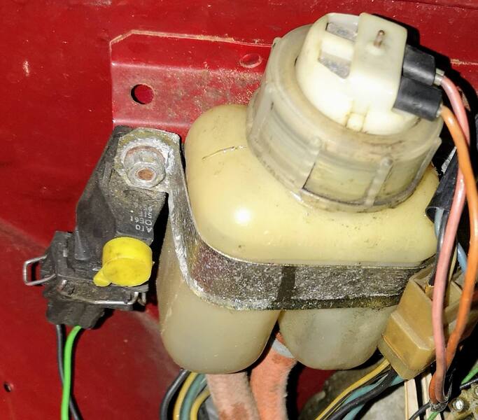

Time to sort the brake fluid leak...quit procrastinating and just get on with it.
New caliper piston and seal kit all ready to go.
The problem is pretty obvious where I usually park.
The horrible mess is rather more obvious once the wheel is off.
Yuck.
Yep...it be a piston seal that's leaking (didn't expect otherwise really).
These brakes are refreshingly easy to work on.  The pad retaining rods are floating on springs (so they're *usually* not seized) and come straight out once two P clips are pulled off.  Then the pads lift straight out, and two further bolts (17mm) allow the caliper to be removed from the hub.
I had originally planned to change the flexible line as well but the union at the inner wing end didn't immediately relent when presented with a spanner so I opted for "leave it well alone" as one of the main targets for this job was not to generate a bigger to do list than I started with.
Getting the piston out required a bit of perseverance simply because I didn't have a helper to press the pedal while I kept an eye on things and compressed air was out of the question as my compressor is currently out of commission until I find out why it's tripping the RCD.
Wasn't too hard though, with the dust boot removed it was easy enough to pull it free while slowly rotating it.
The fluid actually in there didn't really look too bad and there was no puddle of metallic sludge in there like I've found in a few older calipers.
There wasn't really any obvious damage to either the piston or the seal at a glance.
Though the new seal is a more snug fit to the piston, there's visible clearance between the old seal and piston.
(Trying to photograph that was an utter pain).
The only signs of damage I could see were some *really* fine scratching/pitting near the outer edge.
Ignore the mangled finish on the inner area of the step, that's just from me wrestling it out of the caliper , and is the area normally outside the dust boot.
This isn't enough to feel with a fingernail and is only visible when the light catches it just right.  I guess it's enough though given the clearances involved.
I made the executive decision to leave the outboard piston alone.  There's absolutely no sign of leakage from it at this stage (I did have a peek under the rubber dust boot), and given that pulling the caliper takes all of five minutes, it's not the end of the world if it needs to be revisited.
No photos from the actual dismantling and reassembly process I'm afraid as I was predictably absolutely covered in a horrible slimy congealed brake dust/brake fluid mixture.
This was snapped once I'd reassembled everything and changed into a fresh pair of gloves.
The bleed nipple even came undone without undue force (it was slightly rounded off though, so the new one from the service kit was fitted - dust cap has since been added).
Then hooked up the Easybleed and let it run until I had a steady stream of clean fluid running through.
Then it was just a matter of double checking the fluid level...
...5-10mm above the mounting bracket is correct.

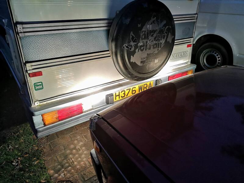

Then going for a test drive.  Well it would have been if the headlights hadn't then decided to play funny buggers.
Nearside is lit at roughly 50%, and doesn't respond to switching between dip and main beam.
Tapping the relay that handles that headlight with the handle of a screwdriver immediately restored normal operation.
The headlights on this while not being quite up there with some of the modern cars with good HID setups are by quite a long way the best of any classic I've driven.  Definitely an example of what the humble H4 headlight bulb can actually do with a decent optical system to work with.
