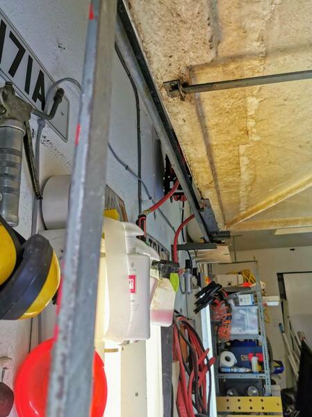

This parcel arrived for the garage yesterday.
Sadly didn't have time to get it fitted until this afternoon.
It's a *heavy* sucker so I had to use some pretty serious fasteners, got there in the end though.
Think this location is a pretty good idea as it's using what would otherwise be totally dead space.
Also positioned such that if it *does* decide to pull the ceiling down, it'll more likely land on the door frame rather than the car.  Not actually hooked up yet as I need a reducer for the outlet as it's 3/8" and everything I have here is 1/4" - and nowhere locally I could think of had a 3/8" quick connect.
You can see how it's completely tucked away so shouldn't get in the way.
The multiple holes in the ceiling was me trying to find a ceiling joist.

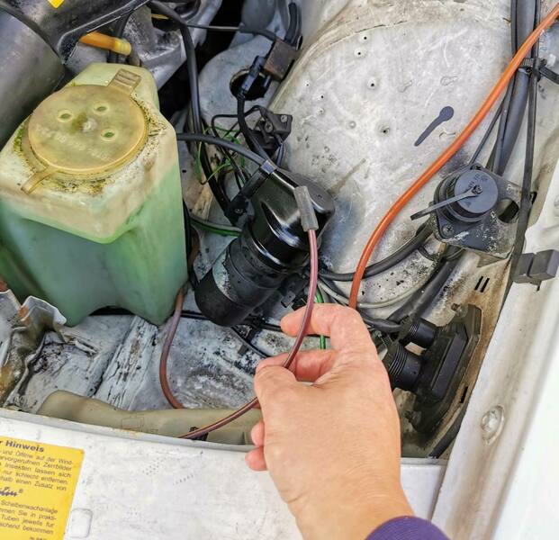

Having had the Mercedes out once in the dark it was obvious that the headlight alignment was way out - a ten second check quickly traced the reason for this.
As with many things on this car, the headlamp beam height adjuster control operates the mechanism by vacuum - and the hose had come adrift behind the nearside headlight.  I probably knocked it off when I pulled the cover off back when I first got the car to help get the condensation out of that headlight.
Reattachment of the vacuum line to the actuator on the nearside headlight has restored the level adjustment function and a more or less sane looking pattern.  Reckon it could do with a tweak, but it's hard to say looking at the far side of the road.  I'll see about checking it against a known good pattern on the garage door at some point.

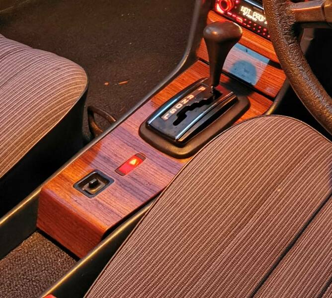

Only one small job done today. Due to a missing trim clip the trim panel in front of the centre cubby hole sat a good 1/4" proud of the surrounding trim and looked obviously wrong.
The way this whole panel is secured is that it slots into place under the ashtray then slides forward to locate. So replacing the missing clip wasn't something requiring *too* much precision. Cue careful use of a woodscrew...being careful to not break the surface. There was already a void here from where the original clip was secured so I've just used that space really rather than screwing further into quite a thin bit of wood.
Sophisticated it isn't but it works.
The whole panel used to wobble around and rattle before, none of that now. If I find what type of clip was originally used there I will see about replacing it properly.one day, but it's pretty low on the priority list.  I really do like how with this interior that they seemed to have figured out exactly how much and where to use the polished wood trim to make it feel properly special, but not be too over the top and brash. Especially with a contrasting interior colour like blue or green.

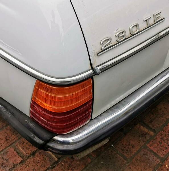

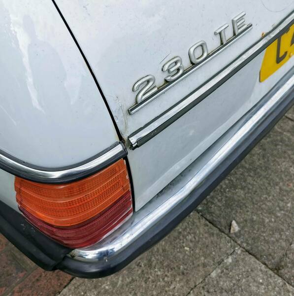

Had a box arrive today I've been waiting a couple of weeks for - the replacement tail lights for the Merc.  Took forever to arrive as there were issues with the shipping - with the goods having been returned to the sender twice - I assume due to issues with export paperwork.
Before and after for the offside.
Fit is...average at best.  But given they were about 10% of the cost of most of the used genuine ones I've found I'd say it's reasonable.  I doubt you'd notice unless you were looking for it.
The original here has pretty well had it.
Sadly the nearside one fared less well during transit.
Seller immediately agreed to send a replacement, so hopefully that will be here soon.  Be nice to get these sorted out.  Small detail really, but a very visibly obvious one.
