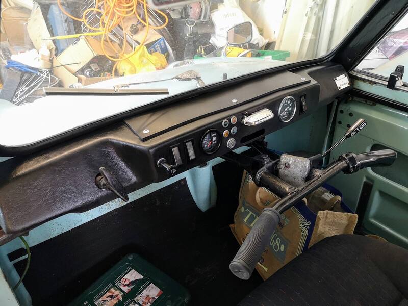

Well this was a moderately frustrating afternoon.
Didn't have a huge amount of time to play with so decided to go for a quick and easy option for stuff to tick off the to do list.
Some...it feels like considerable...time ago some of you may recall me picking these up at an autojumble.
Intention being to use windscreen demister switch to switch the heater blower and the other to be wired in as a brake fluid level indicator.  Figured this afternoon would be a good opportunity to get them actually installed.  The general public agreement for placement was for it to go where I had suggested, to the right of the speedometer, mirroring the headlight/wiper switches on the other side of the dash.  I wanted to align things such that I had room to install a total of three switches there for potential future upgrades (I've a half developed idea to get me working forced cool air ventilation in the cabin which would want an additional one).  While the brake light/switch doesn't quite match visually it's the same width as the Invacar (etc!) ones so I can reuse the cutout for it in future.  I know BMC had a thing for using switch-based brake fluid warning lights for many years, did they ever do one that used this type of footprint?
I've seen vertically oriented warning lights of about this size on some Man buses from the 80s, but without access to a boneyard to go digging through never likely to find any.  A part of me still really wants to get access to a dead late 90s Man 18.220 as they had literally a few dozen discrete warning lights on the dash, and my box of random panel indicators etc needs those...They match the footprint of those in the van too so would be nice for status indicators in the living area too.  Kind of kick myself for not seeing if I could make that happen (and get hold of a flipdot destination blind & controller) back when I still had contacts in the industry.
Anyhow...back on topic.
This started poorly in that I couldn't even find the brake one.
A bit of measurement and marking out with scribbles on masking tape was done before I set about cutting the hole for the heater switch, which in an almost unheard of turn of events actually didn't go horribly.  Not the tidiest cut in the world but the couple of wobbles are small enough to be well behind the switch bezel.
This is where things came unravelled.
The action of the switch was a bit "crunchy" for want of a better word, and the meter showed it to be slightly erratic in terms of contact.  I've already had both of the ones in the car apart to be cleaned and regreased so figured I'd do the same here.  They're not difficult switches to service and it makes a huge difference.
However somewhere between me taking it apart and getting back into the car to reassemble it, the little spring which sits between the contact plate and the switch shuttle assembly vanished.  I have no idea where...it was there when I took it apart, it wasn't when I went to reassemble it.  I don't know if I dropped it, though I know it just sits in there and is loose so I don't think I'd have just walked outside with it sitting on top of the switch...or if I've set it aside somewhere "safe" and forgotten where...or if I've set it somewhere safe and it's rolled  away.
Either way...I spent the best part of an hour and a half searching for the blasted thing, then another 45 minutes digging through my various boxes of miscellaneous parts to see if I could find a suitable replacement.  That would be a no.
Don't suppose anyone has one of these switches floating around I could buy do they?  Doesn't need to be an illuminated one as I just want to nick the spring out of it!
I'll have another rummage around tomorrow.  Might need to back the car out as at least that will let me see clearly underneath where it's parked and give me a bit more room...
Back out this afternoon to see if I could find that blasted spring.  After about an hour of digging through the garage I finally relented and shuffled all the stuff out of the way, moved the Jag onto the street and backed the van up so I could get TPA out of the garage.  Here she is blinking in the sunlight for the first time since September.
Could I find it even having got myself some room to move?  Not a chance.
Had a last bash at things by sweeping the garage out then going through the resulting pile of dust with a magnet.  Result?
Found ya, you little sod!
Ten minutes later I actually got the switch cleaned up, back together and was able to get it installed.
Doesn't look out of place I reckon.
Could have been straighter, but I'll take it.  There's a bit of wiggle room there so I can look to fine tune it later.  Obviously needs wiring attached at some point.  Plus at some point I'll be swapping the dash out for the spare I have which doesn't have a stinking great hole in the top anyway.  I need to pull it to tidy some of the existing wiring up anyway (the main ignition feed passing through a rusty screw terminal block doesn't instill confidence!), so may as well take the opportunity to fit the better dash while it's out.
Speaking of wiring I want to see if I can make a few improvements anyway...a relay or two to take the load off the ignition switch for one as it gets warmer than I'd like.
Wouldn't be a bad idea to tackle that job now while the car's otherwise off the road now I think of it...

I was going to say your wiper switch is upside down as the pictogram shows the wiper coming down from the top. That would be an easy fix. I realise you've got bigger problems but that would be (is) bugging me. But then I noticed what looks like a choke knob next to it also a wiper logo on it (and that one is the right way round!).
So how does that work, ones the on/off and ones a speed control? But I doubt they have a two speed wiper.
Actually, it's just occurred to me as I was typing this the left one is probably a plunger for windscreen washer. I like those, I have one in the Triumph and you can adjust where it hits the screen by how hard you push it. If you push it really hard it goes right over the screen and comes in the sunroof.
Anyway, I'm just rambling now but that switch needs turning round.
The wiper switches are all like that, likely a case of what was cheaply available out the parts bin.  If you were to turn it around it would sit in the wrong position when off (the stop which sets which way the switch moves is moulded into the switch cap, so it's no a simple matter of flipping it round).  The knob next to the wiper switch is as you correctly identified a mechanical windscreen washer pump.  The choke is up above the windscreen on the offside with the heater/demister air distribution controls.
The only car I've seen with a switch on the dash to do with intermittent wipe was the Skoda Rapid/130GL (the 130GL was an Estelle which got all the Rapid interior bits, so different dash, centre console, better door trims etc).
That gave you three different delay settings when the wipers were set to intermittent.  They were spaced such that it was actually genuinely useful.
A lot of what I'm doing now to be fair is detail stuff.  The bodywork is scruffy but it's not a problem really for now.  Once the hub is sorted she should be back in service, I'm just trying to tick off a lot of the stuff I threw together originally, but doing it right this time.  To be honest a lot of it is detail stuff like "cable tie that bit of loom" or "install foam pad to stop that rattling" and the like.
this really is as @dollywobbler puts it is the "did you know princess Anne" of Model 70 owners :)
the switch is the correct way up even if the pictogram is "upside down"
they were all like that from the factory including the User trial BPE-H prototype Model 70's!
rather annoyingly someone has actually turned the switch in REV upside down, which bugs me because it looks wrong, but also confused me a little and I wasn't sure which position was on or off!
(someone's also fiddled with my warning lights in the past as you can also see, but I think ill leave those be as they make more sense!)
as such I unknowingly left it in the on position, and when the windscreen wiper decided it wanted to work mid drive it scared the crap out of me LOL
See that looks much better to me though I'll agree if you just turn the whole switch round that will also look wrong as the off position will have it sticking out at the top. I doubt it's that hard to take the cover off and turn it round though I can't remember to be honest. They are standard British Leyland switches, I had them in my Landcrabs but it's been a long time.
I realise none of this is important in the grand scheme of things.
You can't turn the cap around (I've already tried!) as there's a stop moulded into the cap which is which defines which direction the switch can move in.  The ones designed to be fitted the other way up have a tab on the back of the switch cap moulded into the opposite end.
I've had all the switches apart to clean and grease them, so did look to see if I could flip the symbol the right way up at that point.
This layout being largely obsolete aside from a few commercial vehicles by the time the Model 70 went into production probably meant they were able to buy them in cheaper.

I also attacked the dashboard with some more plastic treatment.  It was looking really dull again, and that seems to really drag down the perception of the interior...and I was getting hacked off trying to order a drill bit from Amazon and getting two and a half pages into the search results before it would actually show me what I had searched for, so needed to do something to lower my blood pressure again!
It does look so much better when the dash is clean.  Shiny plastics look wrong in a lot of cars, but this isn't one of them.
I know some people will laugh at me doing stuff like that on such a scruffy car, but I fully intend the interior to not be scruffy once I'm done with it.  I've little interest in getting the exterior into a spotless state, but I fully intend to have the interior in a properly tidy condition eventually.  I want it to be a pleasant place to be, even if that means a few deviations from the factory spec.  I've said it before I think, but I'm kind of aiming to make TPA into my interpretation of what the Model 70 could have been if it had been marketed as an actual market competitor to many microcars.  Aside from dual circuit brakes, a couple of warning lights and additional instruments the mechanical side to be honest is absolutely fine as it left the factory...I don't want to sound like a broken record, but it really is a bloody well engineered little car, it's just in the cabin it loses points really.  Yes, it is very basic and agricultural by today's standards...but is world's ahead of a lot of contemporary microcars, even four wheeled ones!
