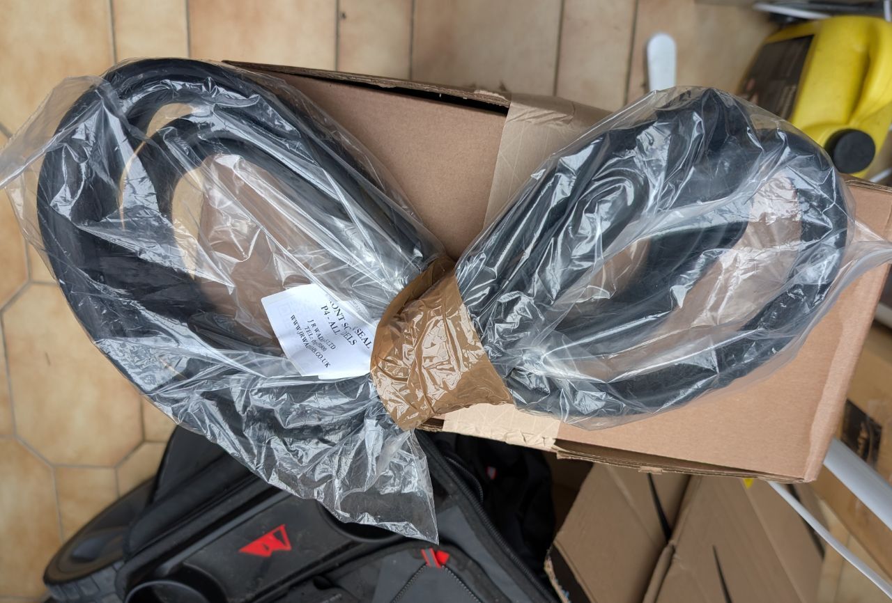

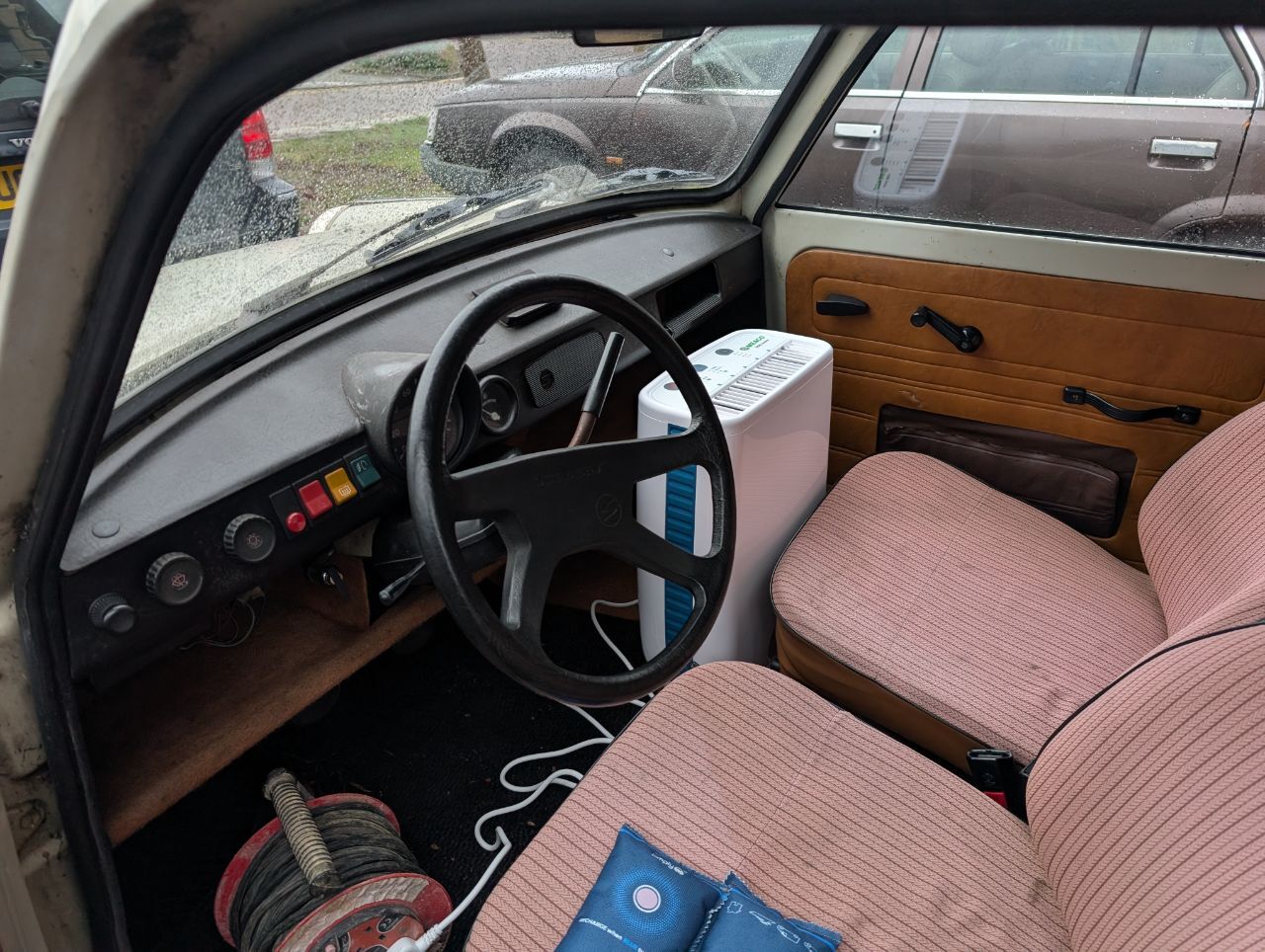

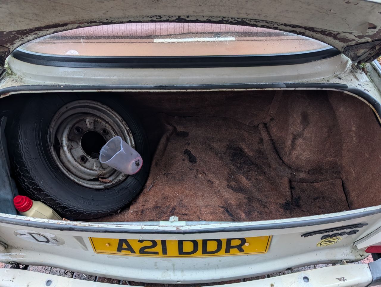

The Trabant has water ingress issues.
The windscreen does leak a bit as the seal has shrunk, but only when driving.  The rear windscreen on the other hand absolutely pees water into the offside of the boot.
The cause of this is rot in the screen surround.  This will be Fun to sort.  Hopefully get it done this year though.
Annoyingly I don't believe repair sections for this area are available so we'll need to do some fabrication.  I won't be doing this.  I don't have anywhere near the required skills or tools to do a good job of it.
Once the screen surround is sorted I'll also get the corrosion in the boot floor sorted - though at the moment it's providing a way for a fair chunk of the water that gets in a way to get back out again.  This is why I just slathered the area in rust converter and protection and left it be otherwise for the time being.  I had checked with my MOT tester beforehand and they confirmed that it wasn't anywhere near any prescribed areas so wasn't urgent.  Unlike the wonderful reconstructive work that was done on the front chassis/subframe mounts earlier last year.
This has resulted in the car being unpleasantly damp in the winter.
I had been working with a couple of these packs - which definitely helps a lot.
However they very much have their limits and needed to be dried out roughly weekly at this time of the year.  Time for something a bit more heavy duty.
A proper dehumidifier.  Which definitely seems to be doing it's job as in a couple of hours it had already collected this much water.
It's important to know that there are two types of dehumidifiers.  Heat pump and dessicant based.
I hope you were looking forward to a brief rambling Segway into dehumidifier technologies, because there's one coming right up.
Heat pump units are the most common and generally the cheapest.  They way that they work is really simple - they are basically just a tiny fridge or air conditioner - in that they chill a metal coil to below dew point which the air you want to dry is then passed over.  Exactly the same as how condensation forms on the outside of a glass of a cold drink, it forms on the coil and is then directed into a drip tray.
Under ideal circumstances these are more efficient.
They do have a big shortcoming though - and that's that they don't work well at low temperatures.  They rely on there being a temperature gradient between the surrounding air and the cold coils, and of course you can only make that so cold or the whole lot will just freeze up.  Even if it doesn't freeze up though, their performance drops like a stone once the ambient temperature drops far below around 10C.
Dessicant dehumidifiers are a bit more complicated.  They take advantage of the properties of certain materials which very readily absorb moisture at normal temperatures but will then very readily release it again when heated.
The airflow path through these things is quite convoluted.
Air is drawn in and passed through a slowly rotating disc/drum shaped honeycomb of dessicant material.  This draws the moisture out of the air.  That air is then exhausted back into the room, now dry.  As the wheel rotates, the now moisture charged dessicant moves into another air stream.
A separate fan directs some additional air through a heating element and then through the moisture charged dessicant wheel.  This causes the dessicant material to give up its gathered moisture.  This air (which is now essentially now at 100% relative humidity) is then directed into a condenser.  This is nothing special, just a plastic radiator essentially.  This is actually cooled by the air being drawn into the unit - as the air passing through it is so humid that tiny temperature drop causes the water to precipitate out of the air.  This is then channeled into a drip tray for collection.
These units have shortcomings.  The elephant in the room is efficiency.  Dessicant units quite simply are not as efficient as heat pump ones.  By quite a substantial margin.
They also have quite a lot of moving parts so long term may well not prove as reliable.  Though aside from the dessicant wheel itself most of the innards are likely to mostly be commodity parts at the end of the day so provided you know one end of a screwdriver from the other and have a bit of patience they probably are repairable so long as it's not something like the controller PCB that fails (and in this day and age that's exactly as big a risk on anything of any type).
Cost.  Generally dessicant units are more expensive.  I think rather than a reflection of the actual cost of making one unit over the other, the reason heat pump units are cheaper is simply that so many millions more of them are made every year so economy of scale wins out.
On the other hand they do have some advantages - a few of which are of particular interest for the likes of us wanting to use them for things like drying out a car.
Low temperature performance.  These things really don't care about the cold - right down to the point at which it ceases to be practical to collect liquid water, a dessicant dehumidifier will quite happily keep pulling moisture out of the air.  In fact as the condenser works at its best when it has the most cooling, they will tend to get slightly more efficient as the temperature drops.
Size/weight.  They are generally far smaller and a fair bit lighter than heat pump units.  Which makes sense when you realise that there's not a whole fridge packed into them.  This makes it far more practical to stand them up in a car foot well etc without having to mess about removing seats etc.
Heat output.  Dessicant units chuck out quite a lot of heat.  The heater is usually in the order of 300W to 800W, and most of that heat is chucked straight out of the unit more or less.  If you're trying to dry a car out in this winter having a dehumidifier that essentially doubles as a low power fan heater can be a real bonus as warming the car up will really help to draw moisture out of soft surfaces like seats and carpets.  It also will go a pretty good way to meaning that things won't freeze up even if the ambient temperature outside does dip a bit below freezing.
For indoor use in a domestic setting a heat pump unit really does make the most sense most likely if you're talking about normal ambient temperatures as they are just so much more efficient. I think you're talking something like 5 times as efficient when you boil it down (pun intended) to raw ml/kWh of water extraction.  For use in awkwardly shaped and often very cold spaces like a leaky car though, dessicant units are the obvious winner.
So ends my ramble for the evening.  Yes I am still full of the flu and can't sleep because I keep coughing my spleen up every ten minutes...so you got lumbered with my drivel for a while instead as a distraction!
I may make some edits when I'm at an actual PC tomorrow though and can read through what I've written on a proper screen and hopefully with a few more working brain cells than I have right now.

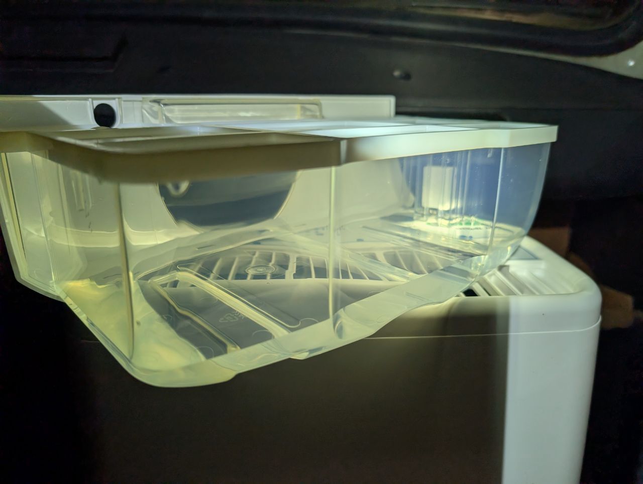

This one had roughly half filled the container overnight, and had cycled off on the humidistat (which is set to cut off at 40%rh on the highest setting).  I do have a 60W tubular heater somewhere which if I can track down I may well stick in the boot and whip out the parcel shelf.  I have actually stuck a bucket under the area where the leak is now...not sure why it didn't occur to me to do that until for now.  That would help encourage moisture to depart far more quickly.

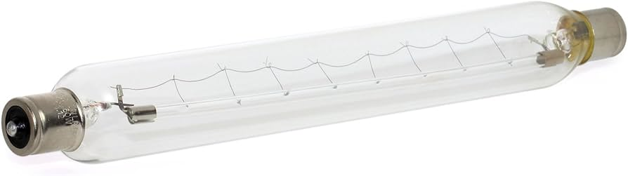

That is if I can find it.  Last time I saw it was probably 10 years ago.  If not I'll just leave it be, we'll get there in time now the moisture is being pulled out anyway.
Real advantage of this thing though from a practical perspective is that it's small and light enough (about 5kg) it just sits in the passenger footwell and I can just grab it and stuff it in the garage/Rover if I want to take the car out in all of about 20 seconds.  I did use the heat pump one I have when I first got the car and that was a major pain to get and out of the car as it only *just* could be wedged in there and weighs about 25kg.
Oh I have some of those too! :mrgreen:
Had the Trabant out today so the dehumidifier got shifted over to the Rover.
Apparently it leaks worse than I thought.  The passenger side carpet is soaking wet.  I'll try to get those pulled out in the unlikely event I get a spare five minutes at some point.
It is definitely pulling a decent amount of moisture out it seems.
"Continuous drainage" in this case being a bit of fuel hose stuck out through the door jamb.  Which is easy in this case as the bottom seal is missing.

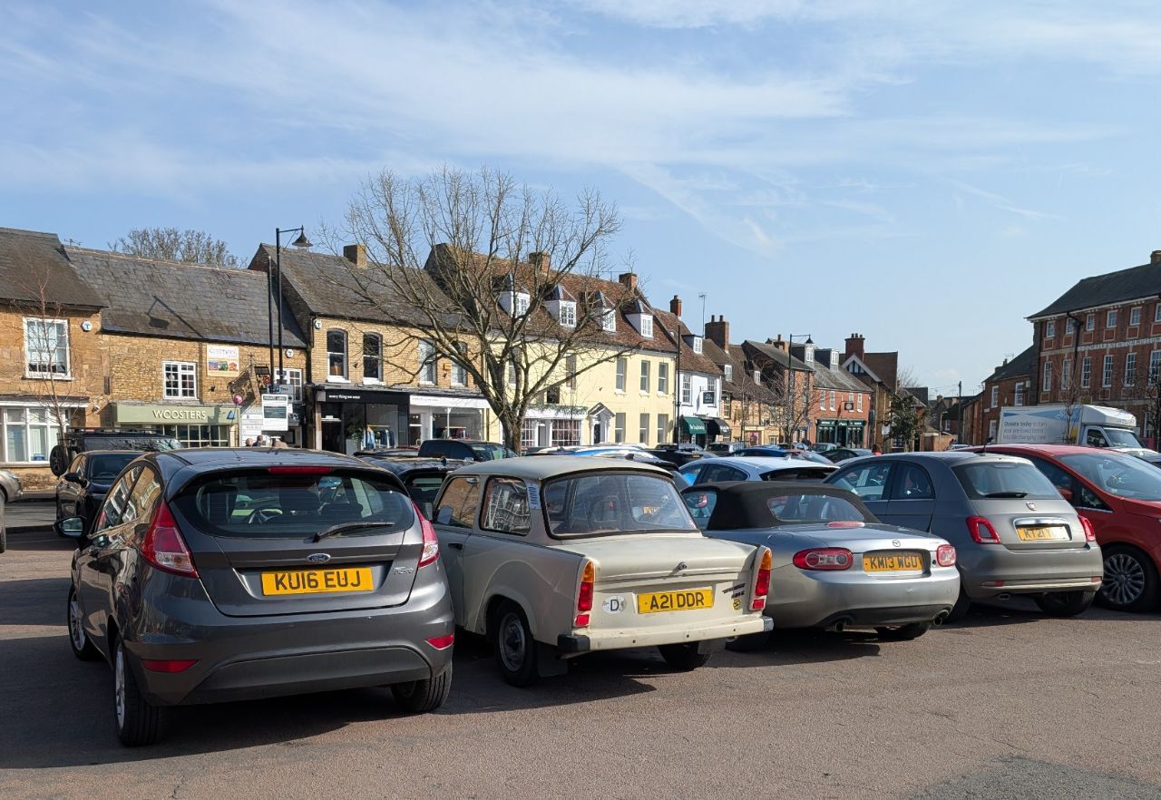

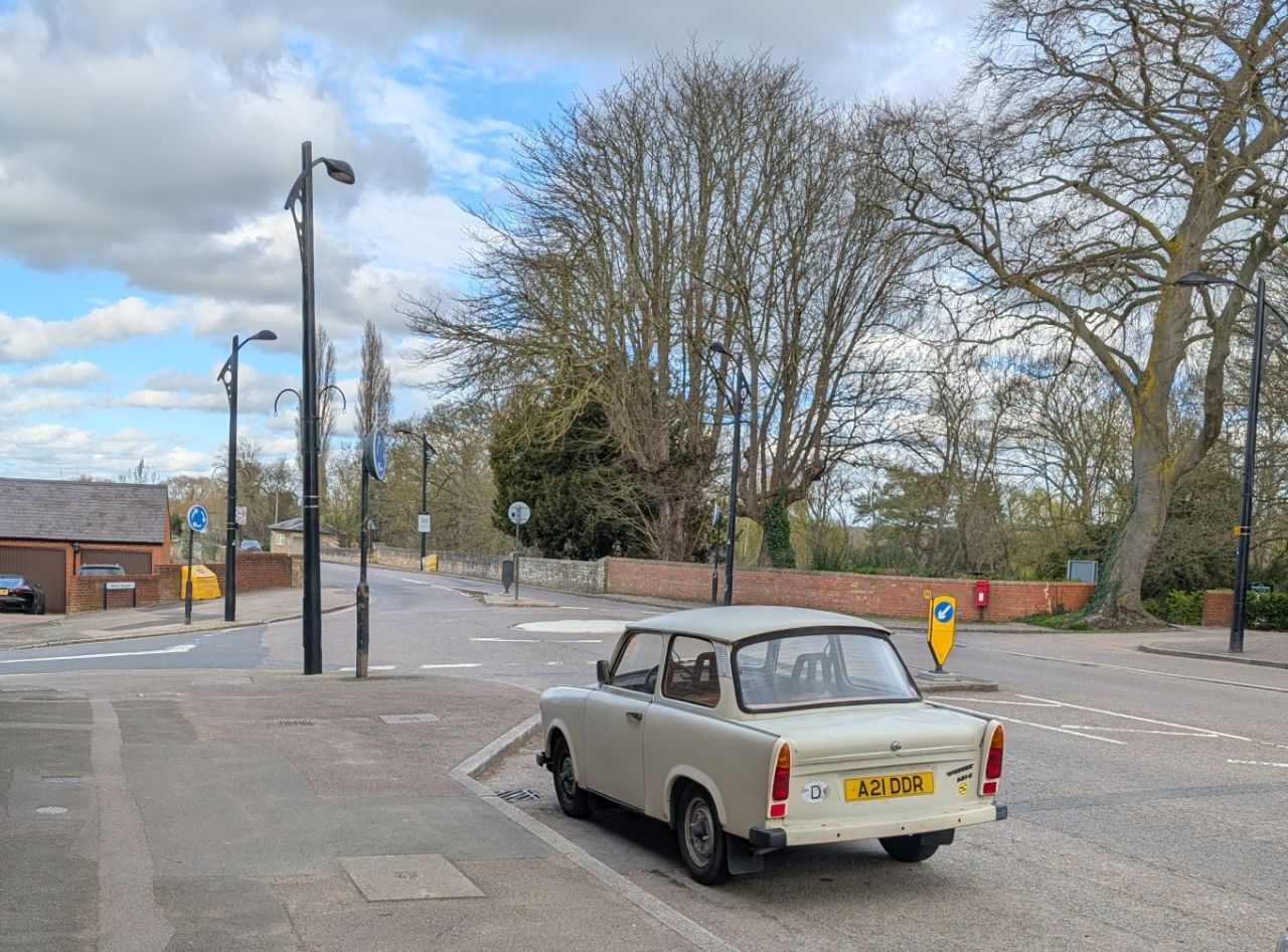

I was following someone in a giant Range Rover (complete with illegally spaced private plate, blacked out everything and silly window tints) into this car park today.  I could virtually feel the hatred as they had to do a 6 point turn to even get around the corner in the carpark and I just zapped straight into this gap with zero effort.
Driving a small car does have bonuses.  Glad I wasn't in the Volvo or I'd have had to go hunting elsewhere for a space myself.
by modern standards the whole row is very small, any of the current electric SUV's would dwarf that lot!
Done well finding a spot to park any sort of car on the market place in Olney!!!
The very reason I use a Fiat Seicento or Morris 1300 for local errands!

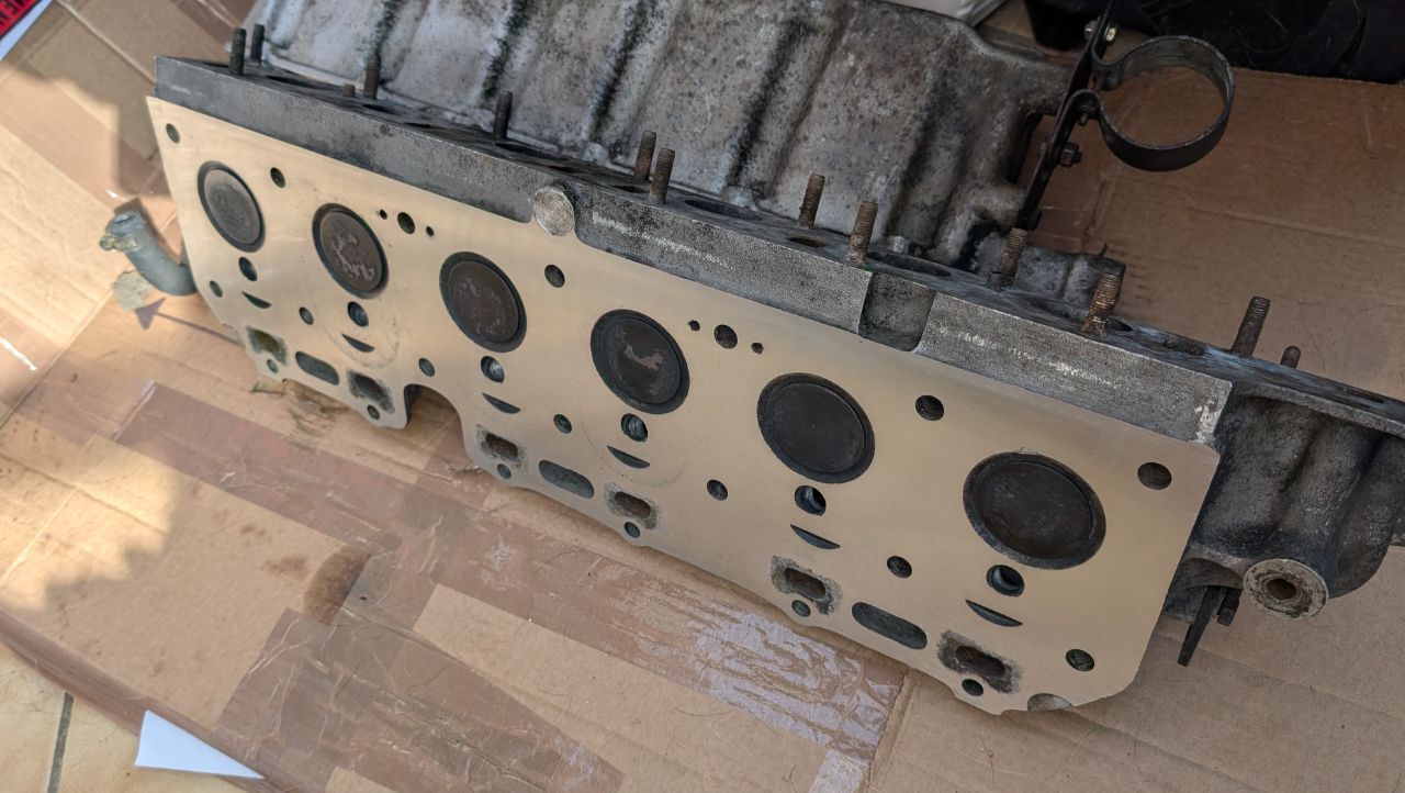

Heard back from Headline MK today.  The Rover's head has been pressure tested (good) and the valves have been vacuum tested which shows them to be seating perfectly.
They were a bit concerned about some of the pitting around the water ways so I've dropped off a head gasket to help them get their bearings for bits which may or may not be an issue.  If any welded repairs are needed before the lightest of light skims they will be made.  We're on the same page of "Anything it needs it gets" but equally there's no need to make work where it's unnecessary.

They have carefully checked the head and are happy that none of the pitting in any way affects any of the sealing surfaces, so no welding required.  It's passed all the tests thrown at it and just needed the lightest of light skims to clean and true it up.
Just need to collect it and get it refitted.  Which at the rate I'm getting to things at the moment will probably be somewhere around summer 2029 it feels like.

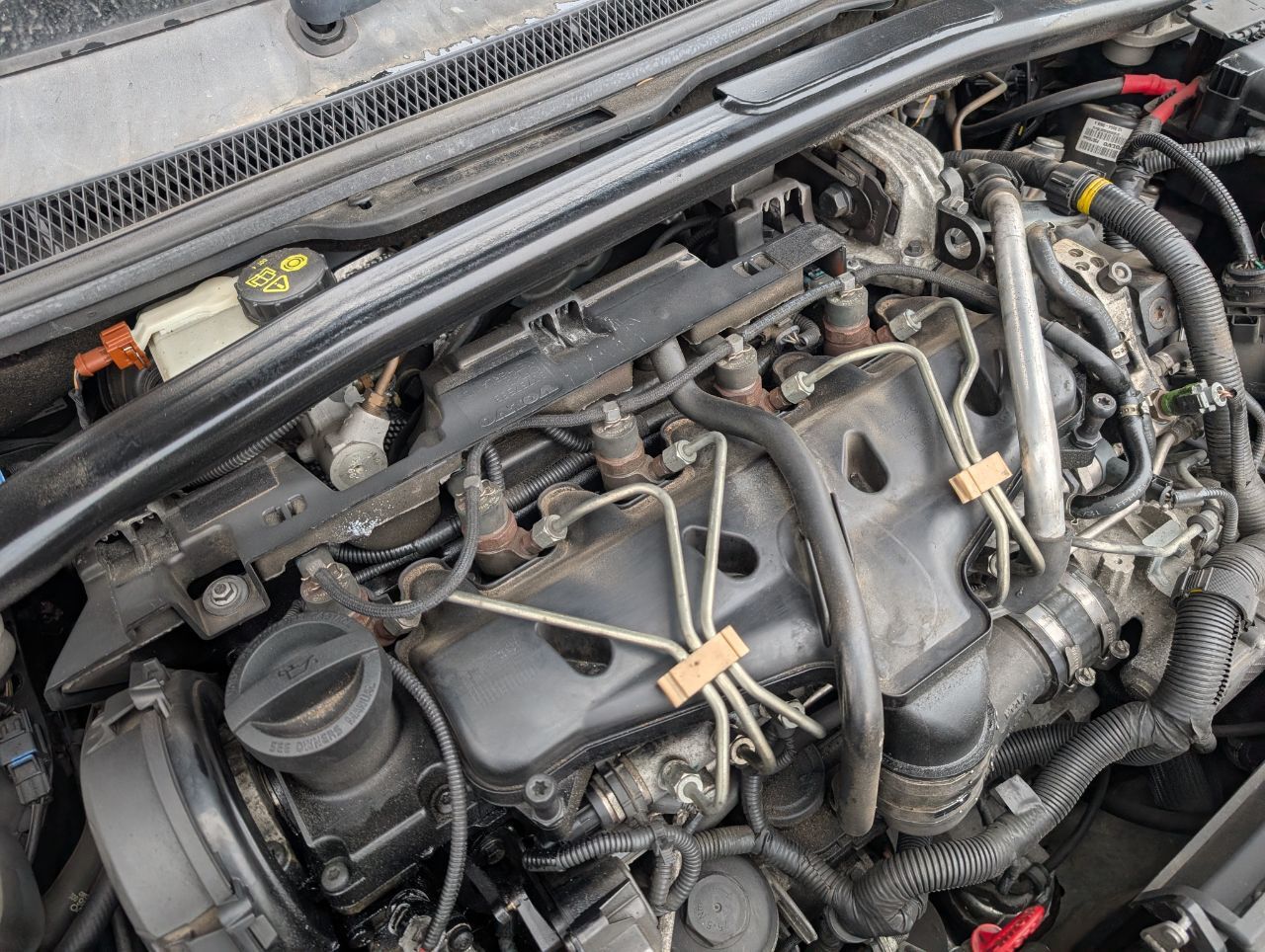

Stopped by to speak to Volvo a couple of days ago with a view to getting this lot oil tight again.  My intention was to basically just buy every oil seal for the cam cover/inlet manifold area in general.
Guess what.  Not a single one of them is still on the parts system.  Apparently 2010 is the furthest their lookup system now goes so with a 2007 car I'm out of luck.  Wonderful.
Great.  So I'm going to have to play the fscking Autodoc parts lottery again most likely.  The motor factor I'd normally use is an hour and a half round trip away and I quite simply can't spare that time at the moment.  Guess I could try MPD or Bedford Battery again...but inclined not to given they seemed to consider retail customers with the same disdain you would something unpleasant you need to scrape off your shoe the last few times I've used either.
So am doing the right thing and ignoring that until I've an hour or two to sit down at an actual computer - god only knows when that will be.

Just had quick look at this, obviously I'm not sure exactly which model/engine you have, but my guess is they either couldn't find them on the system or simply couldn't be arsed. I might be able to help if you want to PM me your VIN or reg. I can see cars going back to the 740/760 so 2007 should be covered!
I did get a distinct whiff of "Really can't be arsed, why are you making me put my phone down?" about the guy on the desk I have to admit.  I did wonder if I should just try going back on another day.  Last time I was there they were really helpful, even if as I expected the part itself was NLA - they got me the number which was really all I was after to keep an eye out for (the always broken bit of trim around the driver's seatbelt slot in the B pillar).
Reg on this is WU07NTJ.  I'm not absolutely 100% exactly where the oil is coming from, but mostly looks to be from around the cam cover in general - so I was intending to just go in armed with all the most likely candidates until I hopefully found something obvious or had just replaced everything.
This is what I can find so far. If you need me to hunt anything specific down send me a PM and I'll have another look. The fact that they have prices listed I assume means they are available.
Main rocker cover gasket: 30713459 - £52.50
Camshaft position sensor O-ring: 30756062 - £5.60
Oil filler cap gasket: 30677740 - £8.10
Sealing ring (O/S end of the head): 8631561 - £10.80
2 hours ago, High Jetter said:
£52.50 for a RCG? I thought, so chucked it into Google and cam up with this: https://www.ebay.co.uk/itm/205804190702?chn=ps&_ul=GB&mkevt=1&mkcid=28&google_free_listing_action=view_item
Not guaranteeing it's right, but her does list V70 on the listing and it might have other bits you need.
Honestly if I know it's right and it'll last another 18 years, that sounds cheap to me.  I've had nothing but headaches with random no name parts over the last few years.  I'd rather pay £50 for something I change once than £25 and I have to be in there again six months later.
Especially as I have to mess around with the fuel system to get to it, and I can't quite express enough how much I Do Not Like disturbing bits of a common rail diesel fuel system.
Useful to see though - does confirm to me that the little doodad below the oil filler vanishing into the cover does indeed have to do with the swirl flaps.  I had always assumed that to be the case, but had never got around to confirming it.
In fairness I tend to want to put my tail between my legs and run away screaming like a little girl whenever I take the cover off and see how much stuff there is covering this engine - especially as I have absolutely no idea what about half of it even does.
The XJ-S engine was probably even more busy (and was definitely less sensibly laid out) but at least I could look at (nearly) everything and tell what it did.
One bit at a time, sweet Jesus ..
@Zelandeth in fairness I did replace the swirlflaps when we owned it so it may just be shit aftermarket parts (or ham fisted fitment!)
Edit:- https://ebay.us/m/NizUqK is the one I fitted in 2023
I'd certainly give it all a clean down before worrying too much about it.
Good to know the flaps have been done.
Any things I need to be aware of pulling that lot off (aside from the bastard spline headed screws I'll need to buy bits for), or is it pretty self explanatory?
I did wash it down a month or two back and after an hour of driving there was oil all over the top end again - as best I can tell it's coming from around the cam cover but with how hard it is to actually see anything because it's all buried under itself it's hard to say.
I didn't immediately notice it was dripping on the drive as there's still a huge oil stain there from where the XJ-S used to park!
