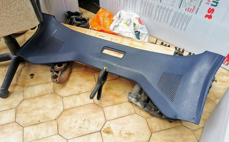

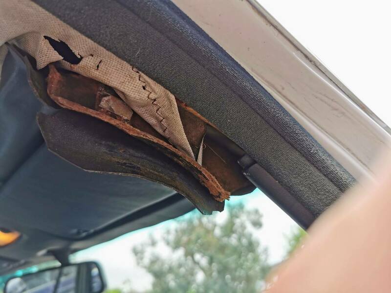

Something I have made a start on tackling is the rear headlining trim panel, which has looked like this probably for a number of years.
Not ideal.

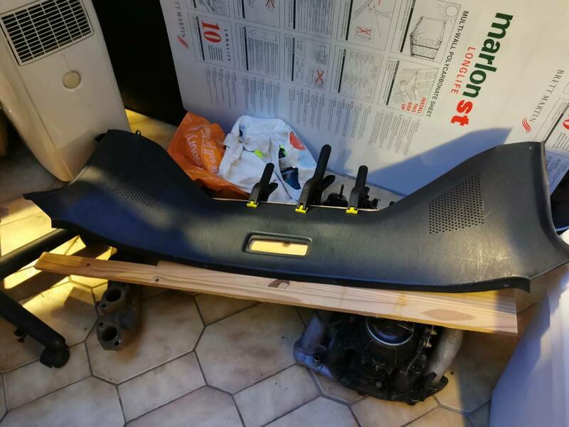

I'm trying the simple approach first, which has been to wet the fibreboard down thoroughly in the affected area and clamp it to more the shape I'm after.
Not holding my breath.  If that doesn't work I'll probably bend a piece of metal to the right arched shape and just bolt that to the back of it.  If the board will take the right shape though that would be the easier solution.

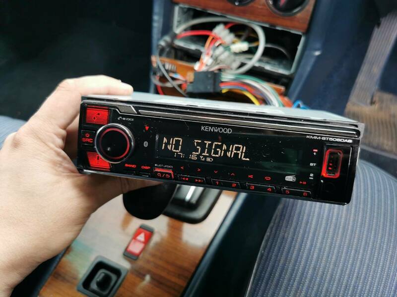

Little DAB antenna splitter gizmo arrived today.  Being me I couldn't let that tiny black box go without investigation.
A lot more in there than I was expecting.  Was just expecting some sort of band pass filter, wasn't expecting active circuitry.  Guessing this is necessary because it's using an antenna that's not designed for the purpose so additional amplification is needed...pure guess.
Pulled the head unit a bit further out this time while fitting it and had the joy that is finding prior audio wiring work that makes you scratch your head.
There's a lot of this going on.
Why they didn't just put that wiring into the white screw connector directly I have no idea...why connect another 2" long wire to it first by twisting the ends together?  This loom reaches about two feet out from the dash too so it's not like they were absolutely desperate for the extra length.
Also found the main 12V feed twisted together when they had an open position on their terminal block.
It's not pretty now, but all the taped and twisted together wires are now dispensed with.  I would have done this last time but didn't spot it as I never pulled the loom far enough out.
Unfortunately my satisfaction was short lived.
Apparently many DAB sets now use a tiny push fit antenna connection...so I need another adaptor to plug my adaptor in.  *Sigh*
So off to wait longer for something else to arrive.  Just put it back together for now.  Not really likely to really use DAB anyway.
Hard to tell in the photo but I've fine tuned the display colour a bit so it matches better.

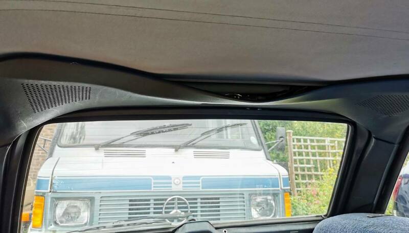

Edit: Forgot to say, it looks like the mission to de-sag the rear headlining trim is working.
Will probably get it refitted shortly as it will be a while before I get around to wiring in rear speakers as it'll be quite a time consuming job.
Before:
After:
Haven't bothered tucking it in at the edges as it will come out again to do the boot struts (if they ever arrive) and the speakers.  Not sure why folks claim getting the locating pegs back in is a massive pain...took me all of about 15 seconds.
It's not perfect if you look too closely, but is massively improved.  If it sags again I'll probably just stick a bit of metal across the back to add some strength to it.

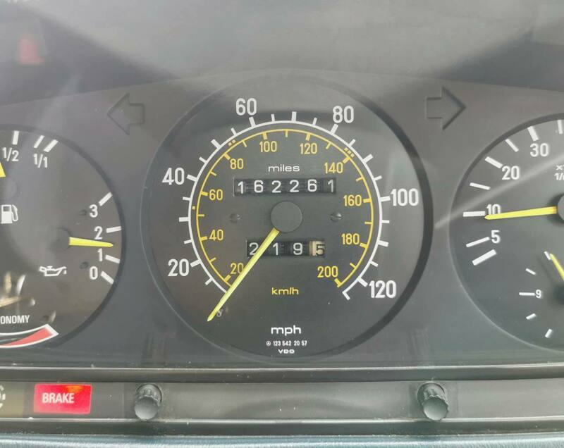

Have an odometer palindrome as I always enjoy catching those.

The adaptor I'd been waiting for to allow me to hook up the DAB antenna to the head unit turned up this morning.  This thing.
Like so.
Easy.  Right?
Well it should be!  If the stupid adaptor worked anyway!
The antenna works, the analogue/DAB splitter works, and this can be demonstrated by stuffing the connector straight into the back of the head unit.
Note the "DGTL" icon at the bottom of the display showing we're working from DAB rather than analogue.
Testing it with a meter shows that there is indeed no continuity through the centre pin.  It was a set of five assorted adaptors...of course the other four are fine.  Just the one I actually need that is stuffed.

This bit of trim was really bothering me.  Not just because it looks a mess but because it stuck out about an inch from the car and was just asking to stab a passer by.
Eventually I managed to "repair"  this channel (read: Squished with pliers) to the point I could reattach it to the trim clip so it sits flat again.
The "cap" which would have closed that off would originally have been part of the rubber part of the strip so is long gone.  My solution to that is probably going to be a bit of chemical metal...discovered the tube I had in my toolbox had turned solid so I couldn't do that today.

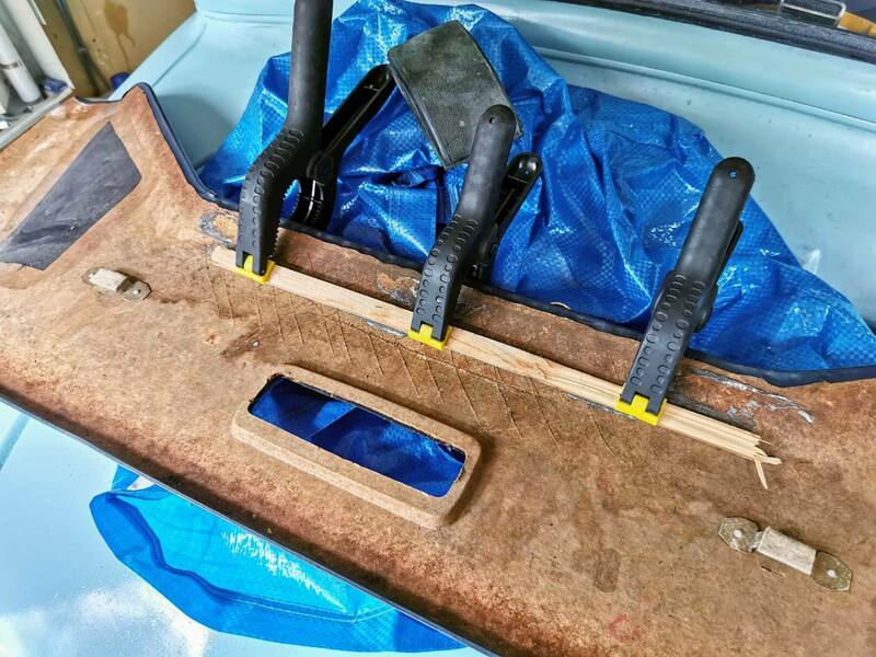

As I mentioned in my last post the headlining trim had done this again.
Next shot at providing this with some form of structural rigidity was going to be resin based along with a little batten.
I scored the surface to help it sink actually into the board.
Then mixed up a batch of quick setting resin and "liberally" painted it and left it for a few hours in the garage to set up.
Immediate impression is that it's far stronger... let's hope it stays that way!

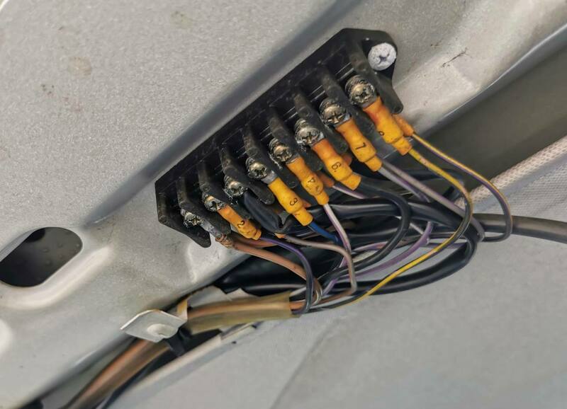

Was interested to find a major junction box for the wiring to the rear of the car above that panel.  I'm more used to seeing things like this on older commercial vehicles than on cars.
Nice to see all the wires are numbered.

The replacement for the dodgy DAB+ antenna adaptor for the stereo arrived this morning (I did look to see if I could get one locally, but the only place I could find one was Halfords - and they wanted £35 for a whole antenna kit, so eBay it was in the end), so I finally have a fully functioning stereo now with both analogue and digital modes working.
Even though I know I'll probably never really use it, knowing it didn't work was going to bug me!

A pretty major milestone was achieved for me today in that for the first time ever I have actually 3D printed a replacement part for one of my cars.
This (while it obviously still needs some finishing off and painting an appropriate colour) will be a replacement for the broken bonnet catch pull.
Yes I know proper replacements are about a fiver...but that's not the point.  I needed to replace it and I randomly stumbled across the model for this, and it's a pretty flat part so took less than an hour to print...so this was a far more interesting solution than just buying a new one.  Will clean that up, paint it and hopefully get it fitted tomorrow.

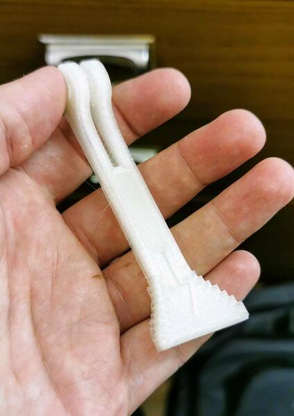

Last job for today (save for a leak check as I'd had the rocker cover off again) was to clean up and test fit the new bonnet release.
Rather less conspicuous than a cable tie sticking out of the grill.
Pops out when the bonnet is released from inside the car, and is far easier to get hold of than the aforementioned cable tie.
Now I know it fits properly and seems tough enough I'll paint it black so it is a bit less conspicuous.
Mission success.

3d printed parts like this will be the saviour of alot of old and middle aged cars I imagine!
Just open it with oily hands a few times, won't need to paint it black then...

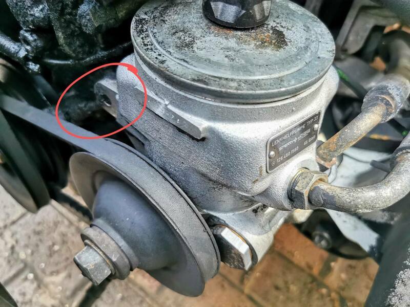

I have a sneaking suspicion that I may be missing a bolt on the power steering pump though.
I haven't changed that belt yet because the new one is the wrong size.  I'm not 100% certain there should be a bolt there...the pump is absolutely solidly mounted so it may just be a case of it having a few mounting options for different applications.

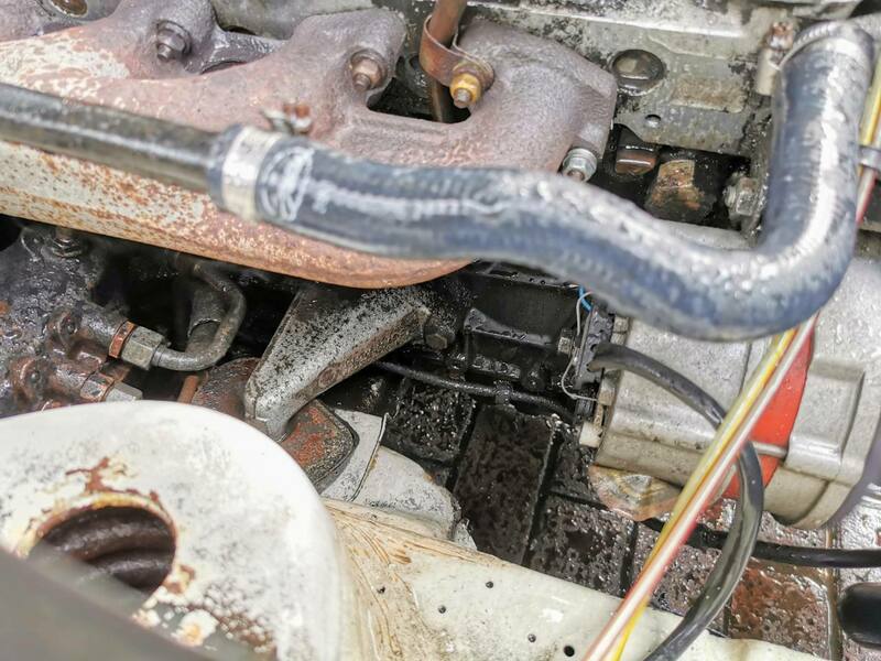

Really need to get back in to the front of the engine with the degreaser as I've obviously missed a fair amount there.

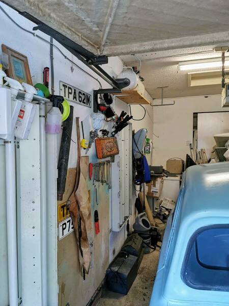

Nothing actually car related done today - though the garage got some attention.
The catalyst for this was knocking this pile of things over for the 39,349,291st time - as it happened basically every time I walked into the garage.
A wider angle "before" photo from a few months ago.
Cue making a godawful mess.
Then this is where we ended up when I ran out of time.
Much better.  This is the corner right by the door.
Shelving makes such a big difference.  There is still more to go up, but I ran out of time today.
Digging around I've ascertained that I *really* don't need to buy any more oil for a while.
The pile of junk at the back of the garage is going to need to wait for a bit as I need somewhere else to stack the cushions from the garden furniture before I can really start deconstructing that mess.
My plan is basically for two or three ranks of free standing shelves to go in widthways across the back of the garage...eventually.
Not sure if the result really reflects how many hours of work this took...but I'm glad I've made a start on it as this is something I've been trying to find the activation energy to make a start on for years.
At least I can walk past the car now!
The compressed air tank there is going to be wall mounted up above the garage door frame to keep it out of the way.  Having started this will give me a bit of a kick into getting that piped in... especially as I'm sick of not having air on tap any more.
It's a bit of a squeeze but the other side is also accessible.
Which is about the same as before...but the shelving now means squeezing through there no longer involves knocking over a couple of dozen bottles, cans and tools.

That's us ticked over the 2,000 mile mark.  Second one rolled around a lot quicker than the first.
