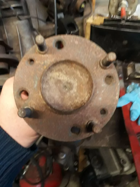

It looks like those are general purpose studs fitted into a redrilled fiat? Hub , the other unused wheel bolt holes may be on 98mm pcd with the 2 wheel locating peg holes, possibly fiat 500 wheels may bolt straight on with m12 wheel bolts but that's purely a guess !
The fact that Fiat 126 wheels bolt on rather than using studs (and that's where the trailing arm setup was sourced from) did make me wonder whether some of the existing holes might be for metric wheel bolts.
One of the smaller threaded holes is definitely metric - had a bolt in there earlier to help stop the hub rotating when I was trying to unscrew stuff.
it does rather look like they just took normal off the shelf Fiat 500/126 hub, and then drilled them for 4x100 studs after the fact
(I wonder what the 2 smaller holes are for?)
I'd have sworn that they would have been imperial thread but when you think about it, as they bought in the transmission, it's odds on that it will be metric.
Or is that the clue, the existing holes ARE metric, but that being British, they drilled and tapped imperial holes in the flange to take standard UK treaded studs, which to me, would make sense back on the 70's. And the small holes will be for holding on the drum in it's original application.
My suggestion would be get a set of metric wheel nuts thats the correct size and length, and a couple of small screws to hold the drum on.
As an aside, what size socket did they / you use to get the nuts off, and has it an imperial equivalent?

well the above picture is of (supposedly) a Model 70 hub, you can see the 4x100 studs like on TPA, but you can also see the 4 holes that would of been for the Fiat wheels plus the 2 smaller holes
The Gearbox was actually one of the few things on the Model 70 that was not brought in :) but the suspension/diff is all Fiat 500/126 bits

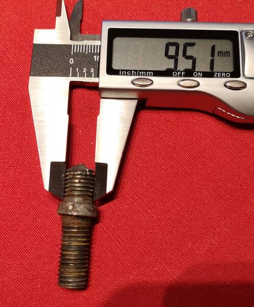

Looking at that pic again of sizes, bet the stud is 3/8 UNF (which would be 9.52 mm if it wasn't worn).
Really wish I still had my box of thread gauges.  They were one of those tools you didn't use hugely often, but saved biblical amounts of head scratching at times like this.
If incould just get away with using wheel bolts into the other holes that would be a hugely preferable option...will need to find out what the holes actually are and the spacing...
If I could use that it would save me a lot of faff as the mangled remains of that one stud could just be dealt with by attacking it with the grinder then...rather than messing around and probably to fail tapping it and wind up welding a nut to the thing and probably snapping it in the process...

I think the issue with using the other holes is that they are 4x98 I think where as the wheels on a Model 70 (and Mini etc) are 4x100
still worth checking tho :)
I was wondering however on that note, on the 4x100 holes, can you not just get rid of studs entirely and use bolts or is that not possible?
And I'd guess that's why they drilled and tapped the extra holes, to take a Mini wheel which would have been cheaper than buying Fiat wheels.
There's no reason why you cannot fit bolts instead of studs, BUT, you need the chamfer on them to be the same as the Mini wheels so they fit and hold the wheel on correctly.
I've fucked about with such a set up before, but I'm buggered if I can remember what shite it was on. Rootes?
the Model 70 actually originally used 12 inch wheels off, im not sure what to be honest!
a bit later after the Model 70 Mark B was introduced they moved to 10 inch Mini wheels, which have the same hole pattern as the 12 inch wheels, hence zel being able to put 10 inch wheels on TPA, an originally 12 inch wheel Model 70
(I had thought that the change from 12 to 10 inch wheels happened with the Model 70 Mark B, however there are pictures of Early Model 70 Mark Bs on 12 inch wheels, so im 100% sure when the change happened exactly)
(im not sure what size wheels the Fiat 500/Fiat 126 have But I dont think they where 12/10 inch hence why i imagine AC drilled the hubs for 4x100 studs/wheels)

Are you sure the holes in the hubs on model 70's are 100 mm pcd and not 101.6 mm?
Logically, to me, they should be the latter as that's 4" which when you consider when the mini was designed, in the late 50's, everything was imperial.
I've actually looked up old pcd info and the mini was 4", presumably 100 is a nice round number.

Right, Moss have come back and said they are 7/16 unf. That was their total response  (no lengths etc).
7/16 would be 11.11 mm.
3/8 and 7/16 are common sizes.
You need to check what's on the hub with an imperial tap unfortunately.
I reckon they're almost certainly going to be 3/8" given the dimensions of what came off - had a look at a slightly less mangled one with the micrometer...
Within 0.01mm of what I'd expect for 3/8" UNF...so that looks increasingly likely.
Obviously it should be pretty easy to check the thread with the correct tools too.  As mentioned above, I'll need to make a trip over to 6C/Mrs6C for that as the tap & die set I have is metric only.  Even if it is creepily close to a metric 0.75mm thread pitch...
