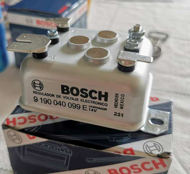

Which contained this.
Quick consultation with the workshop manual allowed me to confirm which wires go where.
Plus a trial fit showed the mounting bolts to be exactly the same as on the current regulator.
The only obvious difference is that three of the terminals on the new one require spade connectors whereas they're all horseshoe connectors bolted onto the original unit, so I'll need to re-terminate three of the lines.  I'll likely do the generator output one too unless it looks absolutely pristine.  There isn't much slack in this wiring so I don't want to go trimming ends off anything I don't have to though.
Interesting to see the new unit is made up of two distinct modules.
I'm guessing the smarts of the unit are in the lower bit and there are some chunky semiconductors mounted to the upper part which actually do the work.  Sadly in the absence of owning an X-ray machine that's as far as my examination can really go.

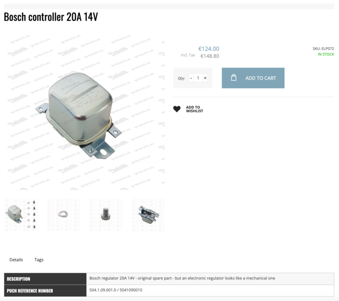

interesting stuff! I look forward to hearing how it works! I also wonder if its any different to this or if its just the same product? https://prokschi.at/bosch-regler-20a-14v.html
1232217865_Screenshot2023-02-18at14_23_28.thumb.png.5098a26fa19e7041981111c527eb1739.png
That's a slightly different version, and is the only 20A specific one I've seen.  Though given how these things work, I don't think it will do any harm being slightly overrated.  Assuming my understanding is right anyway.
If you're going for originality though that would be a better bet as it looks far closer to the original one and likely has the same wiring positions - I never spotted it originally as it's not specifically labelled there as an electronic controller aside from buried in the description.  Shame the cover isn't held down by the same screw as the original or you could potentially have transferred that over too to make it look less obviously new.
It's also about four times the price of what I bought...so I'm going to stick with this and see how it goes for now.
Installing the new regulator wasn't the worst job at all.  Bit fiddly but not hard.
As with any real electrical work, step 1 is to disconnect the battery and tuck the negative connection well out the way. The positive is also disconnected here as the isolator is also open. The only thing that bypasses that is the supply to the clock and only the clock, and that's got a 1A fuse on only a few inches from the battery.
I attacked everything in the vicinity with a bit of carb cleaner to try to get some of the near 50 years of gunge off the wiring so I could actually see what colours they were. Rather than black, black, black or slightly reddish black.
Quickly came to the conclusion that the generator output terminal was indeed going to want a new terminal fitted along with the rest, despite it being the correct style for the new unit.
Aside from those broken strands, I was very easily able to wiggle the wire around in this crimp - and that's meant to have been carrying the full output current from the generator.  Won't have been helping anything.
None of the connections looked exactly stellar really, though being only a few months short of 50 years old we can forgive that I think.
One extracted, crusty old regulator.
It was then a "simple" matter of dropping the new unit in, crimping some new terminals on and connecting everything up.
This was a slight pain on account of the new unit having the generator field and B+ terminal locations swapped, and the wiring being basically exactly long enough for the original.  Thankfully the generator loom is separate, so I was able to wriggle enough extra slack out of it to allow things to reach.  The output line is now a bit long, but I can easily sort that - I'd like to replace the inline fuse holder with a blade type anyway so would be a good opportunity to do that.  I know some folks will scream at their monitors at my replacing the glass fuses with blade types - but *none* of my local motor factors stock glass fuses in anything other than the 4A rating used in some old battery chargers, so I want to switch to blade fuses throughout so I don't get stranded somewhere because of a blown fuse.
It should be noted that while my crimping tool produces exceptionally scruffy looking crimps, in my experience they have always been absolutely reliable. Unlike the nice neat looking ones from three separate fancy ratcheting tools, including quite an expensive one, which I've had pull apart on several occasions.  So I stick with "scruffy but reliable." I'll be going back and putting some heat shrink over the joins to the terminals anyway.
Double, triple and quadruple checked my wiring matched the directions, and added a new direct link between the B+ terminal and the starter solenoid positive post that's more than rated to handle the full output current from the generator. The wiring from there to the battery has already long since been upgraded to something reasonably chunky as the originals that came with the car were both pretty well rotten and were skinnier than the lines from my cheap Halfords battery charger. Given the locked rotor amp rating for the starter is 300A, I imagine the original leads would have got a little toasty and dropped quite a few volts.
Needs tidying a bit, but it's installed.
The unnerving bit was of course reconnecting the battery and seeing if anything would smoke. Thankfully it didn't.
Of course the £43.50 question then would be once the engine was started, whether the generator would actually generate and if it would in fact be regulated in anything resembling a sane manner.
Previously at idle it would sit resolutely off charge, usually showing just under 12V on the gauge.  Now we see about 12.5V.  Wasn't expecting to see any output at idle so that's a bit of a bonus.
Pretty much as soon as you get above idle the voltage immediately jumps sharply up to a healthy 13.5V.
As the revs are brought up further it will creep up a little further to 14V on the dot.  Exactly as it should do.
Even better, the generator can actually keep up when the headlights are on, which it couldn't before. The general behaviour just looks far more reasonable.
Previously it would just about start generating appreciably above 2000rpm or so, with the voltage just creeping slowly upwards as the revs went up - to nearly 16V at 60 or so, can't remember exactly what that equates to, but somewhere around 4000rpm.

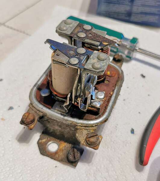

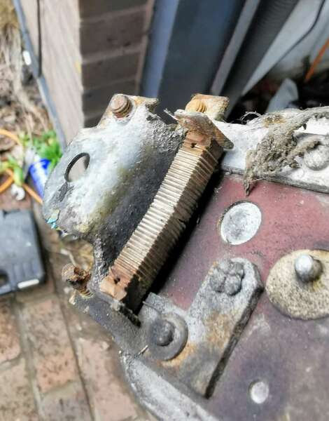

Of course with the new unit in and working, you know what this means...autopsy time!
Well the first obvious sign of issues with the old regulator is that the ballast resistor core has cracked. Though the actual wire *looks* intact. I've not checked it with a meter though.
The cover had obviously never been off because the wax seal over the screw head was still intact.
I was quite surprised when I pulled the cover off given the condition of the exterior.
A bit of moisture has obviously got in, but given the state of the exterior not anywhere near as much as I'd have expected.
Quite an impressive contraption. Though kind of redundant in these days of high power semiconductors really. I would be curious to compare the performance of a mechanical and electronic regulator in actual working order, though I imagine it's long term stability and efficiency where the electronic version will really win out.
Will be interesting to see how this behaves when actually driving, but static testing seems promising.

yeah! I was just wondering just a generic photo and if what would actually show up is what you have, as you say the description aint fantastic! but while googling about I also came across https://www.autoelectricsupplies.co.uk/product/707
which seems to list a few different amperage ratings and confirms they are solid state replacements which just look old style, still quite pricey sadly! but good to know what options are out there :) (I wonder why they even bother with different amperage ratings when the prices are all about the same anyway!)
having an over-rated 30A regulator is probably not a bad anything anyway, for when you get that massive sub-woofer installed in/under the seat :mrgreen:

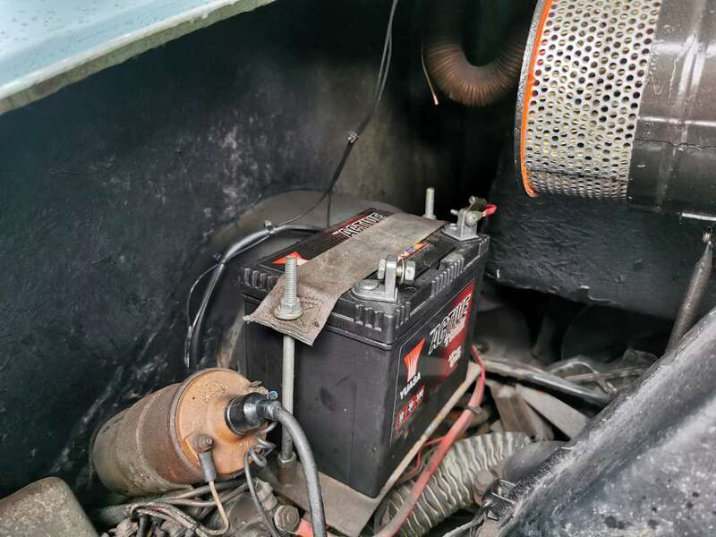

That hold down strap is a little to close to the positive terminal for my comfort.
Fair point, I'll scoot the battery forward a touch next time I'm in there.  Ideally the strap would be a bit narrower, but it's what I had handy.
3 minutes ago, High Jetter said:
Strap is fabric, though?
Yep, it's a strip of seatbelt.  If it got wet though it would become somewhat conductive - not enough to do any damage at only 12V, but if left for a while it could present a parasitic battery drain.  Comes more under the heading of "let's not tempt fate" more than "OMG that's dangerous!" to my mind.
Thanks for pointing that out, situation has now been improved.
That's about as good as it's going to get while keeping the battery fully on the tray.

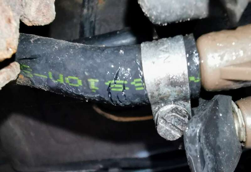

Car on the other hand had a different idea for how I should spend my afternoon.
Great!

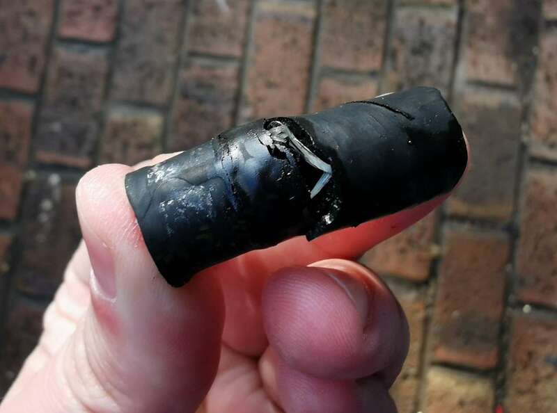

That is rather sub optimal.  Just figures as the one filter I've still got sitting in the boot waiting to change is the fuel filter!
The guilty party:
Yep, that would do it.
That hose was fitted in July last year according to the paperwork.
Completely aside from the fact it's dissolved away to nothing, it's just normal fuel hose - not high pressure rated for use on injection systems.  So shouldn't ever have been installed in this location anyway.  Yes, this was done by a garage.
Oh, no surprises this was holding the hose on at the filter end.
Naturally 8mm isn't a hose size I had in stock.  Cue a run round to Pirtek.
This should do nicely.
I think that should handle the ~50PSI or so this system runs at just fine.
Overkill?  Absolutely.  Do I care?  No.  Fuel systems are not something you cut corners dealing with.
All back together.  Only took 30-40 mins.
The jubilee clip was begrudgingly reused as I don't have a proper fuel hose clip to hand the right size - though it will be there precisely as long as the weekend when I'll be swapping out the fuel filter.  Doing that with the car on ramps though as I can't get at the outlet end with the car on the ground.

I've had a couple of people point out that this hose isn't likely long term ethanol safe. Which hacks me off having sought advice from a company whose whole existence is based around selling and making hoses.
My go to usually is ISO7840 A1 Marine grade hose as I *know* that is entirely ethanol safe (and resistant to basically anything short of a direct tactical nuclear strike). However that's not sadly something I can just drive five minutes to somewhere and buy...hence wandering round to Pirtek today.  Last two batches I ordered from online sources were blatantly fake rubbish.
My other choices locally are Halfords (X2) or Motorserv basically...who just have four year old loops of equally nameless hose as Halfords, bundled with the wrong type of hose clamps hanging on the back wall but for three times the price. I'll need to check what Top Gear down in Flitwick have to offer in the fuel line department, but even that's an hour and a half round trip - and today like many days I just didn't have time for that. I've had Bedford Battery recommended to me by many folks - but that's even further afield. I'd figured an actual fluid transfer specialist was a fairly safe local bet.
Have to admit that the nonsense surrounding fuel lines and trying to find what is actually ethanol safe and what isn't, then also sifting through what is fake and what isn't, is really the single set of factors which makes me want to most to just sack this hobby off once and for all and just buy a Tesla and be done with it. It doesn't seem to matter how much money you do or don't spend or how carefully you try to pick stuff out you still either get it wrong or wind up being sent rubbish.
The one which failed on me today by the way was labelled as SAE J30 R9 - which as far as my reading suggests, should be ethanol safe. Though it's blatantly obvious that the printing on that example means absolutely nothing.

I figured I'd have a nose around behind there to see if there was a convenient accessory feed I could tap into.
Uuh...
What's that big red wire taped together?
Guessing it's the feed to/from what used to be this relay socket.
Not entirely happy with that...the coil feeds are still present at the socket, so I think I may well need to reinstate that relay.  Not quite sure what it actually switches, given the size of the wires it must be something pretty major.  I'd rather have it switch off with the ignition properly.
Annoyingly nothing in the vicinity is switched on the accessory position.  Plenty of permanently live and ignition switched, but I'd really like to be able to use the stereo (which is available in that ignition position).  Even the fuse box which is right below doesn't offer much.
So I reckon splicing into the line coming from the ignition switch itself will probably be the easiest option.  Though will annoyingly require me to pull the cowling off again.
Not expecting a huge amount else going on this week, I've just about got to where I'd hoped to be on the to do list by the end of the weekend courtesy of a chronic fatigue flare up so I've got a lot of catching up to do.  Cars having to take a bit of a back seat for a few days.

Did finally get around to doing the oil and filter change on the Caddy which has been due for the last month and a bit.
While checking things over this badly perished bit of fuel line was also replaced.
The rest of the factory rubber lines could do with changing too as they're just starting to go - but that requires fighting with those spring type hose clamps which I definitely didn't have the patience for today.  I hate those things with a passion as they're just so fiddly, even if you do have the right tool.

Speaking of fuel pressure, the hose between the rail and the pressure regulator looks like it could well be original.  That will be "fun" to change given it's well and truly buried under the inlet manifold.  Thanks for reminding me of that.
Seems to be absolutely fine under load, just at idle and on very light throttle it's lumpy.  50mph motorway sections are particularly unpleasant currently.

No lambda sensors here.    Though checking the fuel pressure probably isn't a bad shout, especially as the fuel pump isn't exactly quiet.  I've never actually checked the CO level...quick check there.
