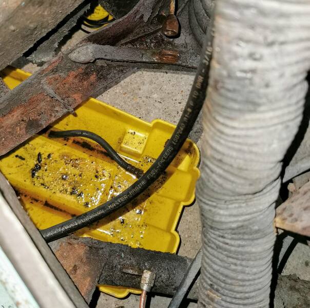

We're 50% done.
After nearly two hours of cursing I got the first hose off.
The retaining nuts fought me every step of the way.
At least this meant I could fully confirm the new parts matched.
Excellent.
Getting the new one on was merely "bloody awkward." Here's a before and after.
Doesn't that look better?  The hose isn't twisted, it's just slightly longer than the gap so bows out a bit.  The old one was just doing it towards the camera in the above photo so it's less obvious.
Still surprises those hoses show no signs of perishing, just crusty ferrules consigned them to the bin...and I'd probably still have changed then anyway for long term peace of mind.  You don't take chances with single circuit brakes.
Hopefully get the other side done tomorrow.

Let's finish the job we started yesterday.
It's still cold.
Somewhere down the line once the garage is actually sorted out I'll have to think about getting some heating installed.
Step 1...Do what I should have done yesterday and spend ten minutes taking the seat out.
Today this is the corner we're doing battle with.
The first retaining nut came off without too much bother.  Was still a bit of a struggle, but nothing too dire.
Of course the last one decided to be an absolute pain.  Not helped by having to do everything 1/32 of a turn at a time and access precluding getting any serious leverage involved.
If I hadn't managed to wedge that one spanner against the chassis rail I reckon I'd probably still be there.
It felt like a LOT more than an hour and a half later when we finally had the old hose out.
Getting the new one in was only made slightly more awkward by virtue of the fact that the flare on the line to the wheel cylinder wouldn't spin on the pipe so I had to screw the pipe onto the union rather than the other way around.
By this point I could barely stand from my legs and back cramping so I called it a day.  Jobs for tomorrow will be to bleed the brakes, adjust the handbrake, clip all the lines back into place and do a VERY thorough leak check.  While I have the seat out there are a couple of minor jobs in that area I might attend to at the same time.  Looks like I might have a very slight blow from one exhaust to inlet manifold gasket, or it could just be a bit of dirt...I'll look more closely tomorrow.  I'd like to attach that fuel line to the chassis rail to keep it from sitting and rubbing against the top of the engine mounting cradle too.
I'm thoroughly glad that these hoses are fitted now...Not a job I want to do again!  Such a simple job made a million times more awkward because of the positions that you have to contort yourself into to get to anything.
