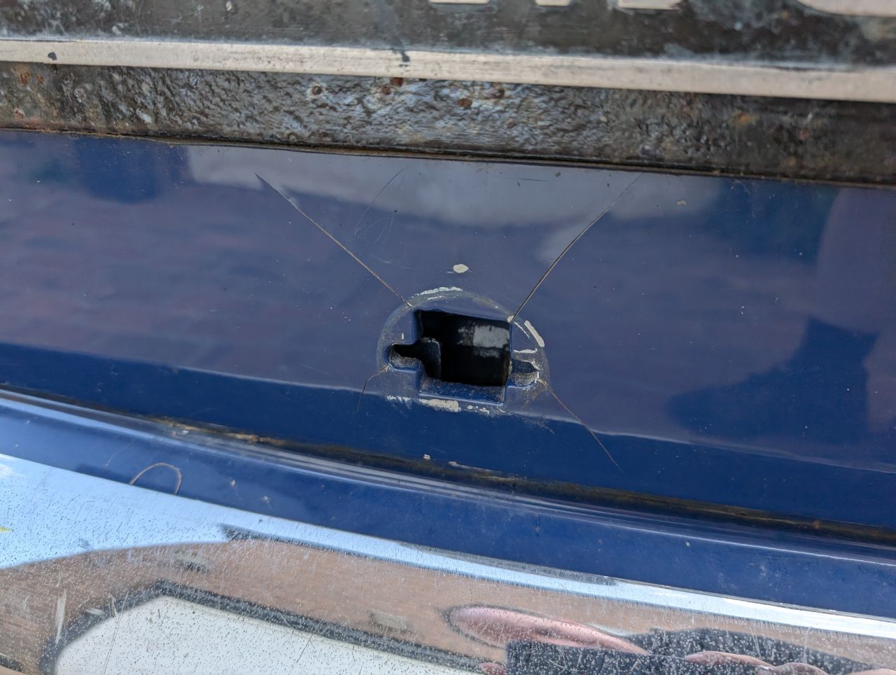

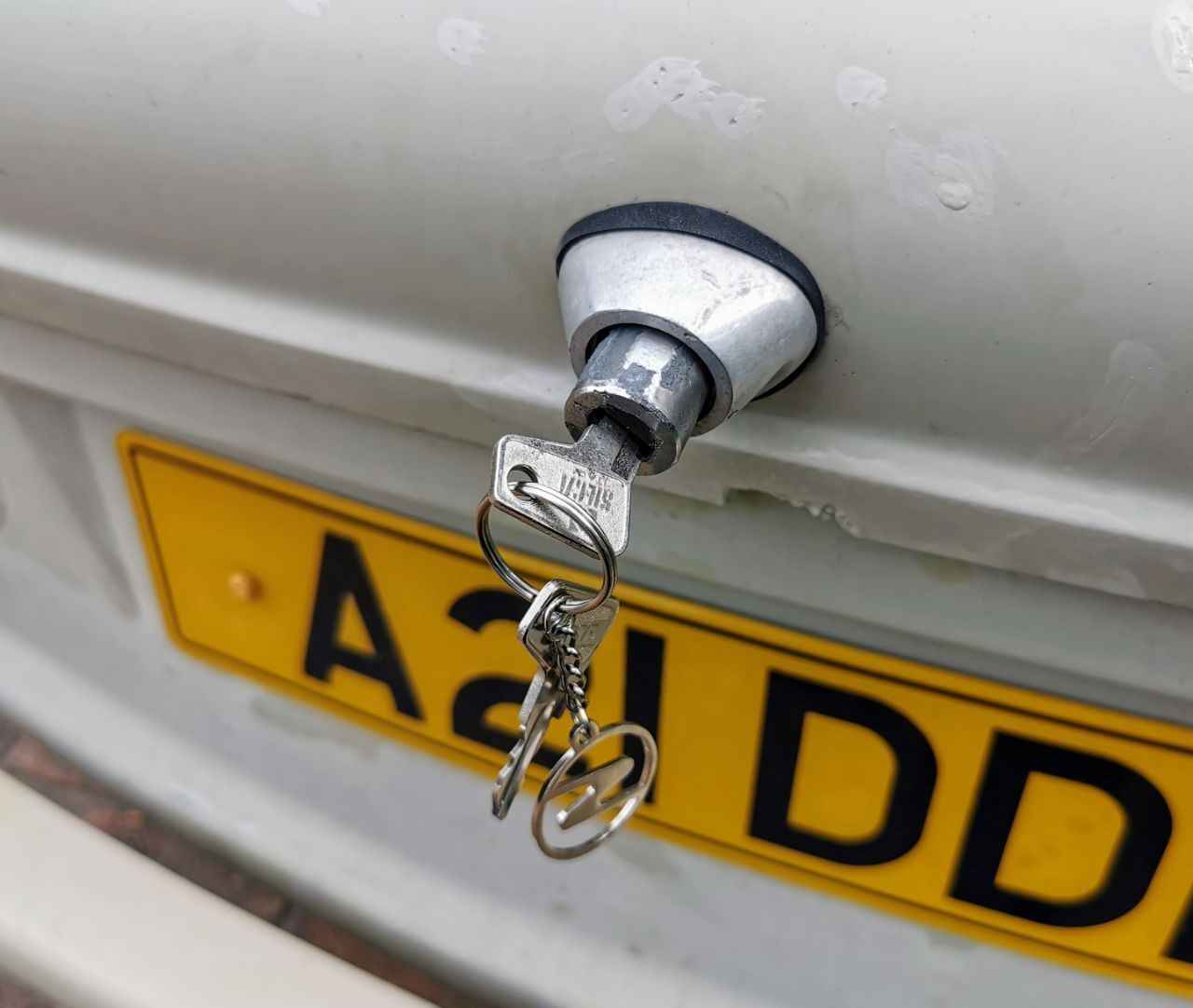

This afternoon I got stuck into fixing something which hasn't worked in as long as I've had the car and get the impression has been like that for a long time.
Yep, the boot now actually locks.  It is still a bit finicky as the lock barrel is quite worn but it does lock now.  Which is kinda a nice quality of life improvement you know being able to keep the casually curious from opening it.  I do wonder if it jammed up some point in the past and that's why there's a chunk of the bootlid missing from where someone forced the latch.

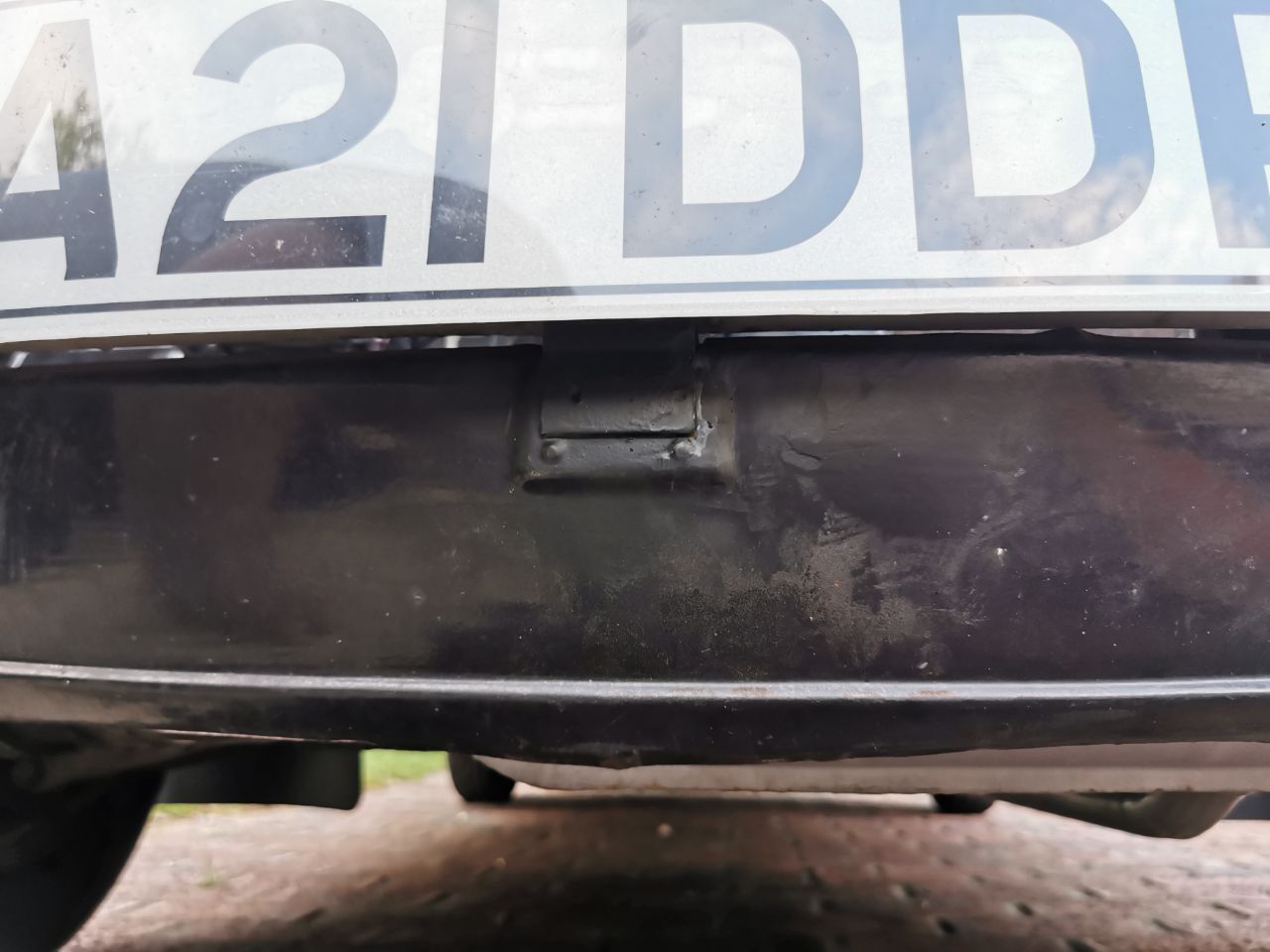

Every car has something (or several somethings) stupidly simple made maddeningly awkward because the car is in the way.  On the Trabant the two I've come across are the inboard exhaust manifold to downpipe bolt, and most recently the centre air dam mounting bolt.
It lives behind where that little square thing under the number plate.
If you're smart you attach this before installing the bumper I guess...however I didn't feel like removing the bumper, carb or exhaust expansion chamber to make access easier.  I just opted for swearing at it for half an hour while trying to avoid eating the air dam itself to replace the middle bolt which ejected itself somewhere between here and Birmingham.
In fairness it's still about a 3/10 in the grand scheme of things.
It may have been annoyingly fiddly but the missing bolt has now been replaced, which has resolved the godawful buzzing from up front again.  When that started to get loose it produced an initially unknown metallic rattle from up front, which seemed worse when under power - suffice to say that initially cause some concern until I discovered it was in fact something innocuous.  Ah, the joys of using old cars!

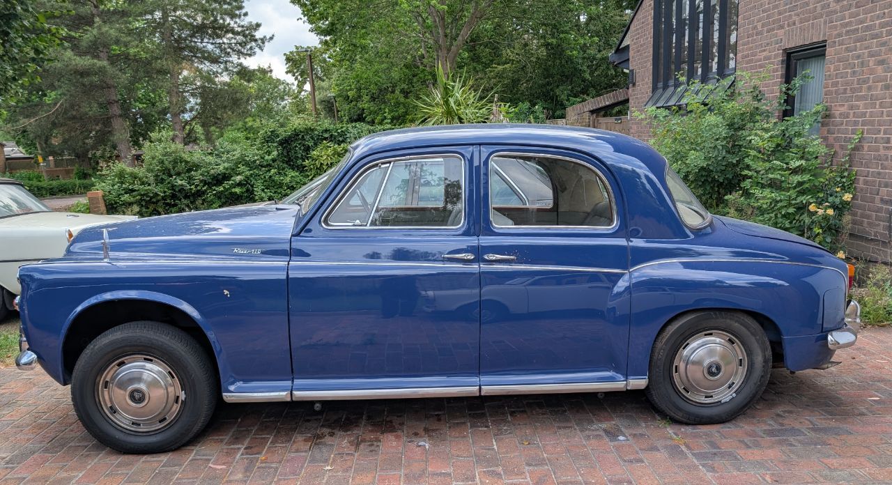

I'm sure that this particular arrival will surprise very few of you to be honest.
Looks stunning, I wish mine was as tidy
  • Agree 1
1 hour ago, Zelandeth said:
Sorry, also entertaining guests this week so trying to juggle a lot of things!

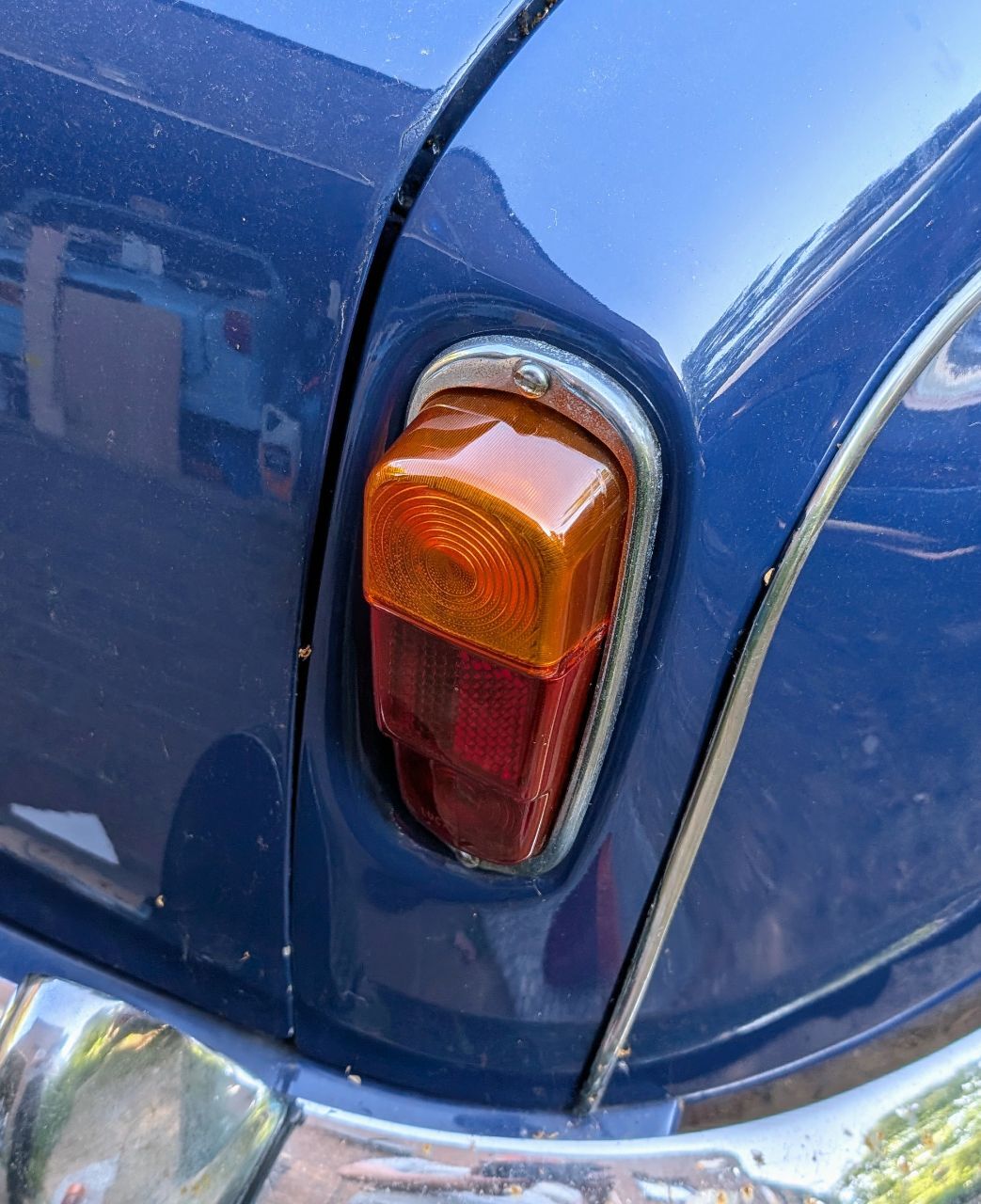

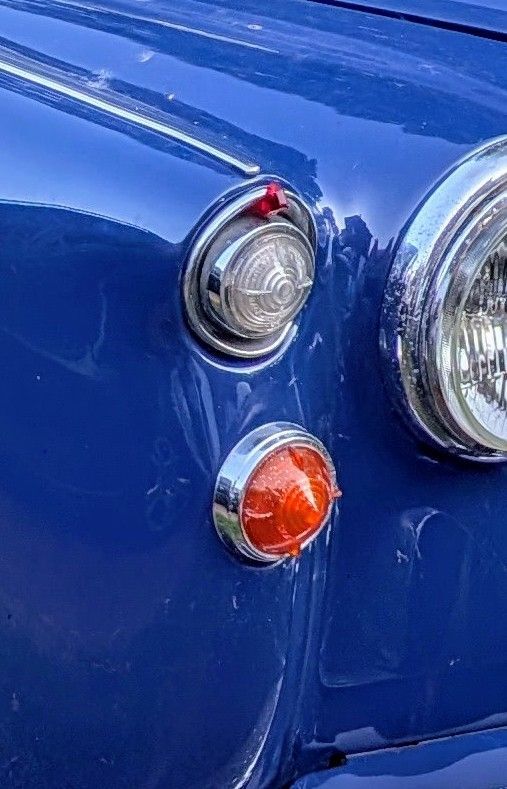

Indicator/side lights.
They're the other way around between the two cars and the older car has little red light pipes at the top that the later one doesn't.

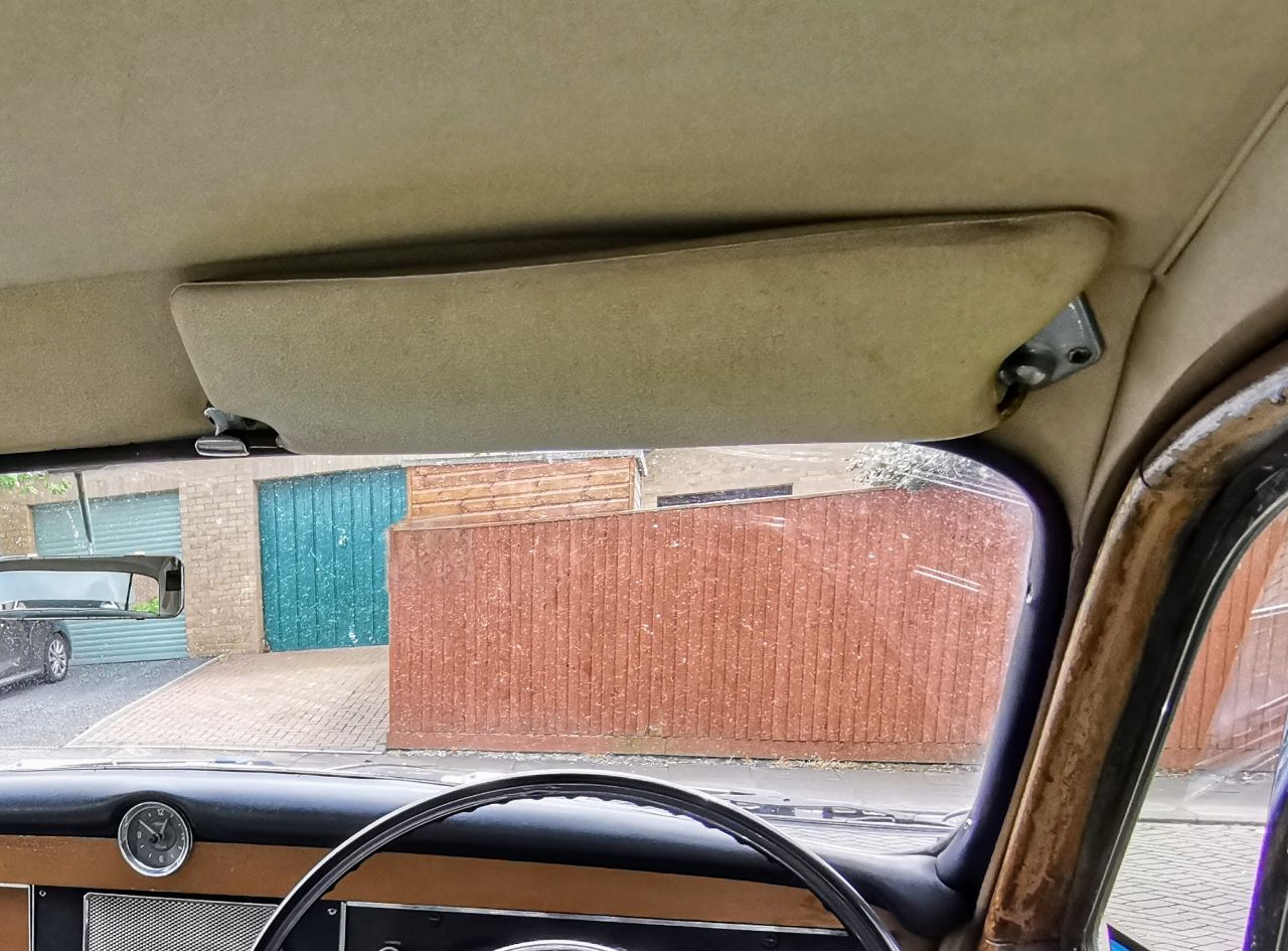

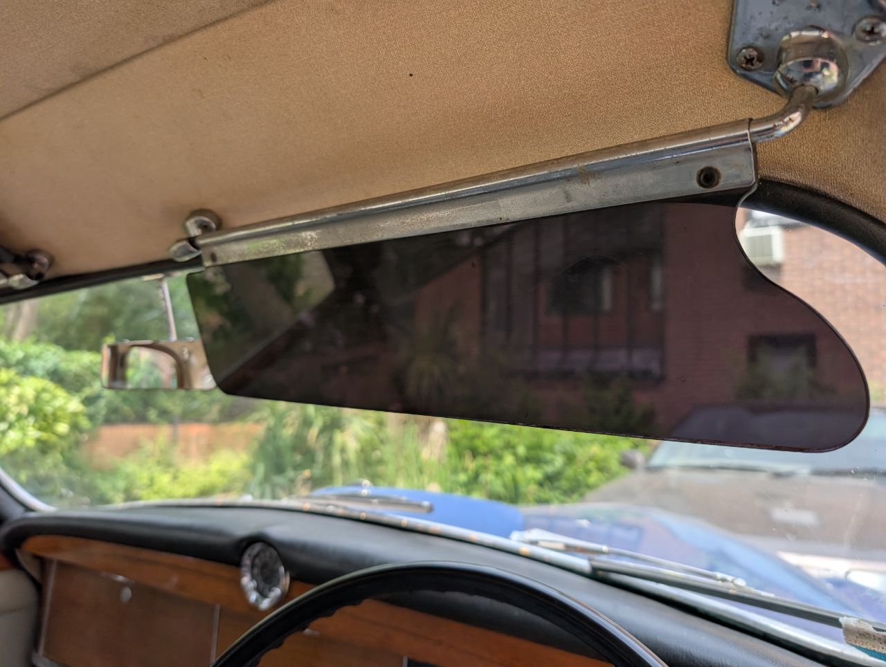

Sun visors.
The ones on the earlier car are tinted plastic (acrylic?) rather than the more conventional modern style ones used later.
62:
63:

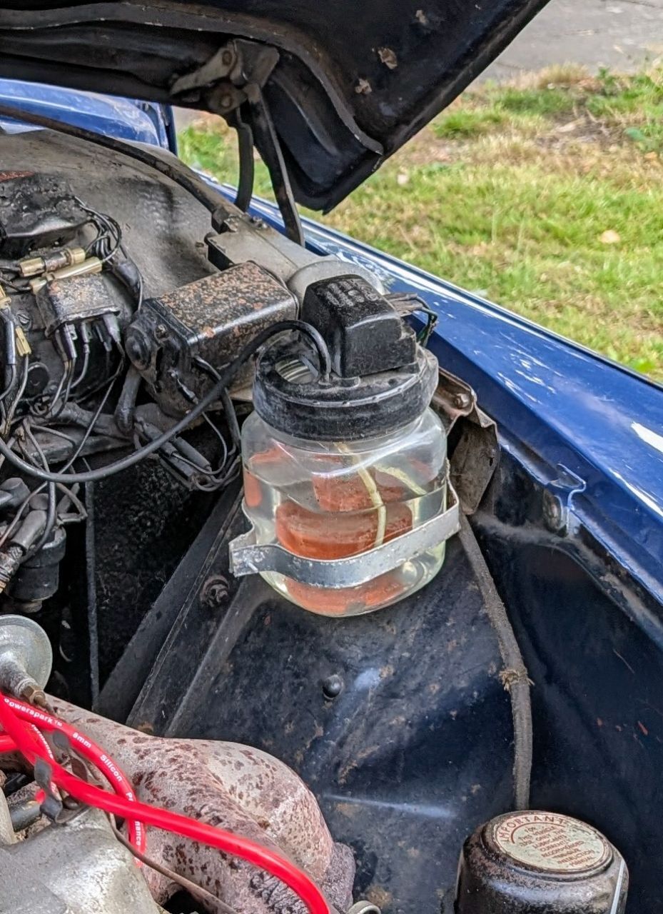

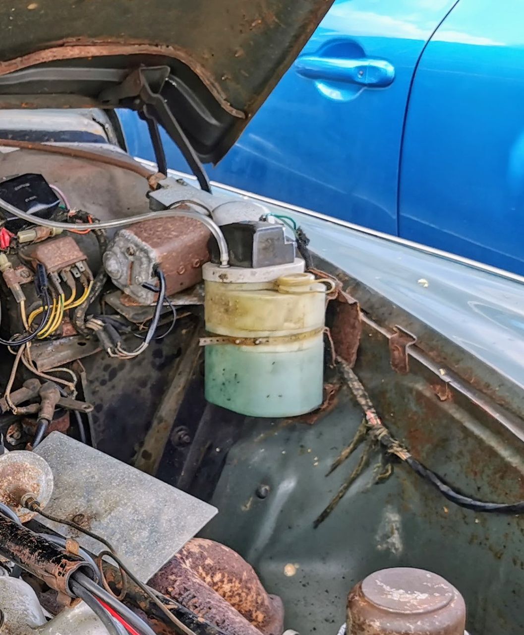

Windscreen washer bottle.  Seems to have changed from glass to plastic.
62:
63:
Could see things like that being some element of production line simplification and cost cutting given that by the time my 63 version was made I imagine that production would have been starting to ramp down quite a bit, with resources being ever more shunted towards keeping up with orders for the P6.

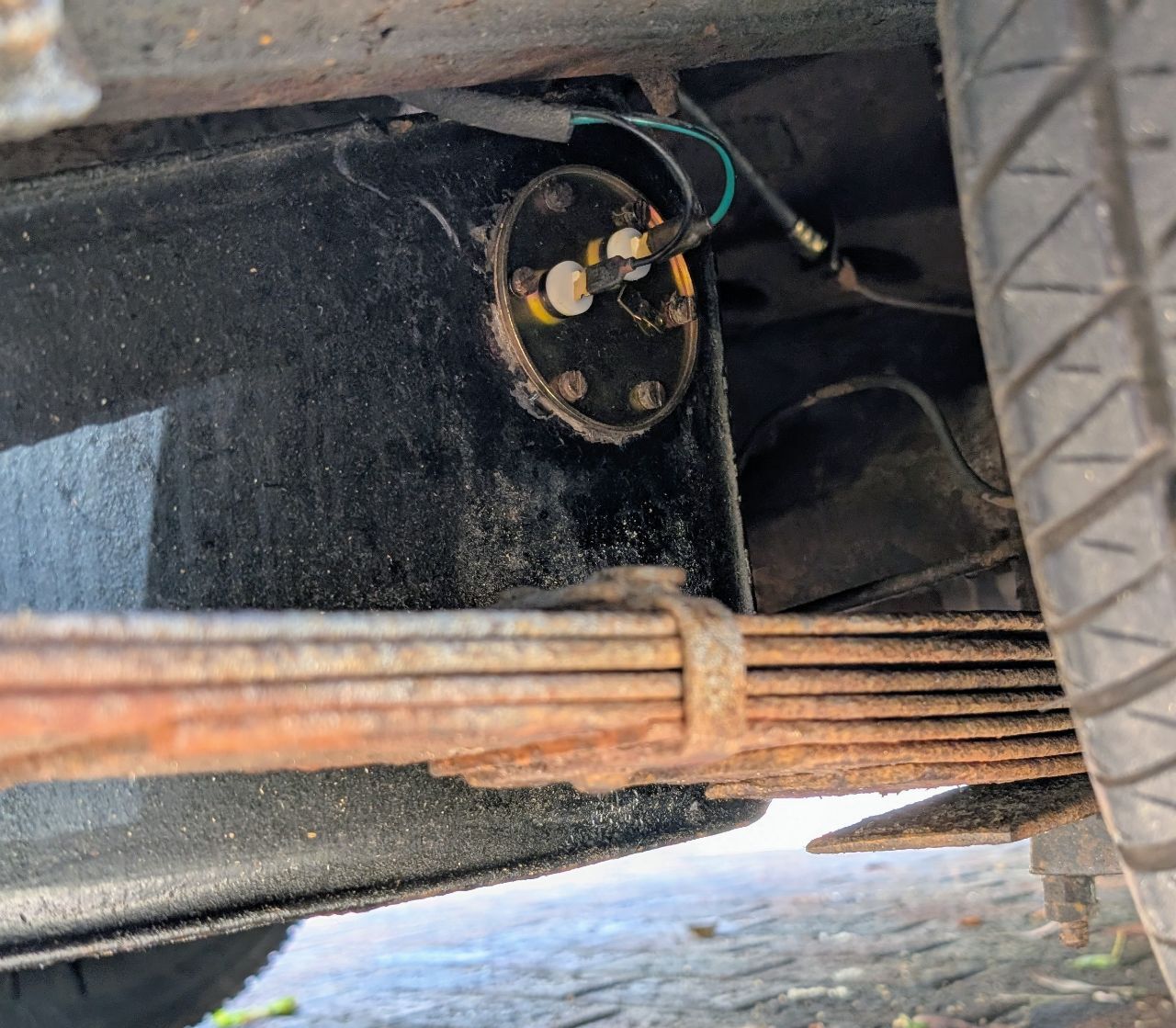

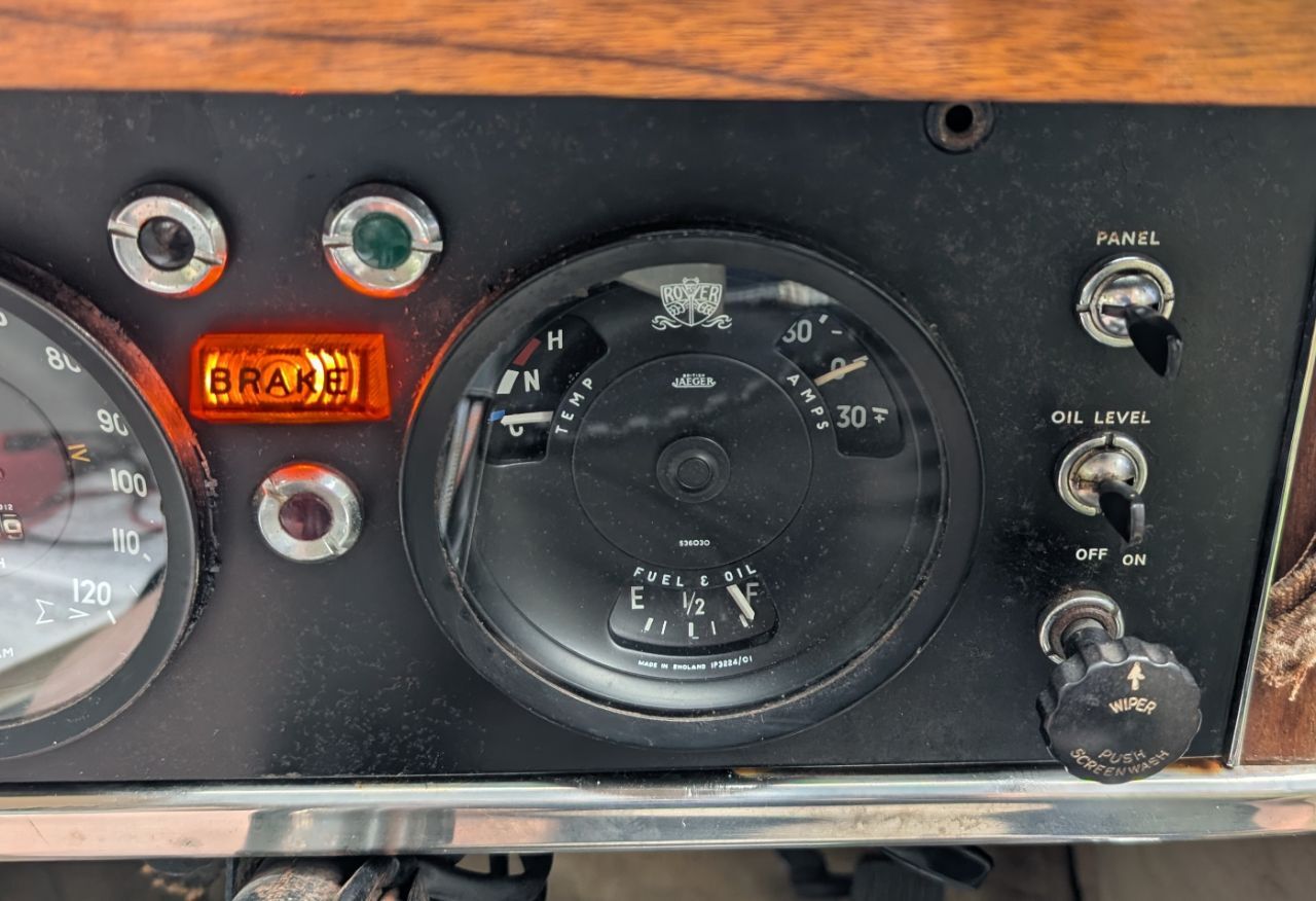

Already known is that the fuel gauge isn't working - though I've not yet investigated whether this is strictly an issue with the guage itself, wiring to the tank or if changes are needed to account for the car having been converted to negative earth (will depend whether it's a thermal or moving coil/iron gauge).  I should try the oil level check switch as seeing if there's any movement there might at least suggest if the thing is getting power.

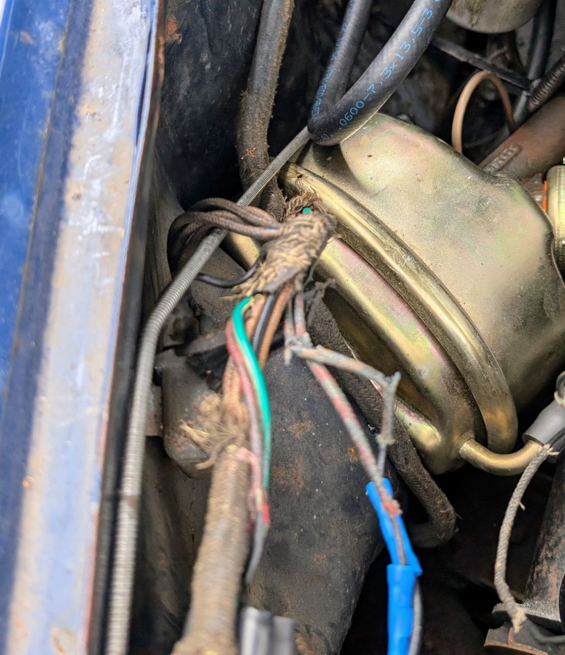

Brake warning light doesn't work.  Suspicious looking stray wires in that vicinity - and I know for a fact that one of the terminals on the reservoir should have two on it as that's where the power is spurred off for the handbrake switch as well as the level sender.

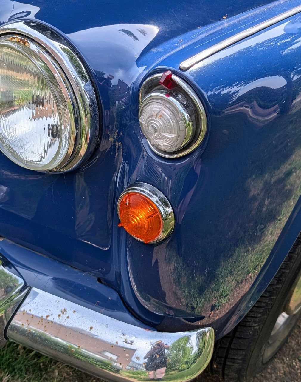

Are those small red tips like the ‘sighters’ that you sometimes see on US land yachts from the 70s?
I believe their purpose is to reflect back a bit of light from the side lights to make judging where the front of the car is after dark easier.  P6 has them actually moulded into the lenses (and usually broken off).
US '70s ones like Cadillac are often fibre optic linked to lights and are a bulb failure warning - I always liked the ones on the P6 :)

Does anyone know what this colour is - if indeed it is even a Rover colour?
Whether more recent or in period with the car I doubt this was the original colour.
I'm assuming that the original was a significantly darker blue given that this is visible in a few areas like on the door hinges.

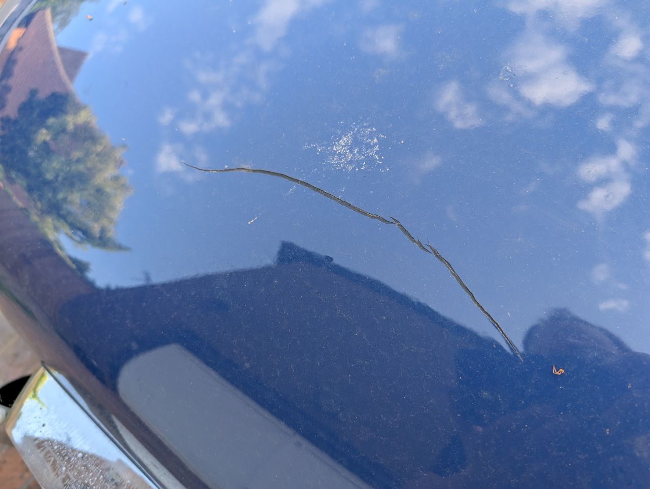

Kinda rolling my eyes that someone went to the lengths of taking the door off for the respray but didn't change the worn hinge pins while it was off the car.  Admittedly though given this car has been through a bereavement sale it's quite likely that Ill health stopped the restoration in it's tracks so maybe easier to understand.  *Adds hinge pins to shopping list*
Just know that at some point I'm going to need to do touch ups (and possibly get the boot lid repainted as the paint appears to have reacted and shrunk badly) somewhere down the line so having at least some idea what colour it is would definitely be helpful.  Is a shame about the boot lid as the paint otherwise really does look pretty decent.
It's not exactly urgent but getting that tidied up definitely would be nice to have done properly.
My '59 has indicators at the top, but you've got your fancy red sidelight bits which surely need to be at the top to be visible?

I thought it seemed a little on the vibrant side for this class of car in period, but in my opinion really does suit the car.
The ride height seems to be a common issue.  The rear springs sag when they get old and lose their temper.  Conversely the front springs work harden so get stiffer - so the front ends up sitting high and the rear sags.  Assuming I don't find any major horrors when getting stuck into this I may well treat it to a full set of new springs as I imagine that would really transform the ride.  This one isn't as bad as my previous car where there basically was zero rear suspension.  This one does at least move when you try to bounce the car.
  • Zelandeth changed the title to Zel's Motoring Adventures...Volvo, Renault, Rovers, Trabant, Invacar & A Sinclair C5 - Updated 22/06...New Arrival!
Actually, now I think about it, it doesn't look a million miles from BMC Teal Blue. I know it is impossible to tell from photos, especially digital ones, but this is my old Wolseley Six.

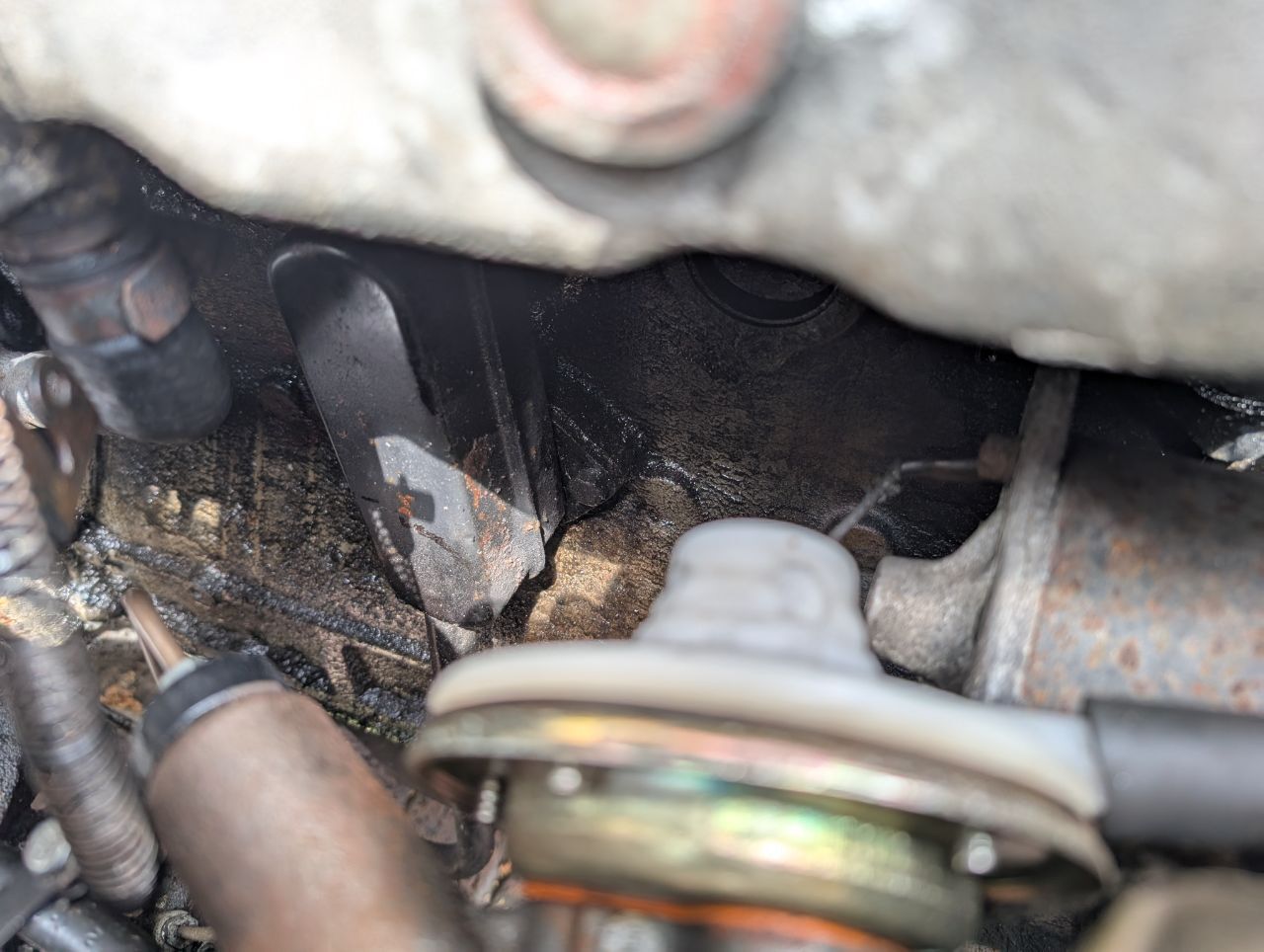

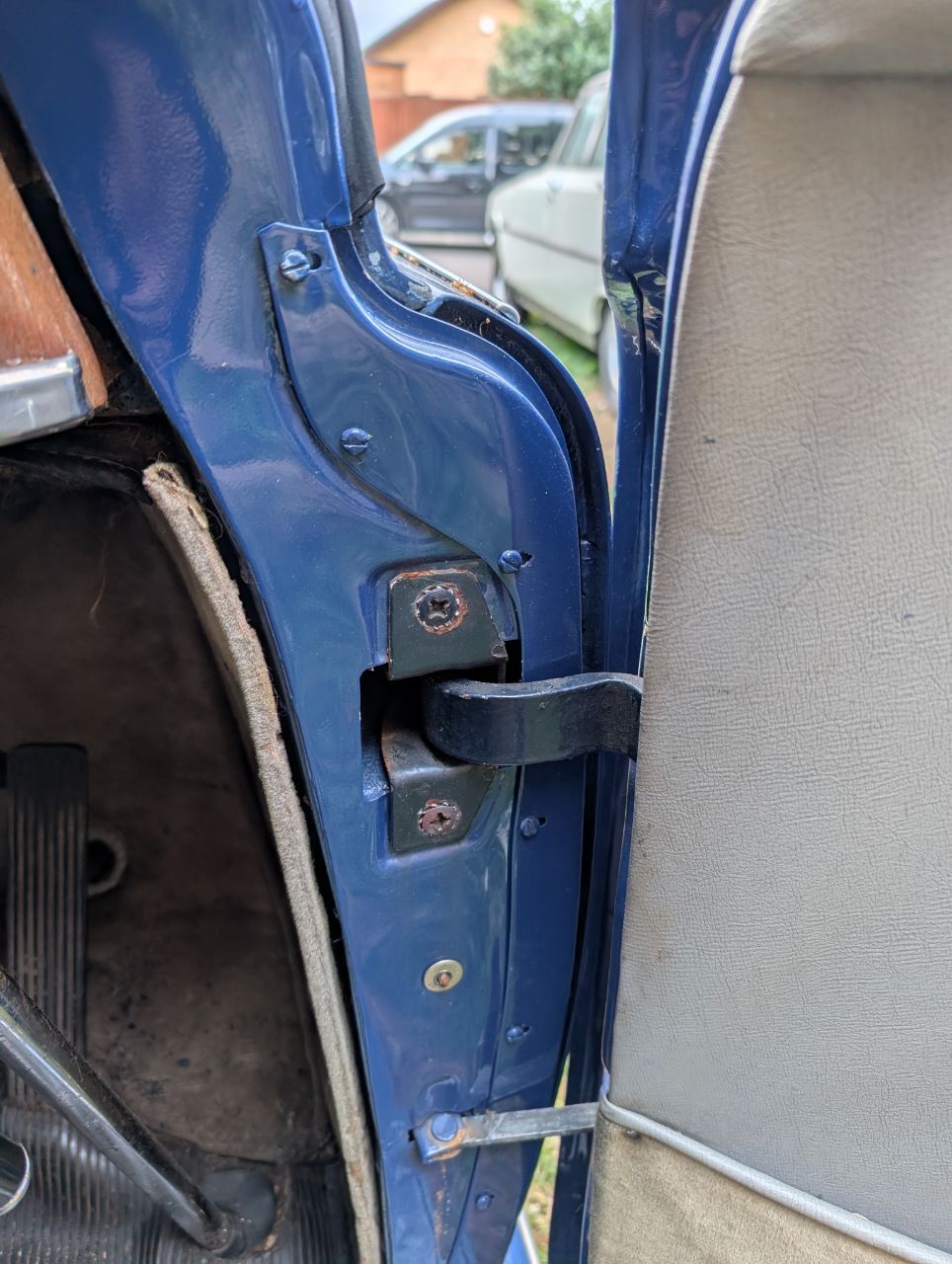

Hmm.  I think I'll need to resecure this window guide.
I had noticed when backing it into this corner that there was a definite rattle from the exhaust.
Ah, yes this would explain that.

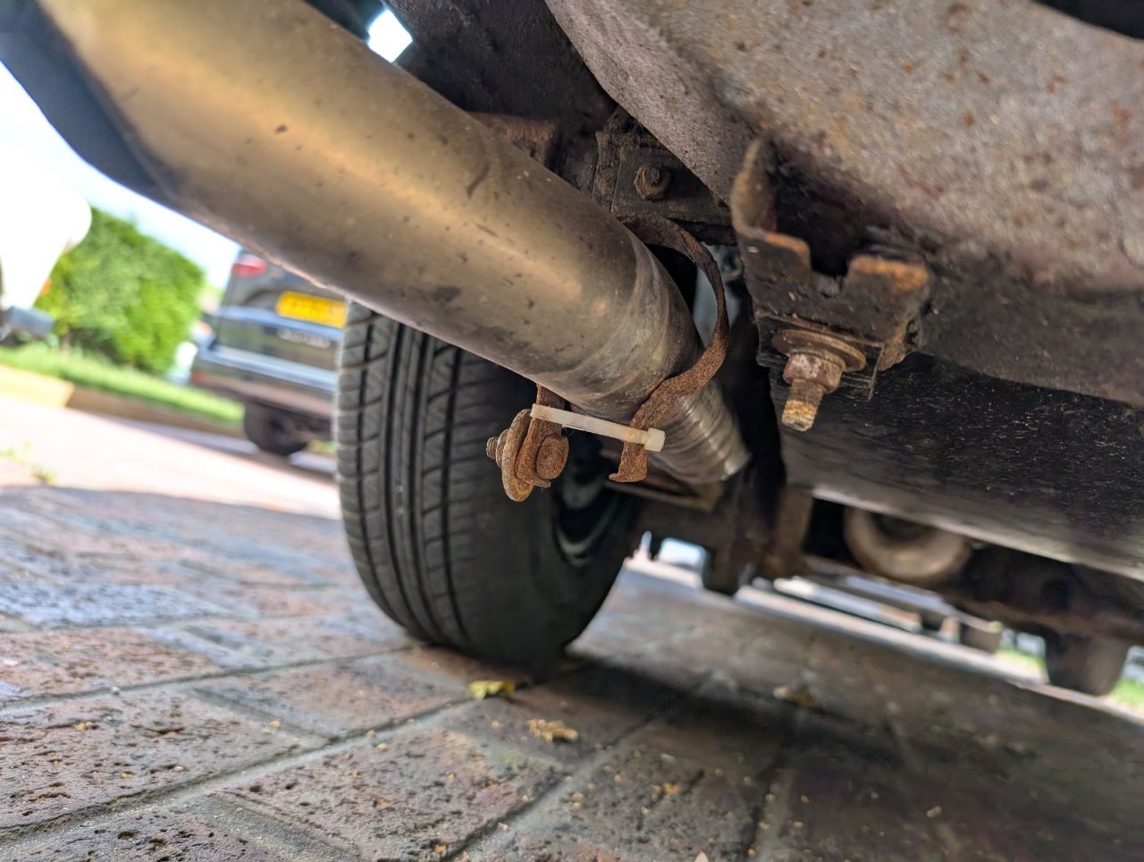

Looks at a glance to be stainless, at least the mid and rear sections.  At least that was easily resolved.
Bolt is too long, but it was what I had to hand.

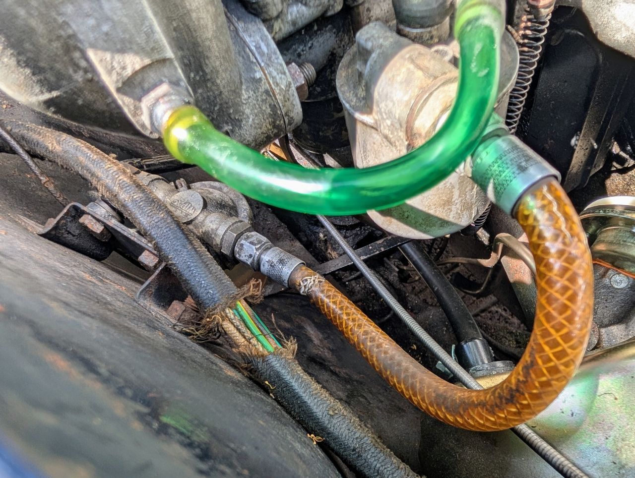

I wanted to check to see if the float switch in the brake fluid reservoir was working.  Given that this car only has single circuit brakes I am considering this to be a very safety critical component.  Lifting the lid brought the warning light on so that at least is good news.
I can't at a glance see the line that goes to the handbrake switch, I'll need to crawl underneath and see if I can find that.  That's more for my OCD though, it's the fluid level indicator that's actually safety critical.

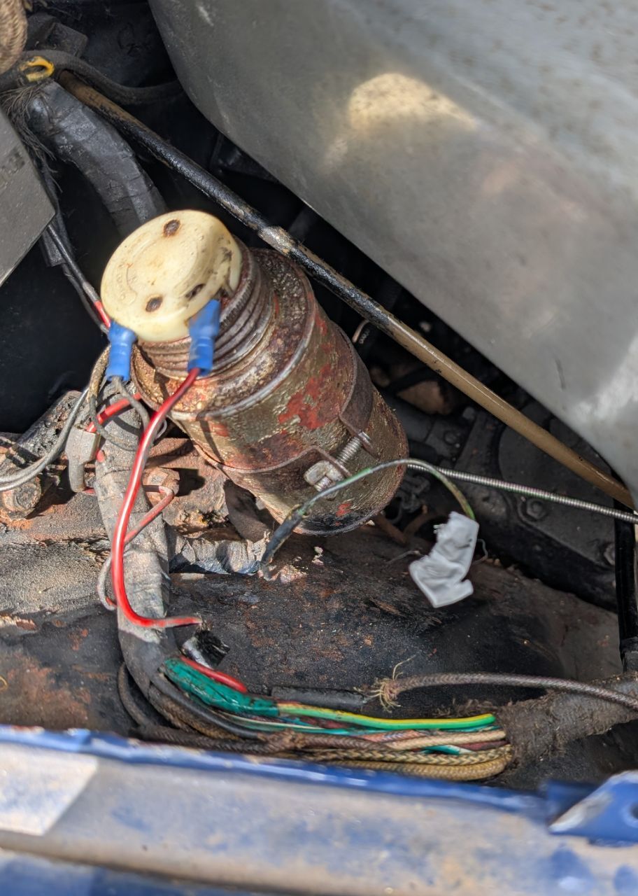

Speaking of safety critical I've stuck some tape on the end of that wire floating around by the brake fluid reservoir and a couple of bits on the other side where they had chafed and metal was showing.  This isn't a permanent fix (yes that's just duct tape) but at least vastly reduces the odds of things shorting out in the short term.  The bare wire by the brake fluid reservoir was indeed an ignition switched live.
There should be clips on the sides of the bonnet aperture for the main looms to clip onto, these seem to be missing here, presumably not refitted after the paint was done.  Will need to get something done about that.

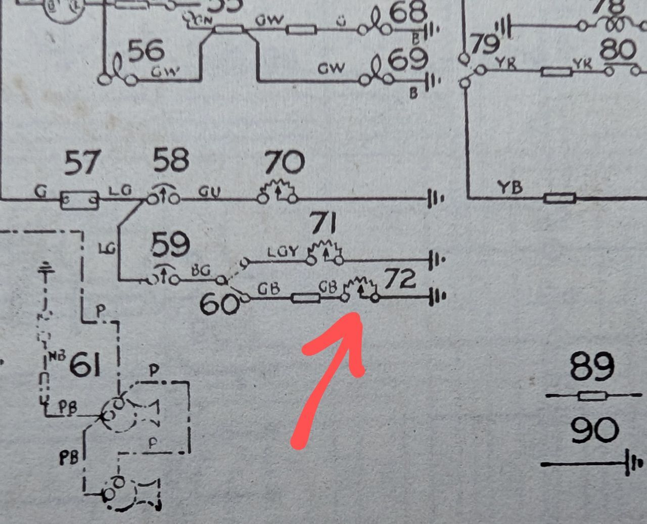

The fuel gauge gremlin needs more research.  There is power to the gauge as when you switch it to oil level check the gauge wakes up and reads off scale high.
As the power for both of these modes comes from the same source that tells me that the issue is likely with either the sender of wiring to it (or maybe the tank itself not being grounded?).  Though there is also something amiss with the level sender it seems for the oil level as it's showing off scale full when it's actually a bit low.

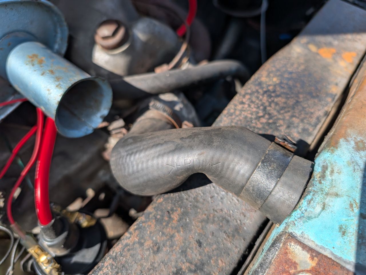

Discovered that someone has at some point fitted the wrong thermostat housing.  This is why the top radiator hose is squashed like this.
The correct housing for the 110 has the hose stub pointing straight up.  This won't be doing coolant flow any favours.  Correct one has now been ordered.

Iirc 850AVB fuel sender was seized at the bottom. Removal, pulling apart to clean and a lot of WD40 got it moving again. Presumably these just seize up/stick when a tank level doesn't change for years. Wasn't terribly hard to remove it.
First box of goodies has arrived.
Let the improvements commence.
Before and after for then first new bit fitted.

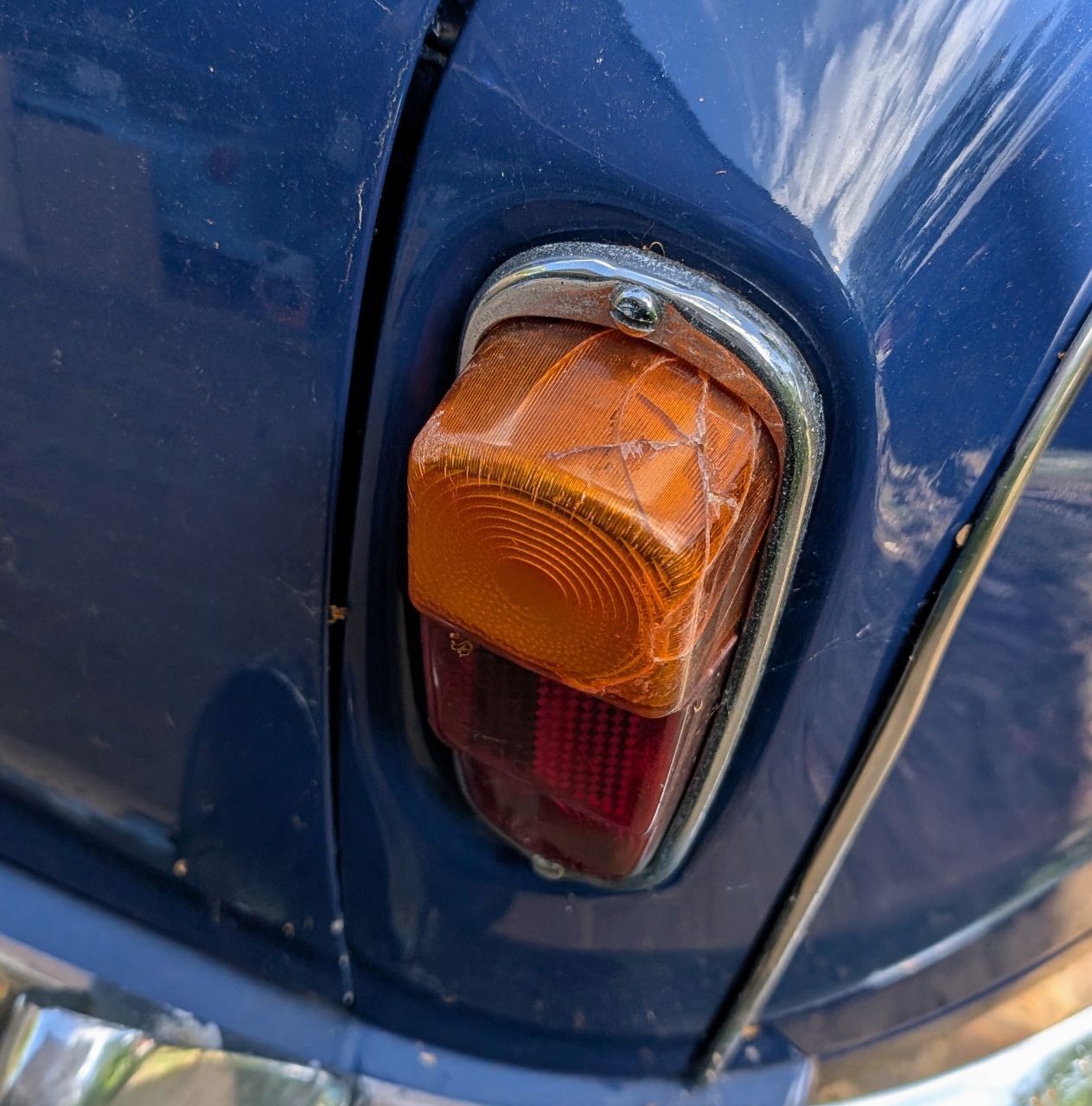

Reason for the new badge is pretty obvious.
Quality of the moulding isn't anywhere near as good as the original, but you're never going to notice that unless you had them side to side.  Not being cloudy and all crazed will make the front of the car look a lot tidier at a glance.
Apparently I need to clean the carb needle/seat given that it decided to start dumping fuel when I turned the ignition on.
Given I need to change that fuel line between the sediment bowl and the carb anyway I'll give it a clean at the same time.
I did a little further investigation into the fuel gauge issue, and it looks like we do have a wiring issue.  There's power at the gauge but it's not getting to the sender on the tank.
Guess I'll need to track down where the loom runs and looking for damage then.
I think a good clean of the interior is probably worth doing.  The instrument panel definitely looks better for a bit of glass cleaner.
Given it's getting stupid hot again tomorrow not likely to be anything groundbreaking going on.
  • Zelandeth changed the title to Zel's Motoring Adventures...Volvo, Renault, Rovers, Trabant, Invacar & A Sinclair C5 - Updated 24/06.
Today was another "cram a couple of minutes in here and there between a thousand other boring tasks" day.

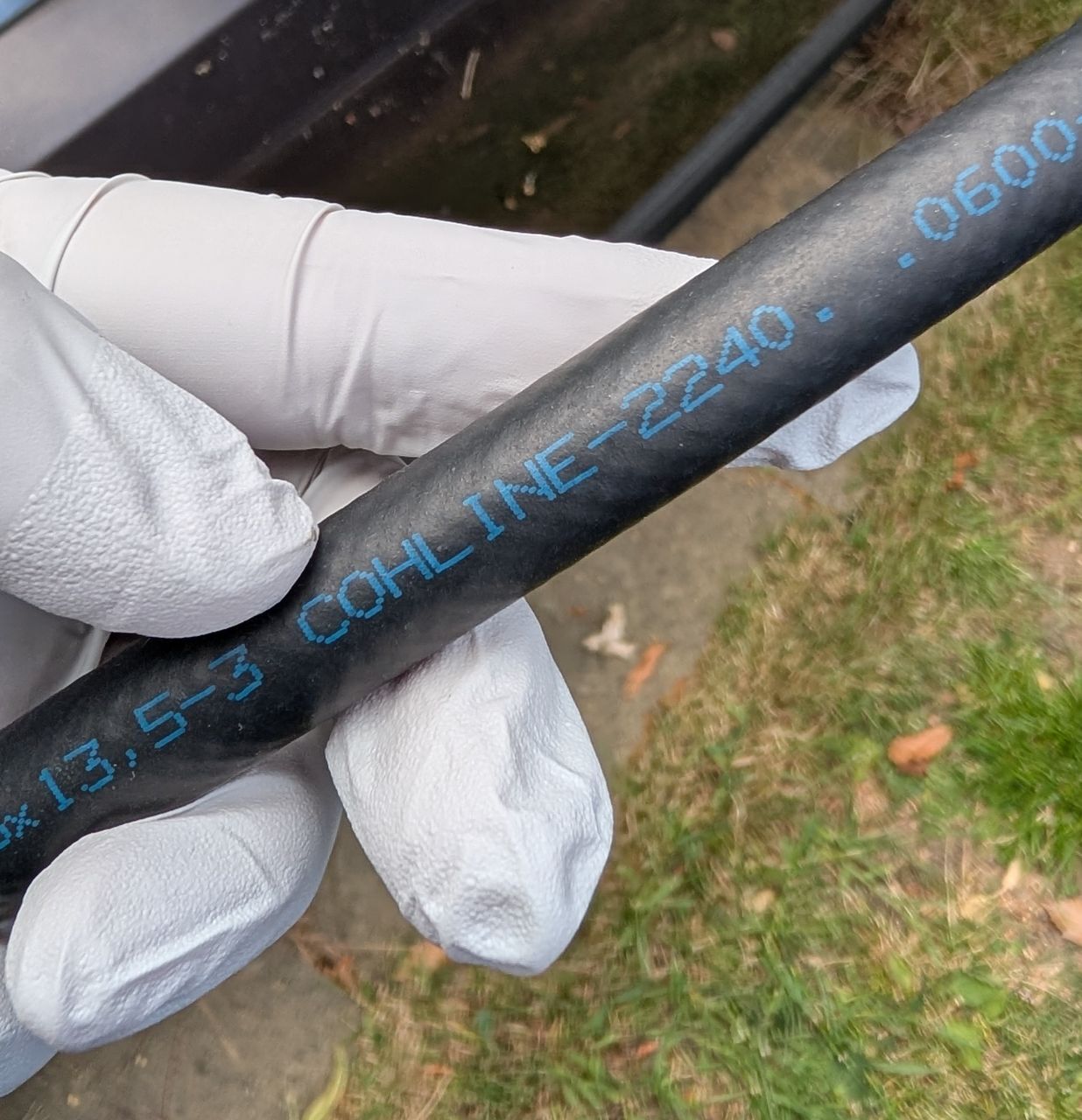

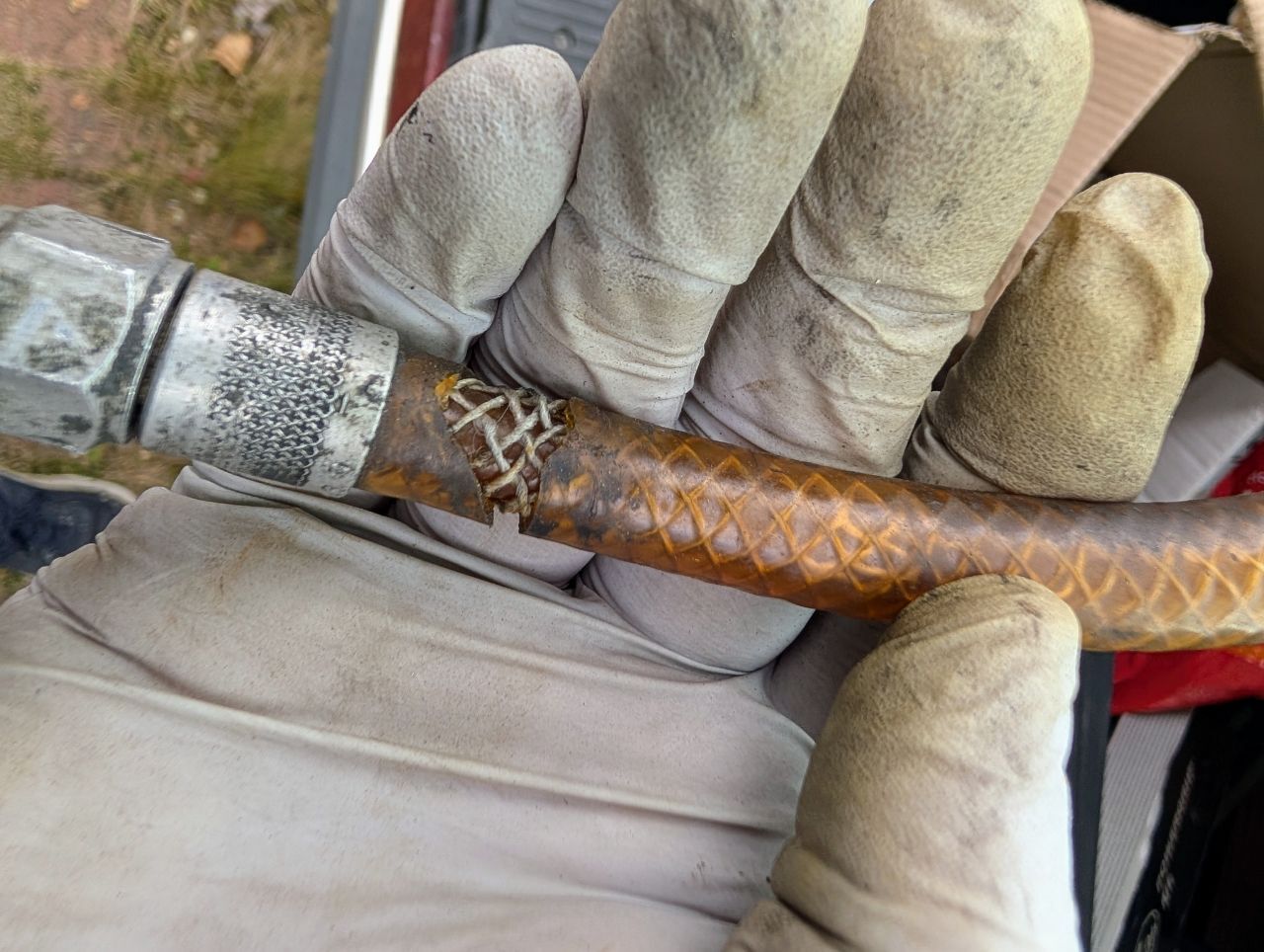

This fuel line had to go.
Glad to report that the new line supplied by Wadhams is made of the good stuff.
So that should be fit and forget.  I did take the top off the float chamber and blast it through both ways with some carb cleaner and compressed air (carefully) which does seem to have got whatever gunk was in there out.
I looked into getting the indicators/sidelights on the front swapped back into their proper places, but it quickly became apparent this wasn't going to be a ten minute job.
Which leads back up to this mess.
Who needs grommets where wiring passes through metal panels anyway?
I think I'm just going to rip this mess of unsuitable connectors and acres of electrical tape out and replace the lot.  The lamp holder assemblies are in poor condition anyway, three out of the four are missing their rubber boots and two are basically held together by electrical tape.  They're not expensive and the sidelights here are actually the wrong style for the car anyway.  I think this is the solution which will cause by far the least long term headaches.
The electrical work on this car does definitely have a few areas needing attention.  There are a bunch of silly errors that need to be corrected.  Like this loom (I think it runs to the horns) which should run under the bonnet strut but instead is draped over it.
Similarly part of this one is wrapped around the bonnet release cable rather than cleanly running over it.
Which is moderately annoying as it would have taken seconds to avoid when things were being reassembled, but correcting it after the fact is a pain as I'll need to actually dismantle things again to route it properly.  Eh, it is what it is and it will be sorted.
This is the electrical target for today though.
Specifically investigating the fuel gauge.  This lot looks complicated just glancing in there, but if you break it down into the chunks you're interested in it's really not a complicated circuit.
59 is the fuel gauge itself.  60 is the switch that selects between it showing the fuel or engine oil level, 71 is the oil level sender, and 72 is the fuel level sender (which is new and I've checked has continuity).
A little testing soon revealed a clear problem.  That switch on the dash is dead as a doornail.  It was also connected up backwards.
Here's how the panel was looking at close of play today.
I suspect the gauge is over reading slightly, that would tie in with my experience in the previous P4 where just under 1/4 was empty.  For now I've just bypassed the switch, but that will need to be replaced in the longer term.  I'm guessing water ingress is likely to blame given it's clearly got damp back there and the side/dip light switch has also been bypassed.
The brake light is indeed working again as well.  That wire floating around by the fluid reservoir on investigation did turn out to be the signal line from the handbrake switch.  I haven't actually had the engine running long enough to find out if the temperature gauge works, but I'm pretty sure I've seen it off the lower stop so hopefully it does.

Engine oil level?! Never knew that was a thing. I suppose as a Rover owner you'll not have a chauffeur but should be above having to yank an oily stick out of the block...
How does that work, surely not a float in the sump?
