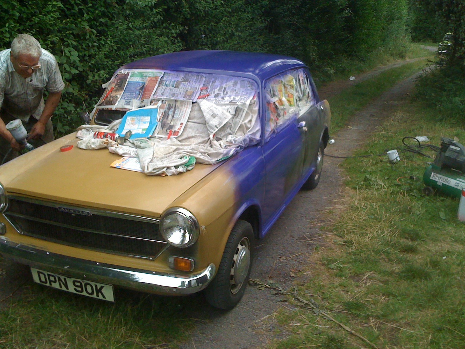

Previous owner popped up on ado16.info with this snapshot of the car getting its purple coat after the black paint had been removed. It's a Yamaha purple rather than a Kawasaki shade and the tin of paint is about 15 years old which would explain why the print on the label has completely faded away.  I love stuff like this popping up, I hope more of the many MANY previous owners pop up and add their little bits of history with the car.
