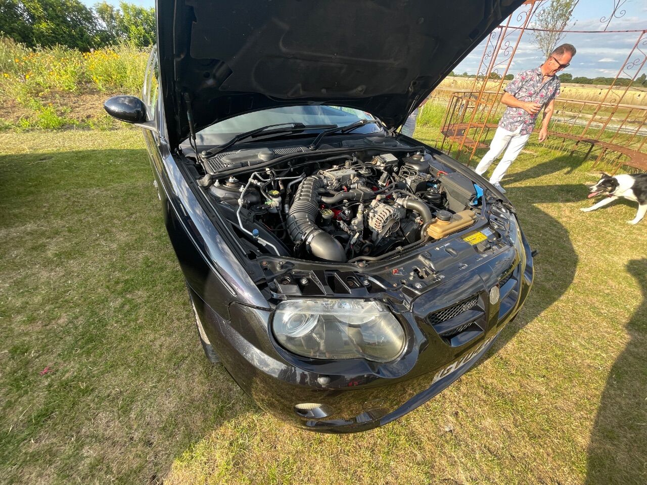

With your ZT, to test the inlet you should hear the engine note change slightly and it give you a little bit more shove at about 4000rpm, if so it’s working fine

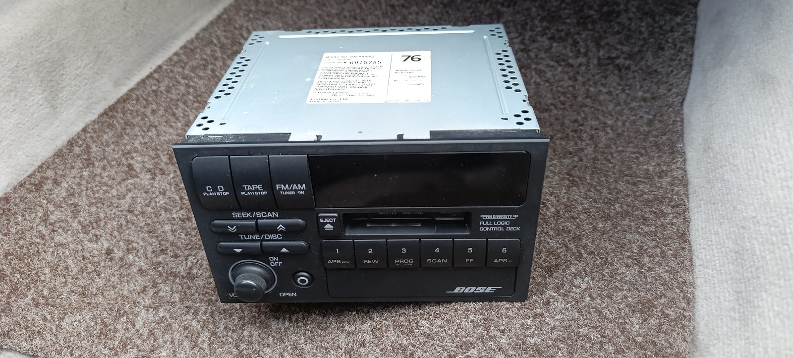

After attending the show 3 times with a model of car that hasn't been seen there before ('97 Lincoln Mark VIII, '89 Toyota Corona EXiV, '95 Cadillac Sedan DeVille) my goal is to repeat the same this year and bring my Infiniti Q45. It's been sitting in a mate's drive after having gotten keyed for the last 7 months or so, moving over to the new place only 2 weeks ago. With no test on it it was time to deal with the important things first, replacing the broken aftermarket headunit with the US market factory Bose stereo I picked up while over there:
If you look far enough back I've already attempted to figure out why the aftermarket unit wasn't turning on. The investigation was inconclusive (its probably just dead) but at least I vaguely remembered how to take the center console apart. The old radio came out easily, with it this absolute mess of a wiring harness:

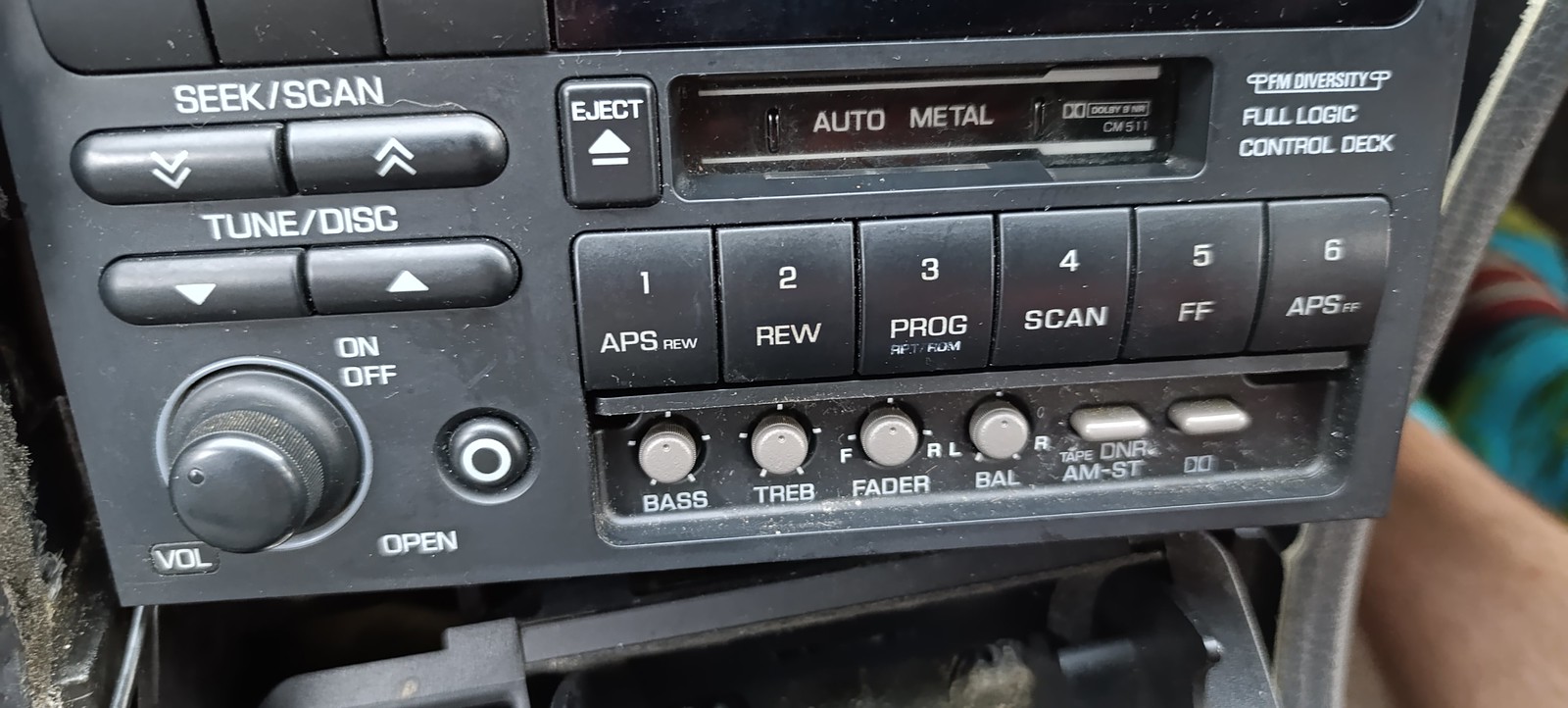

First test with the new radio in. One of the plugs had a little nub that I had to remove (no clue if the Japanese market cars had a slightly different pin layout) but things looked promising:
Well, I slapped it all back together and can confirm that I now have a fully working factory bose sound system again, and it's looking so much better than the ugly Chinese screen that was in there before:
I haven't tested the tape player yet but I've got a wider range of frequencies than a Japanese market headunit would have given me (probably the original reason why it was replaced). Naturally it's got the mandatory early 90s equalizer features, whats particularly crazy about this one is the fact that the lid the dials hide behind is not just spring-loaded but actually uses a tiny motor to open and close!

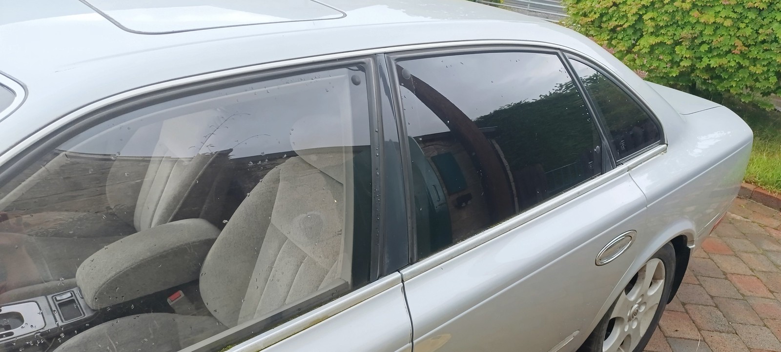

The job for today was to remove the rear window tint. I was unsure whether to keep it or not but in the end I think I made the right call. Here's what it looked like before:
Unpimp ze auto:
