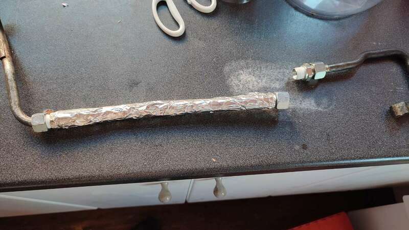

The powersteering hose went back into the car, threat sealer and heat reflecting tape added this time around. The alternator also received it's new voltage regulator today. Well, the powersteering system now appears to be leak free! However, still no charging happening, the battery light is still on and voltage at the alternator output post to chassis is just the battery voltage while running...

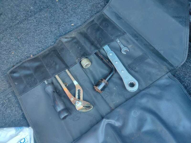

Yell if you want a loan of the Ribe socket set I bought. Completely forgot that could be useful.
Also, this is how I got the Alfa toolkit, if it's in this pic and wasn't left in the kit then I'm sure I've still got it somewhere. The screwdriver will be floating around, I'll post it when it turns up.

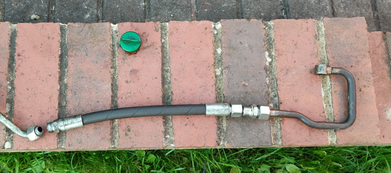

Well, the 166 went in for its MOT today, and things didn't quite go as planned!
As you can see below, most of these things will be easy to sort. I'm hoping that the caliper on the parts 166 will be useable. The rest is just a washer pump (apparently used on every car of the 80s), a set of wiper blades and a generic exhaust hanger.
The real issue however is the powersteering leak, as it appears to be dripping from exactly the same spot it did before, despite my best efforts to fix it (which it was for a little while). Which is an issue as it'll be hard to really do any better job other than replacing the section with the original hardline (#7 in the diagram), which would most likely be a steering rack out job, not something Im particularly keen on doing myself.
Since the leak will most likely come from the compression fitting (which was loose the first time I diagnosed it) I feel like there's going to be relatively little else I can do. Powersteering stop leak won't work either as it mostly works on leaky gaskets (temporarily).

I just realized, the line that was replaced is not a high pressure line, it was a hardline coming out of the steering rack, going into a rubber hose being connected to another section of hardline with nothing but a hose clamp (number 8 in the diagram). The garage didn't replace an entire section of hardline, instead they replaced the hose and (for whatever reason) shortened both ends of the hardline somewhat. I have no clue why they didn't just flare both ends of the remaining hardline and stuck a hose on it as this is just the line going into the PAS cooler, but thats exactly what Im going to do.
This will replace the 3 points of a potential leak to just two, which are simple hose clamps.
