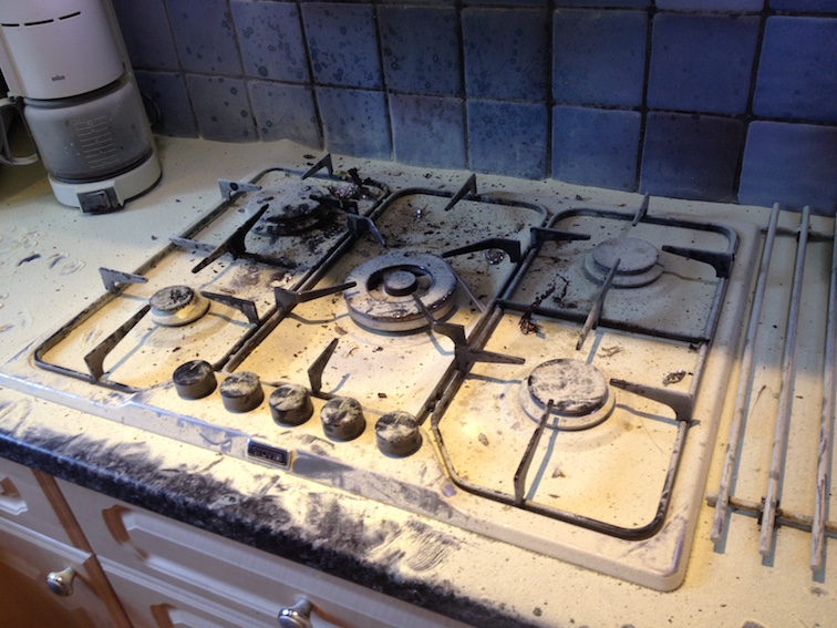

An unexpected update: we had a fire.
We’re all OK but a bit shaken even though it was relatively minor. We had recently bought the 2kg powder extinguisher I linked to above. It not only worked when needed, but it put out the fire. I reckon it was a close call though. We’re counting our blessings and are so glad our son brought up the subject of getting an extinguisher a couple of months ago when I started this thread.

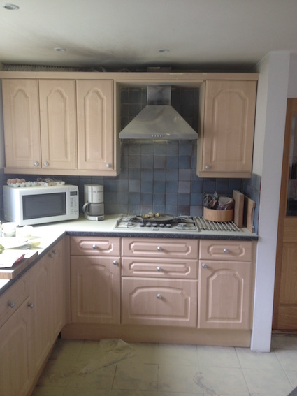

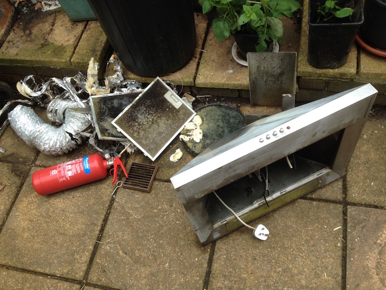

I was upstairs, my wife was cooking dinner, kids were in the lounge. Not sure exactly but dumplings browning in a frying pan caused the oil to spit which caught the flames of the hob, and caught the extraction hood. In the time it took my wife to grab a tea towel and try to wet to cover the hob the extraction ducting above the hood caught fire and seconds later when I ran downstairs there were flames coming across the ceiling, and melted bits of burning extraction fan were dripping onto the hob. Wife had thankfully turned off extractor and gas and had the fire extinguisher out already. She got the kids out and shut the doors while I blasted the hob and extraction. The fire was smothered and it went out. We called fire brigade just in case there was anything smouldering unseen.  I left the kitchen to get some fresh air, not knowing 100% if I’d managed to put it out because the kitchen was so full of powder.
Things I have learned from the experience:
1. It escalated so, so quickly. Seconds.
2. Seeing your stuff in your house on fire is one of the most frightening things I’ve ever seen, something I’ll never forget, even though it was only about 3 seconds of my life.
3. The 2kg extinguisher was just about emptied putting it out. Smaller that 2kg is pointless.
4. I’ve dealt with a couple of small(ish) fires on laser cutters at work over the years so I instinctively fought it rather than run out, but 20-30 second later and I think I’d have been out of my depth. Also I was standing between the fire and the back door so my exit was clear and I knew the others were out.
5. The powder from the extinguisher filled the room immediately. I could hardly see the windows, the top half of the room was thick with it.
6. I stayed in the powder filled room too long but I didn’t want to leave if I saw flames still after the first blast.
7. It’s a difficult decision, leaving the room and not knowing if the fire is out. It was a hot day and the windows were open so and fire could have easily re-ignited.
8. I did a couple more blasts at the extraction to be certain and to empty the extinguisher before I left. I had a bit of a headache all the next day probably from powder inhalation. May have been stress/fear/adrenalin playing a part too though.

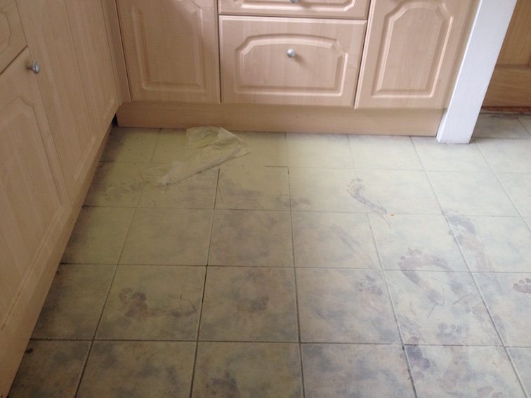

7. The mess from a powder extinguisher is incredible. It took us a whole day of cleaning to get the kitchen somewhere near normal. Things like the toaster and microwave are full of powder and are ruined.
8. We had one extinguisher, in the cupboard under the stairs. We’re going to replace that and have one in the kitchen too. And one upstairs, and one in the loft too as we use it as a work space. And maybe one in the shed too.
9 We called the fire brigade just to be certain. They got here in about 5-10 minute and checked it all out, pulled out the extraction ducting, pulled down the low voltage lighting in the ceiling to check above and were happy all was OK. They were brilliant.
10. That 5-10 minutes waiting could easily have been 5-10 minutes watching our house burn. That’s truly frightening and makes me shudder now just thinking about it.
