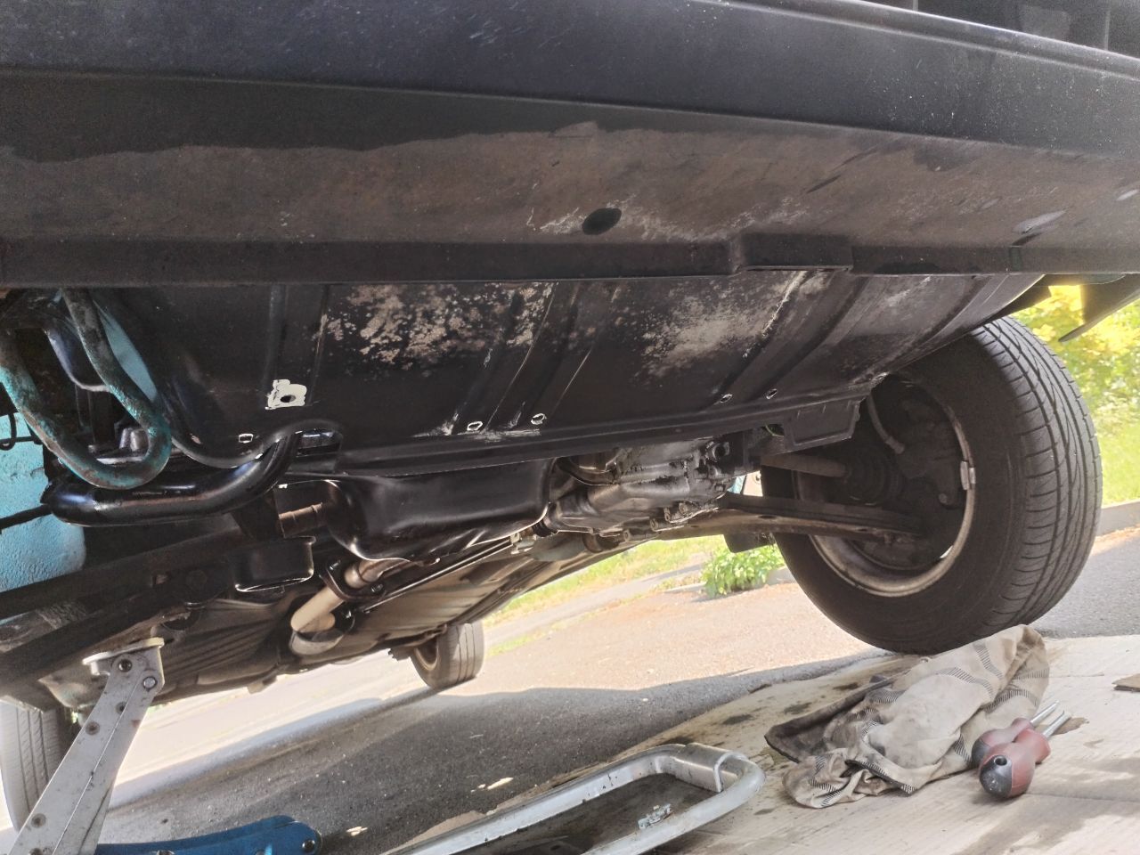

But... There always seems to be a but these days, the exhaust was blowing quite badly. I crawled underneath and it was fairly obvious. This picture was taken lying on my back under the car looking up the down pipe at the flange that links it to the manifold.
IMG_20250216_144728_edit_710786891307708.thumb.jpg.87f941934ba2472a92ed6b3819b75279.jpg
I imagine the manhandling getting it off and back on the manifold has caused a weld to break.
Right, I think I might have one of these so go off for a rummage in the back of the garage and come out with this.
It looks unused and indeed the welds look good and strong.
But it obviously isn't because at the other end is a snapped off bolt.
So I have one that needs welding and one that needs a broken stud removing. I'm not sure which is easier. The good news it's easy to remove, four nuts at one end and two bolts at the other, all of which are easily accessible from underneath so I don't have remove anything in the engine bay.

When I took the old one off I could see somebody had covered the joint in silicone sealant though it obviously hadn't been effective judging by all the soot on it. I removed all of this before refitting. Obviously not from this bit as I'm not using this bit but I cleaned it all off the other side. The whole set up seems a lot less satisfactory than a normal flexi pipe.
And lastly this is looking down the old pipe where the fracture is clearly visible. It goes nearly half way round the pipe. This also clearly shows the restrictive welding.

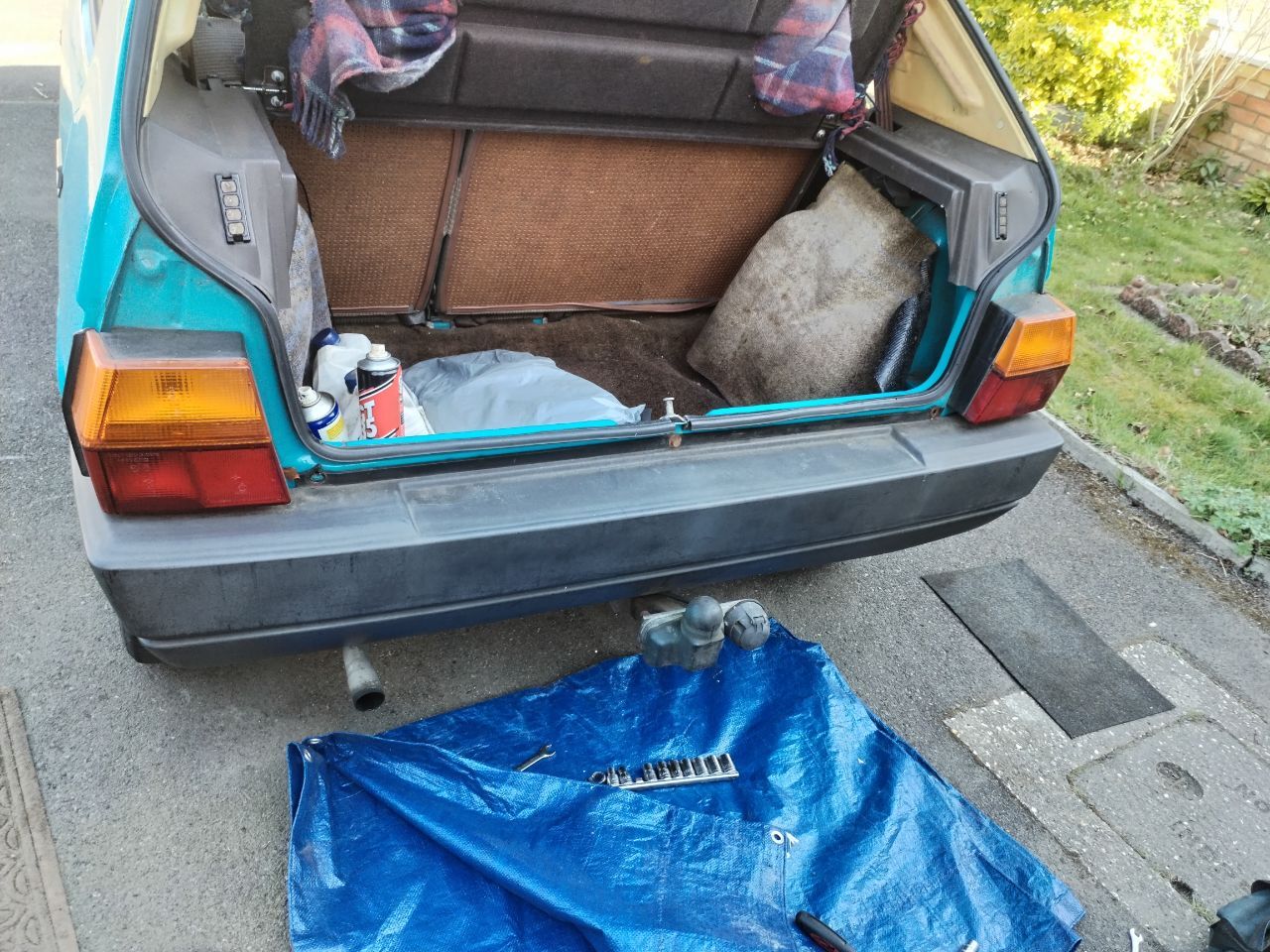

As Blue Favorit sailed through its MOT I thought I'd do an easy cosmetic job to reward it.
The bumbers are rather faded.
There are many different products on the market to black them up, some working better than others. The best one I find is Auto Glym bumper and trim gel but it still only lasts a matter of weeks before it has faded again.

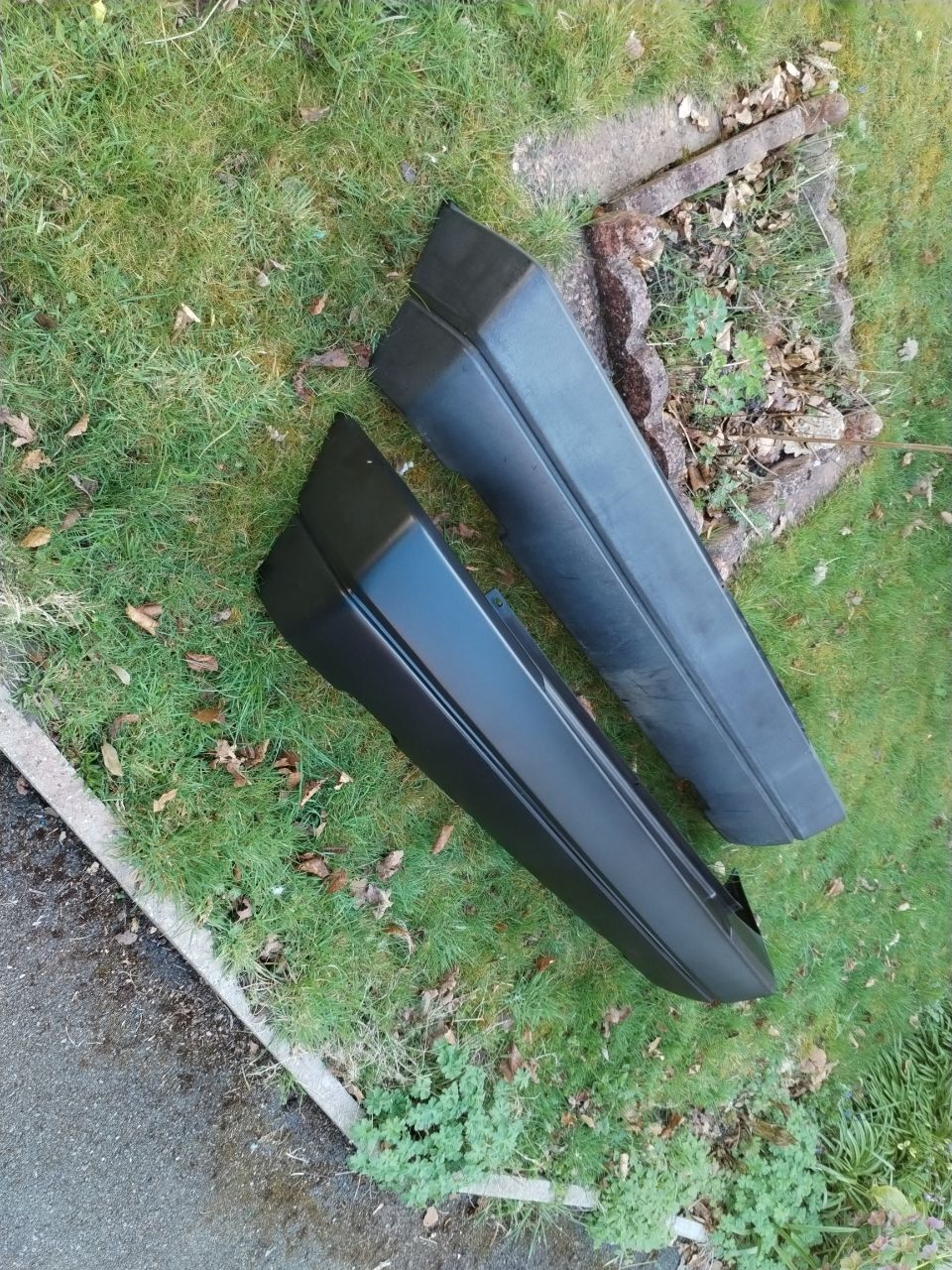

About three years ago I picked up a brand new rear bumper. It has been in the loft ever since so I thought I'd bung it on. After all they come off really easily so I ought to have it done in under an hour.
You can see the before and after here.
The difference is even more stark in sunshine.
But you can also see in the above pics that it has twisted slightly, probably due to poor storage which may well be my fault. But, thought I, surely once it's all bolted up it will straighten out. Well yes, but getting some of the holes to line up was right pig.
It has three bolts along the top, two underneath and one on each side. I tried doing them up in various different orders but it kept coming back to the three top ones. You can't push them up from underneath because the bumper bar is in the way. All you could do is push it inwards very hard which would lift the leading edge. But trying to do that with one hand and lining the bolt up with the other took much longer than expected.
Got it in eventually but then it shows up the plastic surround around the number plate.
So I had to get the Auto Glym out.
Still not quite the same but near enough. You can still feel the oils on the surface of the new bumper so it will be interesting to see how long it stays black. Hopefully it will encourage me to keep the front bumper blacked up more often too. It does look a lot better when it's just been done.

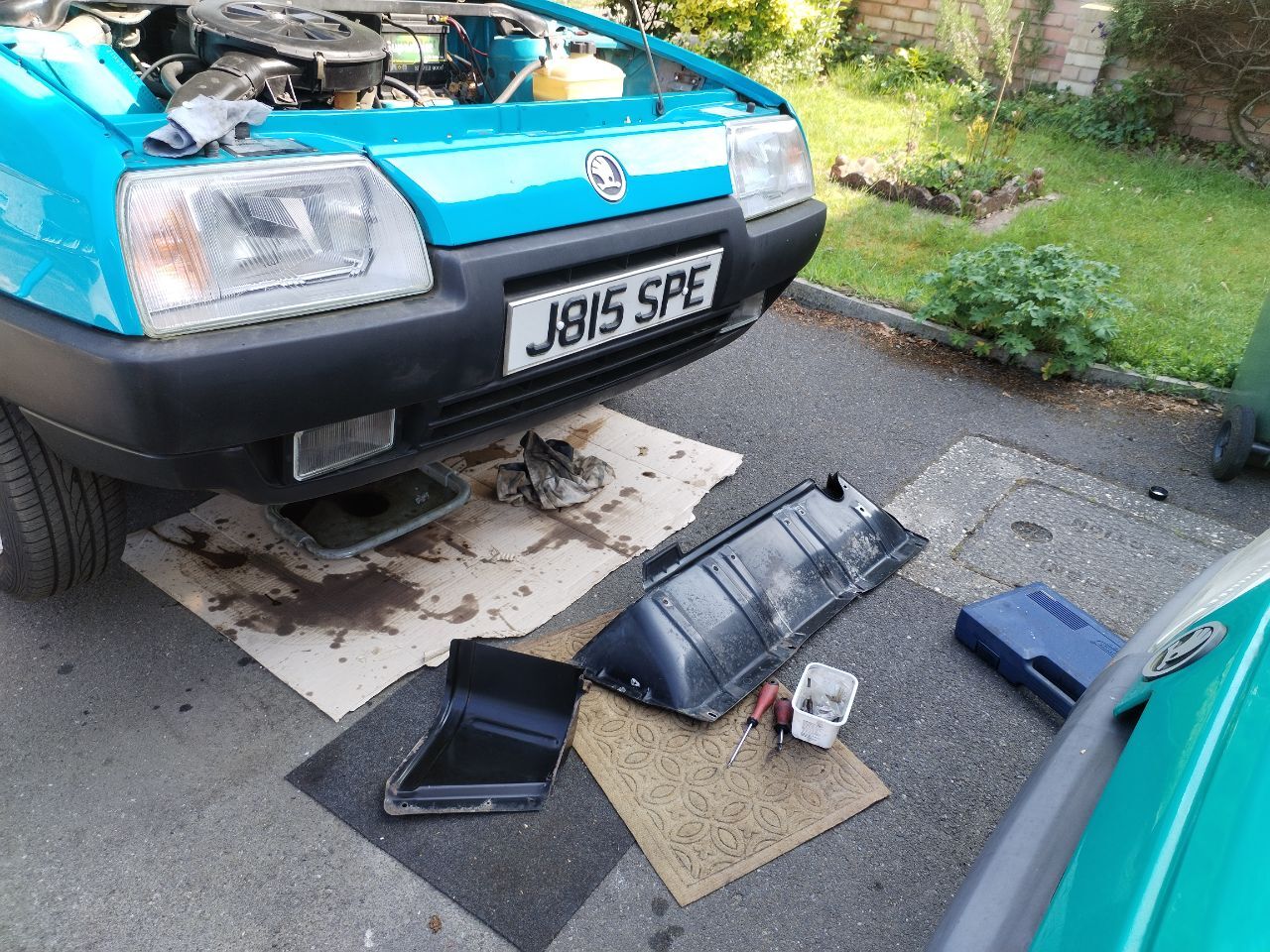

Cleared 200 miles since the rebuild during the week so decided to do the oil change. As mentioned before I decided to use a slightly thinner oil, partly to help flush out any little bits that will have inevitably been dislodged during the rebuild, but mainly because it was cheaper and I knew it was only going to be in for a couple of hundred miles. And whilst I was about it I would also refit the undertray. I hadn't bothered refitting it before as it is impossible to remove the oil filter without spilling some on the undertray.
It was not the tidiest of oil changes but luckily I had my big bit of cardboard to hand. I was trying to manoeuvre the filter up between the block and radiator when it slipped and fell back in to the bowl I use for catching oil.
Ironically if I had refitted the undertray that would have stopped the filter plummeting in to the oily depths but at least I still have a clean undertray.

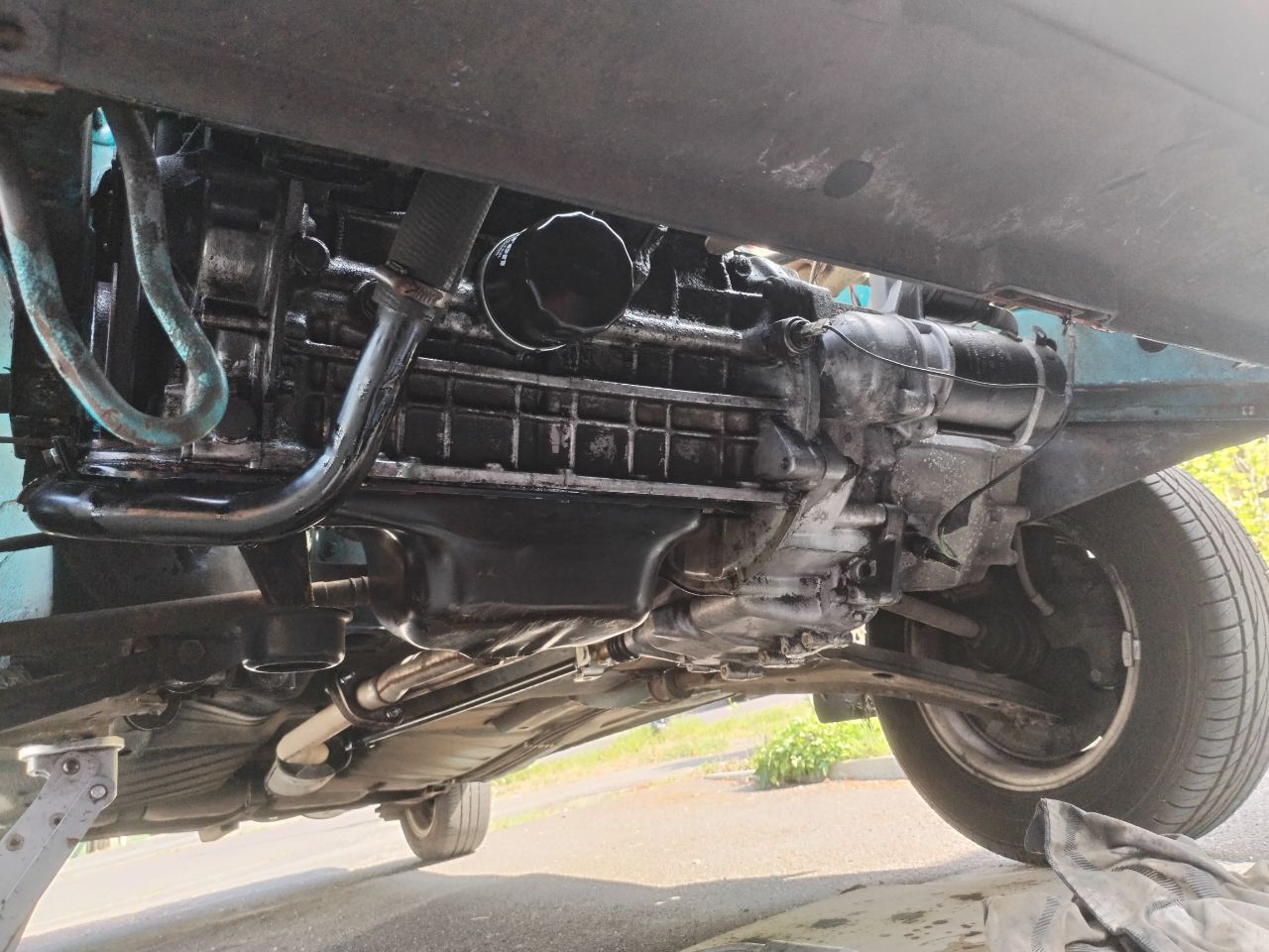

Before. The engine is quite exposed.
After.

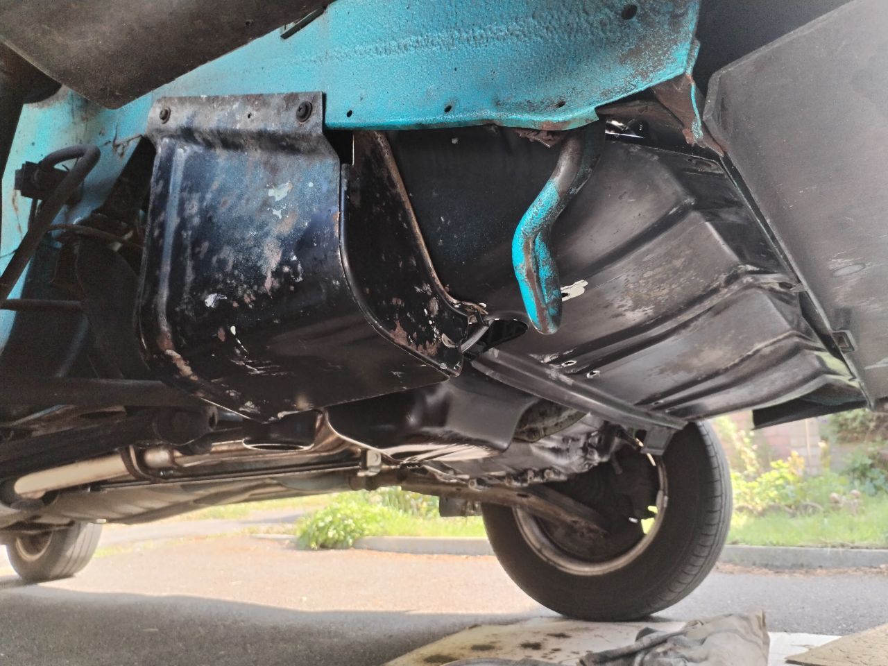

It was slightly trickier to refit because the towing eye is bent back. It always has been since I've had it. It does rather get in the way.
I've had a half arsed attempt at bending it back but it really doesn't want to know. You can't hit it, it just bounces. And I've tried putting the trolley jack under it but it doesn't move. I thought about putting the tow rope on it and tying it to a tree but I've only ever thought about it. It's not really causing problems there so I've just left it.
And lastly I've refitted the cover over the crankshaft pulley.
Which means the engine rebuild is officially complete after about five months.
