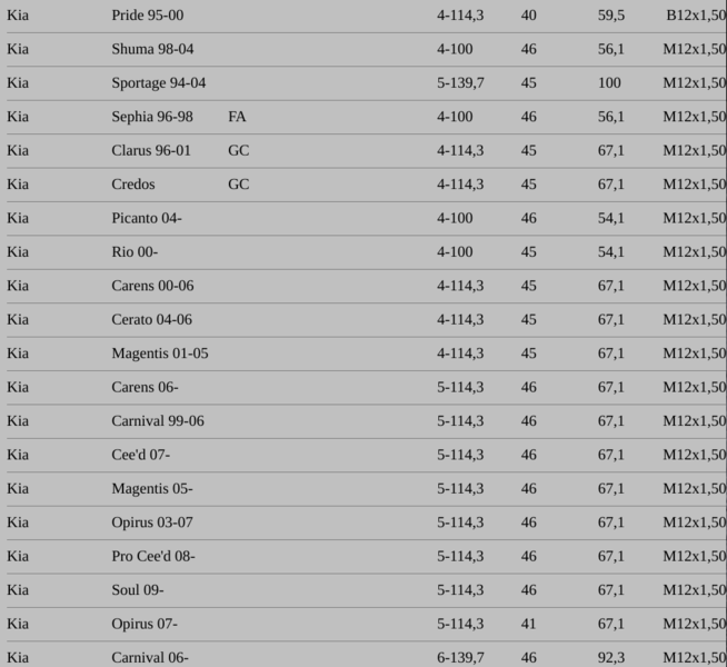

Yes, they are 4x100, a product of the VAG takeover as mk1s which are entirely Škoda have 4x98s. I guess VW wanted to do a bit of standardisation.
13 hours ago, junkyarddog said:
Definitely not a MK2 Golf rear caliper,they are cast iron.
More than likely a Mk4 Golf caliper,a popular upgrade for the Mk2.
Thanks, I didn't know that, I only had what the seller told me to go on . I'm learning as I go though it's taking awhile as it's generally pretty reliable.

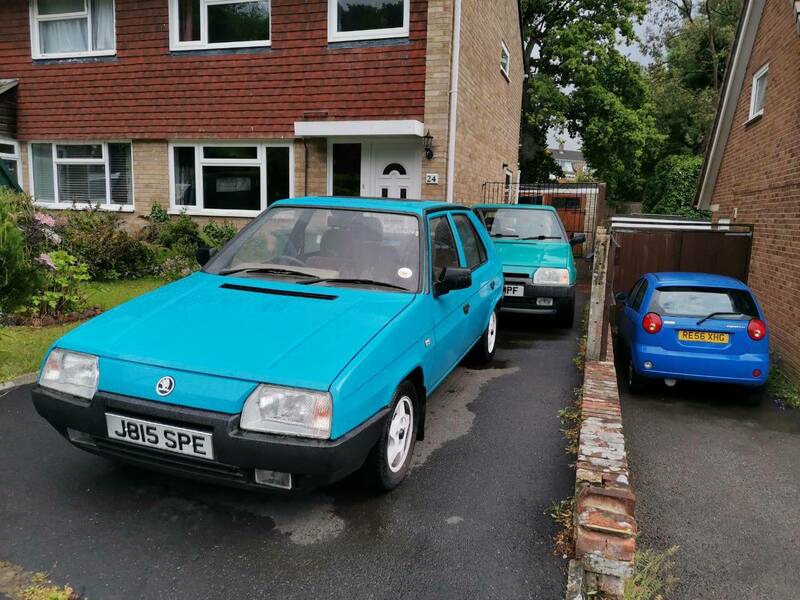

@Yoss, seems your Favorit was spotted!
I can't really hide can I? I'm glad they thought it looked mint because I think it's bloody filthy at the mo.
I was just on my way back from @Skcats place to pick up some spares and stopped off there for a pub lunch. 240 mile round trip and it obviously didn't miss a beat. No reason why it should of course.

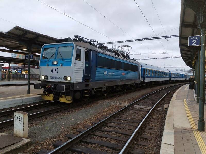

So instead we'll have a little light relief. Can't help thinking the base blue on Czech railway locos is quite close to the blue on my Favorit. This first picture is a bit dark, this was taken at twilight, they do look lighter in the flesh.
But is it just me that can see more than a passing resemblance in the styling too. They are cousins after all. The locos were built by Škoda at Plzeň and the car by Škoda at Mladá Boleslav ať a time when both were still the same company (only Škoda Auto were sold to Volkswagen, Škoda Transportation are still a proper Czech company). The locos were built between 1984 and 1992. Škoda had the design for the Favorit pretty much ready to go by 1983 but for some reason the government wouldn't let them build it until 1987 and my car is 1992.
Neither design has a curved panel anywhere and both look quite utilitarian though as far as I know Mr Bertone was not involved in the design of the locos although he might have looked at one before coming up with the Favorit.
I am tempted to get a white and dark blue wrap over my bonnet and get some ČD logos made up.
Or I could just do this.
One has to assume that thirty years ago all railway staff cars would have been Favs.

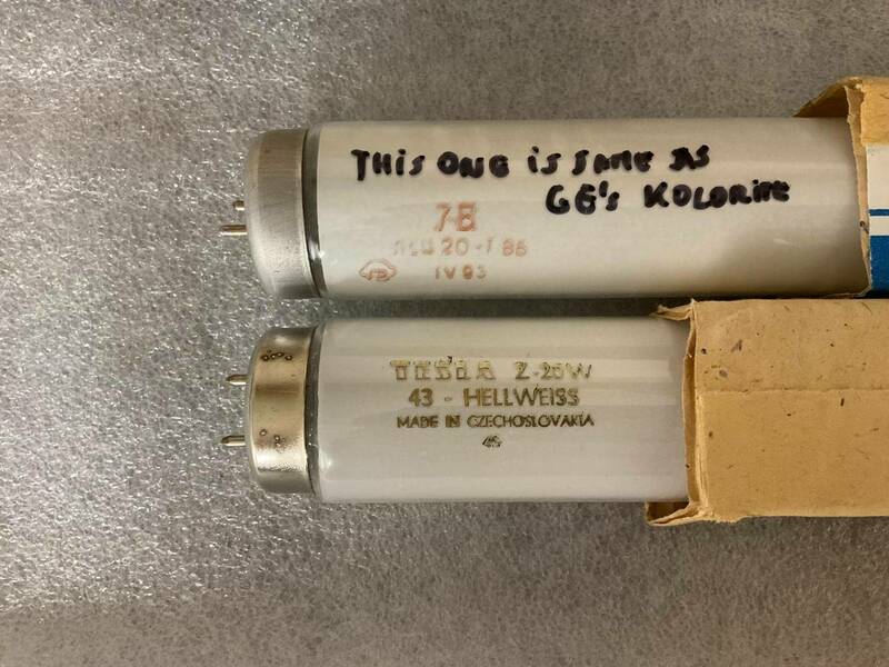

heres a quick picture I took of 2 of the tubes as I was unpacking one of the parcels he sent me (ignore the black writing on the top tube, I did not put that there!)
the top tube is a PZGRL, Poltava gas discharge lamp manufacturing plant soviet fluorescent tube from Ukraine
the bottom tube is a similar age Tesla Holešovice tube of Czechoslovakia
and I think one can clearly see even from this quick photo just how much better the Tesla tube is constructed, its still a bit crude by western standards of the 1980's but its *way* better constructed then the soviet tube of the USSR (the Tesla tube has proper full sized cathodes with plenty of emitter while the PZGRL tube has wimpy cathodes with hardly any emitter on them)
and also rather to my surprise even the Tesla tube has cathode guards, not something found on a lot of western tubes even.

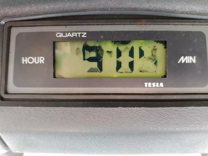

Favorit clocks are made by Tesla.
Though admittedly mine needs replacing. I do have a spare one in the garage but it's not very high up the priority list.

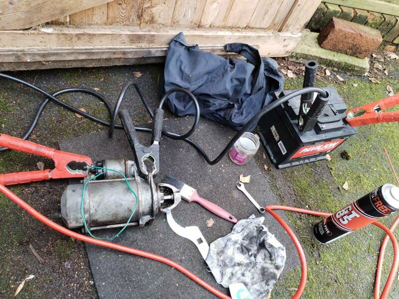

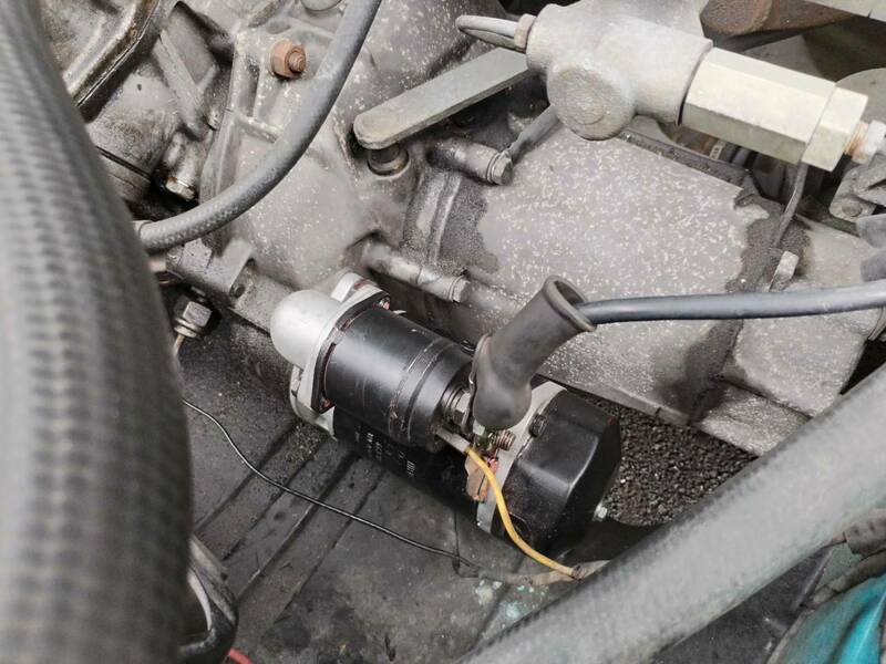

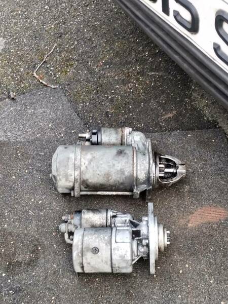

Been having a bit of minor trouble with blue Favorit. About every fourth or fifth time you go to start it it makes a nasty graunching sound as if the teeth of starter and ring gear aren't quite connecting.
I figured the solenoid might not be firing properly and it probably just needs taking out, cleaning up, lubricating and putting back in. So I whipped it out and judging by the state of the edge of the teeth this is exactly what has been happening.
Not ideal but I figured that as long as the solenoid is firing properly this shouldn't be a problem as there is plenty of meat on the rest of the teeth. I checked the teeth on the ring gear and they still look fine. So I cleaned it all up and put it back but it was the same. It always fires eventually even if it takes a couple of attempts but the noise when it doesn't quite engage can be a bit embarrassing and scares passers by.
This was annoying. I'd even made up a professional* test rig.
The thin wire is attached to the terminal on the back of the solenoid and if you strike the other end of the wire on to the big terminal that the red jump lead is attached to it fires the motor. I fired it dozens of times and it worked every time so it was a bit disappointing when I refitted it and it didn't work every time.

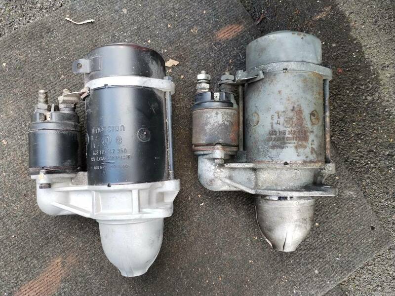

 I have a Felicia motor in the garage. It's one of these newfangled high torque things so it's about half the size of the Favorit one. This came off a 1.6 but even the 1.3s with the same engine as the Favorit used them so I thought I'd dig it out.
As you can see, it's tiny. It's barely bigger than the solenoid.
But the mounting points and connectors are the same and both have nine teeth so I bunged it on. Fits perfectly. Spot the starter motor. It's in there somewhere.
This also shows how spacious the engine bay is. You can change the motor over in under ten minutes so nothing to lose really.
Well it didn't work. It just clicked as the pinion hit the starter ring but did not engage. I think the pinion might be slightly larger, I'm guessing they used a slightly different ring gear on the Felicia.

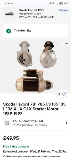

So I swapped them back again and ordered a new one off eBay. £50 seems very reasonable for a new one. Low demand I guess.

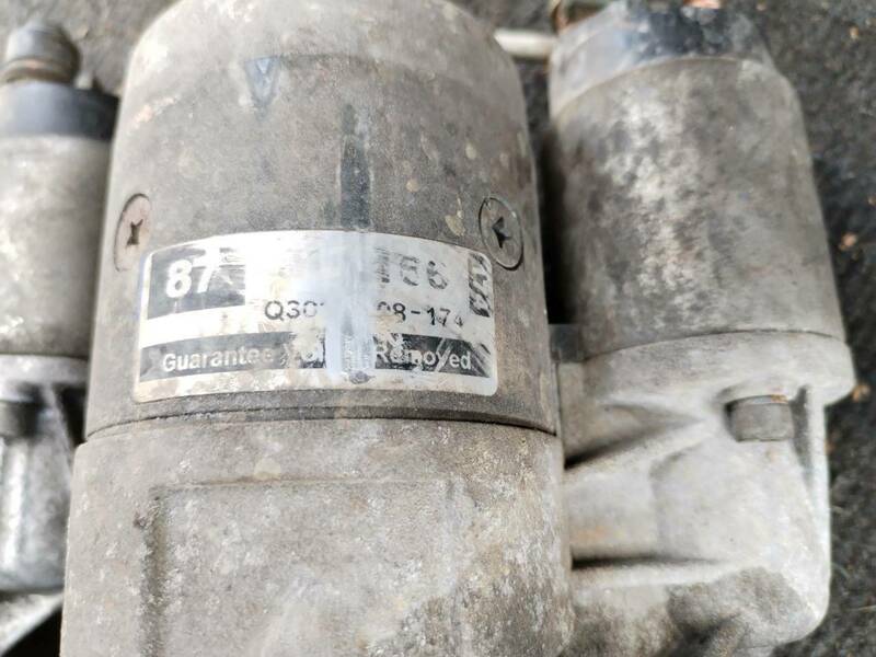

Well this hasn't gone to plan at all. First of all I ordered the motor above. That evening I get a message from the seller asking for my reg number. Fair enough so I sent it to them. Got up the next morning to find another message saying the order has been cancelled - reason for cancellation? Buyer requested cancellation. No I didn't, I just sent them my reg number. I sent them a message saying as much but got no reply. The motor had been relisted but I decided I didn't want to deal with them any more.
So I found another one. It was ten pounds more but I decided it was worth it for peace of mind. I've already documented this on the grumpy thread but a quick recap. Got an email from DPD in the morning saying they would deliver between 13.30 and 14.30. I got home from work at 13.20. At 14.24 I get a 'sorry we missed you' email whilst I'm sitting on the sofa looking out of the window waiting for it!
It then says they are now going to drop it off at a local shop and they will let me know when it is ready for collection. I get that message about an hour later and go straight up to the shop but it is not there. Shopkeeper says try again tomorrow but of course it is still not there. So I get back to the seller and he agrees to refund me if it didn't turn up within a couple of days.
In the meantime I spent a fruitless afternoon trying to contact a human at DPD. But every method of communication starts with them requesting a tracking number whereby they would just tell me it was at the shop, which it obviously wasn't. I found a phone number which starts by requesting the tracking number to be entered on the keypad which I did. A robot voice then told me the packet was ready to collect and instantly hung up without me being able to respond. The WhatsApp chat went much the same way and obviously wasn't a human.
Anyway two days later eBay seller messages me to say DPD have found it and we're returning it to him. And indeed when I checked the tracker on my phone it had changed from ready to collect at shop to now being returned to sender. I don't know why they couldn't have delivered it to me but at least they'd found it. God only knows where it had been.
I would say how can they lose it between my house and the shop at the top of the hill but of course they never actually came here even though they claimed they did.

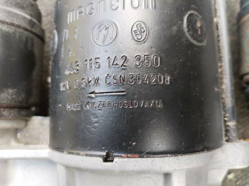

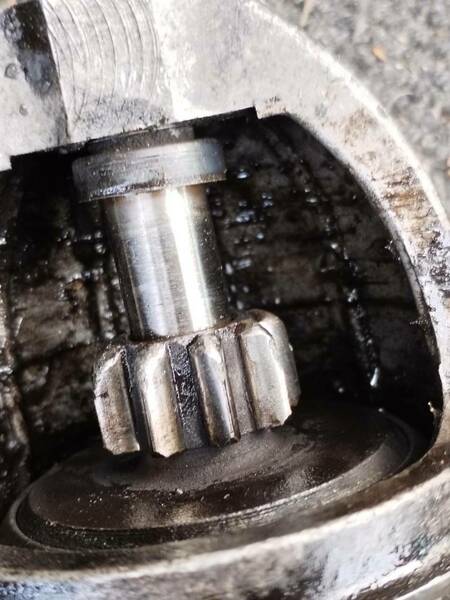

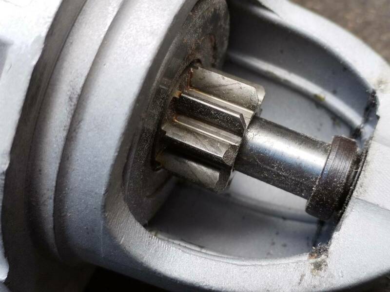

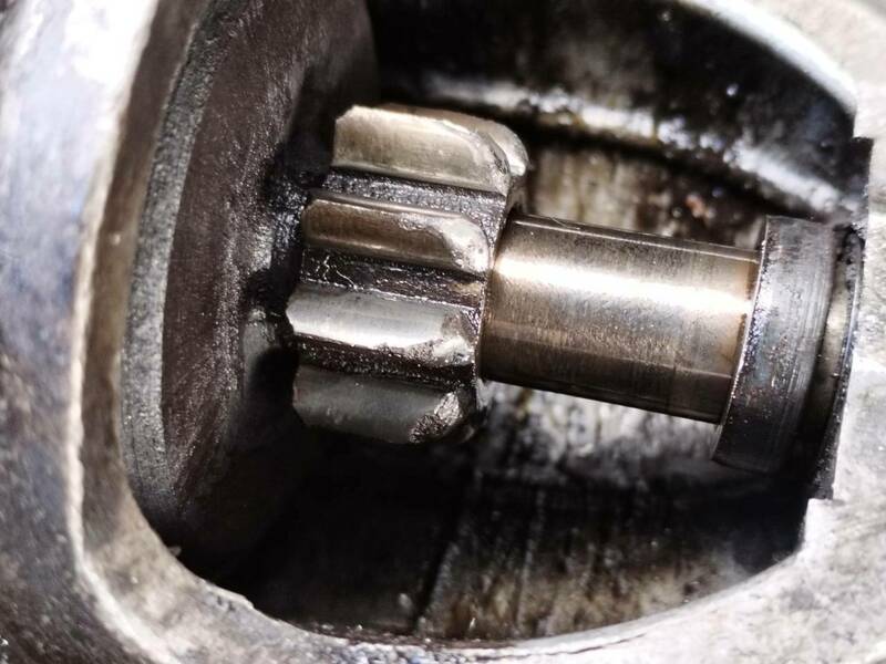

It looks nice. Compared to the other one anyway. It's not identical, it has some extra bracing around the aluminium casting which can only be a good thing.
And if it is new it's new old stock .
IMG_20240303_133830_edit_386344883264859.thumb.jpg.1522eb8dacfda7929649bb0d6606679e.jpg
Seeing as Czechoslovakia ceased to be a thing in 1994.

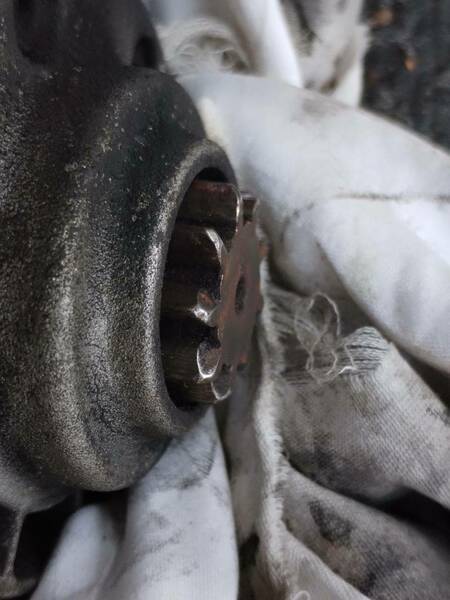

But the main thing is the pinion teeth look like this.
Instead of this.

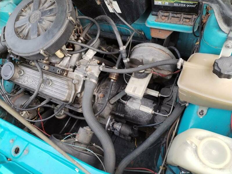

I always thought my engine bay looked quite tidy but this shows the rest of it up now.
But it can stay like that for now as it's still in everyday use.

So I went out next morning when it was cold. The battery on its own was on 12.6v and with it running (it started easily) was on 14.4v which would suggest the battery and alternator are fine. I had been wondering about the motor itself they can draw more power than they are supposed to if they are starting to seize up, I'd imagine.
So I dug out the old Felicia motor that didn't fit blue Fav about two weeks ago (see about three posts back). They are definitely the same type this time. Felicia one on the right, Fav on the left
IMG_20240306_144517_edit_471426122643236.thumb.jpg.0496f046a8744f7eaa95da1ab54a068a.jpg
The one I just removed had a sticker on saying guarantee void if removed which I thought was odd because you'd have to remove it if it was faulty.
Then I realised it probably meant if the sticker was removed. But apart from that it had no other markings at all.
IMG_20240306_144525_edit_471450376425883.thumb.jpg.c45d45c605875bec0865197ea13b6e7a.jpg
Whereas the Felly one had this on the back.
IMG_20240306_144552_edit_471471085298948.thumb.jpg.de574194625152f6adc94d1242986c68.jpg
And if you look very closely it says made in Czech Republic on the body so I'm thinking this is a quality original part and the other one is cheap German copy made for Volkswagens.
Anyway, the job itself was exactly the same as on the blue car except there isn't quite as much room what with the bigger engine. It's down there under the fan and the power steering reservoir and all those hoses.
The teeth on the old one are bit worn but nothing like the one on the blue car.
so we shall see what happens now, but I'll keep the spare battery in the boot for a while longer just in case.
