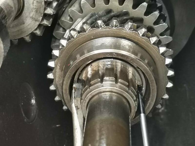

Fourth gear and the 3rd/4th synchro hub slid off easily enough but then I hit a problem. There is what looks like a broken circlip.
I tried various circlip pliers and screwdrivers seen here pointing at the two gaps.

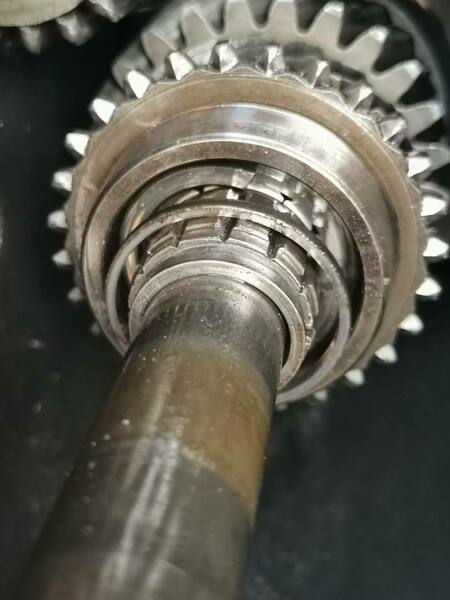

So, after much poking and studying the workshop manual I notice these are called split collars. So they're not broken, there are supposed to be two of them. After about an hour of studying this picture...
...and reading the text and going back and poking it again all of a sudden this ring popped off.
And the collars just fell out. It's so obvious once you know. The collars sit in a groove in the main shaft, the retaining ring goes over them to stop them falling out then the next gear slides on keeping the whole lot in place.
Genius. One of those moments when you feel clever and stupid and the same time. There are several of these collars going down the mainshaft separating each gear. After the first one I just used a magnet and they just pop out.

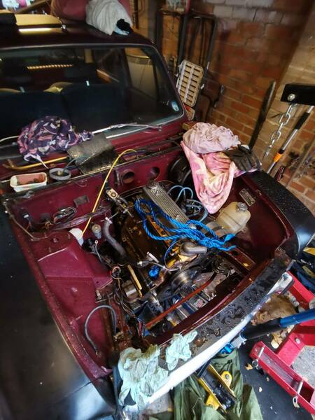

It is tricky getting the centre plate off from inside the car. The first problem was the speedo gear which has to come off to remove the centre plate. On the other gearbox it just pulled off though it has to be a fairly tight fit so it doesn't slip on the end of the main shaft where it sits. It is just a push fit, there is no key or anything to stop it spinning but as the speedo doesnt really put any load on it I don't suppose it matters.
I tried a small puller and it just pulled the nylon bit off the knurled metal bit it sits on.
And you are left with this.
This is after I'd removed the centre plate but I can't go any further until I get that knurled bit off as the gears won't go past it.
But more problematic was that when I removed the centre plate it didn't come off in the same way as the the other gearbox. The layshaft stayed attatched to the centre plate instead of staying in the box.  Here it is lying on the subframe.

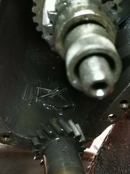

Unfortunately the spindle that the layshaft sits on pulled out too far and all the needle rollers fell out into the bottom of the 'box.
So that's more work. It could have been worse I suppose, they could have fallen on the floor.

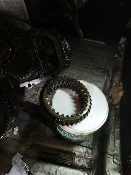

But more annoying, the third/fourth selector rod stayed attatched and pulled the synchro sleeve with it.
Obviously this was, I think, where the strange noise was coming from and I was hoping to get the cover off and find the problem but the problem area has just collapsed in to the bottom of the 'box.
Also with the synchro sleeve off, the little rectangular shifting plates...
...these...
...also fell out and the only way to reassemble them is to get the synchro hub off and I can't do that until I can get the remains of the speedo drive off.
The chances of me being able to rebuild this without taking it back out of the car are diminishing rapidly.
On the plus side the layshaft, the idler cluster and the gears I can see all look perfect.
So I still have all the parts I need to make a working gearbox but not necessarily in the right order.

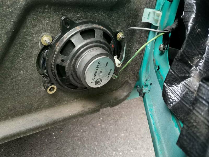

I've recently fitted a new stereo as the DAB stopped working on the old one and I've had to resort to listening to Radio 2 instead of 6 Music and we can't have that. But now one of the speakers has started distorting. It doesn't help that they are only attached to the door trims with two push on nut things like this.
This is because the original ones were oval but they were properly knackered so these are actually the ones out of the Felicia. But being round only two of the four holes lined up. And of course these are also 24 years old.
So I picked up a pair of Pioneer speakers of roughly the same size but this time I've screwed them in to the doors themselves with plenty of gaffer tape between the speakers and metal.
They don't quite line up with the original speaker grilles but they aren't far off and the sound is much improved and it still looks standard.
I can turn it right up without the all the CDs in the door pockets vibrating too as they are attached to the doors not the door trims.

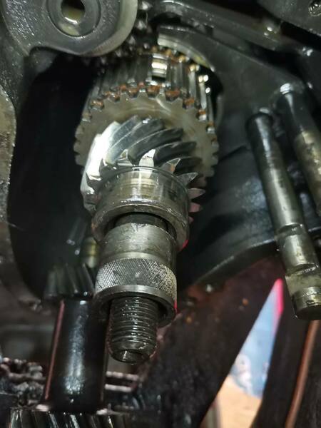

Back to the gearbox for a bit. Previously I couldn't get this remnant of the speedo drive off of the end of the mainshaft.
The knurled bit.
So I bought this mini puller.
It is designed for alternator bearings and the like but as there was such a small gap between the remains of the speedo drive and fourth gear I couldn't get the jaws of a normal puller in there. This has two threaded pins to hold the jaws together but these were too close together to fit over the end of the mainshaft so I had to use a cable tie instead.
It took a couple of attempts but bingo...

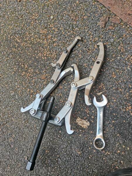

Also previously I was stuck with first/second synchro hub and first gear itself still stuck on the mainshaft. All the other gears just slid off but these last ones were sticking on what I assume is a slight burr on the mainshaft. Both gearboxes were the same and I assume this is normal otherwise Triumph wouldn't have made a special tool to remove them. Figure 28 below.

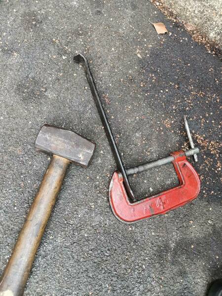

You can't see what's inside but suspected it was just a fancy puller. It needs to be about 10 inches long to fit over the mainshaft. I have pullers but nothing that long. I found some for sale but they started at £40 and they weren't here now. As with all these jobs that need special tools, they don't usually need special tools they just need a bit of ingenuity. So I basically disassembled all the pullers I had and joined them together to come up with this.
This just about worked on the gearbox in the garage but I just couldn't get it to stay on on the one in the car. As I say it's just so much fiddlier trying to work through that little hatch inside the car. More ingenuity was called for.
This little tyre lever was just long enough that when I hooked the end behind first gear the other end stuck out the end of the box giving me room to clamp the G clamp on the end. I could use this first as a hand hold and then had just enough room to tap it with the hammer.

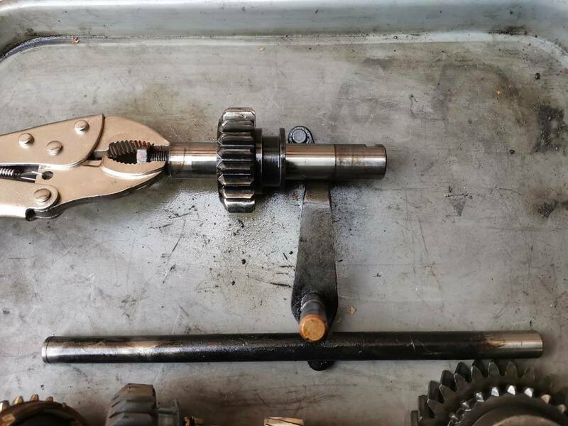

Then I found the next problem. Up until now I had left reverse alone. It is up in the top of the box away from all the forward gears and I was hoping I wouldn't have to touch it. But you then realise first gear is bigger than the others, which is obvious when you think about it, and it catches on the reverse selector rod thing.
This is the homemade puller just extracting first/second synchro. Reverse is on the top left.
So reverse had to come out too. On both boxes.

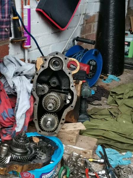

The rebuild has been going on a little at a time, most of the time being spent cleaning the old potentially contaminated oil off of everything. I didn't take many pictures because it really is just more cogs.
But there are a few here.

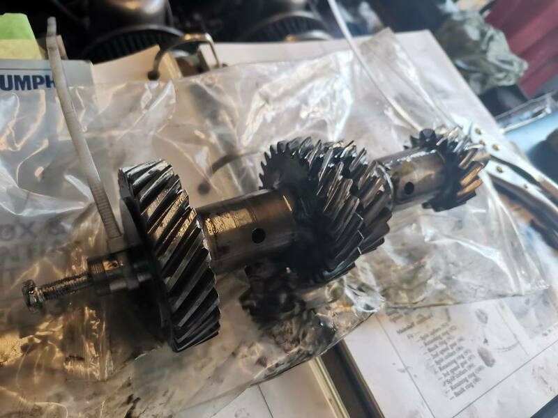

The replacement layshaft from my friend.
Cable tied at each end to stop the spindle dropping out because they do very easily then all the needle rollers fall out. Looking at the parts book the early boxes had bushes, phosphur bronze I presume, rather than needle rollers which would make life a lot easier when rebuilding but they must have swapped for a good reason as replacing two bushes with dozens of tiny rollers must have cost more.
Another new discovery here. I thought this was just a part of the moulding of the centre plate but as I started trying to clean all the gunk out it moved.
IMG_20221006_125929_edit_557879986825810.thumb.jpg.6c4d3bf5b7122c2808484a1cdfb5771d.jpg
Turns out to be a magnet. It just sits in this recess collecting swarf. Once cleaned...
Obviously completely overwhelmed by all the shrapnel in this one but a nice touch.

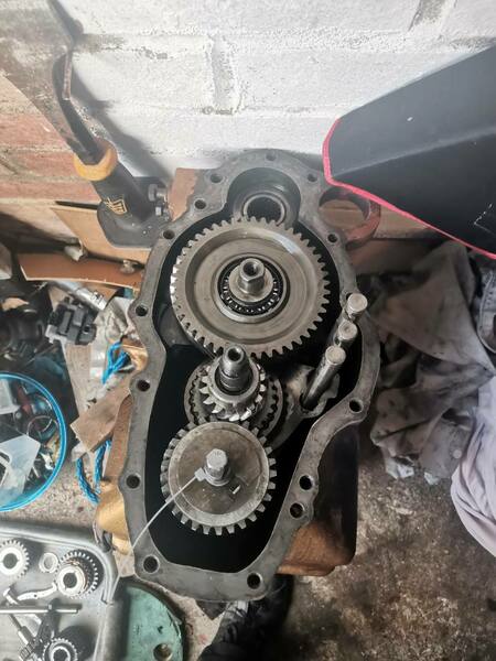

This is all the cogs finally in place.
And the centre plate covering them with most of the selector mechanism in place.

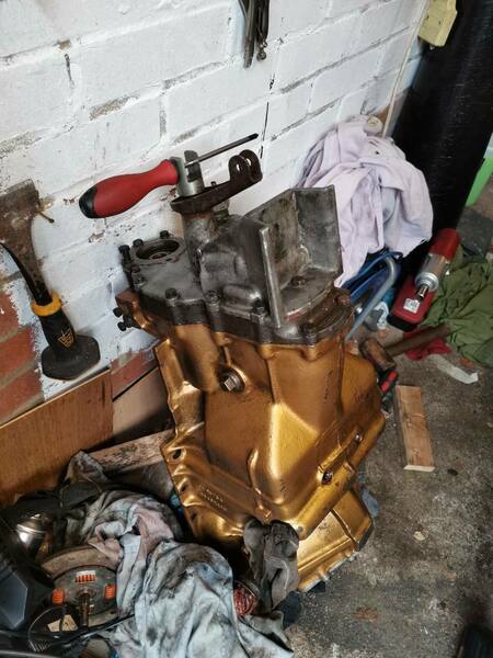

You will see here that I upended the gearbox as that seemed the easiest way to do it, especially when loading all the gears and synchro hubs on to the mainshaft. Dropping them in one at a time and fitting the split collars in the grooves. This would have been very tricky working on the box in the car and I can't see how you'd do it. I know it can be done, probably with all the special tools but I'm glad I did it this way. I've actually quite enjoyed it, I've learned a fair bit on the way.
And here it is all boxed up.
The screwdriver was used to select gears in the absence of the gearlever.

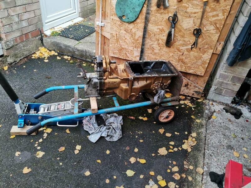

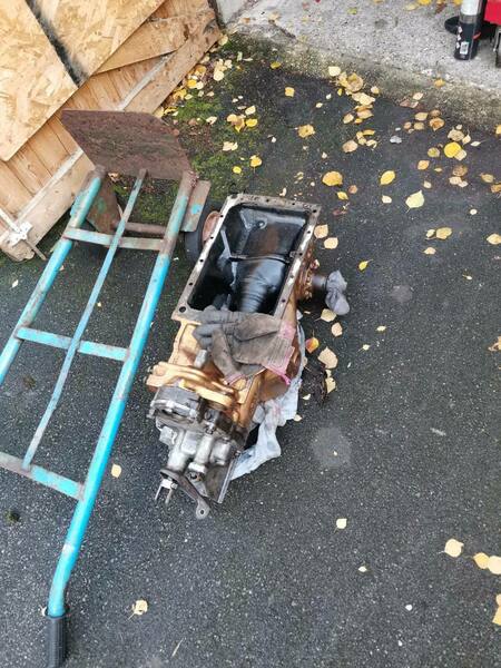

So the gearbox is all back together and ready to be fitted. So the first thing I had to do was repair the sack trucks. They live outside and the end caps had rusted and fallen off leaving the wheels free to follow suit. So I had to drill holes through the axles and put big split pins through.
Not pretty but it works. The sack trucks are an essential tool in Triumph FWD gearbox swaps. Laid horizontal as such...
And then lift the gearbox on.
This is just about the limit of how far I can lift it on my own. You will also note the trolley jack. This is then used to get the gearbox level because when filling it there is no dipstick, you just fill it until it reaches the level of the filler plug.

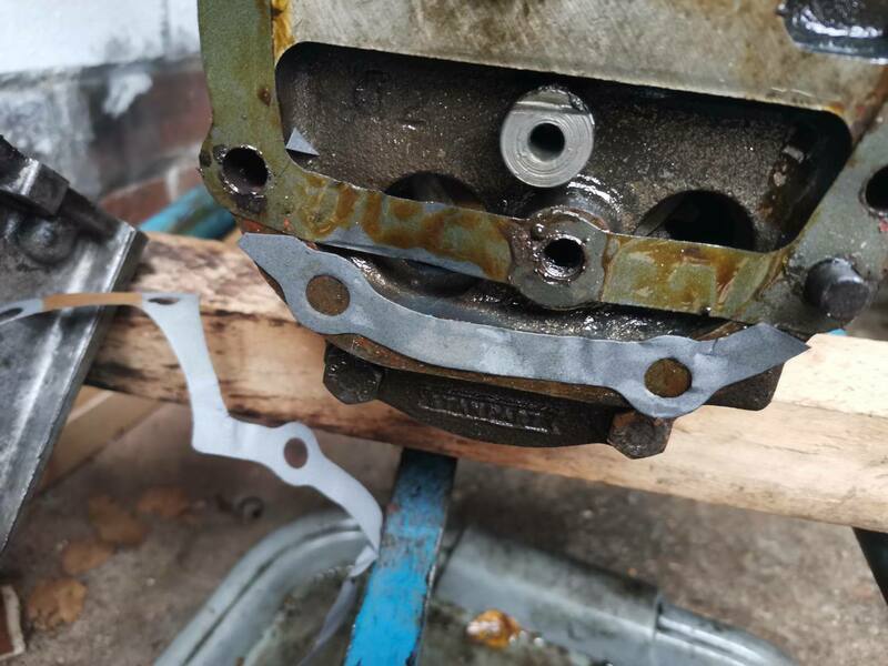

So I put the first litre in and went to get some more, official figure is 1.3 litres, when I noticed it was already leaking. I tried tightening the bolts and there was a little movement but not enough to make any difference.

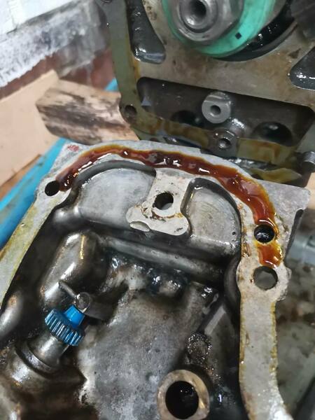

So I went back indoors to consider my actions and drink coffee when I remembered the gasket betwixt the centre and back plate was an odd shape at the bottom, and of course it was leaking.
You can see here it doesn't follow the line of the mating face.
But the packet said 1300 and 1500 FWD so I thought oh well and put more Wellseal on the missing bit.
But consulting the book does show the 1300 centre plate is slightly different.
I knew the aluminium casting of the back plate was different as the 1500 has a beefed up gearbox mount but I assumed the centre plate was the same. Well apparently not.
So I whipped the back plate off again (meaning all the oil falls out again) and used part of a spare gasket that was roughly the right radius and stuck it onIMG_20221021_110141.thumb.jpg.54ef72c302d49fd36358456103f5b56d.jpg
It's just tacked on here, it fitted better once I'd smeared it in Wellseal and flattened it out. Then put lots more Wellseal on the corresponding bit of the backplate and stuck it all back together.
I've left it to set overnight. Tomorrow I will refill it with oil, but not a whole litre at once this time. A bit at a time and keep checking.

The engine is out.
And on the deck, and the clutch is refitted.
The clutch only had to come out to get to a little grub screw to remove the reverse gear shaft. Normally you'd leave it on. Lunch time now.

Actually parcel brown paper is probably too thin. I usually use brown paper bags from work
Cereal or washing powder boxers are good for gaskets.
Engine and original gearbox are reunited. IMG_20221022_152907.thumb.jpg.98a218c203b73039e209d5b0a85111e4.jpg
Could have done without the shower that arrived just as I was readying the sump gasket, had to throw a bit of ply over the open sump smartish but you have to deal with these things working on a drive.

Well the engine and new* box are back in the car. It's a bit more of a palava getting it in than out but that's the case with most things. No pictures on the way because I just wanted to get it done but here it is back in the garage.
It has go in to the engine bay at angle with the clutch end hanging down to get it under the hole in the bulkhead so there's lots of dumping it on the subframe and sliding the hook along the rope and lifting it again and pushing and pulling the front around but it's in now. The front engine mounts are in. The rear isn't yet but I can do that in the garage with a trolley jack.
All* I have to do now is join everything up but I can do that a bit at a time in the garage. This was the one job that once started I had to finish in one go and that's done now so I'm quite relieved.
You'd think this box would be lighter seeing as it's empty. It's not noticeably. I think all the weight is in the cast iron shell.

Haven't updated this for a while because I really couldn't be arsed to get out and put it back together. But I have just got enough together to be able to start it.
And...
We have some sort of transmission! That's fourth gear. I had it on axle stands and put it in every gear and brought up the clutch. It seems to select every gear without any graunchy noises or bearing noises so so far so good. It's not the same as putting it on the ground and putting the weight of the car through it but it's a start.

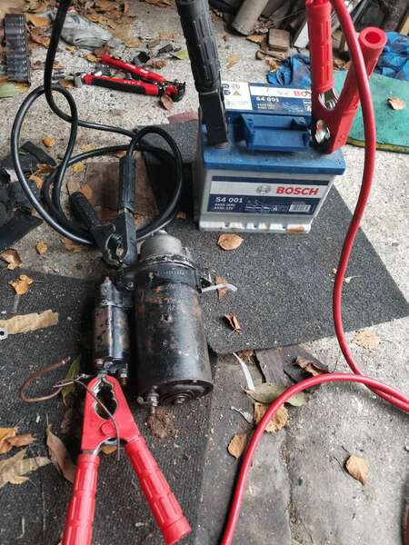

But the starter motor started getting slower and finally siezed up. I had two spare ones in the back of the garage. I've had them about twenty years (I certainly remember moving house with them) and they have had all the protection of a disintegrating carrier bag in that time but to my amazement I rigged one up to my professional* test* rig*...
... and it fired first time. So I cleaned it up as best I could and lubricated the bits I could reach and bunged it on. It spins the engine twice as fast as the old one ever did and it starts better too. The old one was obviously drawing so much power that it was taking power from the ignition. So that's a win win.
I bunged a bit of oil on the old motor and put that on my test rig and that was soon spinning again, without having the weight of the engine to spin, though not as quick as the replacement but I'm sure it can be made to work again. It's certainly too valuable to throw away. The motors on FWD Triumphs are mounted at the front of the engine on the offside and spin anticlockwise so are unique to these.

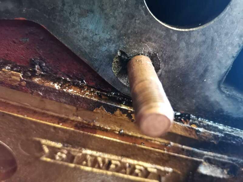

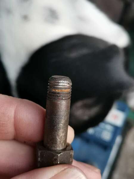

In Triumph news, in a follow up to the previous post, I have fitted all new studs to the head, done them up as tight as I could and added some threadlock too. So next time I have to remove the manifolds, which I surely will, the studs should stay in place.
When I stripped the head down I found where the stud had pulled out it had actually damaged the head slightly too
But I knocked all the loose bits off and there was still plenty of thread to put a new stud in and it's not a part that the manifold mates to so I'm sure everything will be fine.

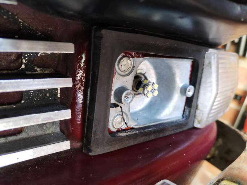

Obviously every time I don't use the Triumph for a while it throws up a few electrical gremlins when I go to use it again. The horn is always temperamental, it is a poor earth between the steering column/rack/subframe. It always needs cleaning. It would help if I used the horn more but then I would look a dick.

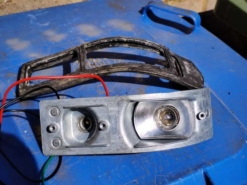

One of the front sidelights has been dimmer than the other for ages which would also suggest a poor earth but this time it had gone out completely. I took the lens off and with a bit of wiggling got it to relight but not for long. So I took the bulb out to set about cleaning it up. I noticed the little spring loaded bit that the back of the bulb butts up against wasn't moving at all so I thought I'd give it a little tap with a 1/4 inch extension bar and it promptly disappeared inside the car. I only tapped it, admittedly with a big hammer, but still only gently.
Well that's buggered then. The round rubber bit contains the rusty remains of a bulb holder and should be attached to the other rusty remains you can see in the middle of the sidelight unit.
So off I go up into the loft to retrieve this box.
These are now getting very scarce, I have one left in stock, but needs must and this is why I have them after all.
It is normally the white metal, a cheap aluminium alloy, that goes all powdery and dissolves but this time it was the was the bulb holder that rusted. Given the scarcity of these things I will keep the old one as generic bulb holders are available and it may be possible to fit one in to the old unit.
In the meantime I thought I'd give the new unit some extra protection, first with a coat of Bondaprimer, noting that I have also pulled the rubber grommety things back and painted the bulb holders too.
Then some smooth Hammerite that I mixed many years ago from Burgundy and dark blue to be quite close to the colour of the car. It's not that close but I use it in underbody areas where it is close enough.
The old unit had been in there for 17 years, hopefully this one will last even longer and I shouldn't have to worry about it again.
I've gone for some bling.

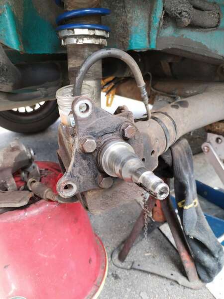

I've never really had to deal with rear disc brakes with my fleet. The only other car I've had with them was the ZT-T and that never needed any work in that department. But I could hear a wheel bearing starting to sing at the back of the green Favorit. The guy I bought it from said they were mk2 Golf GTI discs but much googling suggested they came with discs and drums throughout their life. More googling also suggested the wheel bearings were the same on both. Wasn't sure if this was true but I thought even if it wasn't they could be used on the standard Favorit so I ordered some anyway.
The brake caliper is annoying in that the handbrake cable goes under the stub axle and the hydraulic line goes over the top so one of them has to be removed to get the caliper off and out of the way. I looked on you tube to see how the handbrake cable came out but by the time I got back out to the car it didn't look familiar so after some prodding I decided it would be easier to split the hydraulic line and bleed it again afterwards.
I forgot to take many photos and what with it being such a mucky job I couldn't anyway but once you've figured out how to get the caliper out of the way it is pretty much the same job as with drums. The awkwardest bit being knocking the inner races out of the disc.
The very manky rear side of the disc. Disc isn't perfect but there's life in it yet and it cleaned up okay but no picture because I forgot.
Grotty stub axle.
And cleaned up. At this point that caliper carrier is the only difference between disc and drum brakes. The drum brake back plate uses the same three mounting bolts.
