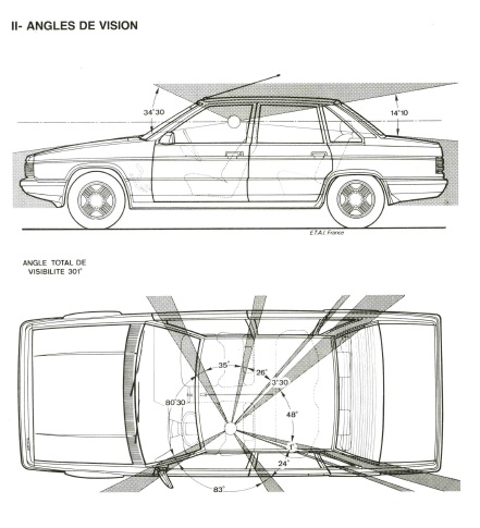

Security? Old cars have windows that i can actually see through and check what's going on around me in every direction. Today, you get tiny viewing slots, seems glass has become so expensive that car makers generally try to avoid its use. Remember, a good all around view used to be a sales argument, what happened to these diagrams that were part of evey sales brochure?

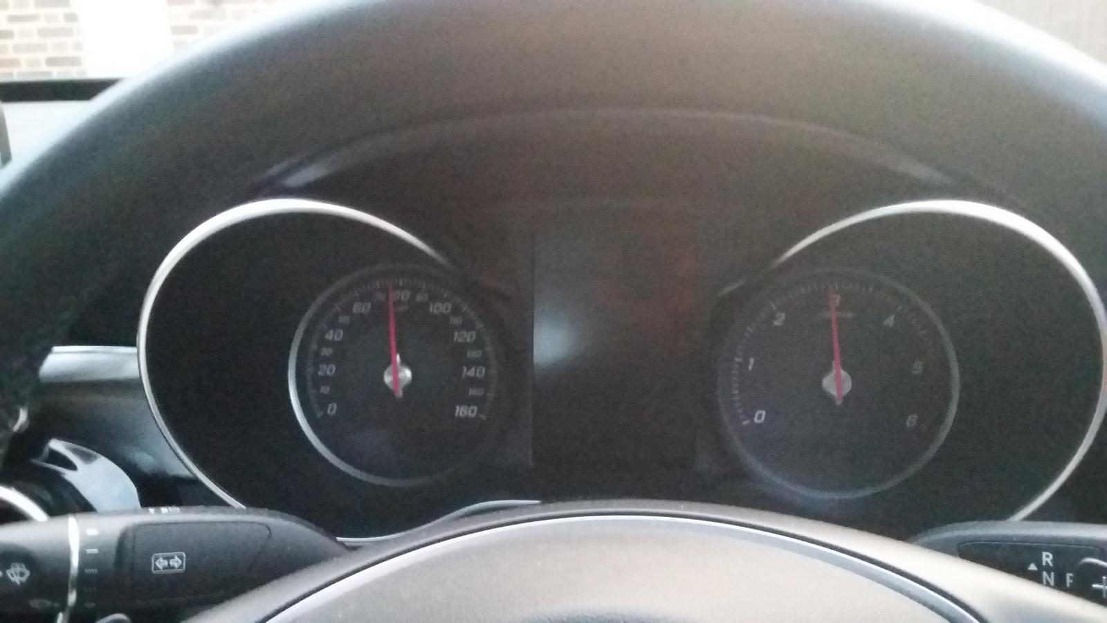

My dad works for Merc and gets a new company car every 6 months.  Currently its a primer grey C class diesel with too many buttons and too many gears.
At the grand old age of 4 months and with 1400 miles on the clock it completely died on the drive.  None of the electrics would work at all (including the Mercedes assistance button) only for it to suddenly come back to life 20 mins later.  This was fixed the following day at a dealer but it still isn't right.  At the moment the start stop rubbish often wont restart the engine at junctions and the solution is to repeatedly stab the start button.
