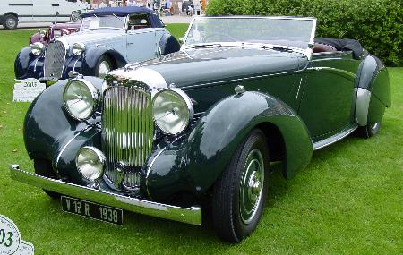

I was sitting in a latest style Mondeo talking to the proud owner and he offered me a drive. He'd just described how it can park itself and take over if you nod off, so there really didn't seem much point; I felt as disinterested as if Ann Widdecombe offered to show me her topbollocks.
It was a different story with one of these though- I jumped at the chance when one needed shifting a few miles and would forgive it any amount of unreliability if I had the good fortune to own one, especially the v12.
PS, best thing I've ever driven.
