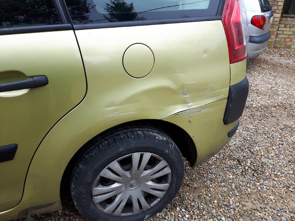

Then some nice wanker did this. Naturally they forgot to leave a note. I have prayed that their sump plug comes undone, if you chaps could do likewise.

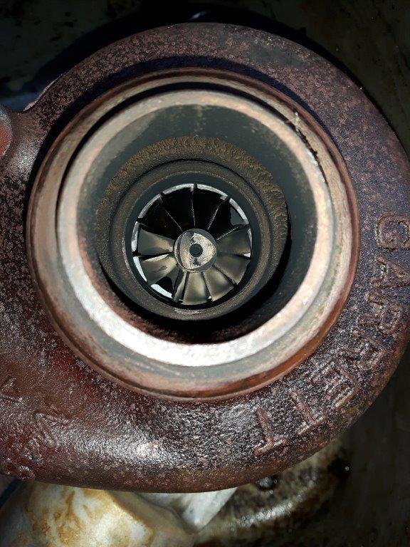

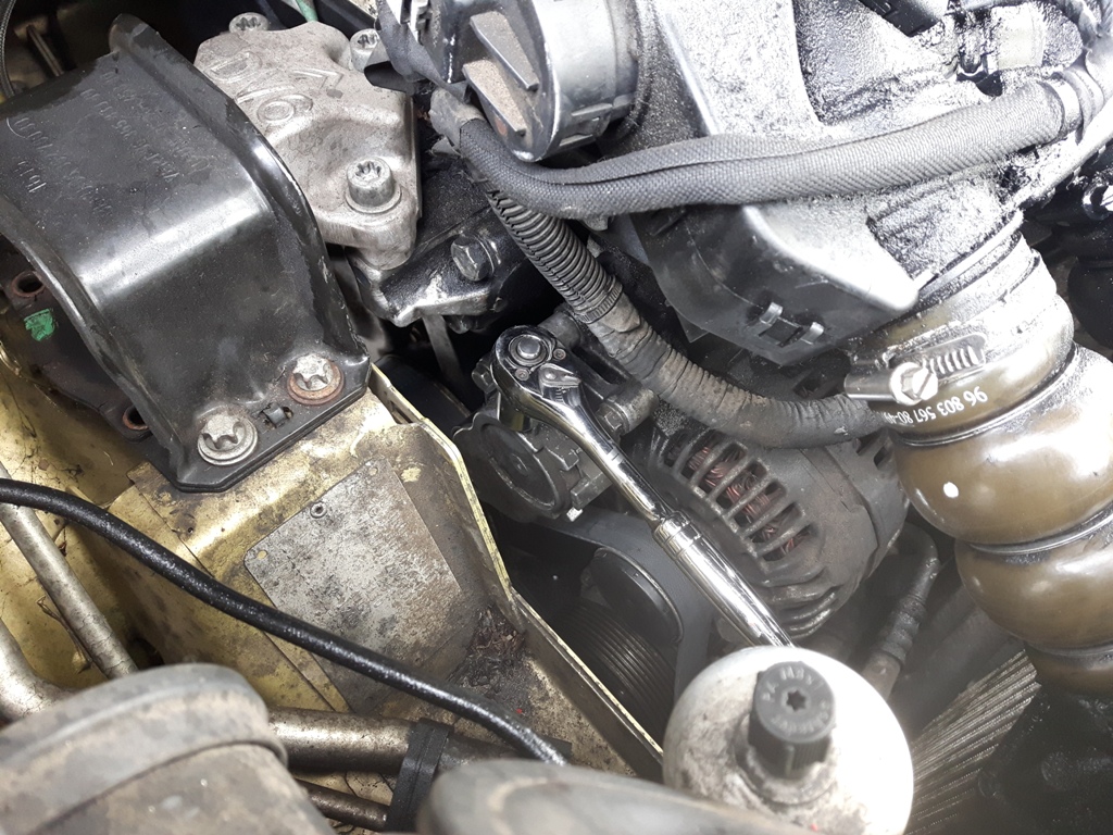

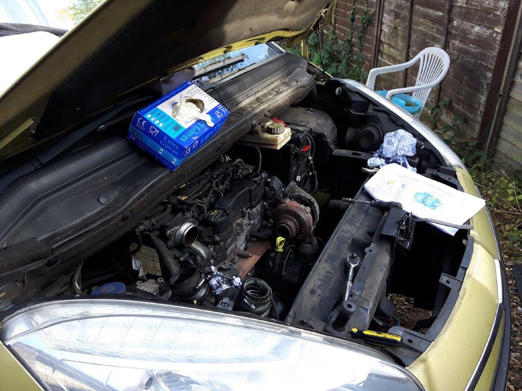

Then that evening the fucking Turbo lunched itself big time. The car has been a bit noisy recently so I guess it's time had come but talk about fucking timing!!! £1k in over the last 2 months and webuyanywreck say £1100 not knowing that the turbo had died so I expect that offer would have nose dived.
I have taken longer shits than the warranty some of the ebay chaps offer on their turbos. There is also a lot of noise on C4owners about cheapo Chinese turbos made from butter. If this car is to last another year I need to put a quality part on it. None of the ebay breakers had a suitable turbo so....  Citroen wanted £990 all in for new turbo and feed pipe. Allparts were £100 cheaper but had a recon turbo with 24month guarantee that didnt include conditions such as "blessed by Donald J Trump" or fitted "by the Pope incumbent" for £600.
Not difficult to fit but a lot of stuff to pull off.
Leaky Air Doseur was cleaned up before refitting
That's the turbo playing peak-a-boo

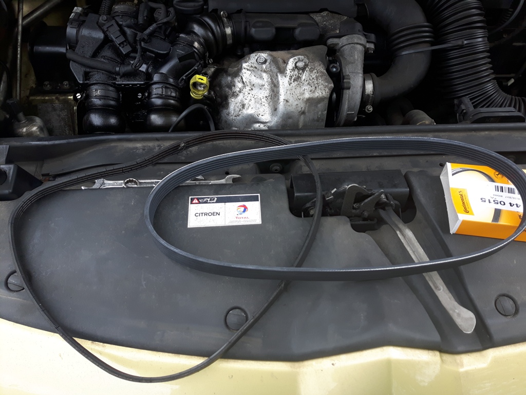

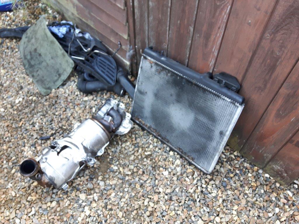

Rad had to come out to get the precat and heat shield off out, which meant removing the undertray which for some reason was held on with zipties
There you are, four more 12mm nuts and
Yep that be fucked
No sign of black death carbon build up. soooo either the turbo was on borrowed time or the local made a mess of the oil change. Most likely was a tired turbo and oil change missed by 5k miles

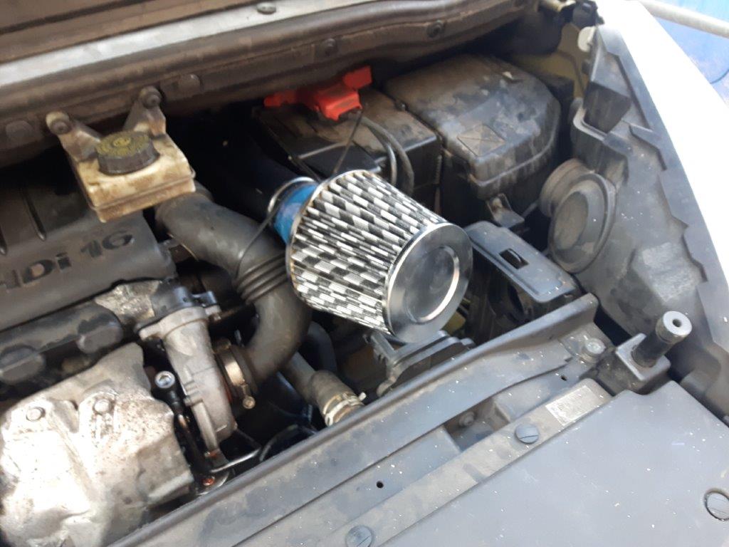

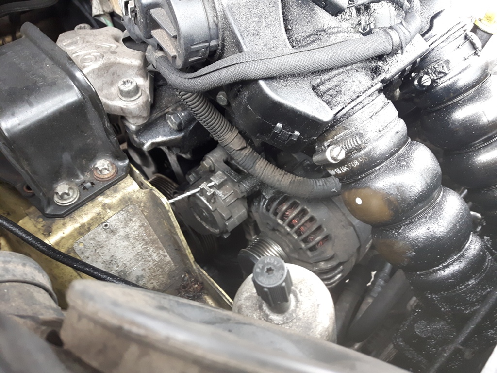

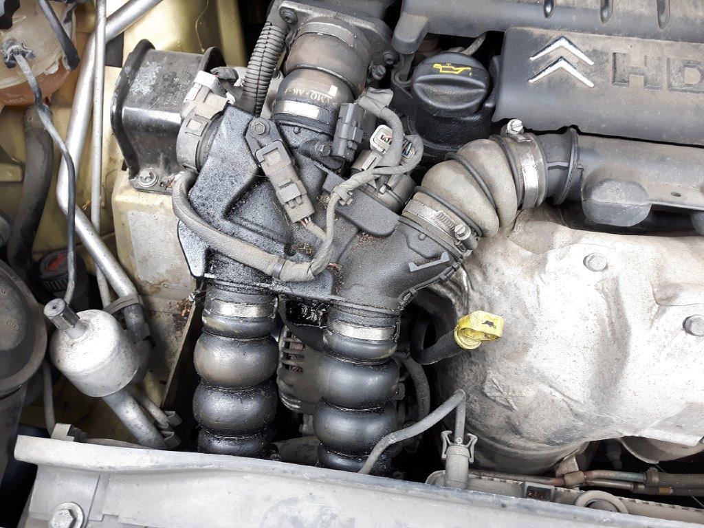

Anyway was driving it on Friday for first time in ages and noticed quite an induction roar at over 3k rpm. hmmm lifted the bonnet and noticed that the ducting between the tiny air filter box and the AFM was missing. Fucksticks
Air filter is front right just behind headlamp, AFM is to right of engine cam right at the back of the engine bay.
Local breakers didnt have one, no ebay traders responded quickly, Citroen quoted " a Vanessa*" + VAT for new parts.
Looked at Halfrauds and they had a BarryBoy cone filter for 19.99 in stock. Whizzed out to get it and then found that the AFM pipe is too far back in the engine bay to fit it.
Disillusioned I fixed the Jag, then on the Jaag test drive a sudden brainfart. 7cm internal diameter! That isnt far off gutter down pipes. Nipped to the local Garden centre and spent £2.50 on an elbow certain that I would have a length of pipe around somewhere.
Got home couldnt find the fucking Shitroen keys, tipped the house, garage, mancave and cars inside out looking for them. They showed up this morning!! Mrs Thestag thinks I am going mad, I think we have a Poltergeist or cat had developed opposable digits so I can move shit around.
Anyway using spare key, that doesnt start the car but does at least open it I managed to cobble this up.
Verdict = works a treat, costs £22.49
p.s. found that there wasnt even an airfilter inside the airbox so am going to be "avin a chat" with the local garage who serviced it for mrs last Oct!! Especially as the fucking service receipt shows she had bought one

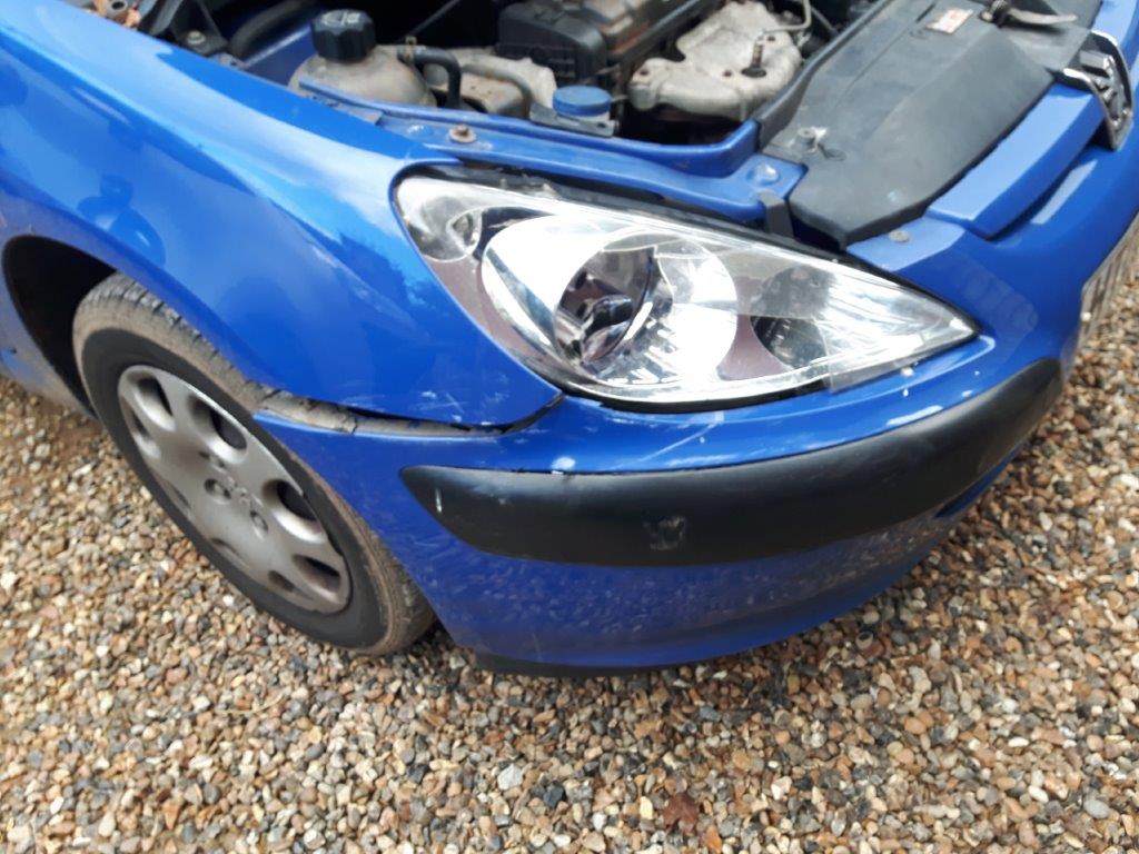

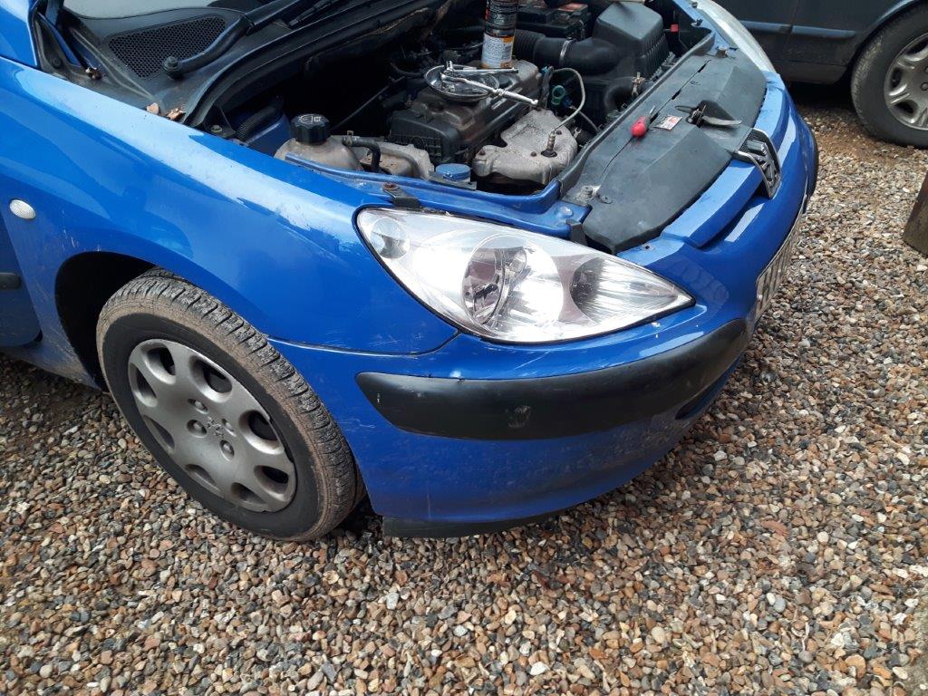

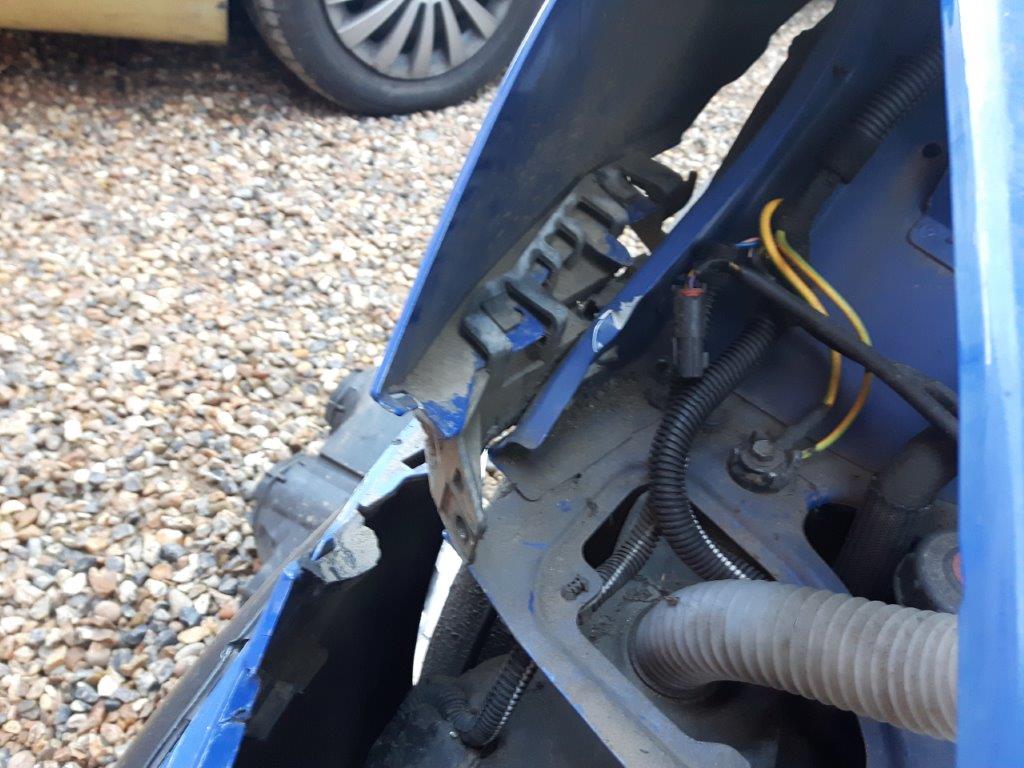

Two weeks back Matt had a wee shunt, agreed with 3rd party that it could easily be argued that neither party was looking as they met o/s/f to o/s/f. Matt was right across the oposite side of the road turning right and hit a Golf coming the other way from being parked up on the pavement. go figure!

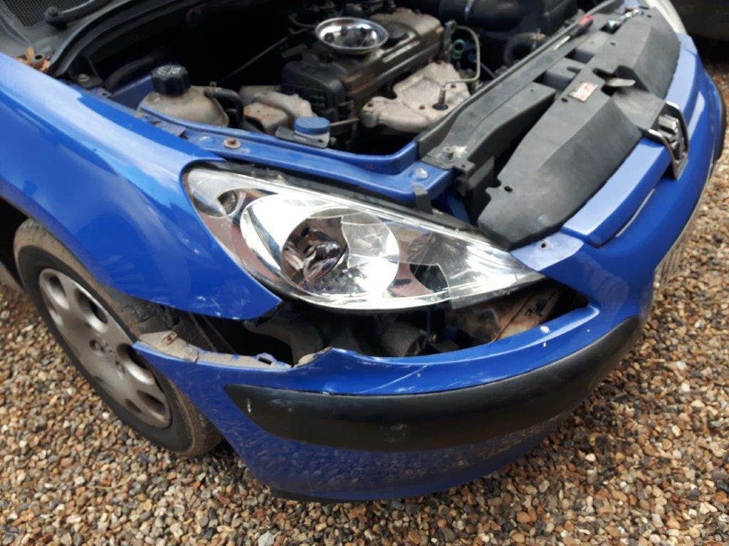

Anyway quick check found that the only real damage was the headlamp unit, the rest had just unclipped itself.

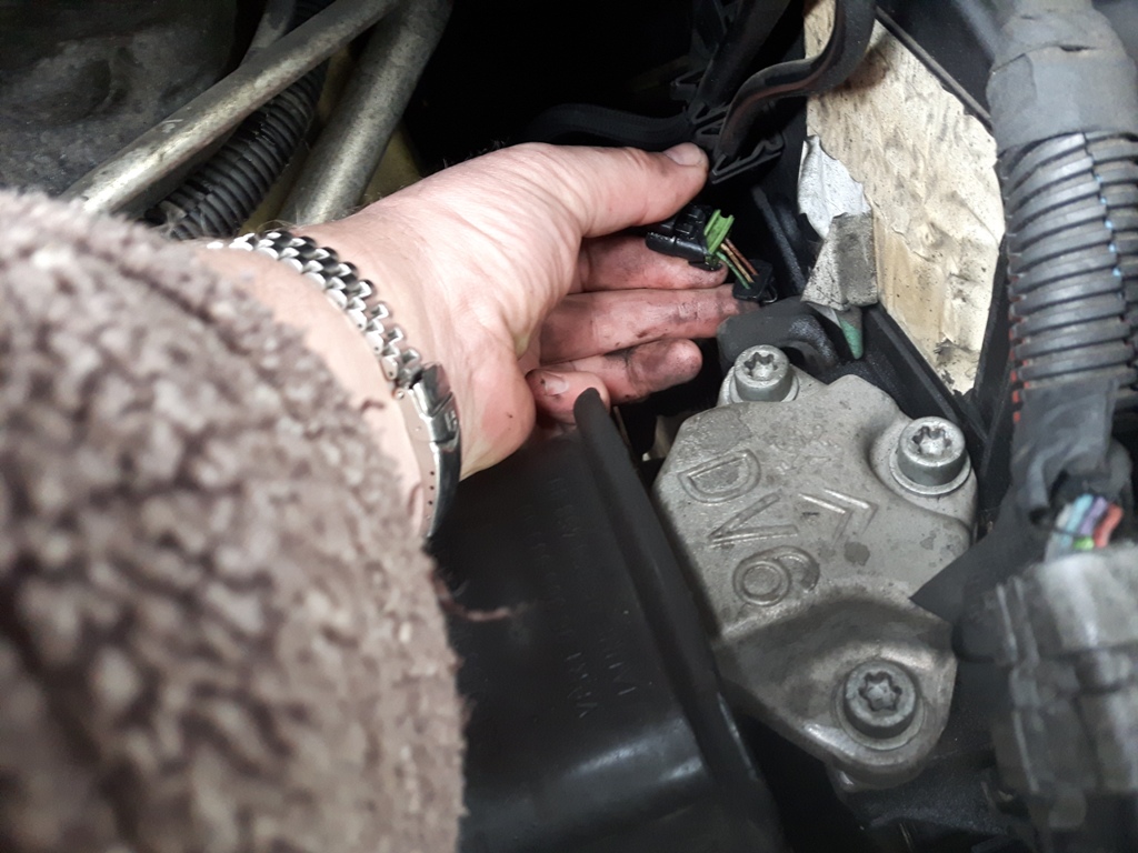

The wing and bumper mounting bracket had shifted but loosening the securing nut allowed it to be repositioned
Then with wing in place, 2nd hand headlamp unit (£27,99 delivered) was fitted and tested. Didn't even have to replace the flippin bulbs :D
20mins later and all done

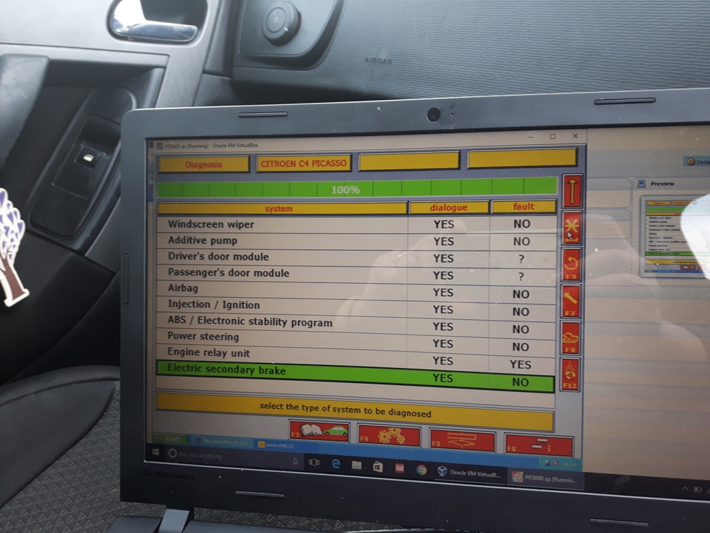

Bought one of those Peugeot Planet gizmos off evilbay last year and have been desperate to give it a go.
Comes with Lexia software to cover Citroen and PeugeotPlanet 2000 for the Pug
Quite a balls ache to install, software only runs from Windows XP. As I didn't have an ancient laptop nor any desire to own one I dipped my toes into the world of Virtual Machines,
Oracle do a freeware bit of s/w called virtualbox for which there are a number of Youtube instruction videos to get VMs up and running. This was the easy bit but then I was bitten by the pain of modern laptops having no driver provision in XP. You also need two mouse devices, one that works inside the VM window and one that allows you to access the host operating system. nightmare. Luckily I had an old desktop with a Windows XP COA that I could use to register the million year old OS. Microshaft kept baulking me when following bodges that are available via google.
So Windows XM VM up and running ready to install the software from CD. only XM dont recognise my DVD ROM player. Eventually found a USB stick that it did recognise and copied the CD onto that.
Installed the software, used the key code generator to get the licence working. I am not bothered about online faultfixing etc as I couldnt get XP to recognise my network port nor the wifi. Maybe I should have bought a shit old Dell running XP afterall!!
Software installed eventually.

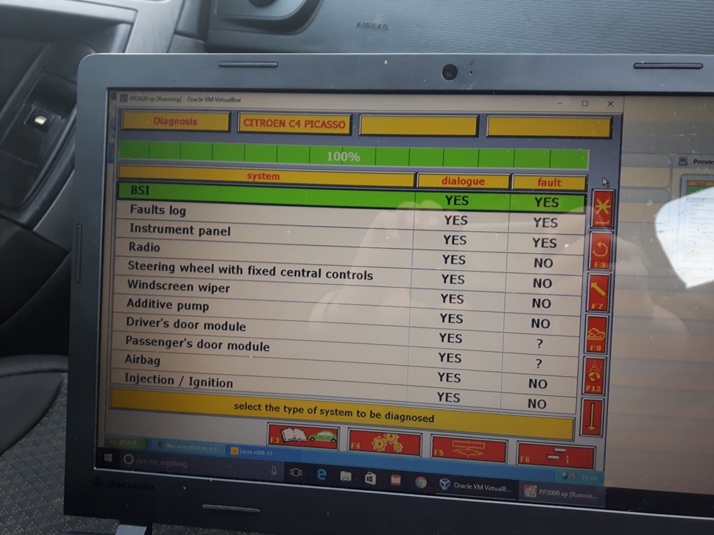

Plugged it into the shitroen first of all. Pretty easy to use except that it has been translated into English via Klingon so some of the instructions are a fumble. In a nutshell use the [*] button to move forwards and the back to front "J" button or Return Button as the software refers to it to go back.
With the cable plugged in and the software loaded I was able to interrogate the config and error logs of the car.
Hmm lots of faults there

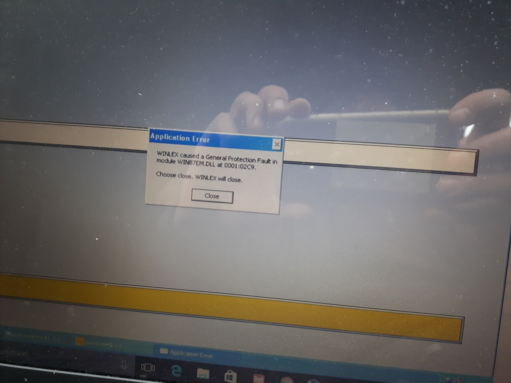

Tried to read BSI faults and found...
Cannot clear faults without reading them first but when trying to read I get this
Arsecakes
Did manage to clear some of the local faults down through seperate sections but it would appear that BSI log is still full with no way of reading faults nor clearing them down.
That said with the faults I did manage to clear the engine is running much smoother and so far no MIL :D

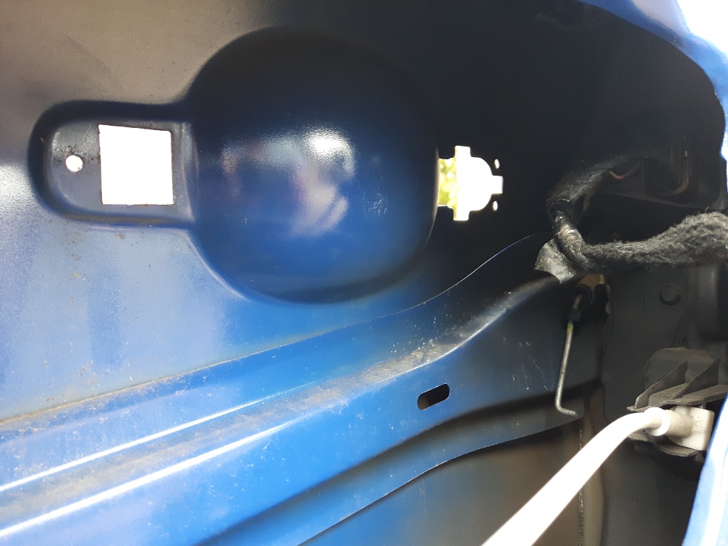

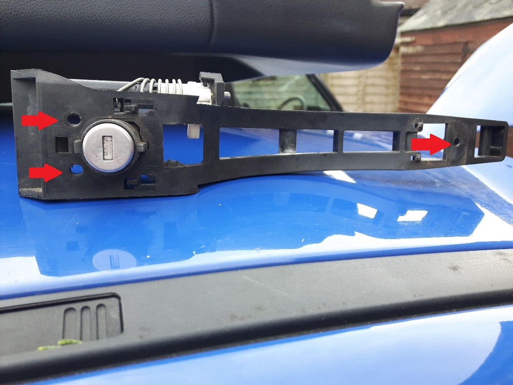

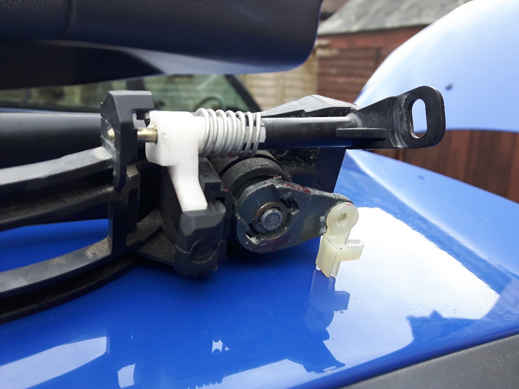

Back when it was freezing Matt Thestag was trying to get into the car when it was obvious that the lock was frozen! Being a complete arsehat sometimes meant that he forced it, and ever since the drivers door lock has been a proper balls ache to lock or unlock. Conscious that this is the only way to enter the car, remote cen locking dont work... yet.. and no locks on other doors I felt the urge to fix it. Only Matt thestag is a lazy bastad and there is no way I was doing it without him at least showing an interest.
Roll forwards to today. Shouted at him until he eventually agreed to come and help.

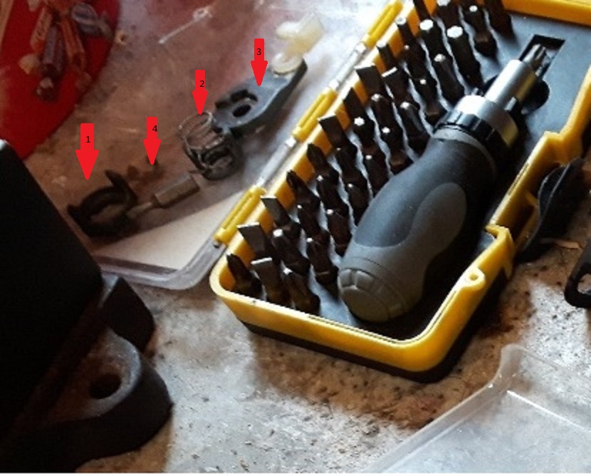

Eventually found that the lock barrel on a 307 can only be removed along with the complete handle unit. i was working blind, without manual nor any real instruction. Pug forums question why you want to remove the lock and then when it is explained the forum fills with metaphorical tumbleweed. After an extensive search of a number of forums and all came to the same conclusion I didnt waste my time asking.
So here it is for anyone with a early noughties PSG with a fucked lock, pretty sure most will be the same.
Obviously remove inner door trim, no real beef here, three screws and a load of those nasty plastic plugs that shatter if you look at them funny. Disconnect window switches and speaker cable then remove the trim.
From inside the door you cant see fuck all until you remove the lower window channel at the back edge of the door. big white plastic thing that guides the window as it lowers. 2 10mm nuts secure it and it can easily be wiggled out of the way.
Because it is tricky to photograph anything while in place I removed the lot and here are the nice pics to demonstrate how it all pops together..
This is the door catch that I removed from the door, 3 T27 screws hold it in place and it is very easy to remove.
Two rods on it attach to the outer door handle, the interior door handle is connected via a flexi cable. Central locking loom can also remain connected.
This is it out of the car. Imaging that you are looking into the door towards the door catch upside down. i.e. the inside of the door skin would be on the right of the photo. The chunk on the left is the door catch as above, the bit on the right is the inner section of the outer door handle, not the metal cam that sits on the back of the lock barrel. I did this pic to show how the two rods connect to the outer handle. Hope this makes sense.
To disconnect the rods, rotate the clip at the end of the top rod in the pic and the rod then slips out of it. The bottom rod in the pic just pushes through the white round slider. keep an eye on it, it is loose and will fall out of the handle. I can imagine that loosing it would be a complete pita and that PSG will only supply a new one as part of a complete unpainted door.. probably
Next and with the outer handle still in the car - removed here for photographic clarity :D
Unclip the plastic bit around the lock barrel on the outside of the door. Three flimsey plastic lugs hold it in place, it pivots from the big lug at the end (far left of the handle in this pic, replacements can be cheaply bought so dont cry if you break the lugs.
Removing that ^ allows the outer pull handle the space to be removed.
This is the handle from the inside again, it is the right way up as if your were looking into the innards of the door. The white lug in the middle is what transfers the pull handle action to the rod with the spring on it and at the other end is where the rod attaches to the door catch. Geddit?
To remove the outer handle you must pull on the outer door handle, at the same time use a flat blade screwdriver to gently persuade the white lug to the left in this piccy. This allows the outer handle to pass to the right of the white lug. You can tell this has happened because the outer handle will pull right out. In this pic you can see the white lug is pulled to the left, look at the central metal rods position in this and the above pics and you will see what I mean hopefully. You can also see the outer handle half removed from the inner frame
To remove the outer pull handle completely it hinges onto the forward end of the inner frame, pivot it out to 90degrees from the door and then remove from the door. dead easy
Next to remove the inner part of the door handle you will need to drill three 4mm pop rivets, the inner part of the handle will tumble into the bottom of the door
You now have the outer handle removed from the door. with the door catch still in place this is your view from the inside. The interior door handle will still operate the door catch but obviously opening the drivers door from the outside will be a fiddle, trying to find the rod etc. Make sure the passenger door is unlocked/ open before slamming the drivers door
Before you make yourself look stupid shouting at the mechanic - if it's a 1.6 or 1.4 hdi then the air filter is up at the back of the engine under the wiper panel - long rectangular one !
Yep I figured that out just after posting that :D. Airfilter was big oblong, the pipes are purely for cold air feed. Now replaced with flexi pipe as PSG intended but on the cheap... as PSG intended
P.S. isnt the airfilter a complete arsing ballsache to get to on one of these?
Yup . Some you have to remove wipers and panel ! Do the fuel filter at the same time !
I must admit that it both annoys me and amuses me that people are so quick to " av a word " with garages / mechanics before looking at the issue properly .
C4 GP start with wipers, top panel, swearing every time you crack your head on the bonnet catch. And yes fuel filter at the same time :D

The bare handle now looks like this

 To reassemble it
With the key in the lock, install the barrel from the back of the handle and the lock from the front. With these in place the key should turn through 90degrees easily, if it dont something has gone wrong. With the lock and barrel installed into the handle you can remove the key and continue with the install...
Shit photo, I thought I dedicated one for this but failed :D
Working from the back of the handle the bits go back together in this order and in this orientation.
1. Big sleeve goes onto the back of the handle first
2. Small sleeve and spring goes next
3. Cam goes on next, the spring is held the springy side of the lug on #1 and #2
4. c clip holds it all together

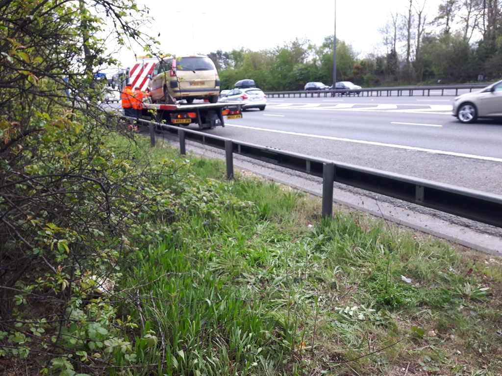

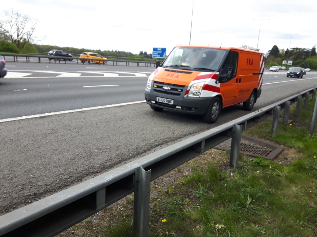

Trusty family shitrown c4 Grand Picasso treated us to a FTP Easter morning on the M40exit to M25. Oh the joy
Result = 3.5h late for lunch at Bruvva Thestags house
FTP was down to a shredded alternator / accessory belt which on it final last gasp yanked the Crank posi sensor out. Didnt really fancy fitting that on the M40 when 1/20 cars hit the rumblestrips in a late exit / stay on the m40 type manoeuvre.
Called the RAC and enjoyed the Easter morning sunshine. Mrs Thestag and the Twin thestags.
Recovery agreed that fixing at the roadside was not safe so offered recovery home. this fella arrived at 1h 20m since breakdown. real nice bloke but the wagon was broke :( And yes mrs thestags Shitreoen is a right fucking shed
He called on his mates who arrived 20 mins later, with the shitrown unloaded the recover bed still would not work,
they chose to fix it
Mrs Thestag chose time to pick wild flowers from the verge
Finally fixed, loaded and ready to go 2h after breakdown so happy days and still in good ish humour.
This morning found the root cause of FTP. this was right chewed up. need to come back to this fella but it did relocated with a satisfying click. just isnt waterproof anymore
The belt is a piece of piss to replace according to the web, just need a 15mm spanner and a 4mm metal drill, spanner winds the auto tensioner back and the 4mm drill holds it in place while new belt is fitted
Old belt removed, thanks to Eurocarparts for being open on Easter Monday, Halfrauds dont sell anything useful any more it seems ;-)
Old belt is proper fucked, I am servicing this thing myself from now on, getting the local garage to do it is a fucking waste of my money
New belt is fitted but by now the post on the tesnioner that the 15mm spanner goes onto has dissolved. Thus the tesnioer is jammed open by the 4mm drill bit.
After some brief swearage and cussing at the fucking thing a little lateral thought found a 15mm socket and ratchet provided ample assistance. Shitroen is back up and running. need to do timing belt now I thing as I dont trust service history anymore, Is 1.6HDi a "safe" engine or is it an "angry interference" type chap?
