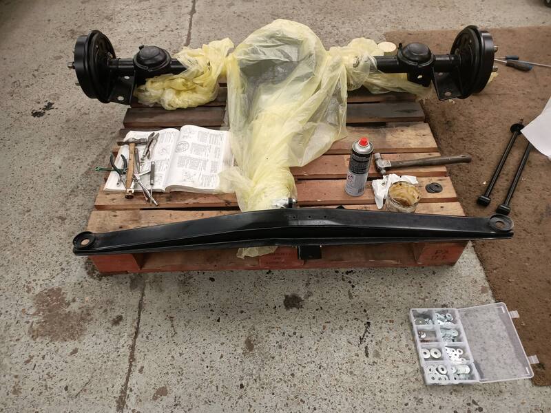

with the subframe back in the car next up was the rear axle, first job was to to rebuild the brakes so it need new drums as one of the old ones was very badly scored and worn and the other side looked as if the brake hadnt been working , its got new shoes wheel cyliders and hanbrake leavers and the springs were cleaned and painted.
with that done i put the crossmember on the front of the axle
next was to make up the brake pipes for the axle i kept the original pipes to use as patterns i decided to remake the brake pipes in the original zinc plated steel.
i was pleased with how these came out here they are fitted to the axle along with the tie bars , new watts link and a new handbrake cable with rebuilt compensator so the handbrake should work alot better than it did.

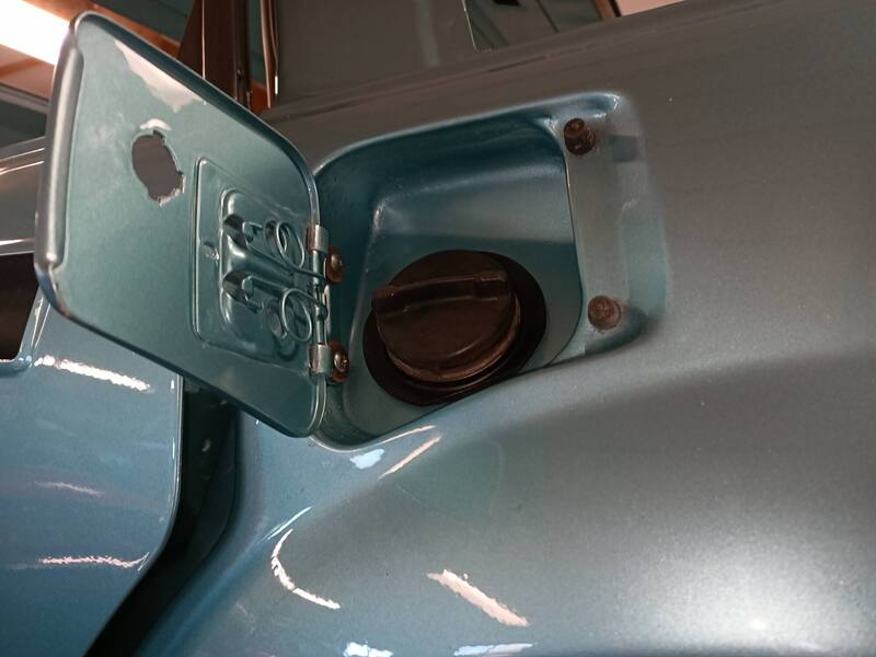

thats the axle ready to fit, next up was to clean up the fuel tank and filler pipe the bottom of the tank was in very good condition  because someone in the past waxed the bottom of the car the top of the tank not so much but lucky all surface rust.
the tank sender was a new unit just before the car came off the road so was still good i tested the pump and to my amazement it still worked though i shall be keeping a spare pump in the boot. i put a new filler hose and breather hoses on and cleaned up the plastic fuel line ready to fit. i  also cleaned up and painted the fuel fill pipe .

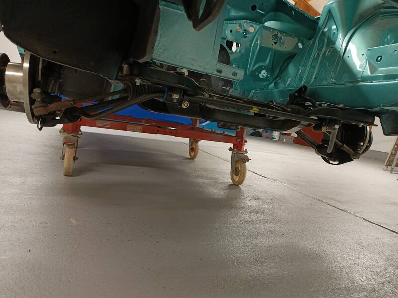

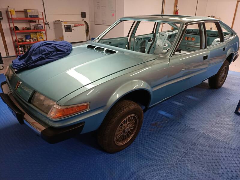

so with the tank in it was to time for the big moment, for it to go back on its wheels for the fist time in just over 2 years.
this moment felt like such a milestone this now means i could start fitting the doors up and start the wiring .

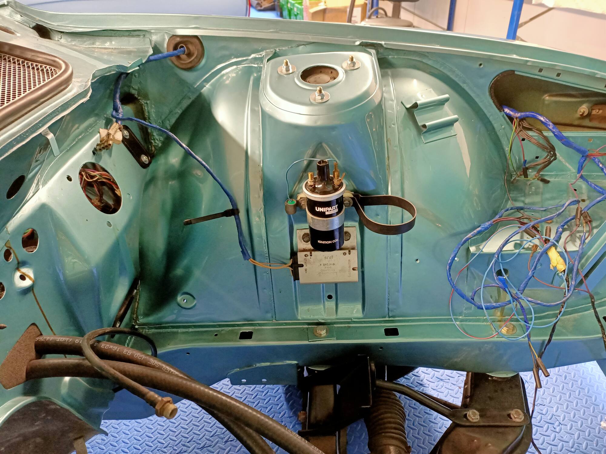

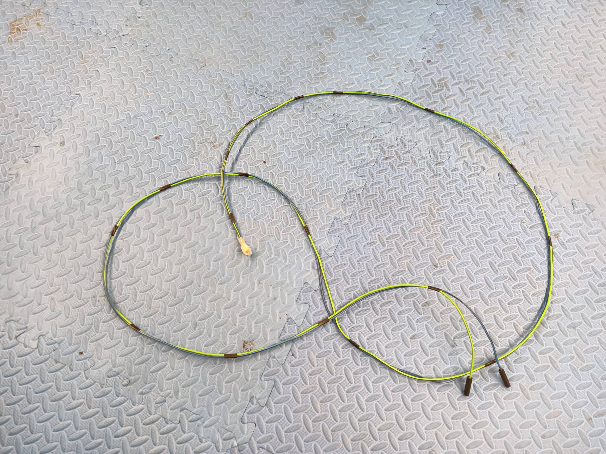

with it back inside it was time to finish repairing and fitting the main wiring loom. the loom was damaged when it had the wings changed Meany years ago they hit the loom with a grinder badly slicing about 5 wires  one being the main earth running inside the car, instead of fixing the damage they just taped over it and left it. so with it fixed and re wrapped I refitted it.

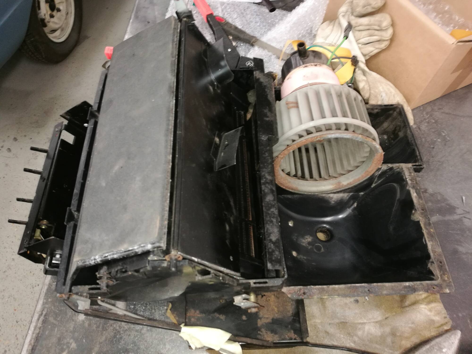

a little while back I refurbished the heater box I had to buy a second hand one from a car that was breaking on eBay as my original heater box had all the link rods for moving the vents cut for some reason and the plastic box itself had been broken in places. so with the second hand box I pulled it completely apart re foamed all the flaps and fitted a new heater matrix and gave the box a really good clean

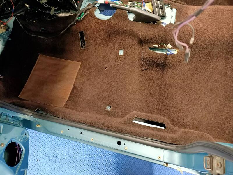

I dug my carpet out of the garage at home and got out the carpet cleaning hoover and gave it a damm good clean as it was absolutely horrible 30 odd years of muddy feet plus being in my garage for the last 2 years it was pretty horrible but came up really well.
the stuff that came out of it was absolutely disgusting this was what was in the machine after the second pass.

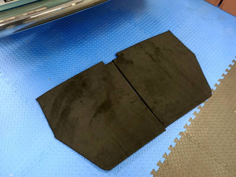

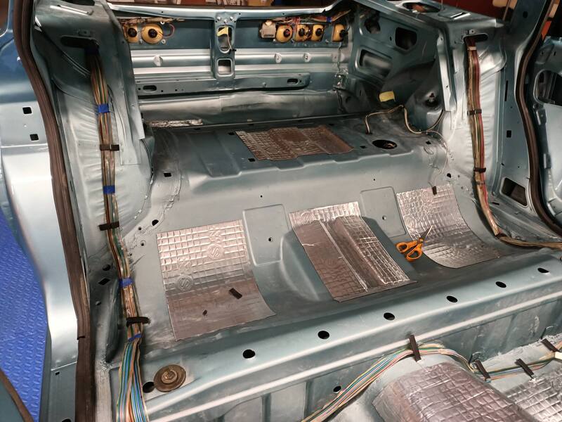

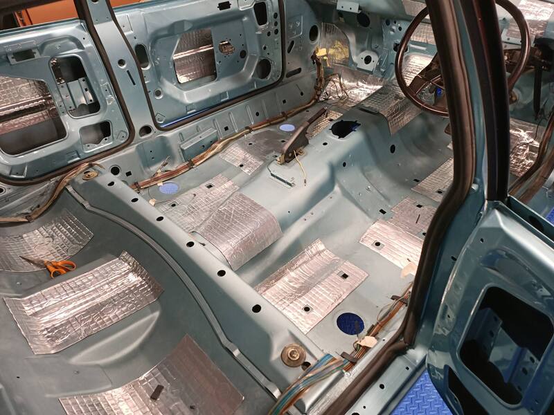

nasty but with the carpet clean I made up some new thick sound matt to go under the carpet and l put the carpet in the car to help it recover its shape.

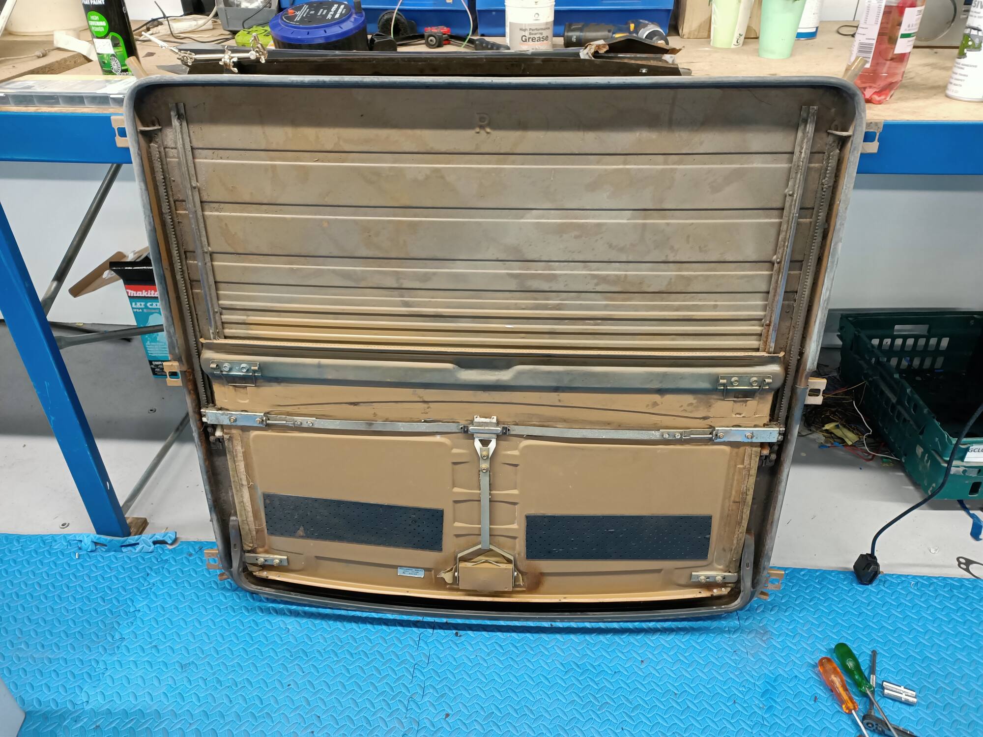

next I put the sunroof back together I gave the tray a really good clean and I employed the service of triple rich to help recover the sunroof panel with the new fabric as upholstery is not my strong suit and I really didn’t want to mess it up rich did an amazing job it looks brilliant.

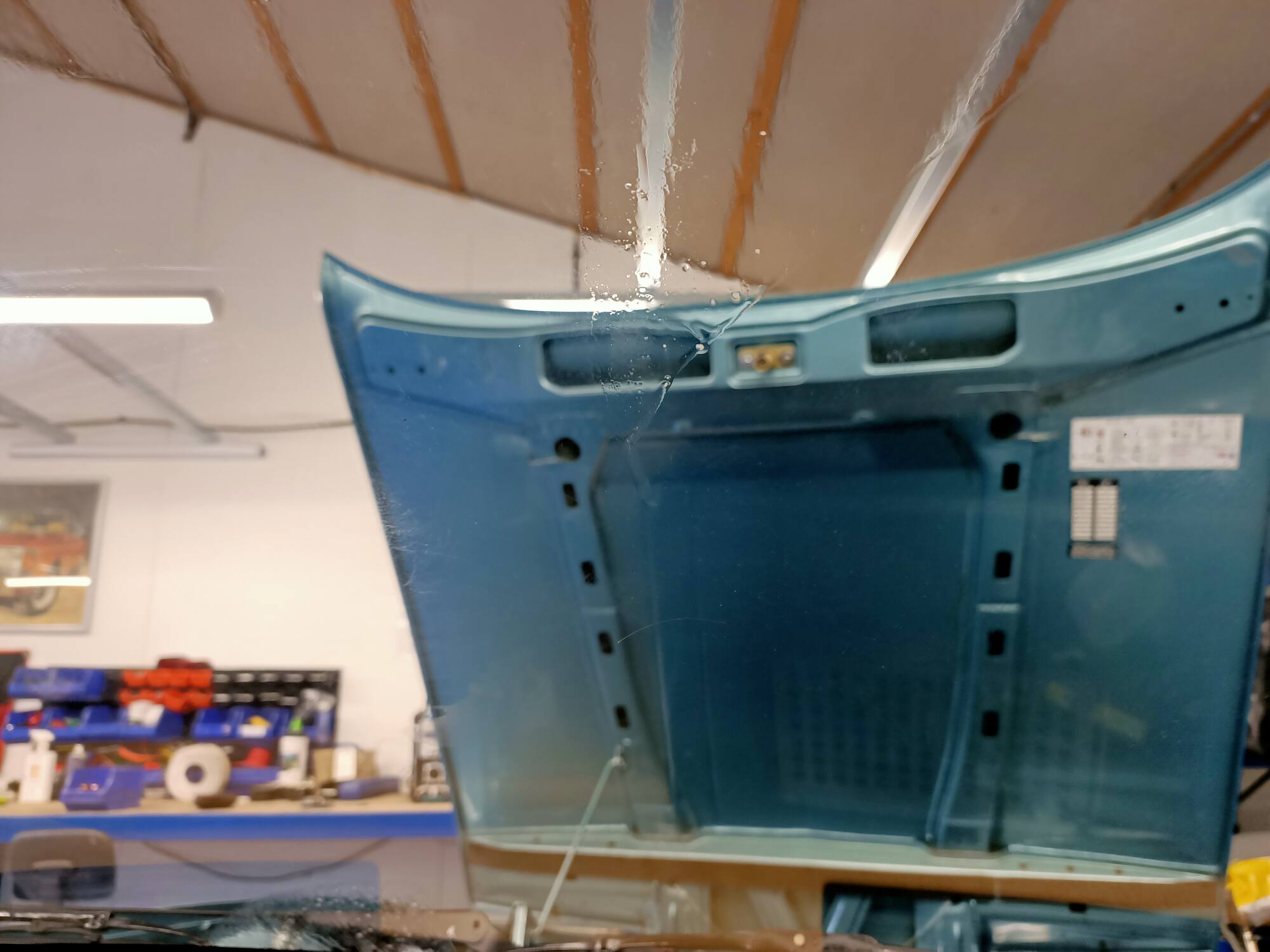

rich also helped fitting the tailgate glass I got very lucky a few  years ago and managed to find a new old stock series 1 tailgate glass seal these haven’t been available for years and rimmer bros only sell the series 2 ones which are different .
it was quite difficult to fit but went in nicely I almost have a full set of windows now I just need to get a windscreen. next I cleaned and fitted the coil and piped the washer jets and fitted an new washer bottle and pump.

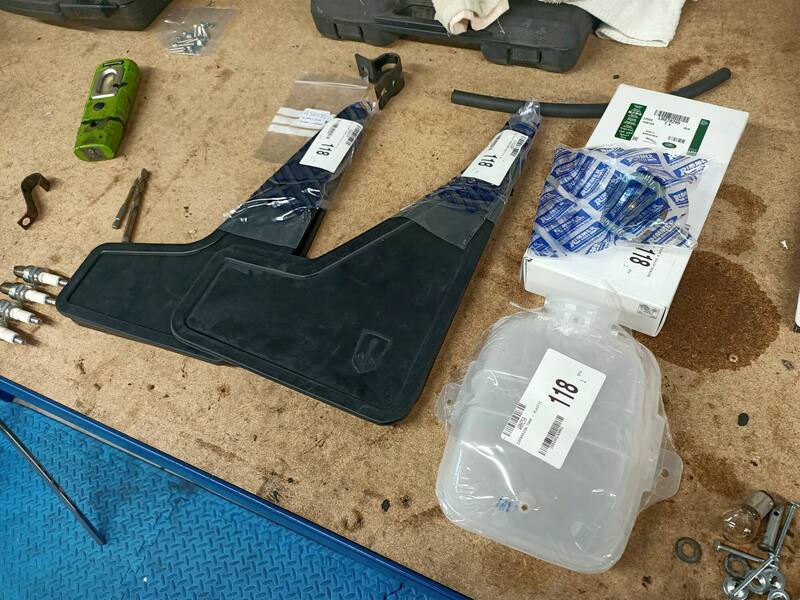

it was at this point a huge box turned up for me
IMG20200718093131.thumb.jpg.a271e833144fba40cb1a2effa9d1fb8e.jpgi
this box contained some much need parts such as a new expansion  bottle a lower front valance a set of genuine mud flaps and most important a windscreen and bonding kit.

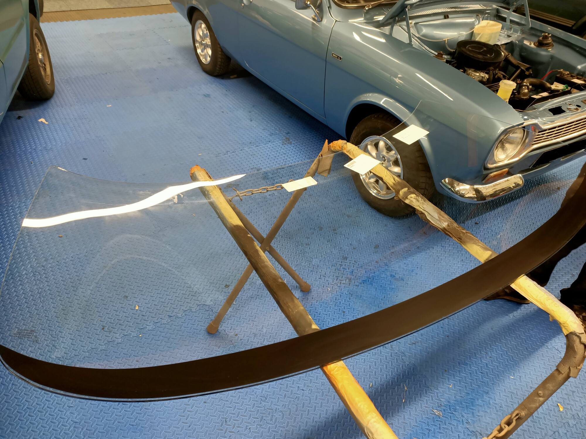

so I employed the skill of rich to bond the screen and chromes in as he has done it before and dose and excellent job.
all bonded in and looking good so that’s a full set of windows. I fitted the new expansion bottle and cap.

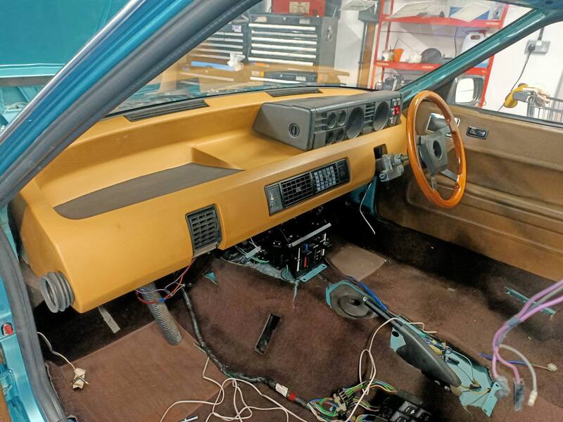

next up was something I’ve been waiting to fit ever since I bought it years ago
what is it a new old stock dashboard .
this dash has been all the way to America then sent back as it was for a right hand drive car. I  also took the instrument cluster apart and cleaned and fitted it
it so nice to have an undamaged dash. next I cleaned up the door cards and fitted them I need to paint up some surrounds for the rear door locks but fitted the cards to prevent them getting damaged.

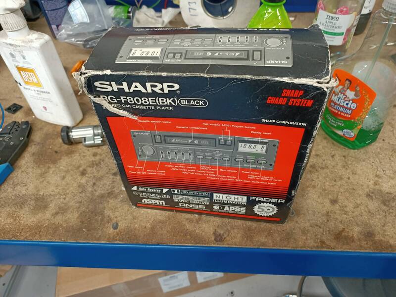

the radio came with the warning stickers for the window so i fitted one to the windscreen.

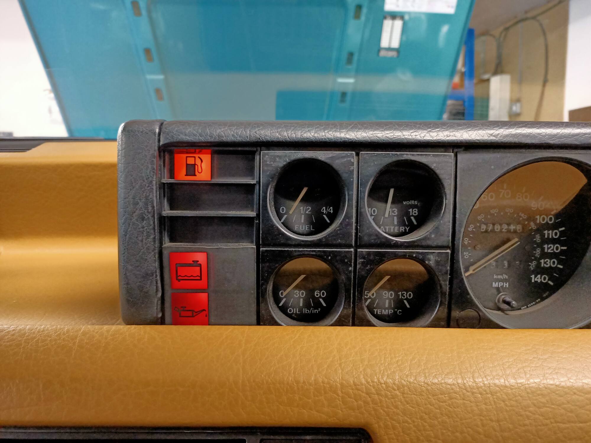

so the time had come to be brave and connect a battery up this bit makes me nervous as I always think something is going to explode but the battery was connected and no magic Lucas smoke appeared so I turned the key.
WE HAVE LIFE this was so exiting so I started going through and seeing what else did or didn’t work  I put the headlights and fogs on and this brought the first thing that didn’t work the dip beam, side lights work but no dip beam other than that all the other lights worked even the bulb failure light works and it did indeed have two blown bulbs in the rear it went off once the bulbs were replaced .
the indicator’s work but hazards don’t  so that’s another thing to look into but all the windows power up and down the heater blower works and the central locking partially works. next up was to try the wipes witch work well with two speed and intermittent , so I did the hubnut wiper test and.

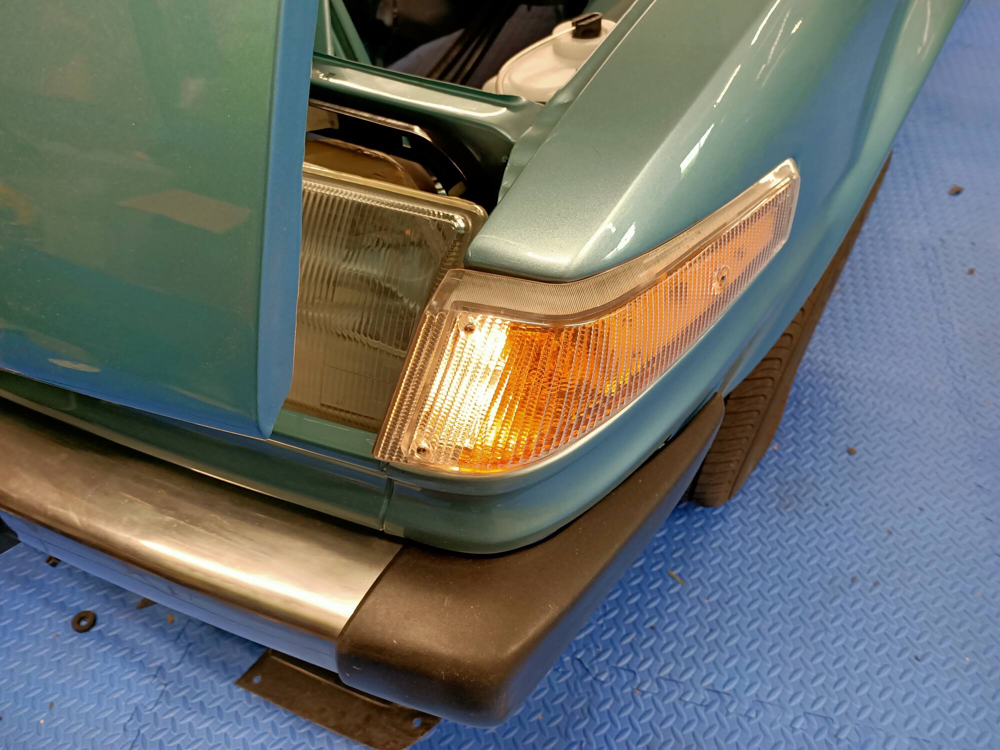

yep triangle of doom and dribble!  next was the front fog lights my intention was to clean up and reuse my originals but on closer inspection on had cracked  down the middle so I replaced them with some nos one I got years ago for 10 quid.
putting the old an new side by side  shows how much the old ones had discolored inside
so I fitted them to the new undertray and fitted it to the car
