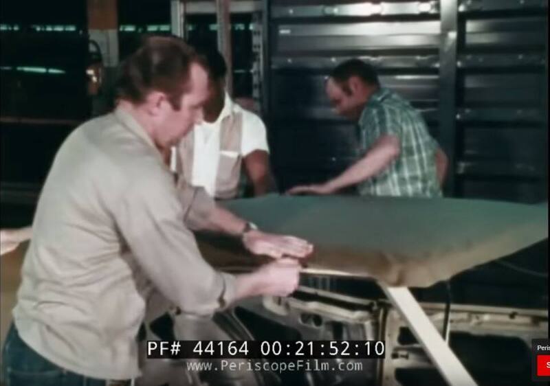

I saw a pic somewhere of the vinyl clipped into a rectangular frame which was then lowered onto a roof. I've no idea if this is how they were all done but it did seem quite a good method of getting it in the right position.
I'm sure there were various methods.  I found this the other day which is worth a watch.  GM in the 70s put about 3 or 4 guys on the job.  The vinyl looks to already be cut to size before its fitted.

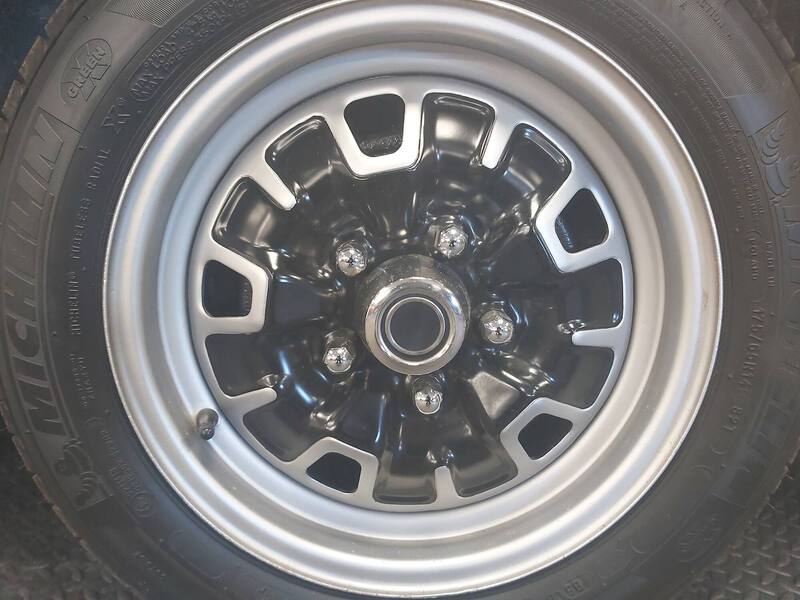

Which wheels are you fitting? All three types are fine looking.
I'll be going for standard GL spec which is the 'sport' wheels with a chrome embellisher around the rim.  They need to be overhauled but they are a decent set of 5 with not too much corrosion.  I may pick up at set of the alloys in future as I quite like those.
I always thought the wheels made a massive difference on Mk1 Granada's. When fitted with the standard hubcap type the car IMO looks really dumpy.
The alloys or GL sport ones really lift the looks.

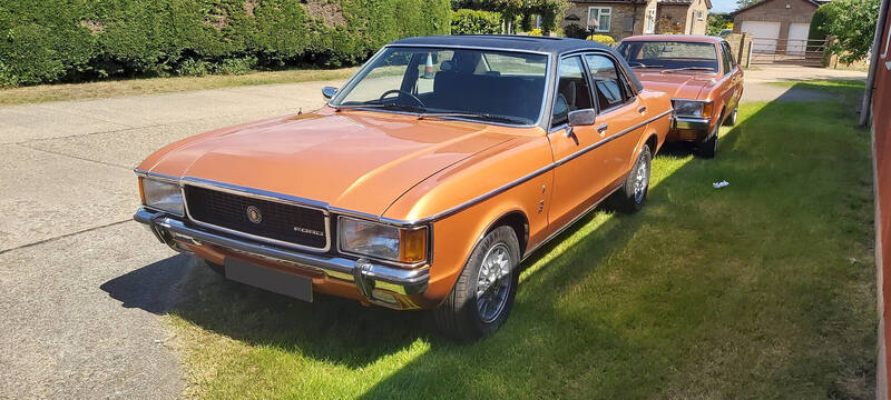

I've also finished the Ghia pictured a page or so ago.  Pleased with this one, I spent a lot of time cleaning red over spray off so many parts.  Lot of work to get the trim looking like it does now.  Requires a sunroof seal, mot and road test before returning to the customer.
675029231_20200519_125817altered.thumb.jpg.9a3f39d1ec3b9906019330962f2773a1.jpg20200519_144434.thumb.jpg.c23c637b67126ec9579e5b8ebace3ef5.jpg
Hoped to move on to something different.  Nope, have a Mk2 Granada Sport instead...  Cheers!

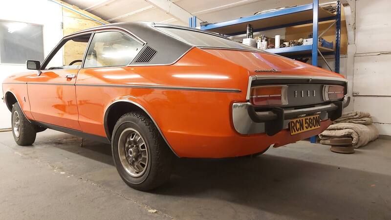

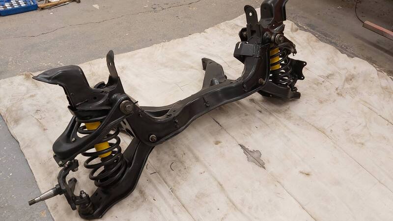

I've reached a milestone.  The car is now back on it wheels which brings 3 years of sitting on body rollers and trolleys to an end.

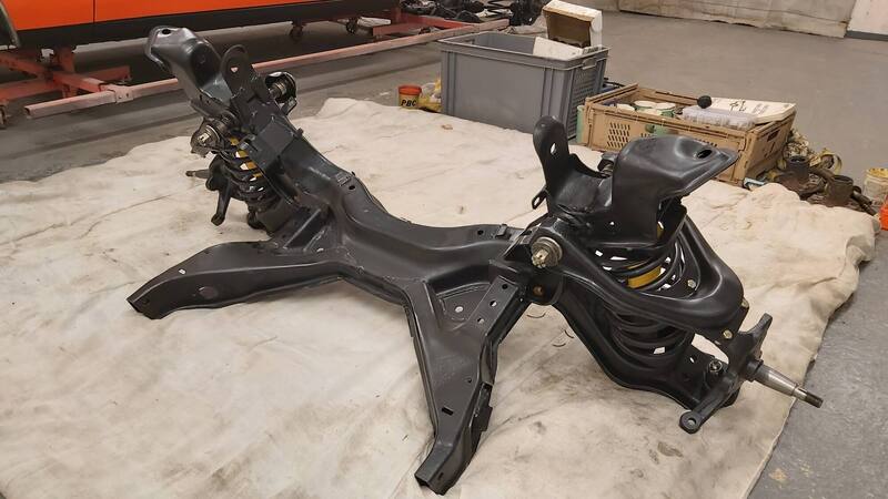

First I built most of the front sub frame.  As usual everything is either new or overhauled.  The front springs are not much fun on these, have to be very careful and try not to scratch anything.
20200523_142809.thumb.jpg.0c00744995fd7a347cad0d38cf5a50b1.jpg20200523_142828.thumb.jpg.efe7e0704f0578984cc1879c7e90ed94.jpg
Plenty more to fit but at this stage its easier to finish once installed on the car.  Fitting is very easy via 4 large bolts through the chassis legs.  After fitting I overhauled the front hubs, painted them and fitted new wheel bearings.  Below you can see the cleaned & painted stub axle just prior to fitting the hub.

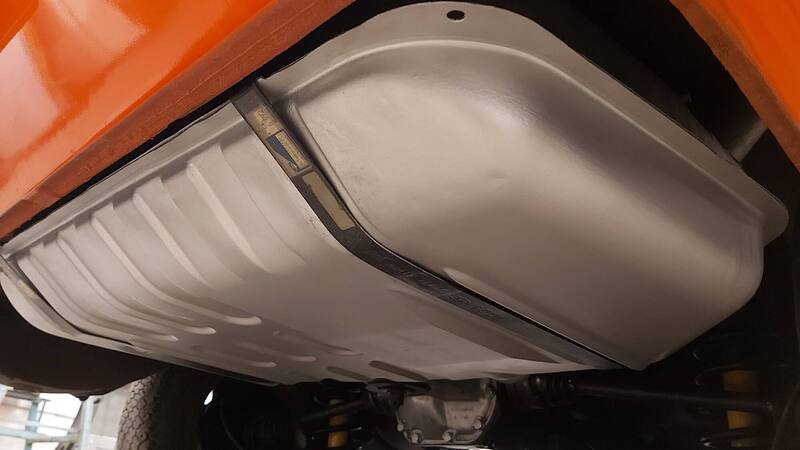

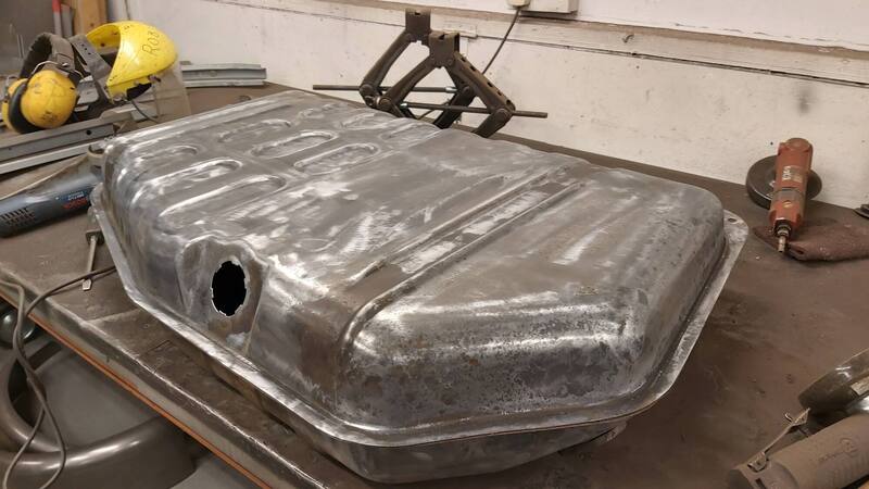

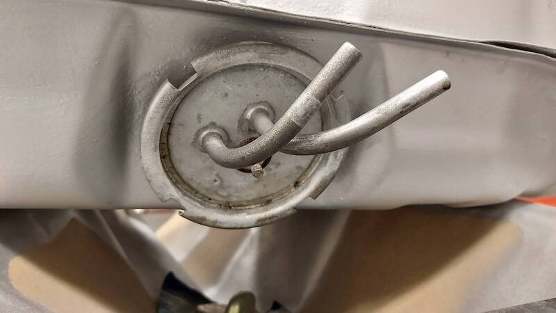

The original fuel tank is a right mess.  Despite being rotten its also quite beaten up/dented.  Luckily I was able to obtain a secondhand replacement that was clean inside.  On the outside it was the usual mix of stone guard and rust.

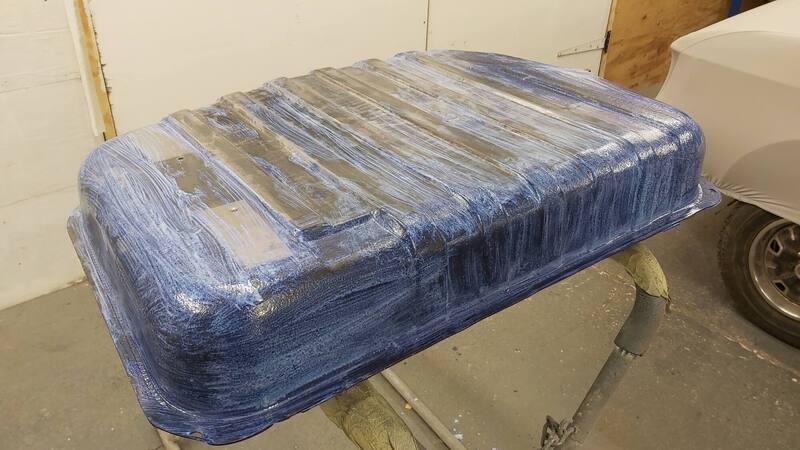

I've stayed a few nights this week and got the job sorted.  Removed all the loose rust and took the tank back to bare metal (about an hour of noise and mess).  These were never painted from factory, they just had a very thin e-coat or anodized finish which never lasted.
Applied a rust treatment and left to cure.  Once compete the rust turns black.
20200526_191209.thumb.jpg.8ea4593e0766948959a02b6cbaf95e97.jpg20200526_194204.thumb.jpg.0dfac9e88ecc9b76e416d4c7e87b26b4.jpg

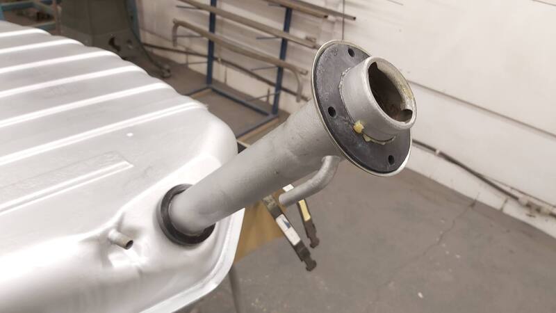

Coat of etch primer and then some silver enamel.  I usually stone guard customers tanks for max protection.  Decided on a less robust but more interesting finish for my own tank.  I also rinsed out any dirt that got into the tank during the process.
20200526_194933.thumb.jpg.345911dd3fd00d10b068aa11694fea6a.jpg20200526_200641.thumb.jpg.c665d108fd9daa367c40fc81daa1d649.jpg

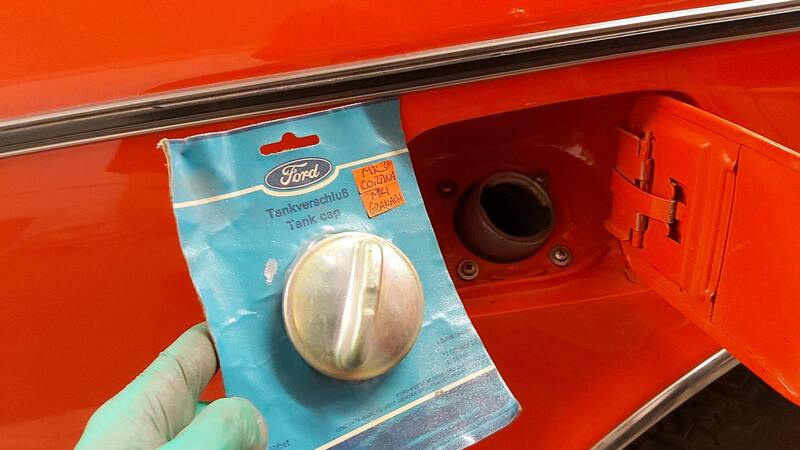

Cleaned & painted the filler neck.  New old stock seals & sender have been fitted of course.  Being a face lift this car is fitted with a fuel return line hence the two outlets.  Early cars didn't have this which can lead to hot start & vapor lock problems on some models.
20200527_191542.thumb.jpg.79de3ebab3fd077ab038c09f52724d37.jpg20200527_191559.thumb.jpg.843843070a9653802accbf2a81f4365b.jpg
Fitted to the car with new tank straps and rubber pads to stop it rubbing the boot floor.  Not the easiest of jobs but I'm pleased with the result.  Contrasts nicely with the black stone guard on the body.  I'll tidy up the red over spray on the floor pan at a later date.
20200528_182519.thumb.jpg.9ff43d9c54cde9a4caa99f142106533e.jpg20200528_182537.thumb.jpg.307e41ddb8c72867845589da35ca7c49.jpg
The finishing touch
Another job ticked off the list.  I'm getting closer to engine & gearbox with each day.  Will sort the fuel lines out this weekend.
