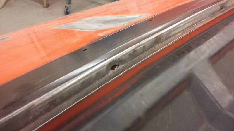

First I took all the old paint off the roof.  As said before I have to do this to expose all the tiny rust blisters lurking beneath the original paint.  It a horrible job and you get covered in red dust so its important to wear a mask.  I also put a big fan in the roof of the workshop earlier this year to help reduce the amount of sweeping up.  Surprising how much difference its made.
While doing this I found two very small holes in the rear window frame.  Only took about 10 mins to mig up as they were so small.
20181027_101438.thumb.jpg.20cd406e8475ba82e78c94c659a0c6ba.jpg20181027_101448.thumb.jpg.d3a0653d6ea719270630a66c51a517ff.jpg
Moved the car back into storage and painted the roof making sure it was well prepared and thoroughly degreased before applying POR.
20181027_115239.thumb.jpg.c44060f35ca6b0e085cd1584fec9a210.jpg20181027_115306.thumb.jpg.8e4ca3313849f167318b69071d598b89.jpg

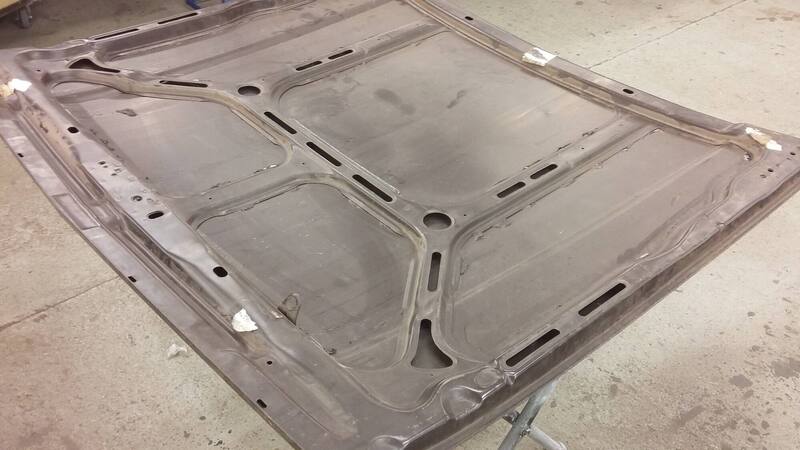

With the shell out of harm’s way I set to work on the bonnet.  This is a genuine panel but like many NOS bonnets the frame has de-bonded from the skin.  They are bonded with seam sealer in spots along the edges of the frame.  I dug out all the old hard sealer and replaced with fresh stuff.  Left the panel to dry leaning against a wall as leaving it upside down can glue the skin too tight to the frame causing all sorts of issues.

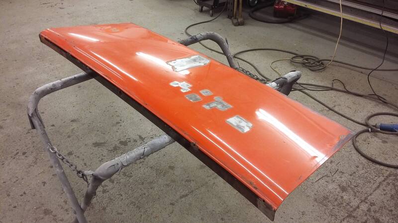

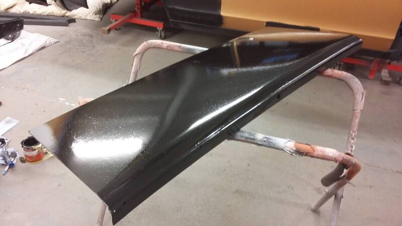

Then removed all the paint from the original boot lid.  Again I have to as its pitted in many places.  The POR should stop that in its tracks and allow me to paint over the top knowing no moisture can get back down there.
20181027_130700.thumb.jpg.d152d10d59c1031e44344256bcb685c9.jpg20181027_140239.thumb.jpg.889f7141b3c64b4668aba6310bf182bd.jpg20181027_141735.thumb.jpg.b43beecd1fbbdcae14e522520f23685e.jpg20181027_141743.thumb.jpg.a1bc9901f496e8191ed0ff60638cae86.jpg
Again the metal was thoroughly keyed and degreased before painting.

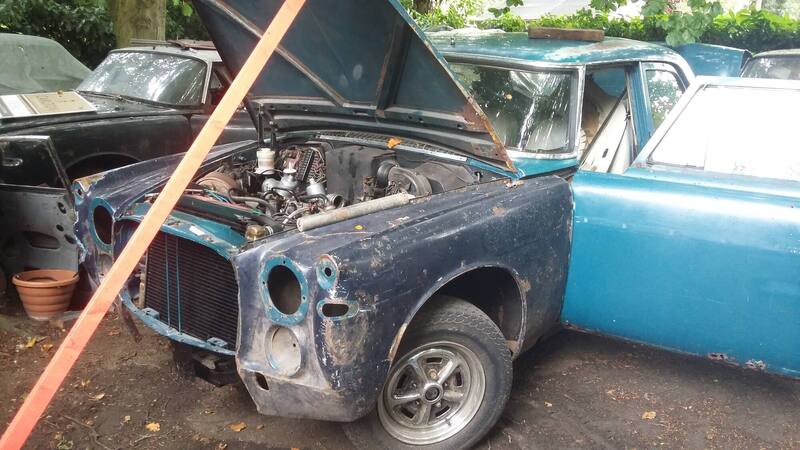

Its an interesting one to work on as its a 3 litre saloon.  I didn't realise just how many differences there are between the P5 saloon and the late P5B coupe.
I've paid a visit to a well know breaker of P5s a few times now in my hunt for bits and pieces.

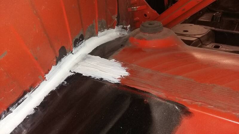

Back on the shell I've seam sealed the relevant areas inside the car.  I've used a scotch brite to replicate the original finish and blend the fresh sealer with any original stuff which is still present on the few bits of the car that were in good condition.
