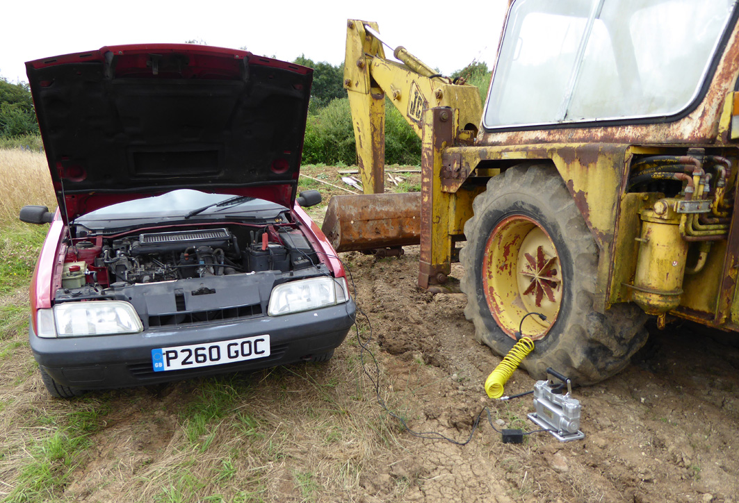

I bought mine from a 4X4 centre and it had been great but has no branding. It just says, twin motor 4x4 monster heavy duty air compressor twin pump 12v.
Makes light work of my Range Rover tyres and manages my digger but works hard. I think I paid about £70 for it 5 years ago. My only criticism is the on/off switch is near the pump and the gauge is nowhere near, but on the airline inflater.
