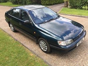

You need something like a Corolla or Carina automatic, they tend to just keep going and quite a few in budget
^ fantastic cars carina's 1000000 taxi drivers couldn't be wrong

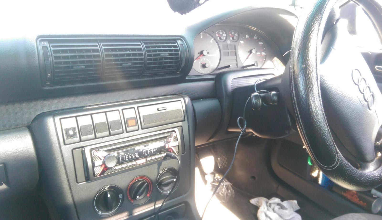

The poor thing would rather kill itself than listen to your great* CD's...
Engine kippered I guess but everything else still works. Alloys might be worth a bit too
