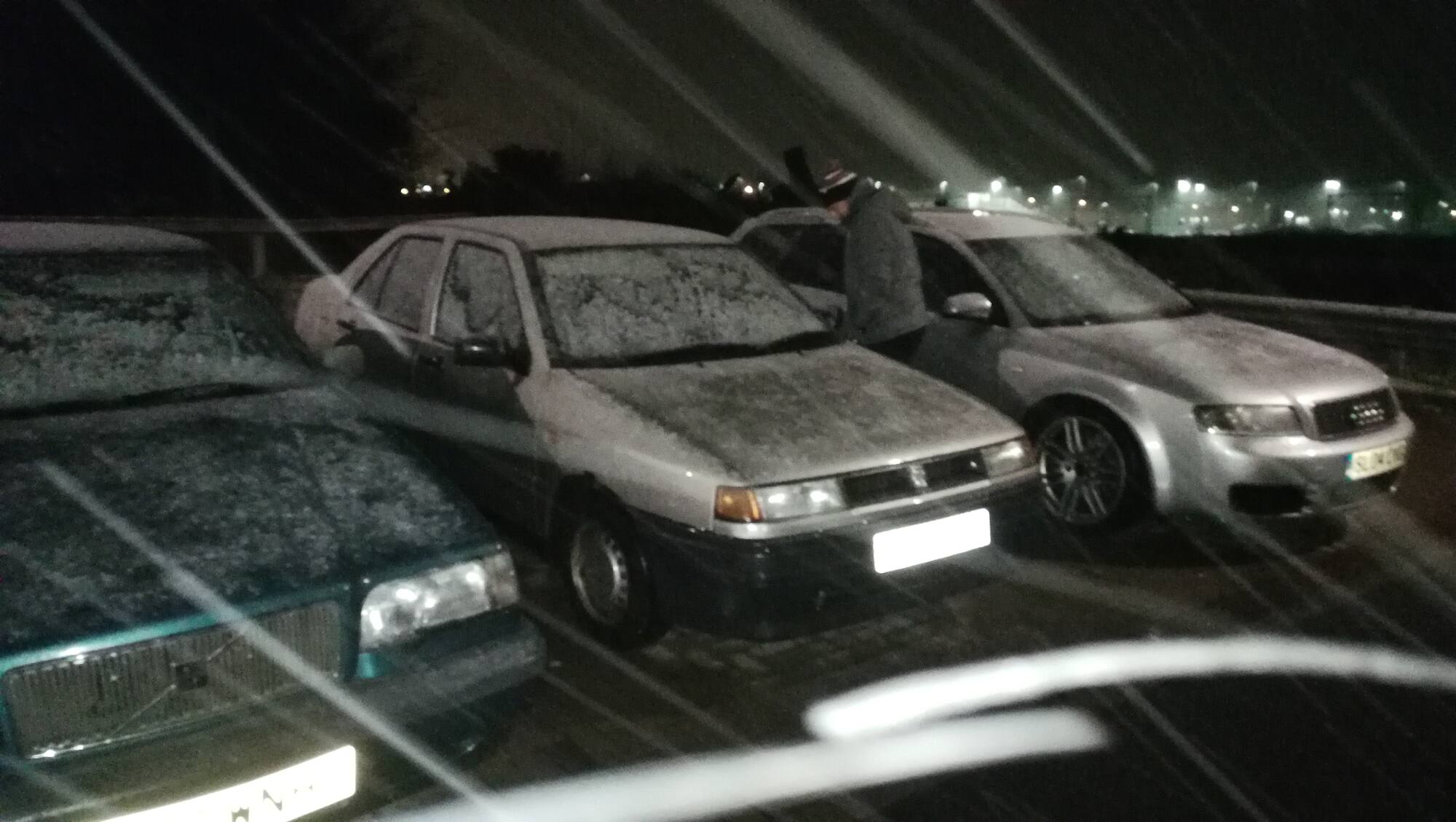

This has been doing sterling service as a daily hack.
Today it was on Scotoshite duty - and that included being in the general location of the venue a bit earlier than usual.
I met up with Dome of this parish at a nearby Morrisons - having jumped in to get Somnath for my lunch on the morrow.
Upon espying the S4 burbling past, I started the Toledo and drove the 120m to the petrol station. Put 20L of fuel in the car and then moved it over to the air compressor to wait on Dome after the S4 had ate it's fill at the LPG pump.
Dear reader, at this point I made a critical mistake. I switched the car off.
With Dome in train, I decided to set off.
The Toledo thought different. Not even a peep. Even with a bump start, no dice.
Now, what I needed was a set of jumpleads - a set was in neither car. Nor the petrol kiosk or the substantive supermarket.
Time to call out the SVM! The 463rd rescue service..
Whilst we waited on the SVM Patrol, we watched the snaw come doon.
Presently, Patrol RML2345 arrived with his leads, and green boxy jump start machine
As soon as the leads were connected, (and before the Volvo was fired) she keyed on and started lovely.
Scotoshite was successfully reached, and I am just in after an entertaining snow filled trip home.
Cheers again to @dome and @rml2345 for the help - top chaps!

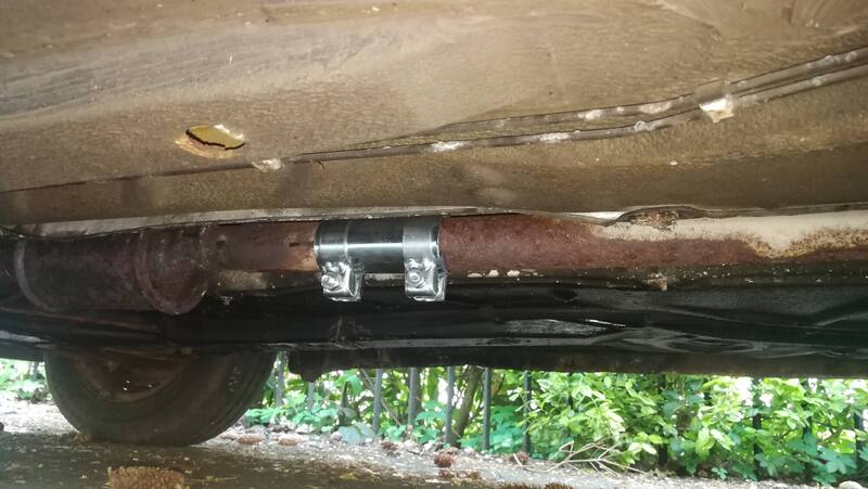

This decided it didn't like having the mid pipe attached to the downpipe..IMG_20200311_162802.thumb.jpg.3fbc0906b65118d58a6067473c0fdaec.jpgIMG_20200311_163302.thumb.jpg.6e69ca68a69c9706d2c3152bbef44c45.jpg
a new centre box appears to be about £40. But no doubt the Backbox will be grumpy too.
i'm off work tomorrow so may investigate further if weather permits. The car is currently at the hoose:)

We now have an exhaust in stock. It came in two pieces so I am wondering if I can get away with just fitting the long pipe from cat end to the mid box (actually located over the rear axle)
Need to push the golf out the way first...
I borrowed a grinder and a jack off of the neighbours and set to sorting the exhaust.
Initial investigation suggested it would be a pain.
The original mid section and box are one piece, and the floor of the car has a bar bolted on that would make getting such a length of pipe out somewhat difficult
Rather than have a huff, I decided to to think inside the box. The sleeve joint provided with the new exhaust was long enough to join the existing pipe to the cat section.
5mins with a grinder and hammer had the pipes ready for the joint to slip over, and get persuaded* into place.
*Twatted with a hammer
The result?
Started it up and it's silent as a fish:)
It'll at least do until I can get over to the unit to fit the whole new unit.
