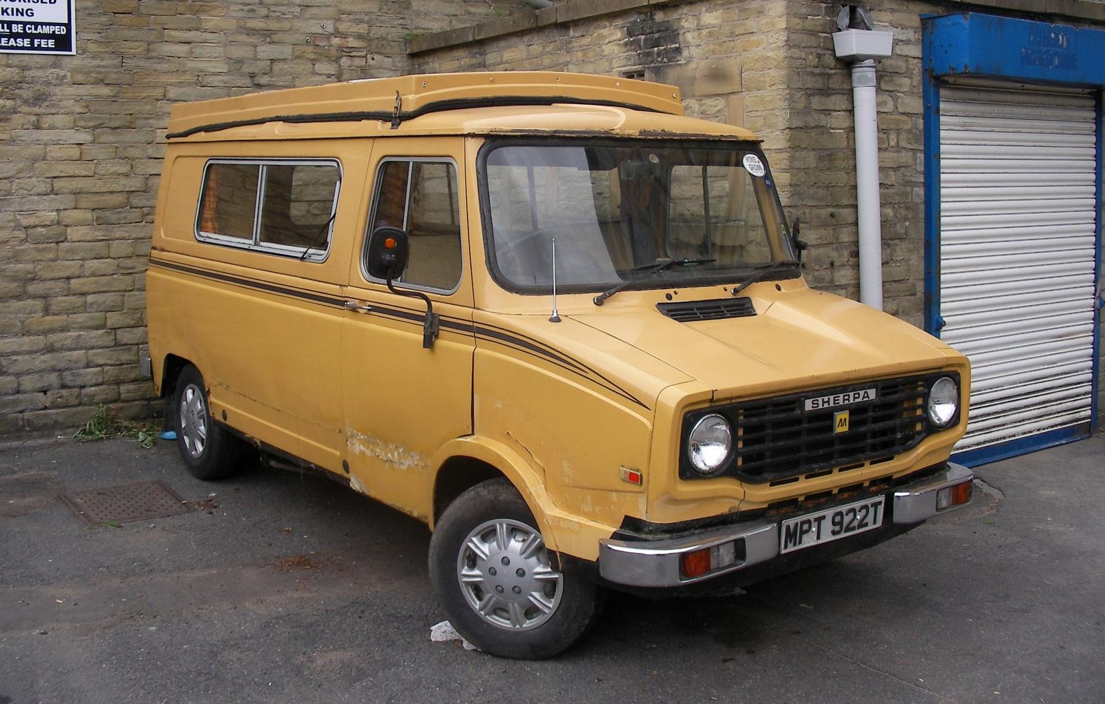

Hello all, this is my new shite! A new addition to a family comprising 2 Triumph Acclaims, an Austin Ambassador and a 240 estate... My 78 Sherpa Autosleeper - acquired months ago after seeing it looking sad in a field and later stumbling across the owner in a pub, a few pints and £50 I'm later restoring her for my dad's 60th so he can tour in it as he gets older. Bought a Sherpa as we had a freight rover 200 as a family car while I was growing up; I believe it had the MDi diesel in it (which prompted a rational hatred of diesel engines thanks to a blowing exhaust and being one of 5 lads I was always in the back with the fumes). Steadily making my way through the standard rust issues - of which there are many - but I'm not sure about the engine. It's got the O series 1.7 lump which is seized solid. I could rebuild it but parts are hard come by and these vans are notoriously underpowered so I think I'm going to drop a different engine in it and (if possible) fit a PAS box from a Pilot. The question is, which engine? It doesn't need to be fast, just torquey and reliable (the thing weighs nearly 2 and a half tonnes). I don't really fancy a modern engine due to the wiring challenges, and my dad hates ECUs after the only brand new vehicle he's owned (an 05 pilot) gave him nothing but trouble. Also don't really fancy a diesel as it takes some of the period charm away from the van, and I can't stand the smell... reckon at the moment a 2.8 Cologne v6, heavy great boat anchors but torquey and sturdy, it'd sound brilliant and I probably wouldn't have to do too much chopping of the bulkhead. A B230 is another that crossed my mind as I know my way round them, they've got loads of power and they've got the bulletproof Volvo reputation. Just wondering what everyone thinks? Don't want to be spending too much on the engine but its got to be usable too. Any ideas?

Thank you Wilko220! I agree about the trims, hideous things... not as bad as the arches above them though lol, my somewhat questionable welding skills have been very stretched but I'm getting there, I've got till next August!
Rover V8 would be a cracking route to go down but I'm a bit concerned about length and width... can't be too much bigger than the ford lump though.
As for the B lump, would be a nice easy one for me as the gearbox is a B unit and wouldn't have to piss about with the x-member or mounts.
