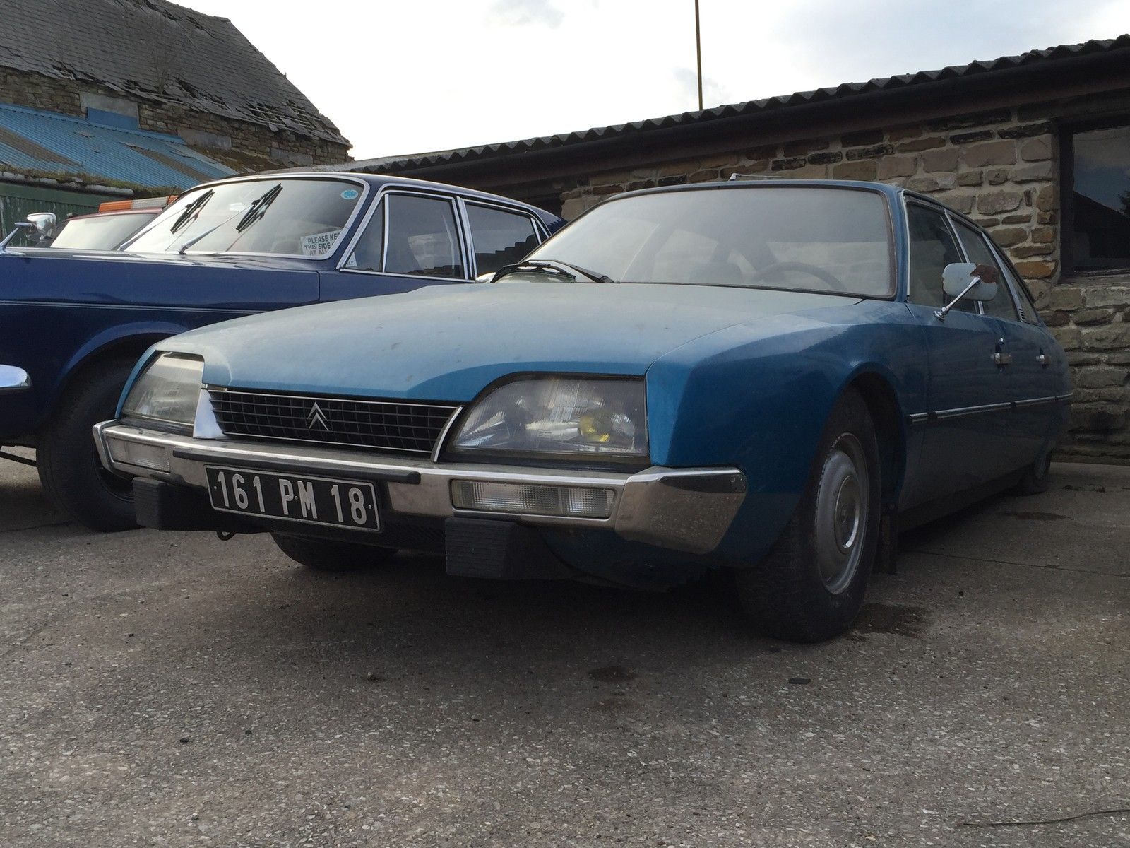

I need a full set of tyres for my early CX.
Now I do like to keep stuff original, but I aint paying the £215 each needed to buy the Michelins and I need all 5...
Hankook 185/80 x14 look to have a blocky old school tread pattern and are £215 for the set of 5. Cheap shit or just about OK.
Thoughts please gents as I know there is a lot of CX love on here.
Last time I bought tyres for mine I had Michelin energy at about £65 each. That was 2001 ish though!
