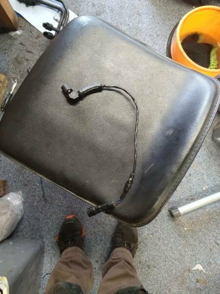

dome Posted October 8, 2020 Author Posted October 8, 2020 Well, somewhat inevitably, the first drive ended with a walk home😪 My GF called me after picking it up from the garage, saying it was running badly and misfiring. I thought it was low on fuel again having sat running during the test-I'd not had a chance to put fuel in it before dropping it off. I stuck a couple of gallons in and it started and ran fine so off we went. It was fine for the first few miles then started to run rough. I limped it in to the next village and walked home. After dinner I got a lift along to collect it, again it started and ran fine from cold and I made it the mile home. Not before the oil cooler bypass hose fitted by the previous owner failed, leaving a lovely* trail of oil for the last couple of hundred yards to the house 😟 So, I've ordered a crankshaft position sensor in a bit of a lucky dip parts replacement. I've also ordered up an oil cooler blanking plate-seems the coolers failing is a common thing and a bypass kit was available from Jaguar. Just need to clean up the mess now... Saabnut 1

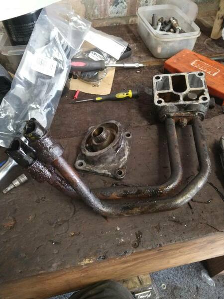

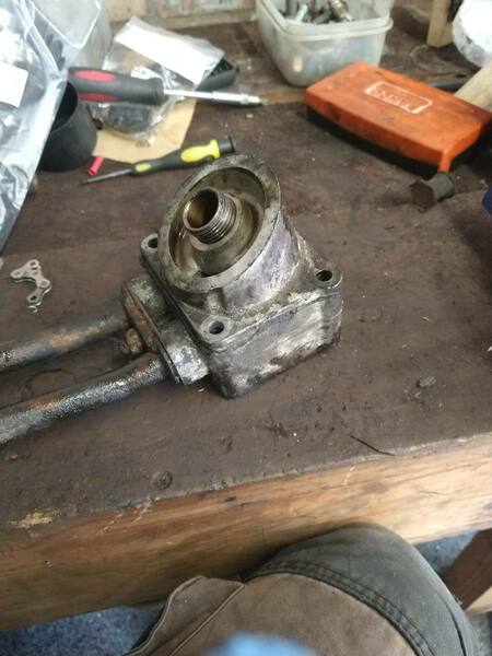

mercedade Posted October 8, 2020 Posted October 8, 2020 I'm pretty sure you don't even need a blanking plate for the oil cooler. The hoses that feed the cooler come out of a plate that sits between the block and oil filter mount (I think), so you can remove the oil filter housing, remove the inch thick plate that has the oil cooler hose outlets, and refit the oil filter mounting plate. I won't lie, I'm half remembering something from my 4.0 about 15 years ago... dome and juular 1 1
dome Posted October 8, 2020 Author Posted October 8, 2020 6 hours ago, mercedade said: I'm pretty sure you don't even need a blanking plate for the oil cooler. The hoses that feed the cooler come out of a plate that sits between the block and oil filter mount (I think), so you can remove the oil filter housing, remove the inch thick plate that has the oil cooler hose outlets, and refit the oil filter mounting plate. I won't lie, I'm half remembering something from my 4.0 about 15 years ago... This is an excellent shout, I've looked into this and it does look like I can bypass the cooler completely by removing the sandwich plate. I made a start tonight after work-oil filter removed to aid access and the bolts holding the filter housing and sandwich plate cracked off. It looks like I can remove the cooler feed and slap it back together. Hopefully! mercedade, jaypee, 320touring and 2 others 5
320touring Posted October 8, 2020 Posted October 8, 2020 Sounds similar to the setup on the old BMW m20s. Removing the plate at the filter end is a winning plan dome and jaypee 2
dome Posted October 9, 2020 Author Posted October 9, 2020 Ok so thanks to @mercedade today I carried on removing the filter housing complete with oil cooler sandwich plate I chopped the lines to make it easier to get out. A quick whack with a rubber mallet and it was apart. Interestingly there was silicone sealant holding it all together. Factory or had someone been there before? I cleaned up the filter housing removing the old silicon and applied some fresh. Back on with shorter bolts and I put the filter back on and topped up the oil. You can see the small* amount of oil it had leaked and the badly fitted hose that had been put in to bypass the cooler-the lines had been cut and the hose fitted. Badly. Anyway, that shit is in the bin. The first candidate for the misfire was the crank sensor. Here it is, Lucas and likely original And the new one, sent overnight from David Manners-thanks to all who recommended them. Definitely a useful resource. So, this evening I set off to see if it was cured. I made it to the pez station. That's a good start! Managed 15 miles back and forth on local roads, not wanting to stray to far There's still a bit of a misfire under load-more than a quarter throttle and it stumbles 😔 It's definitely a lot better though, I'll need to get some more miles on it and work out what to do next. Any suggestions welcome! Lacquer Peel, gm, mk2_craig and 6 others 9

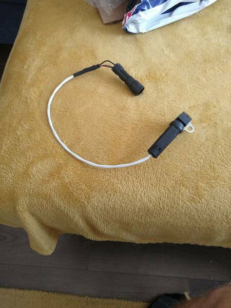

Broadsword Posted October 9, 2020 Posted October 9, 2020 100% that was the crank position sensor starting to break down. Sorry, I should have told you to replace it before the MOT. Even if it turns out not to be the CPS, it needs changing. EDIT: Ha, you literally posted the follow up from yesterday as I posted this.
dome Posted October 9, 2020 Author Posted October 9, 2020 9 minutes ago, Broadsword said: 100% that was the crank position sensor starting to break down. Sorry, I should have told you to replace it before the MOT. Even if it turns out not to be the CPS, it needs changing. EDIT: Ha, you literally posted the follow up from yesterday as I posted this. It definitely made it further and feels better with a new crank sensor! What do I do next to try and cure the misfire under load? It's like the problems still there but not as bad. Jim Bell and juular 2

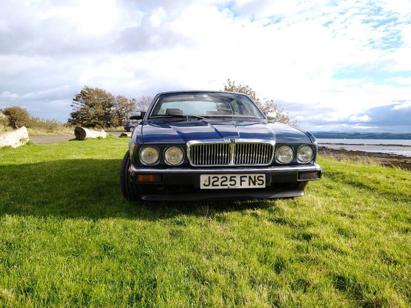

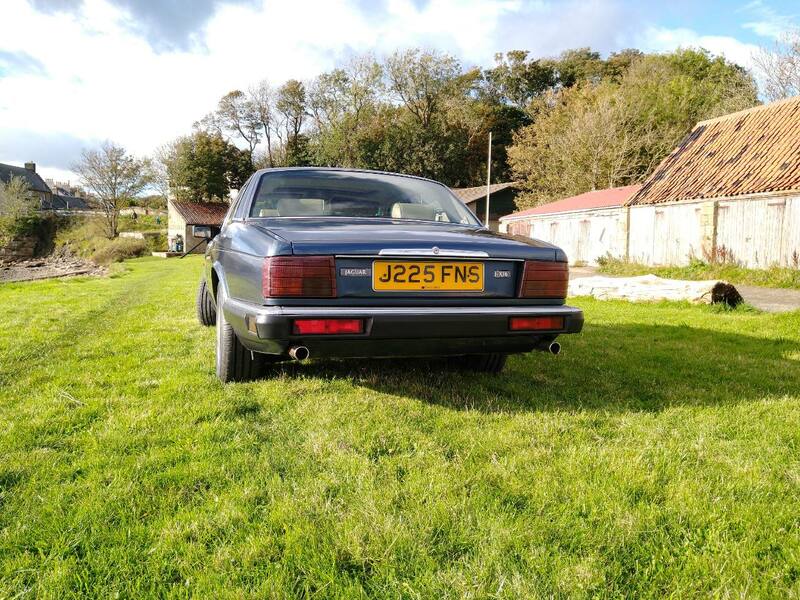

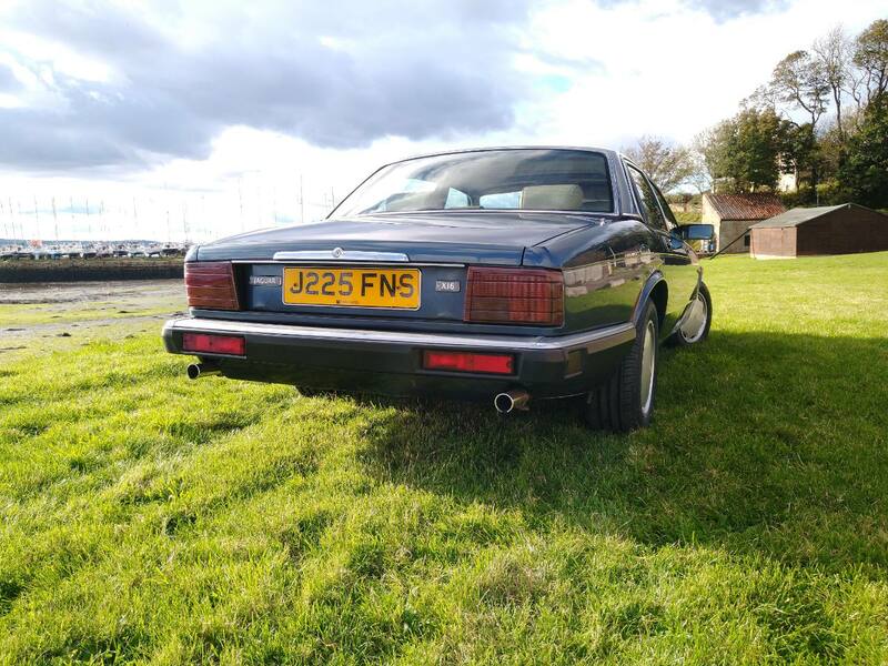

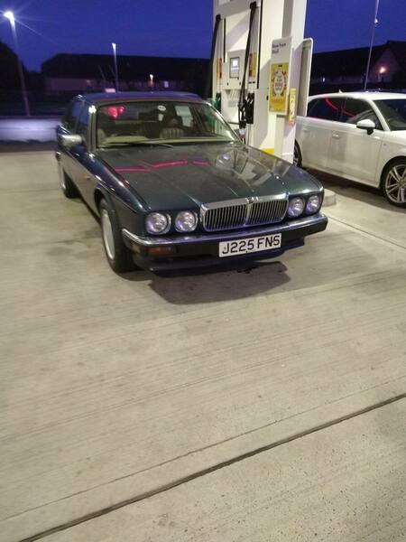

dome Posted October 12, 2020 Author Posted October 12, 2020 Have some pics. I've yet to attack the chrome properly but she's looking good, if I do say so myself... cort16, Fabergé Greggs, Royale80 and 21 others 24
mk2_craig Posted October 12, 2020 Posted October 12, 2020 That does look in better condition than a Scottish-registered Jaguar of the era has any right to be. Great work!! dome and Low Horatio gearbox 2
Broadsword Posted October 12, 2020 Posted October 12, 2020 Great work there. Such a tidy and handsome looking example too! dome 1
MJK 24 Posted October 12, 2020 Posted October 12, 2020 Lovely old Jag. And I do like those wheel trims! dome and djim 2

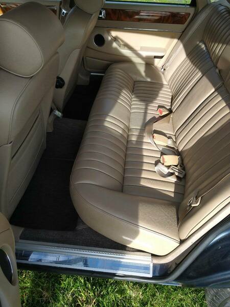

mercedade Posted October 13, 2020 Posted October 13, 2020 Do you have subwoofers under the rear seats (basically where your rear passenger heels would be)? Do you want some for the cost of postage?
dome Posted October 15, 2020 Author Posted October 15, 2020 On 10/13/2020 at 10:55 AM, mercedade said: Do you have subwoofers under the rear seats (basically where your rear passenger heels would be)? Do you want some for the cost of postage? I have what looks like small speakers where the rear passenger heels would be, is that them? Thanks for the offer though! mercedade 1

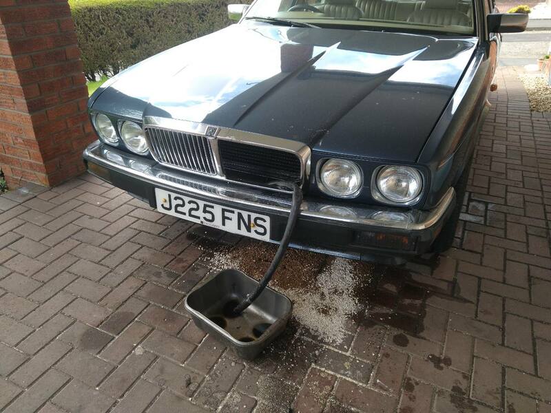

dome Posted October 15, 2020 Author Posted October 15, 2020 140 miles completed in the Jag tonight, on a collection mission for another shifter that you may here about elsewhere on here. It was pretty much flawless, although I arrived home with one less wheel trim than I left with thanks to potholes on the M90 🙁 I'll give it another coolant flush and get some antifreeze into it and also another oil change now it's had a good run. It was great to get some miles on it and reminds me how much I love these things. It also gives me some confidence to get some more miles on it. 😁 Jenson Velcro, Jim Bell, juular and 11 others 14

mercedade Posted October 16, 2020 Posted October 16, 2020 12 hours ago, dome said: I have what looks like small speakers where the rear passenger heels would be, is that them? Thanks for the offer though! That's them. The stereo wiring is a bit odd in XJ40s, so aftermarket stereos take a bit of effort, but those underseat speakers are (pretty decent) subwoofers to bulk out the rest of the sound. dome 1
