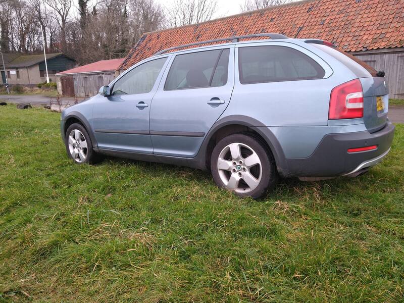

Split_Pin Posted December 10, 2019 Posted December 10, 2019 Jazz: Seen/owned worse rust-wise. I don't envy you with the Octavia does though dome 1

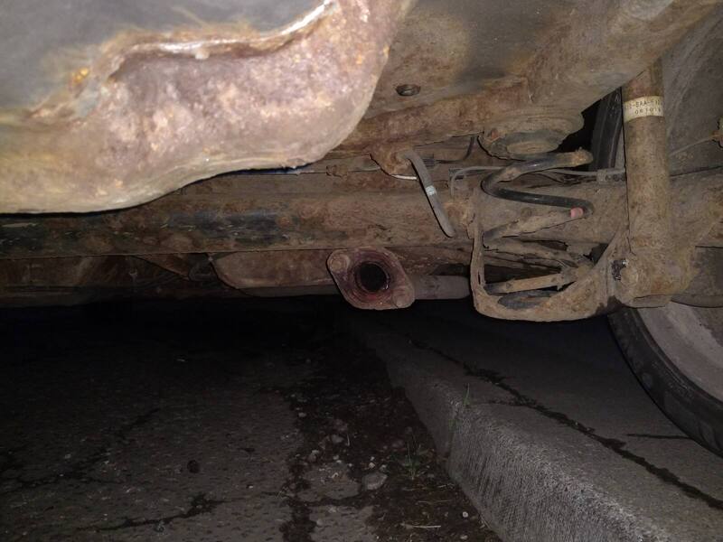

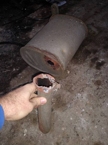

Eddie Honda Posted December 11, 2019 Posted December 11, 2019 9 hours ago, dome said: Jazz I tempted fate by saying this was fine didn't I? The backbox fell off on the way home last night. It was rotten and unfixable so I've invested almost 10% of the purchase price on a new one. It's not too loud without it but I don't want to be that much of a pikey to run about with no back box. I did on the Explorer but it sounded good That's a wank aftermarket can in the picture there. I know someone who had 3 aftermarket rear boxes in five years, so as I had a Yutaka/Honda original, I welded it up. I keep meaning to fit the new one I have, but it hasn't given up yet. I'm hoping it will get to it's 2nd anniversary on St Paddy's day next year! Jim Bell 1

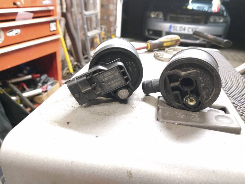

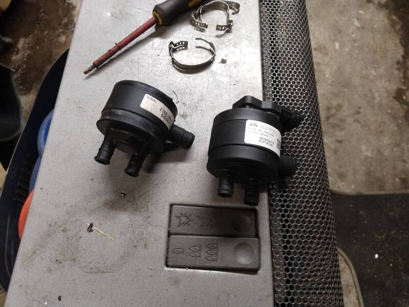

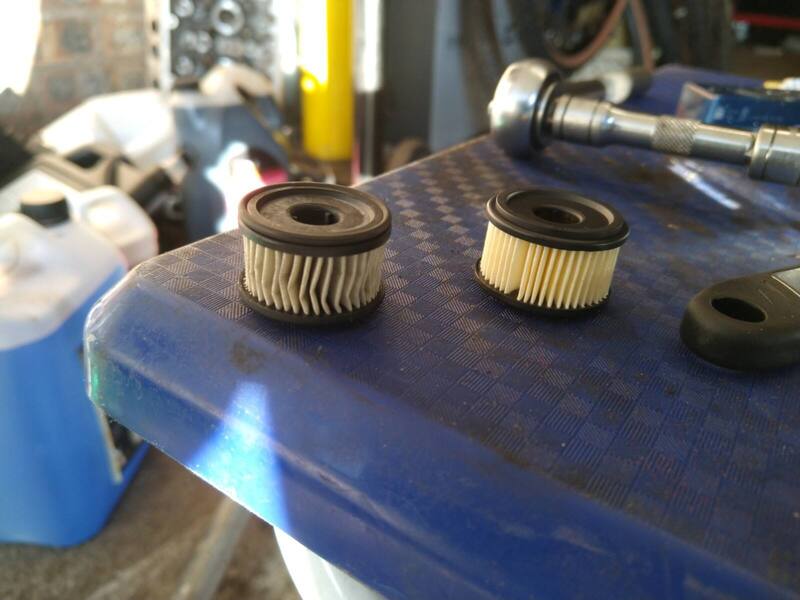

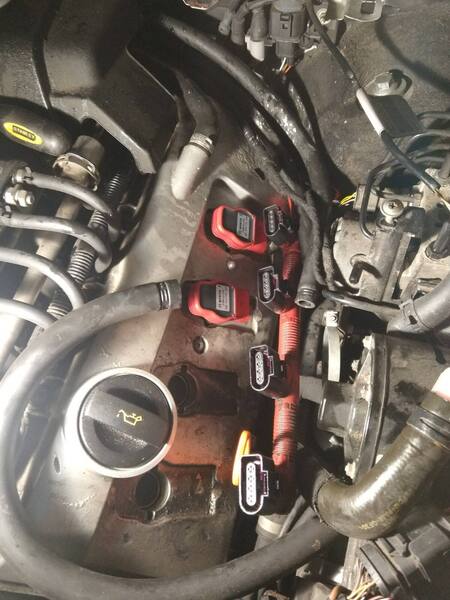

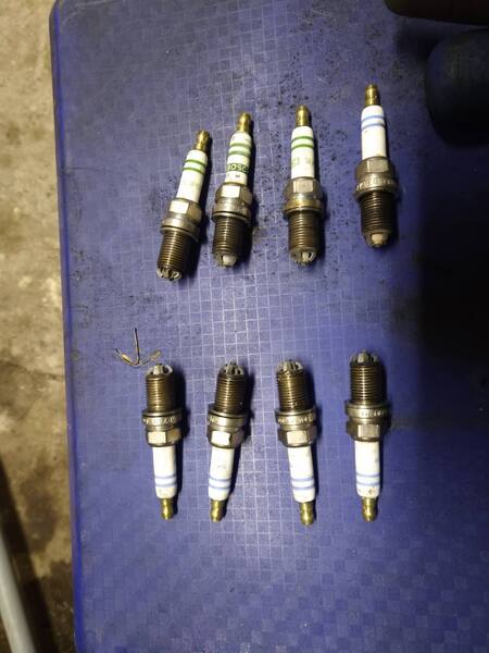

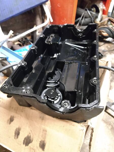

dome Posted January 19, 2020 Author Posted January 19, 2020 Ah, winter. What a beautiful time of year Or, if you've been in Scotland for the last month it's been constantly pishing down and blowing a gale so motivation for anything car fettling has been low. I had a rare moment of motivation on Friday night and decided to service the S4s LPG system and fit a set of spark plugs. I'd only had these sitting for about 4 months so not so bad... I'd serviced the LPG on my Grand Cherokee many years ago and was somewhat taken aback by the amount of gas which was released when I undid the filter, even though I'd closed off the tank and ran it till it conked out. Therefore it was with a due sense of trepidation that I undid the first hose onto the filter housing, at arms length, whilst wearing several pairs of gloves. And... nothing. A wee bubble from the hose an that was it. First filter off. This has a large inlet and splits into two to feed each bank It also has a pressure/temp sensor built in which I had to swap over to the new unit Whilst in here I changed the plugs. This bank was fairly straightforward once I was in there The other bank was a bit more of a faff as I had to remove intake pipework. This gave me a chance to replace the air filter-I'd ordered one last year but been sent the wrong one and by the time I got the correct one I never bothered fitting it, putting it off a I often do... There's a second filter on these systems which had came with the kit, this one did release some gas when I undid it which is always terrifying. It was due for changing though. It was a bit of a faff to get the orings all in the right place but after that it went together fairly easily. Fired it up and let it warm up, it switched to LPG fine with no leaks. Win! Oh and check out the old plugs. Spot the difference? Full VAG service history on this thing... Flat4, scdan4, Lacquer Peel and 12 others 14 1

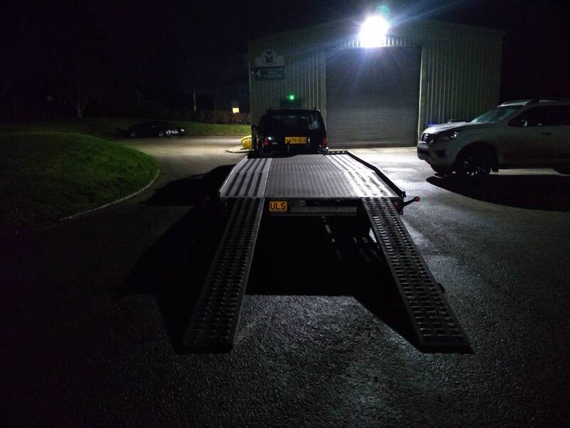

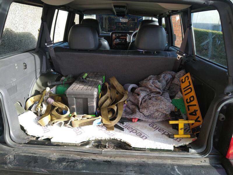

dome Posted February 7, 2020 Author Posted February 7, 2020 Collection weapon Essentials packed A CD holder. How quaint! Lunch consumed and it's off shortly for stage 1 Cavcraft, Shirley Knott, Flat4 and 11 others 14

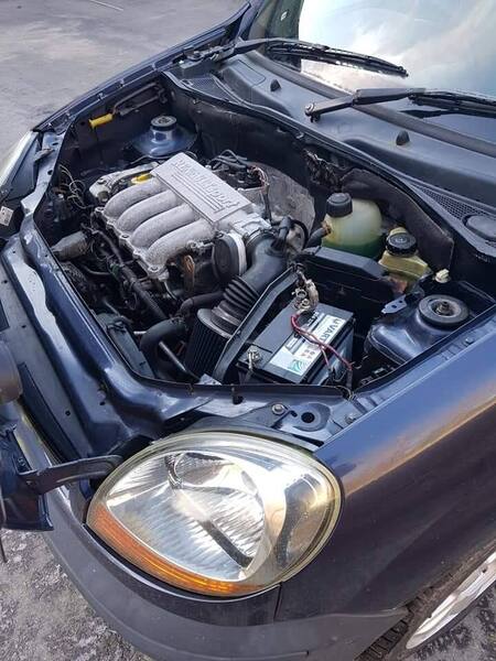

dome Posted February 7, 2020 Author Posted February 7, 2020 Before I go to bed, have a sneaky pic of the reason I went north today for this particular Kangoo That, dear friends, is a Clio 182 engine in this little van? It needs work, of course, but it's running and driving. Right, I'm off to bed. HillmanImp, yes oui si, spartacus and 40 others 42 1
Isaac Hunt Posted February 7, 2020 Posted February 7, 2020 23 minutes ago, dome said: Before I go to bed, have a sneaky pic of the reason I went north today for this particular Kangoo That, dear friends, is a Clio 182 engine in this little van? It needs work, of course, but it's running and driving. Right, I'm off to bed. Va Va Voom dome 1
