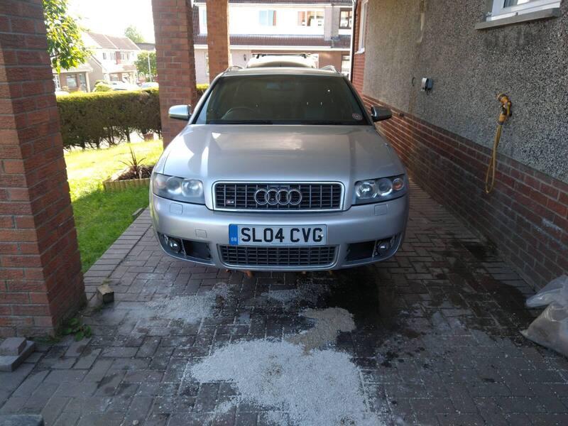

hairnet Posted March 30, 2020 Posted March 30, 2020 do they do copies of that s4 wheel? 8 minutes ago, dome said: Well, as we're all going stir crazy at home and looks well hung, Fnarr. this also gives me a wee knob I can use # snortle
dome Posted March 30, 2020 Author Posted March 30, 2020 28 minutes ago, hairnet said: do they do copies of that s4 wheel? snortle They do but I'm not a fan of aftermarket/replica alloys. These aren't the original alloys for mine but are the same as the facelifted S4. They suit the car though so I'll keep them on it.

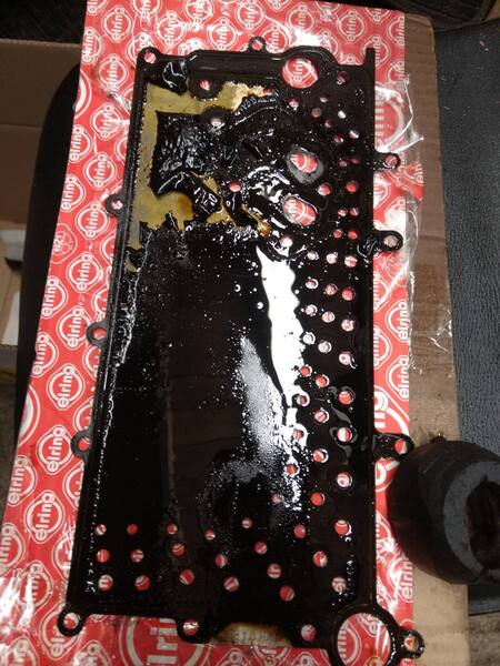

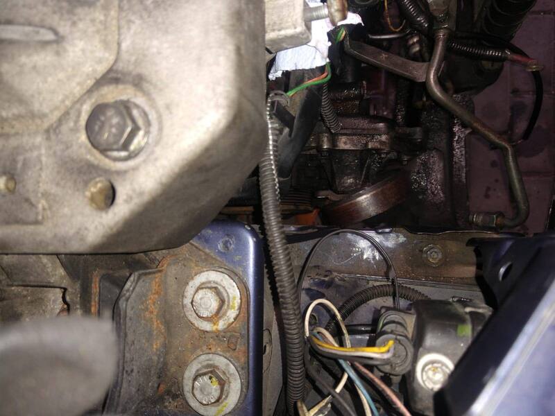

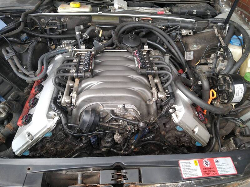

dome Posted May 10, 2020 Author Posted May 10, 2020 Aaaaand not much has happened. Works been stressful so mojo for fettling as been low. I needed to get the last 2 bolts out to get the front end off so had to wait for new torx sockets to arrive as mine were looking a bit ropey. I eventually ended up having to grind one off. That gave me the access I needed to get the inlet manifold off Eep. Ah, well. Best crack on then Manifold off and you can see the oil filter housing at the back of the engine. This was one of the sources of leaks. I'd partly cleaned it up before i took this but it was pretty manky. The valley gasket lies under the alloy section in the middle of the V. Cover off and yeah, the gasket was fucked. Bonus shot of the fucked snub mount from the front of the engine, a new one of these was ordered up too. There's 2 valves under the rocker which stop oil from draining back out of the heads, this was the other reason I was in here. s4s are known for rattles from the timing chain on startup. Mine wasn't bad at all but it seemed sensible to change them at the same time. In true tight Scotsman fashion I'd googled the part numbers and found the cheapest option. Behold, cheaper than genuine Audi parts... I got these fitted and the new gasket and had to stop there as I was missing the gasket for the oil filter housing. I was sure I had this ready to go on but it's disappeared. This still hasn't arrived so that helped* with my motivation. Flat4, djim, catsinthewelder and 4 others 5 2

dome Posted June 10, 2020 Author Posted June 10, 2020 Just realised I haven't updated this! Finally the parts arrived so i could put it back together. Over a month to get the gasket for the oil filter housing, which sits under the inlet manifold meaning i can't put it back together until it arrived. Oil filter housing back on. Before I put the inlet manifold on I used the hoover to clean all the crap that had built up from around it Inlet manifold back on Once back together I turned it over on the starter to build up oil pressure then fired it up Yas! Always a good feeling. I ran it up to temp with just water in the cooling system and the cheap oil and then dropped both. I'm glad I did as there was some crap in the filter which had obviously got into the engine when it was in bits. I'll do another change fairly soon to be on the safe side.. With this done I could fit the new wings. I was pleasantly surprised with the fit-they are pattern wings and were cheap. i supplied the paint code and the bodyshop painted them and delivered them for under £200! In process-the door is open, the panel gap is actually OK And back together The newly refurbished wheels arrived back out of lockdown at the same time as the gasket so I could crack on and get it back looking like a car for the first time in over 2 months! The fit isn't perfect at the bottom of the front of this wing, a little tweak is needed. Other than that it's pretty good And with it's stablemate on the fleet-currently in my lockup while Locost work goes on but I need to get it out soon as I miss driving it The Audi is going well, 100 miles in and no signs of oil leaks. I'm calling that a result! Bren, nacho man, cort16 and 21 others 24
