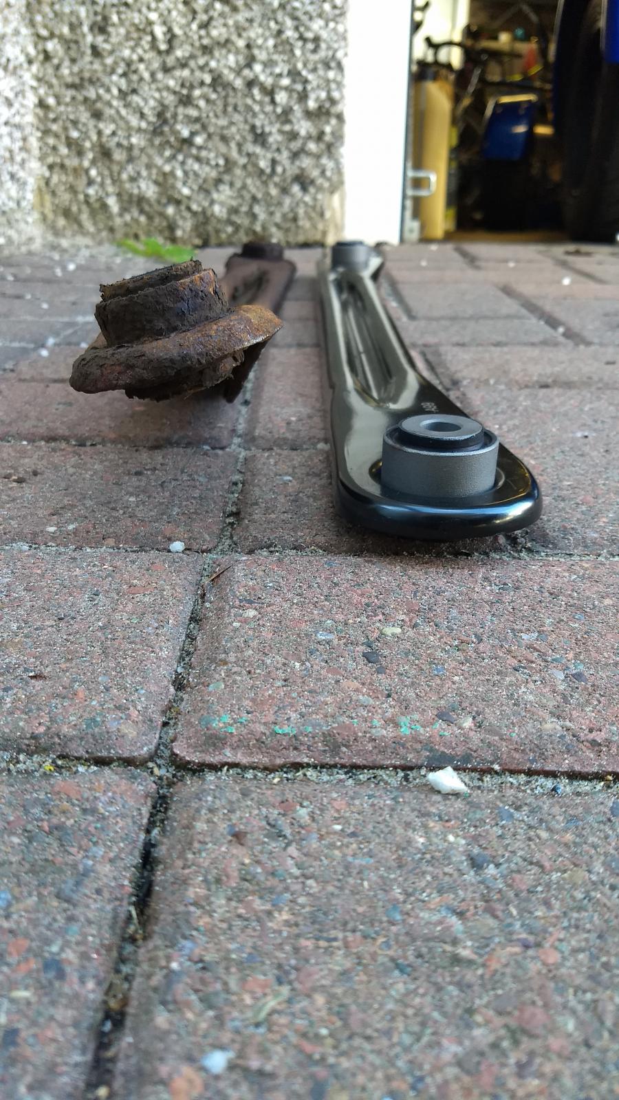

Next, can anyone spot the problem?
Yep, the second pic is the RHS transverse arm. It has been fucked somehow and has dragged the rear end out of alignment. This in turn has fucked the bush under the hub. Yet someone has been driving it like this for ages. Makes you wonder...
Incidentally the seller waxed lyrical in his advert about this having a zinc coated rear subframe. It's safe to say he was talking shit. Not that we actually care.
A new arm is on the way and a bush will be sourced as soon as I can work out what the fuck it is called. The local factors list two in different sizes at a whopping £5 each. Might just buy both.

Got the transverse arm off tonight and compared it to the new one.
Yep, that's fucked.

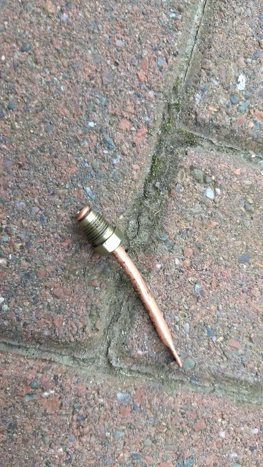

The astute amongst you might spot a slight difference between the two calipers above. Yes, you've guessed it, one was wrong.
A week passed whilst I got a replacement and then got a refund for the old one.
Eventually got them both on and started to bleed them up. I left the bleed nipples open once connected up until fluid started to flow and initially the brakes felt good with any air bubbles rapidly disappearing with a bit of bleeding. My tame mate who was in the drivers seat reported the pedal still felt shite though. Swapping places confirmed this, even though there was no air coming out of the nipples.
Tea was brewed and head scratching ensued to work out what was going on. Sometime later we noticed a pool of fluid under the car behind the wheel arch.
Yep, brake fluid.
Bastard.
Ford, in there wisdom, had decided instead of running the pipes parallel along the car that there should be a small section where they run one above the other. Years of vibration and corrosion had caused the pipe to weaken. Our bleeding efforts had caused it to fail.
Bastard.
Our anger at this was tempered by the fact that it was better happening on my driveway than if it happened approaching the hairpin at Knockhill at 100mph.
Where the joint had failed was in a postition where it would be near impossible to cut, flare and put in a union. The only option would be to replace the entire line.
Luckily* the pipes over the axle had been replaced so there were unions on both lines in front of the rear wheels(more on these later) Routing the pipes into the engine bay and into the ABS pump (down the back of the dirty big V6) looked interesting*
