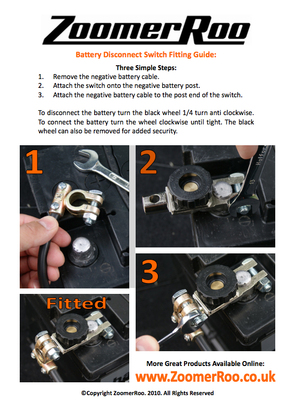

kirton Posted May 15, 2016 Posted May 15, 2016 The one at the top looks like the one I bought: broke one whilst tightening up the earth lead-lesson 1, don't put the whole thing on the battery terminal and then tighten the earth lead on. There is very little metal there and it looks like mazak (commonly known as shit metal) which doesn't bode well for along life, even if you don't break it first yourself
