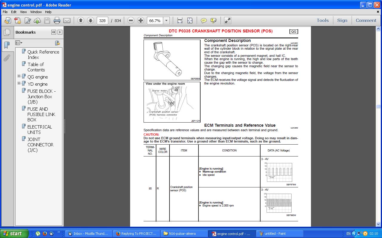

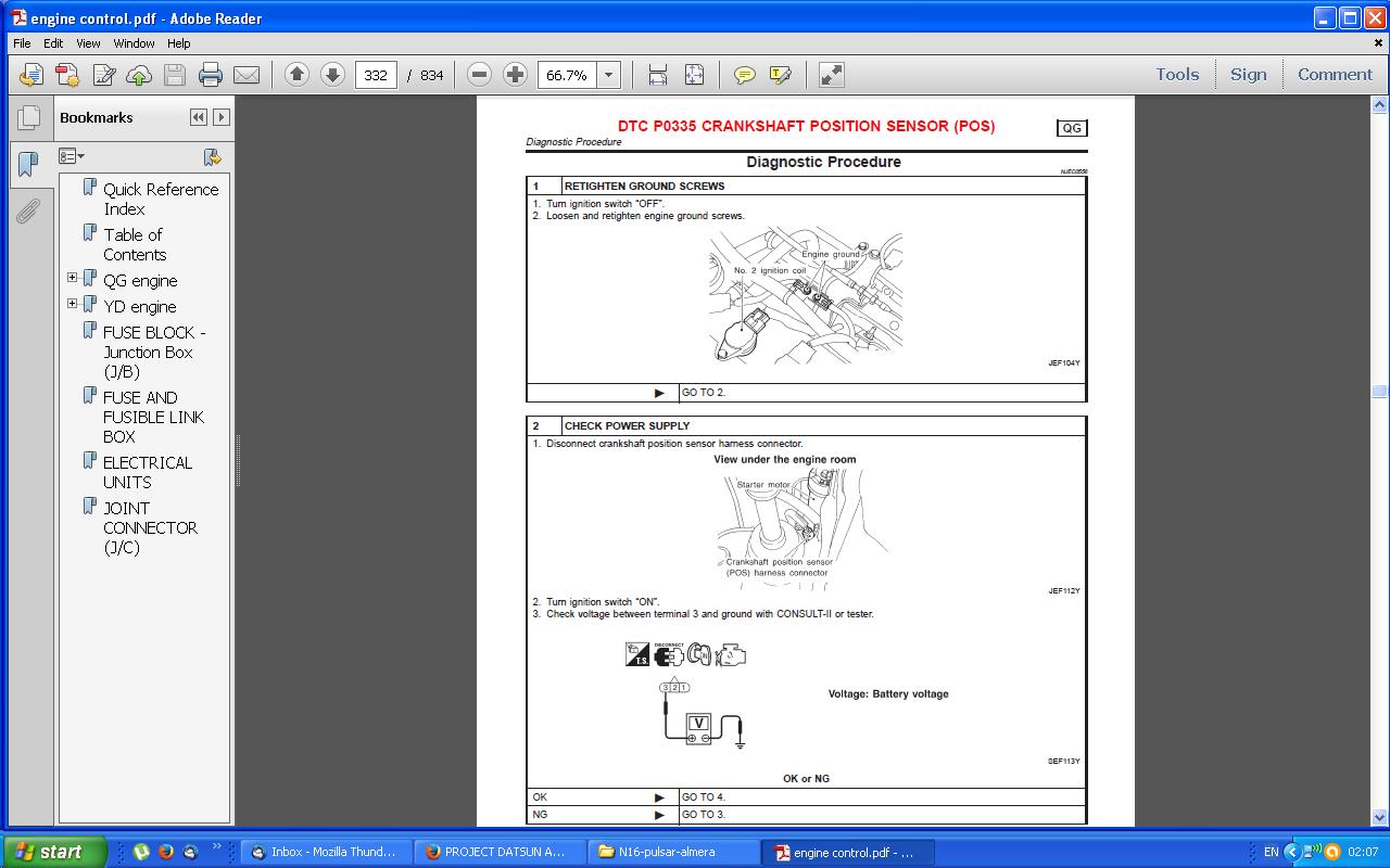

Does anyone know where the crank sensors are on these things? I can't find it!
Ha, I'd just finished work and got the "shite itch" so didn't bother getting changed.
Bellhousing/flywheel area?

Thanks for that BC! That's a real help!

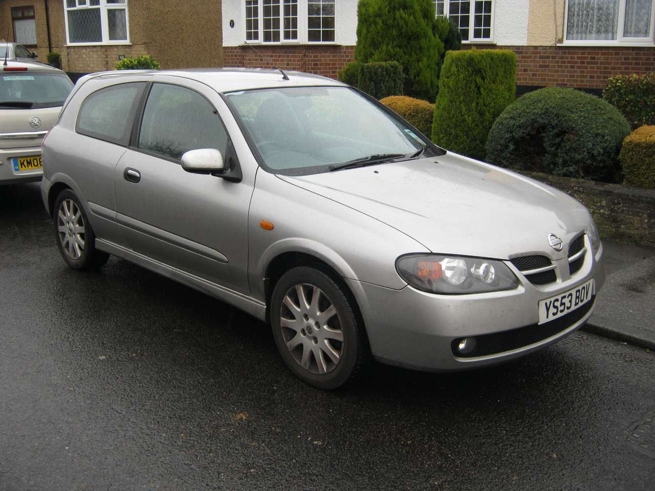

I've owned one of these since 2008 and taken the mileage from 40k to just over 160k, it's been very reliable, did have to replace the crossmember which is prone to rotting on these but mainly just normal stuff wearing out otherwise, but it's still on its original clutch.
They're never going to set the world on fire but are nice enough to drive, and being pretty unfashionable means they are cheap, hopefully the sensor will sort the starting problem (I think the later models had better timing chains and less prone to trouble than the earlier cars but may be wrong) and then you'll have a good reliable car for not a lot of money.
Photo of mine for anyone still awake...
