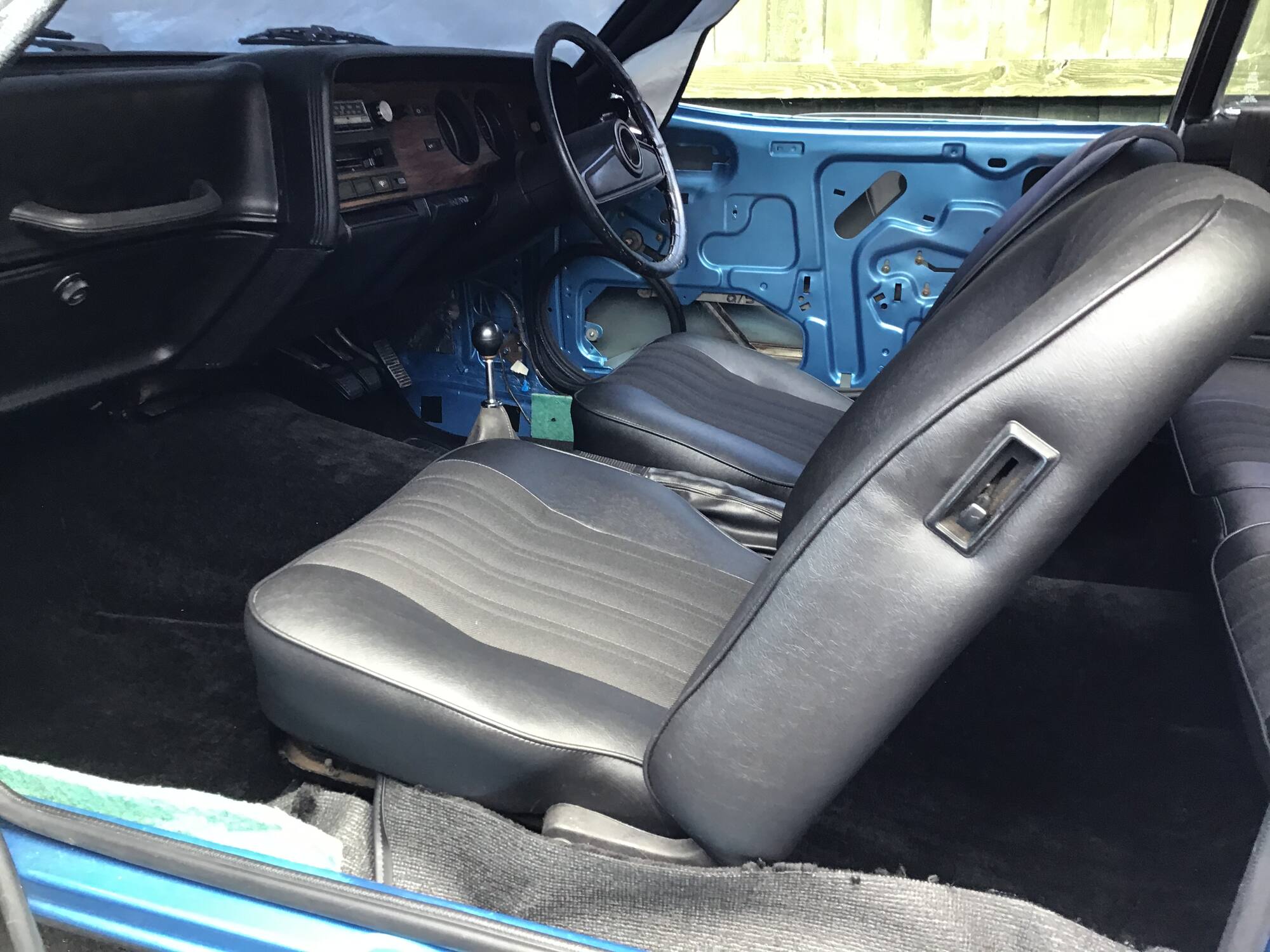

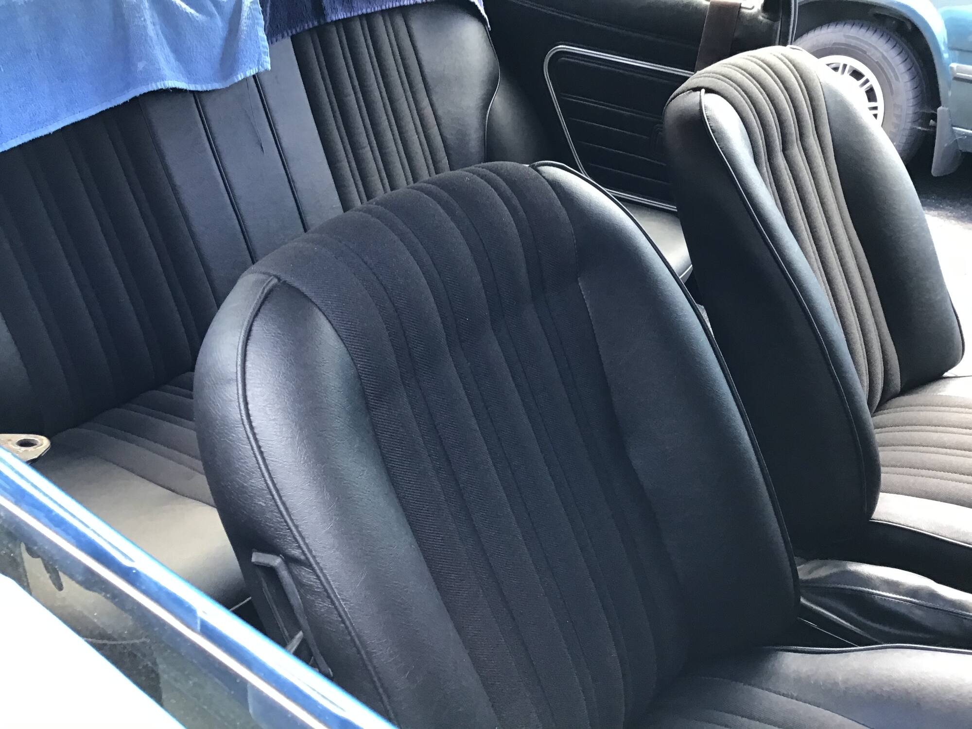

So with that job on hold I decided instead to get the front seats fitted. I don’t think I need the space to work inside the car anymore as most of that is now done so why not.
They went in ok, just took a bit of effort clearing the bolt holes in the floors of all the carpet and under felt. Both seats went back fine though.
