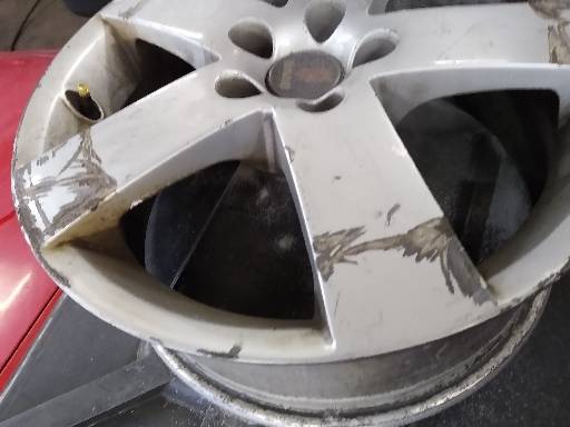

Wheels update. The lacquer said to rub the wheels down first with 1200 grit paper with plenty of water.
I did so but revealed white spots
I did it to three of them (including the one with runs) and then gave them a dusting of paint again, left them to dry. The fourth looked pretty good so I just decided apply lacquer to that wheel. Gave it two coats and left it to dry
Doesn't look too bad. Definitely not perfect and I think spraying them in summer would definitely make it easier.

So the wheels started like this
And ended like this
Not bad overall. My rainsport 5 were delivered so have been dropped off to get the tyres fitted.
