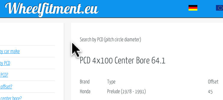

The PCD is 4x100mm, 4J on a 12". The problem is, it has zero offset - and the only replacements on Ebay are in America, and serious dollar to ship.
Centre hole is getting on for 65mm I reckon. I have already discovered that Nippa wheels will not fit.

4 x 100 65mm ish sounds like BMW to me, they're normally about 15mm offset, any 13inch BM steels that might fit?

A CB of 65mm sounds BIG for a car though, so unless you're willing to cut out the middles with a gas-axe (or pay for machining), I think you'll struggle.

Are you sure its 100mm PCD and not 101.6 as that would be 4 inch.
Here have both 4 inch and 100mm PCD in the UK, the 100mm only has 60mm centre bore whereas the 4 inch is 65mm, both are zero offset.
I doubt any car wheels will fit as they are 99% positive offset, if the Nippa wheels move the wheel inboard then you would need zero or negative offset.

The wobbly hitch and stupid wheels make me think this trailer should be in America, not Wales. I've just had another trawl for wheels and drawn another blank. Any of the suggestions above from UK sellers have a centre bore that's too small. That also rules out spaces, as the wheels still won't fit! I've got a pile of galvanised scrap sitting on the driveway at the moment.
