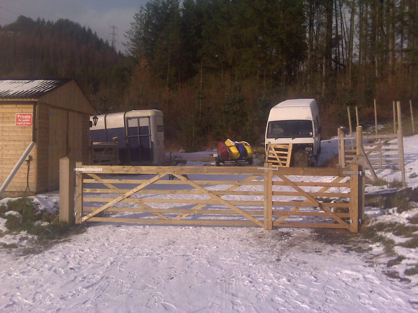

but I like the idea of something a bit bigger, which I could potentially sleep in. I was given this:

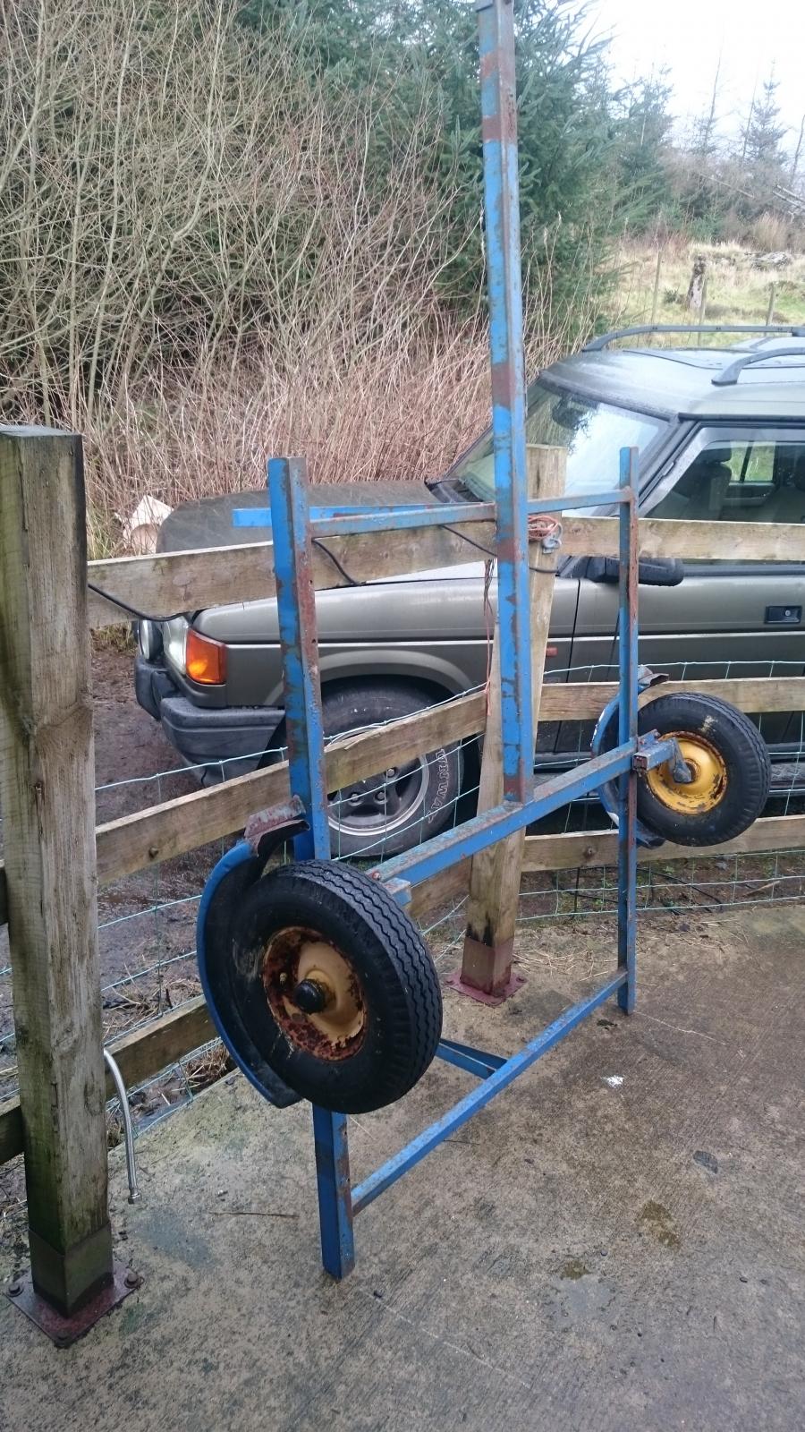

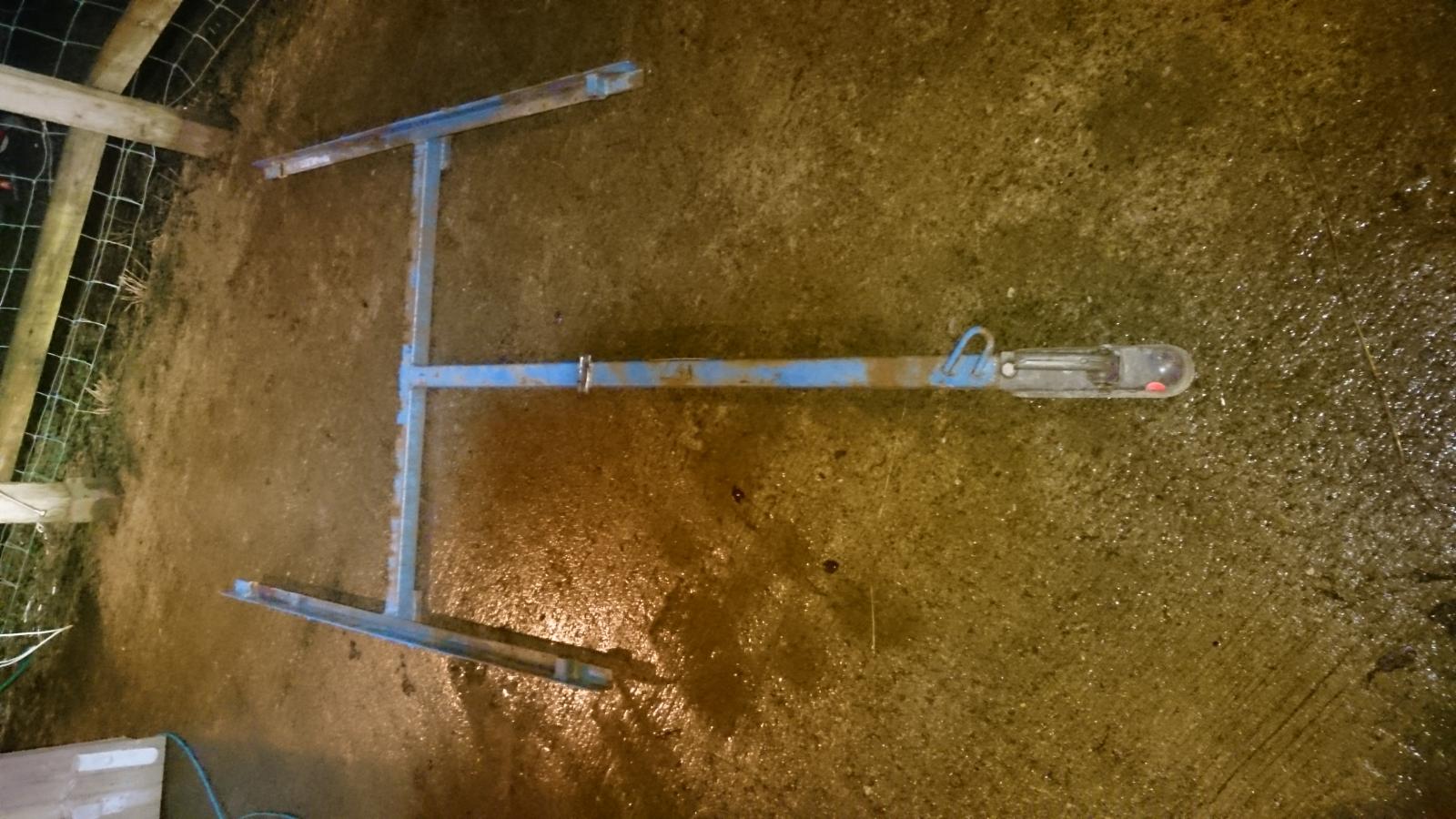

which is an old canoe trailer, and I thought it would be a good, lightweight base from which to work. I'm going to be making up plans as I go along, but the first job was to remove anything which I won't need:
Cut out the cross pieces as I'm going to extend it lengthways, and removed the wheels as they're tiny things with integral (shagged) bearings. To ve replaced with proper suspension units with hubs for bolt-on wheels.

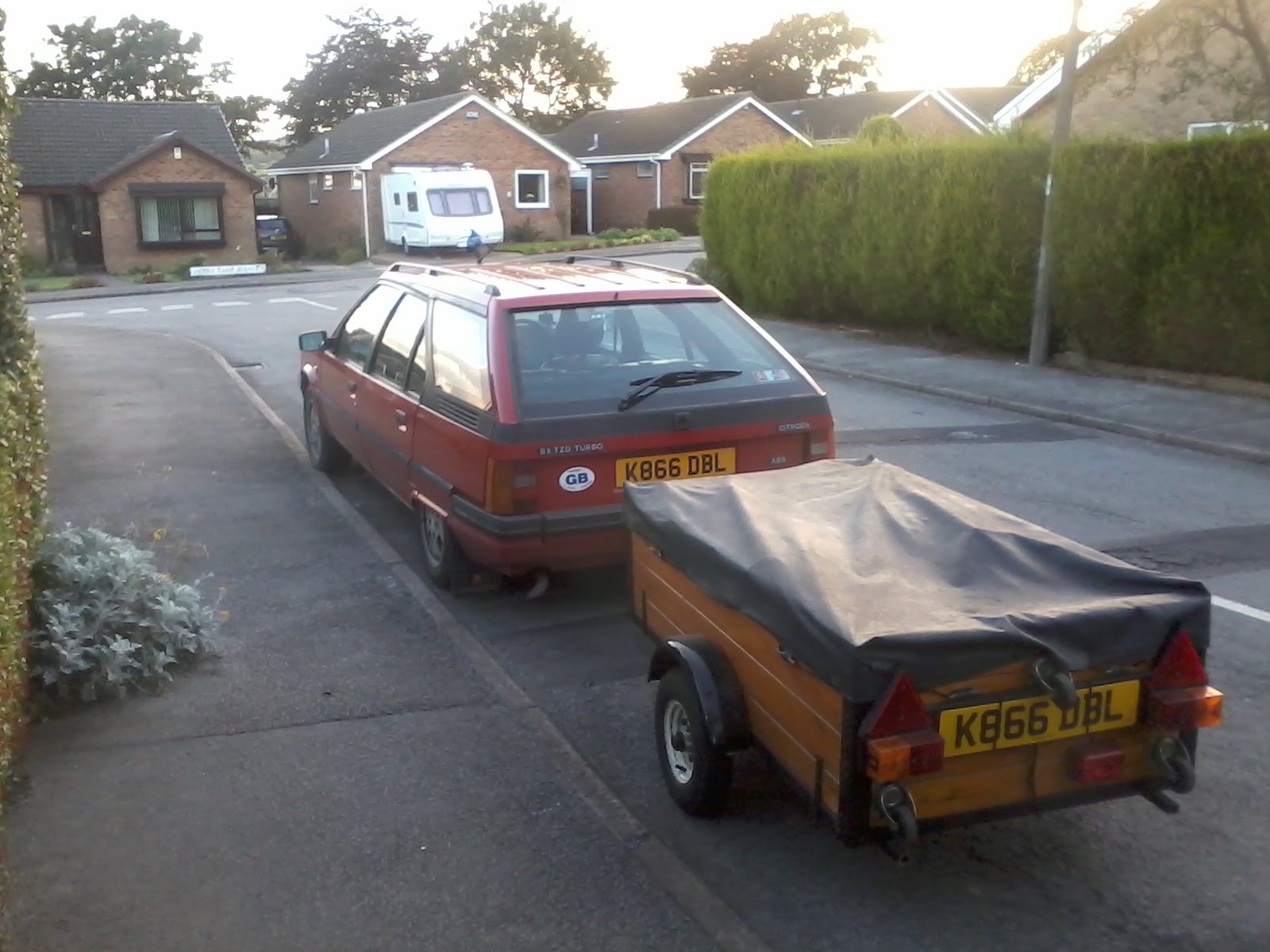

(my 'new' trailer in a previous life)

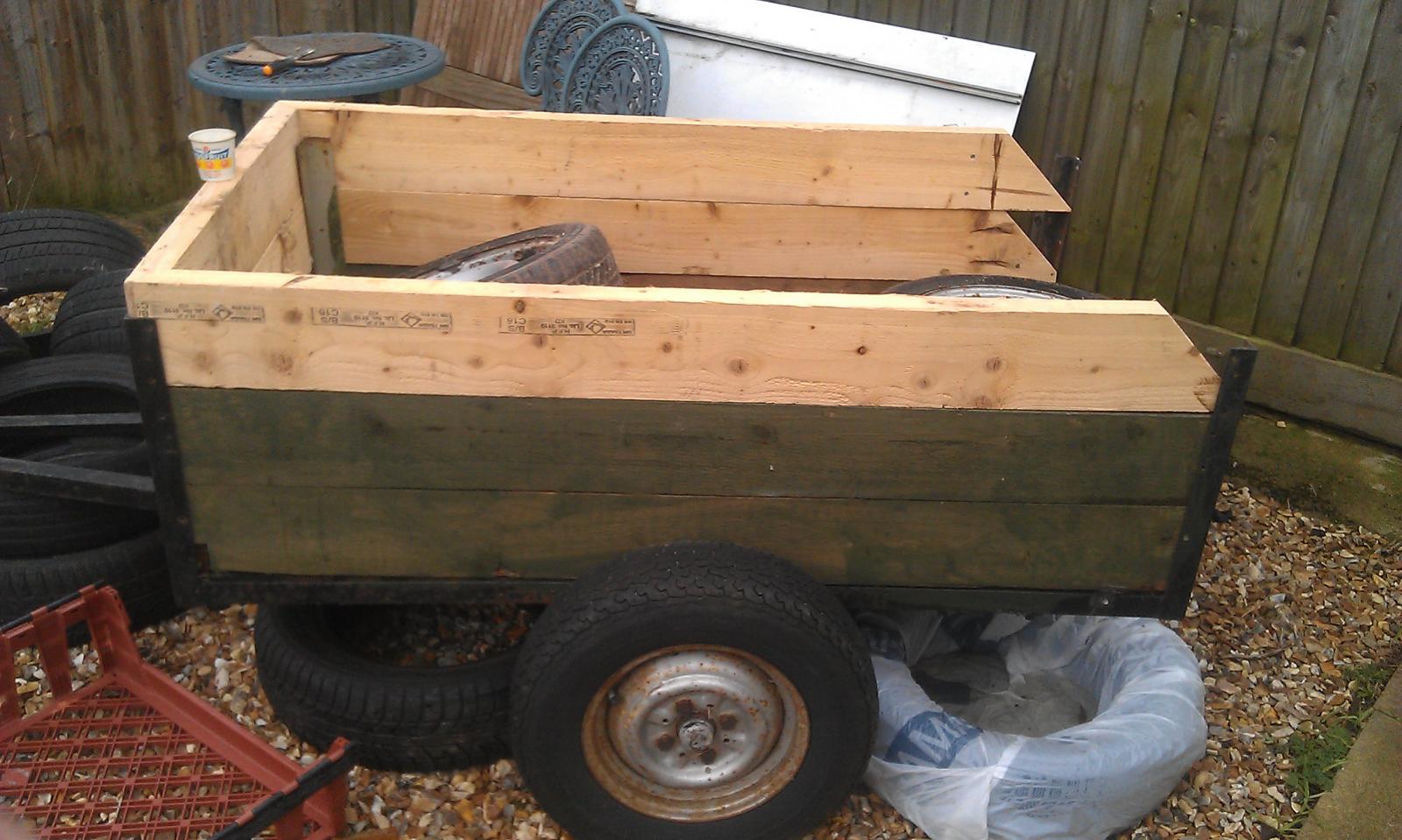

Here's my aged trailer getting back towards road worthiness:
I've gone a bit overboard with the sides though, as I had some 6x2" laying around.

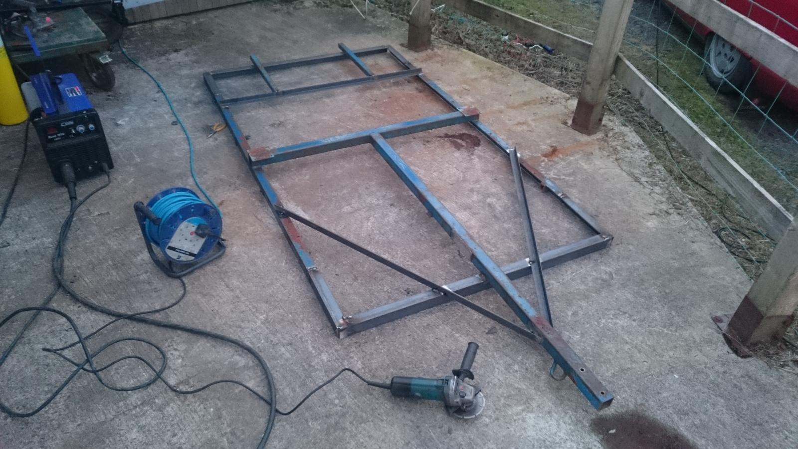

This had taken a back seat for a while, until today (waiting for dry weather!) This is what I'd cut the old canoe trailer back to:
And after a few hours cutting and tacking, I've got the chassis sorted. It really is nice to crank the welder up and work on thick steel.
I ran out of time so haven't finished seam welding yet. The old suspension units are shot, so will get some with a heavier duty rating.

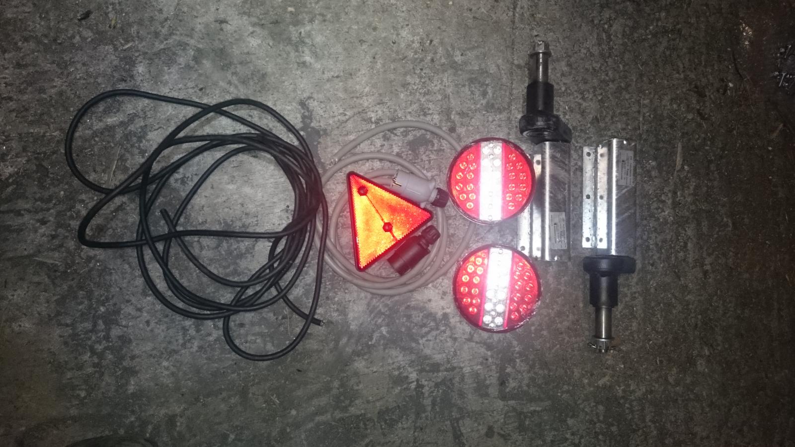

I got a few goodies through the post this week:

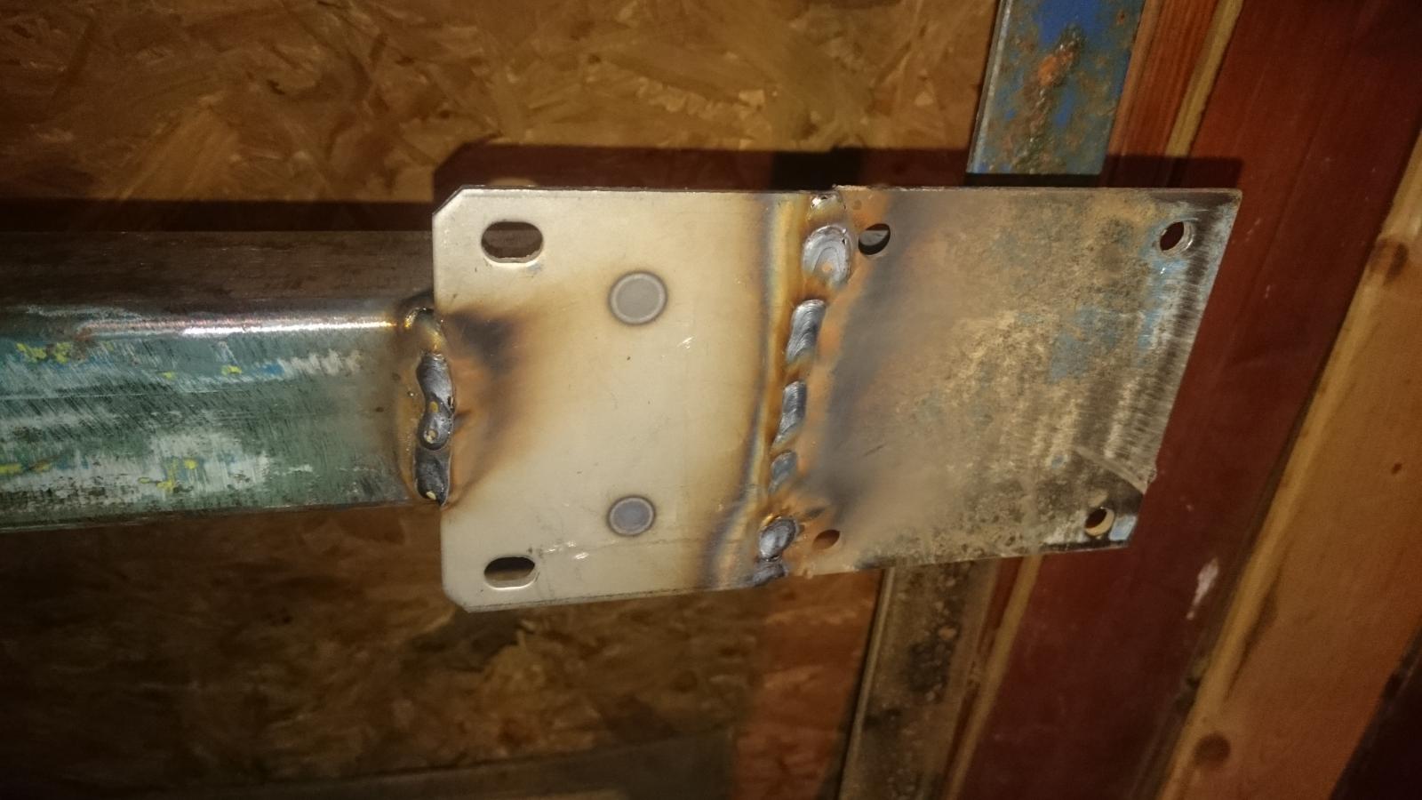

I know I haven't even got a rolling chassis, let along a floor and sides but I like LEDs, so I've bought some rear lights. Sold as truck lights but I think they look neat! Also a pair of Avonride suspension units, as the old ones were knackered.
As they're a higher weight rating than the previous ones, they have a 6 bolt fixing to the chassis, so I extended the original mounting plates as I figured this would be the easiest way to keep the alignment correct.

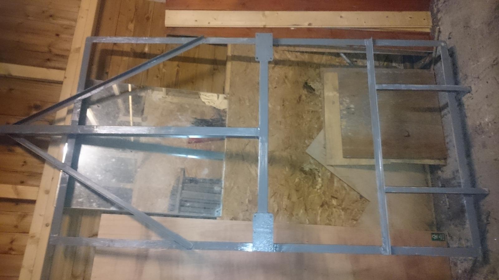

And this evening I've taken the whole chassis back to shiny steel, ready for coating with Zinga.
A little more progress on this over the weekend - now protected against flash rusting although the upper faces need another coat.
I've now assembled the hubs and bolted on the suspension units. These are galvanised so should last a while - the old ones had started to corrode through!
