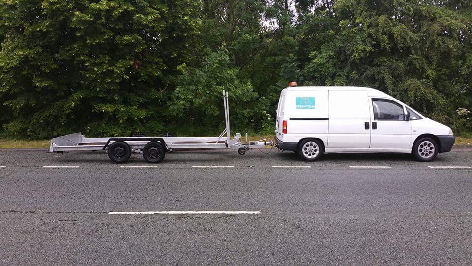

As some of you know I have a van and medium sized car trailer and am ldv beavertail in the making, I'm offering a collection and delivery service any questions inbox me cheers Dave

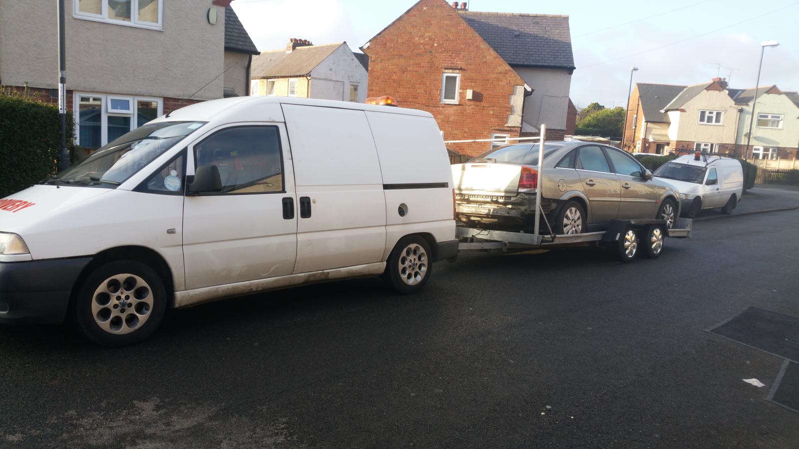

I wouldnt like to tow that last one that's for sure unless the engine was in the boot.
Engines go at the front m8.

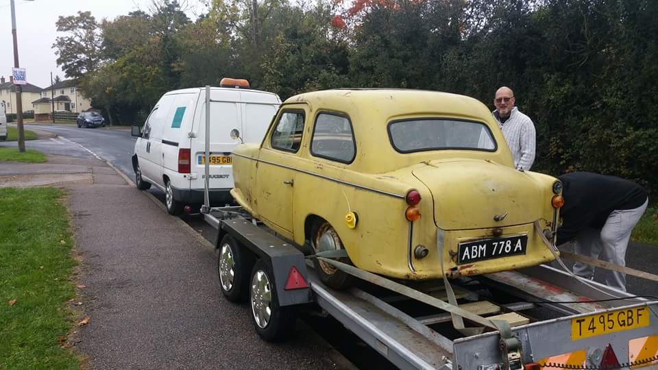

Top Trumps says:
T495GBF: Engine size 1868cc
The DW8 is for all intents and purposes an evolution of the XUD9 and is the only diesel engine in the family not to feature a turbocharger or common-rail direct injection. It is mainly used in vans such as the Citroen Berlingo and Peugeot Partner but can also be found in more affordable versions of the Peugeot 206 and 306.
BHP: 71.0
Towing capacity: 1100kgs.
Vectra C weight: 1,180KGS
VOSA escaping powers: -11.
Ability to climb Rhuallt hill on the A55: Good luck with that one.
Jesus man, you are advertising a service but your photos clearly show a van woefully unsuitable for towing heavy stuff  and you put a car on backwards - thats a surefire way to end up upside down in a ditch with the trailer on top of you.
Thats grim towing. I had a 4x4 with 109 bhp and a 800kgs lightweight van. Up hill with head wind in that was hard work.
Not wanting to jump in bandwagon, but would the trailer not be another 350kg plus.

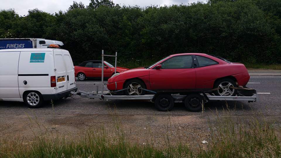

Er, how is that Fiat Coupe strapped down? Is that just straps through the alloy wheels?!
The strap it shut in the bonnet for FULL safety.
It seems we are all getting a bit judgemental on the lad who is simply trying to make a living, but I wouldn't be towing that set up. What is the weight capabilities of the trailer. Vosa are getting pretty hot on trailers and that van really isn't good enough and if you are charging for it you will probably need a tacho. Maybe someone in the recovery trade will be along to give you some better info, but the straps are all wrong and towing that vectra would of scared the crap out of me even with a 4x4 tow car.

Also, for future info - dont strap cars like that, the Fiat coupe is the same with the strap going over the tail board. In an emergency stop that wee tailboard will buckle like cardboard which will let the straps go slack and allow the car to roll forwards.
If you dont have proper wheel straps its ok to use normal straps crossed over the wheel, but they need to circle the wheel ABOVE the centre of the wheel and be hooked to the trailer bed close to the bottom of the wheel, this means the strap can not slip downwards as they are above the widest point of the wheel. As you have them in your pics around the middle of the wheel and leading far rearwards its way too easy for them to slip downwards and come off.
Those wheel straps are worth their weight in gold. When I started out (in a Mk2 Transit beavertail) everything was a disaster initially, but I soon learnt, mostly nearly the hard way.
^ Yep.
Spend 60 quid or so on a set of proper wheel straps, and only use the current combo for doing favours, imo.

Yes,the Vectra is mine. I followed from Heanor to derby. The van climbed hills better than my escort if I'm honest. Putting my Vectra arse first wasn't anyone's first choice but due to stuck brakes,car facing uphill and a complete lack of space it was the only option. The beavertail will be a lot better overall though I must admit
