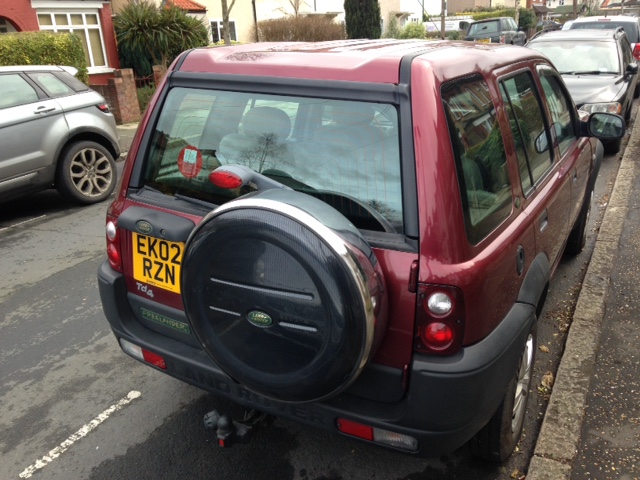

Had a call from an elderly  friend  ( who's not on here), he has his daughters Freelander to dispose of . All i can remember what he said was:  It's dark red , 02 plate , 138k , 5 door  BMW TD4 engineI ,the  radio doesn't work and same with tailgate electric winda .Maybe other things too . Mot until April , but could maybe whizz it down for a new one . Oh ,and its had the 2wd conversion kit and would need the prop and whatever coupling ? to  reinsate 4wd .

A good reconditioned viscous coupling is only 200 quid, but there is a decent chance the transfer box is kippered, which you wont really know about until you refit the propshaft. A recon transfer box is knocking on for a grand.

He sent some pictures . Reconditioned gearbox 18 months ago, the transfer box is ok , apparently the viscous coupling failed.... so the prop was taken off . Going for an Mot  after he gets it home and cleans it .

If the rest of the transmission is ok, they need to invest 200 quid in a new VCU from Bell Engineering and refit it before sale.
Everyone with a buggered one says the box is fine. Selling a 2WD 4WD will always mean it gets a low price, but if its fully working its worth significantly more.
