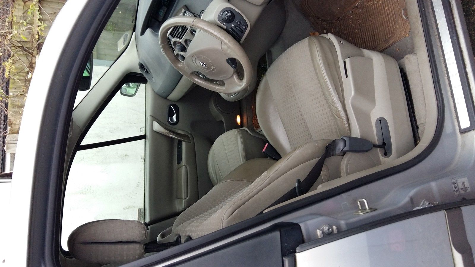

Spare and repairs that I was told was because shifting the auto box into drive, the engine dies. 150k on the clock, auto box, privilege trim so all the toys. As I was only needing it for parts to make a test jig on, I didn't really care. Ended twice at £150, no bids. So thought I'd make contact and see if they'd take a cheeky offer... which got accepted! Also got told its life history...
This was last week, problem is I needed to arrange a recovery to get it onto my drive. Just getting a Scenic wasn't something I was really could be bothered to get! However I finally decided to phone up a car transport guy and who actually could do it today.
So tonight I turned up and saw the beauty. Handed the money, did the paperwork and got given a huge wod of paperwork history. Went out to it, tried starting it and it ran ... for 10 seconds. Hmm. Tried again but kept the revs up. Really didn't want to run or idle. Shifting into drive worked but needed foot to the floor to keep it running and move. Anyway recovery truck arrived, so I managed to reverse it up enough to get it on the back of the truck.
I beat it home, so while sitting in my car I had a think. Now I know (from the statistics from my app) that the most common (by a huge margin) faults on the 1.6 is the camshaft sensor and the crank sensor. Unfortunately I forgot my scan tool earlier, so I couldn't scan it. A quick google showed that the failing sensors could cause that. Anyway I know from experience that the Crank sensor on these autos is different from the manuals and is much more reliable. So that left the cam sensor.
Van arrived, decided to disconnect it - as if it ran better, it'd be a lot easier to get off the back of it. Disconnected it, started it, burrrrrrrrrr.... :D
Gave it some beans, stuck it in drive and it merrily pulled itself off. Left it idling on the drive for a couple of minutes and it just purred. Bonza!
