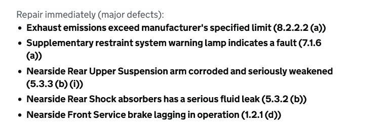

Having shelled out some rather chunky amounts for MOT work in the past, is it really worth forking out for the upper arm and rear shocks? With the van still off the road it's my only transport apart from the Mrs' Auris - and I need to keep mobile.
49 minutes ago, wuvvum said:
Are the rear suspension arms still a pain in the arse to get hold of on these?
No, they seem readily available at around £130 from DMGRS or Rimmers. The problem is the cost/time of lowering the rear subframe if the bolts are totally seized, bearing in mind it's a 21yo car on 187k.
I’d say better the devil you know in truth, even if it is likely a bit expensive to mend.

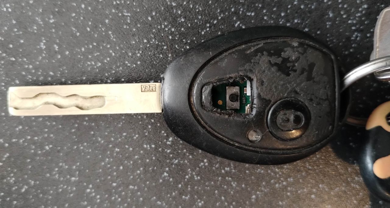

Had a cheep new tyre fitted this morning (as one was below the limit) then later the rubber flap over the unlock button decided it had had enough. I know how it feels.

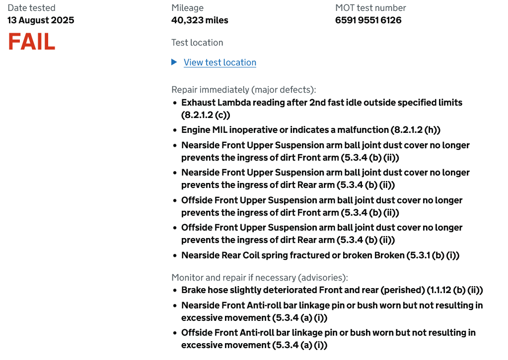

In light of the impending MOT I followed the advice above, but it made no difference, sadly. I thought I'd wait for the MOT verdict before getting a switch.
Today was MOT day, so I first treated it to a wash at our local Morrison's "£2 for 2 minutes" DIY booth - not bad, actually. Got rid of all the 'Sahara' sand, anyway. Then it went for the MOT, and the man said:
Bugger. I knew the EML is on due to the sensor wiring issue, though think it shouldn't have applied as pre-2003. The Lamda reading and the spring surprised me though. Waiting to hear on cost, and whether they can find the gaiters or if it will be new arms.

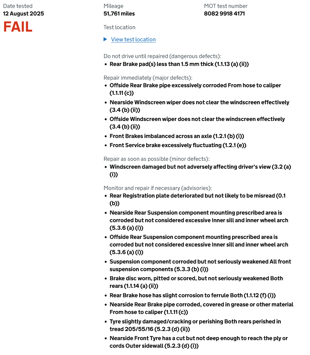

Forgot to say, yesterday Mrs J's Auris scored this:

Got the work on the Toyota done this week, came to £950. Quote for the Audi came in just shy of £1,100, over twice what I paid for it. I'm not sure it's worth that much, but will have to cough up if I can't find an alternative cheapie by Tuesday as Mrs needs hers more over the next few weeks.

That sounds rather extortionate, second opinion required methinks. Sounds like your test station just doesn't like old cars based on the 'bad luck' you've been having
I know a lot of testers are particularly sympathetic with ball joint dust covers, as long as the joint is still ok with no play and it hasn't visibility lost all of its grease then they'll P+A them. There's nothing wrong with packing some grease in there and smearing some PU adhesive sealant over the split, especially small ones

That's now got me thinking, for a set of discs and pads, a brake pipe, a set of rear pads and some wipers, someone's doing alright out of that. I'd seriously consider a second opinion on the Audi at least if I was you
Needed a caliper too, which was £100 for the part.

Here's the invoice:

Here's the invoice:
Admittedly that doesn't seem so bad, they've done the rear discs as well, I thought it was just pads at that price. As well as a tyre which I wasn't taking into account, and the caliper as you pointed out.

Are you able to see the ball joint covers yourself on the top arms without too much difficulty? If I could see how bad they are I'd happily offer my opinion of whether I'm flogging a dead horse with the idea.
It has to be said the top arms can be a nightmare on these with the pinch bolt from hell, they've most likely quoted you a worst case if they can't get that bolt out
