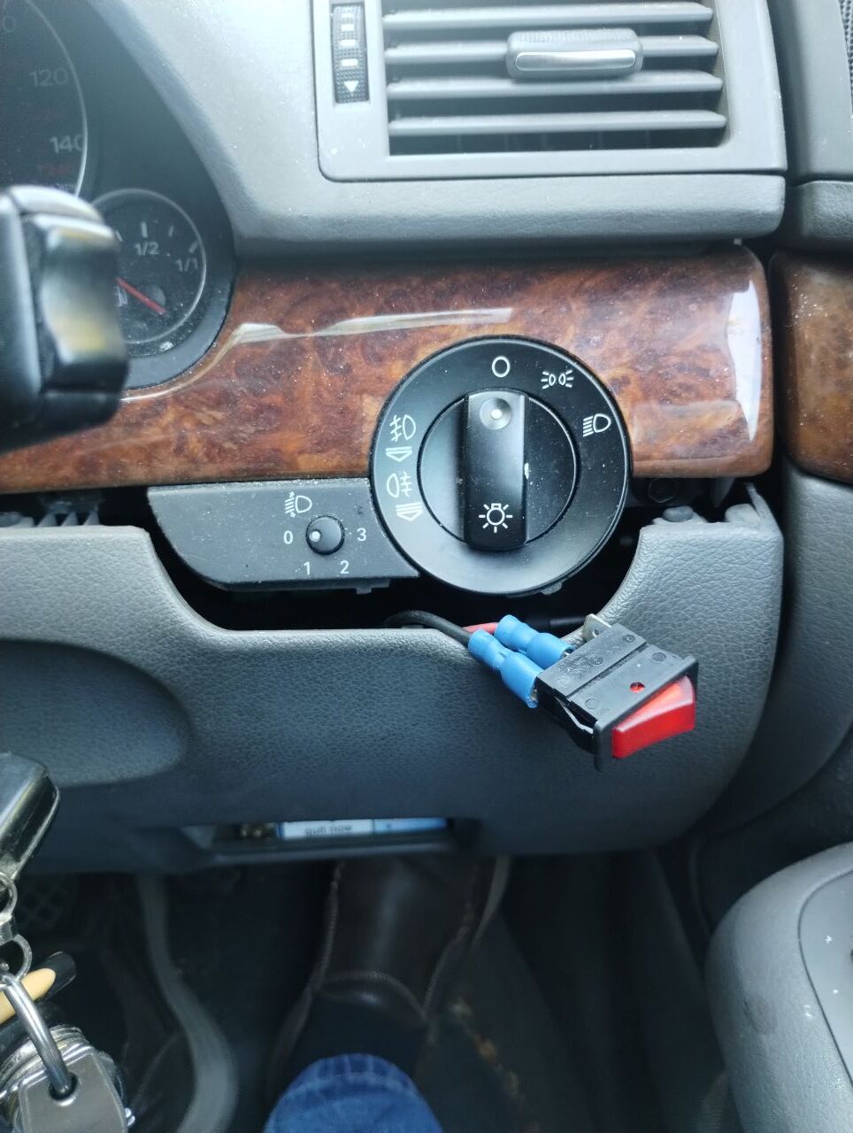

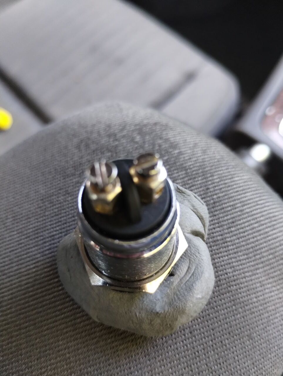

My A4 has a fancy starter button, maybe fitted for anti-theft or due to a faulty switch on ignition barrel. Recently I've been having to press the button harder to get it to make contact, which of course I ignored. Took me ages to get it started in Sainsbury's car park earlier but fortunately it did and I went to my shop where I keep electrickery bits and attacked it. Here's the problem switch:
IMG_20260501_114528039.jpg.a340c18ac850f854b9314f26a5882efd.jpgIMG_20260501_114547669.jpg.0837deb8b5581ba98f9a6a878f2d2142.jpg
and here's the (temporary) replacement:
I'd like to get a new button switch similar to the above, need to hunt online.

Thanks, but I think I can pick one up locally, and fit it over the weekend.
Purchased from The Range, of all places!
