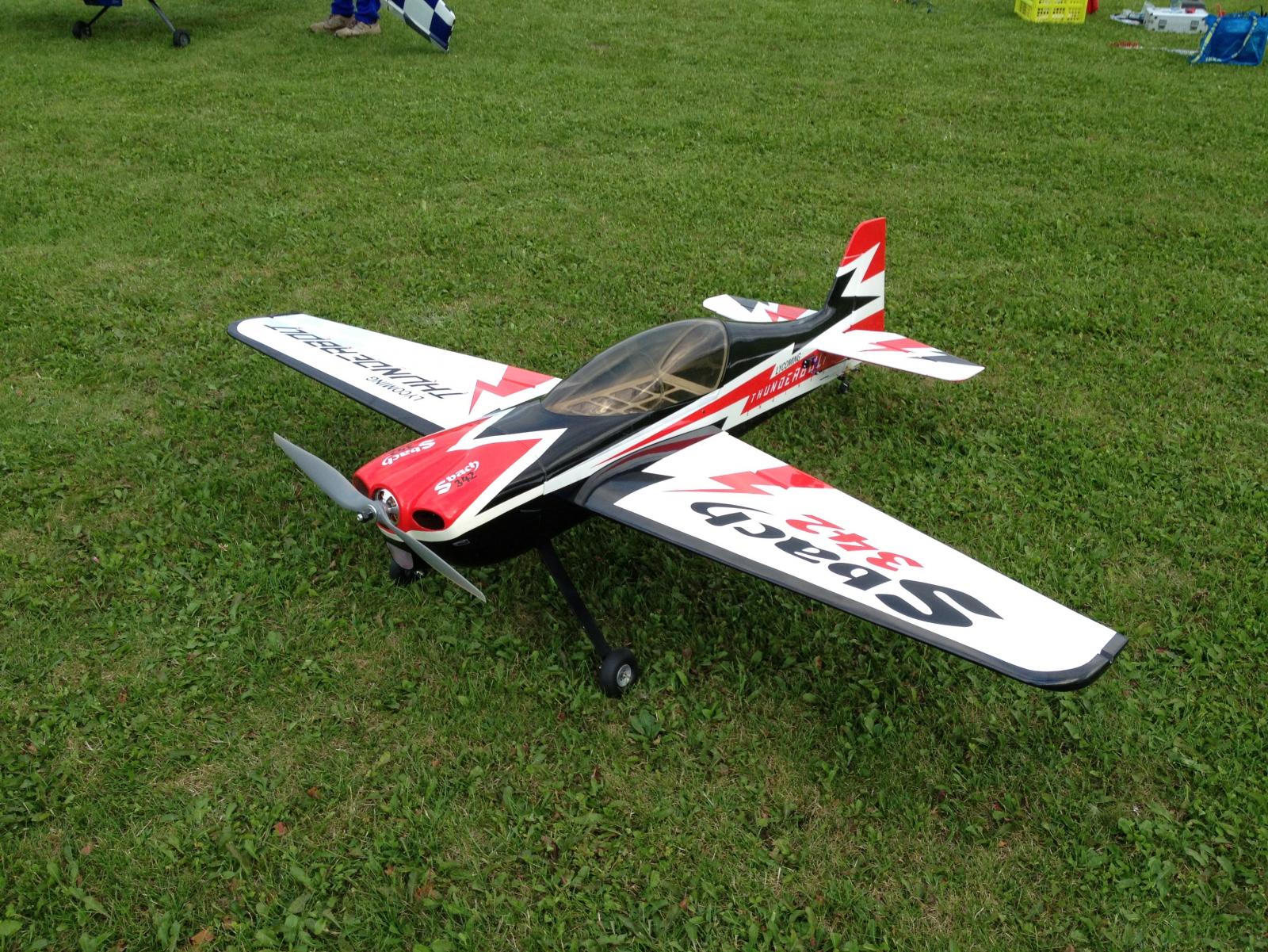

As another hobby of mine, I have some of these:
This one in particular is powered fully electrically, at full bore shes pulling 4kw (5.3bhp) continuously for 5minutes. Running at 100A+ from a 2x5cell packs. If the cells were wired as 12v output, it'd be putting out 300A. The packs only get mildly warm too. Packs cost less than £30.
We've been doing this stuff in RC for years! My setup is no where near the bleeding edge either, all done with regular cheap Chinese gear.
So yeah, nothing particularly high end or special about those starter packs. Being lipo wouldn't leave them anywhere that gets hot though... I.e. in the boot of a car.
