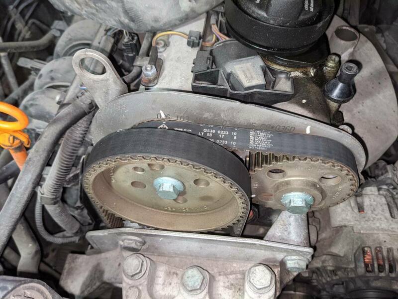

The next job to do will be the cambelt and water pump. SiC had a look and reckoned it has tippex marks on the cam pulleys so we reckon its been done at least once in the last 89k miles/15 years, but probabaly ought to be replaced again since we don't know if this was 14 years ago, or 14 months ago. A full gates kit of belt, water pump, tensioner, idler and things is just over £100 so not very expensive for the peace of mind it affords. Something for another day though.
I did ask at my local garage and it's only like a 3.5hr job iirc, so not a big job.
This is the top cam cover off.
Definitely seems a decent enough car to be worth doing it. Generally well looked after over its life. If I kept it, I'd have done it myself over the summer as looks a straightforward and easy job on these. Stretch bolts on the engine mount if you do it yourself, so don't forget to get new ones.

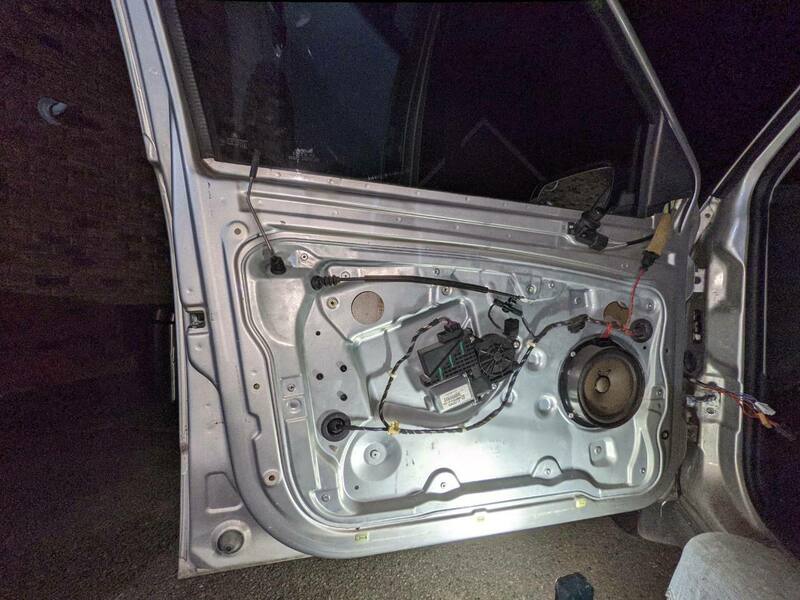

I had a crack at replacing the front passenger door lock module today and have been comprehensively thwarted.
There ought to be a grub screw holding the door handle to the door skin, it is vital that this is undone NO MORE THAN THIRTEEN FULL TURNS, allowing the rear portion of the door handle outer to pull out and give access to the cable that releases the door latch. On the Fabia, someone has been here before, and the grub screw is entirely absent - looking through the access hole there is just a threaded blind hole with no screw. Also, the rear portion seems stuck fast in the door and no amount of wiggling or levering it would get it to budge so I had no choice but to put it all back together and retreat inside.
Has anyone had this issue with a 6Y (1999 - 2007) Skoda Fabia Mk1 and what, if anything can be done? My thoughts are:
1. Drill out the plastic handle and replace the unit with a new one - total cost about £20, but probably moderate amount of faff. 3 spanners
2. Replace the entire door with a 2nd hand one. I'll need a mega shallow XZN bit to undo the door from the door hinges but otherwise looks a piece of cake. Total cost about £50. 1 spanner.
Or is there a trick to this that I don't see? All the guides mention the grub screw that must not be undone more than 13 full turns, but none say what happens on turn 14. It appears turn 14 makes the grub screw fall into an alternate dimension and the innards of the door to be inaccessible for ever more?

Btw I took the door card off expecting to replace the lock mechanism and then saw it was riveted in. After swearing and realising I didn't have any rivets, I put it all back together and then ordered some in the expectation of having to do the job again.
Before you drill out the rivets, double check they look to be the right size. Maybe drill one and compare before drilling out the others. I believe I got the right sized rivets from googling, but the forum I read it from may have been wrong!

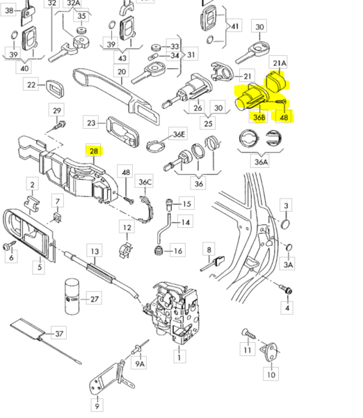

Ah right sorry - badly explained. The thing I'm having issues with is part 36b in this diagram
screw #48 is entirely absent, but I am unable to pull #36b horizontally out of the door for reasons I don't fully understand. Its very difficult to get purchase on it for starters! If you look at your A4 door handle, 90% of it is the handle bit (#20), that you pull on, then at the trailing end is a D-shaped end cap, I need that to be removed so that the clip on the end of the door pull cable can be popped off the grab bit of the handle (#20), if that makes sense?
On the drivers door, this is the bit you put the key in if you open the door like a peasant - on the other 3 doors this is just a blank lump of plastic that really only serves to keep the grab bit of the handle (#20) attached to the door and the cable attached. #36B attaches to #28 by means of the grub screw #48.
I'm going to pop off the outer cap (#21a) then drill a small pilot hole into #36b, put in a wood screw and get some mole grips on it to pull it horizontally out of the door like a savage.

Tbh I think I'd do similar and drill it out. Then either replace with second hand or be a savage and reaffix it all with tigerseal or something.
I remember having similar fun when trying to remove a seized lock barrel from a TT Mk2.
Is 36b wiggling/moving at all? I'm wondering if it's seized into place. Or god forbid someone has used superglue or locktite after being in there before.
I was able to get a 5mm Allen key into the hole that the grub screw ought to have been in, but didn't have the diagram to hand to understand what I was doing.
The whole assembly moves a bit when wiggled with a screwdriver, but it's possible that #36b is glued to #28, as without #48 there would be almost nothing keeping #36 attached to the actual door...
