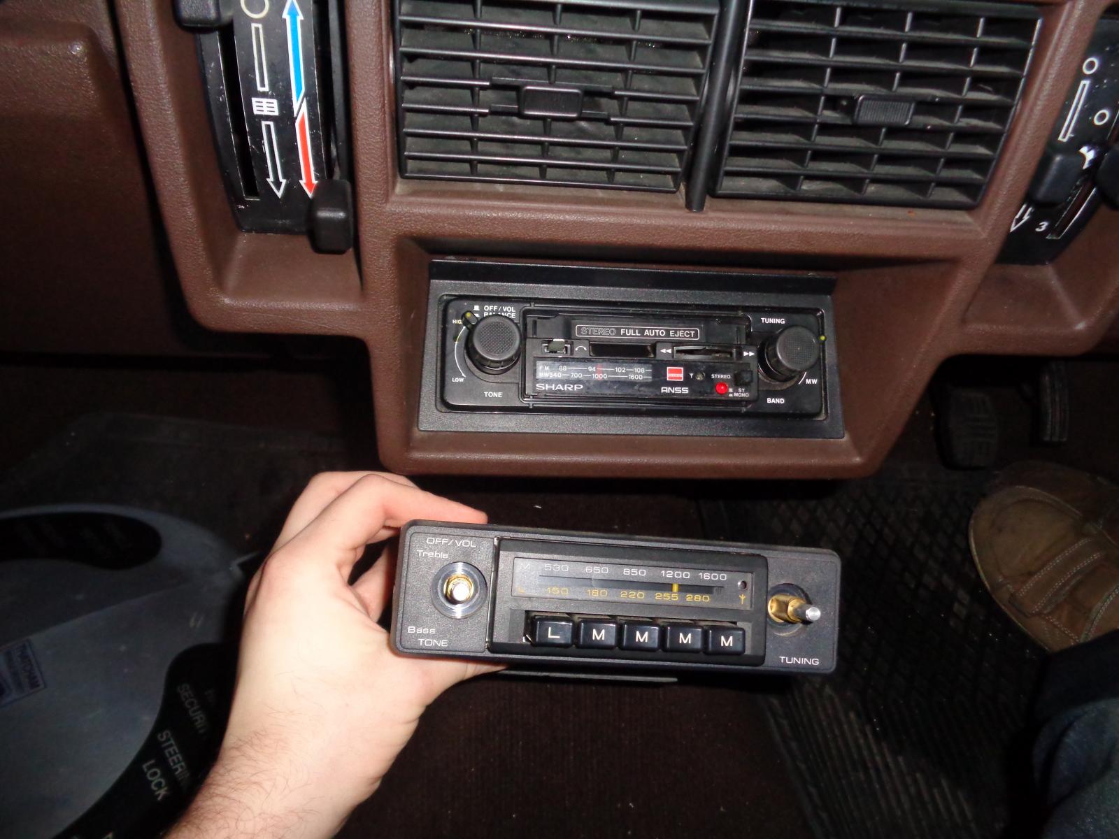

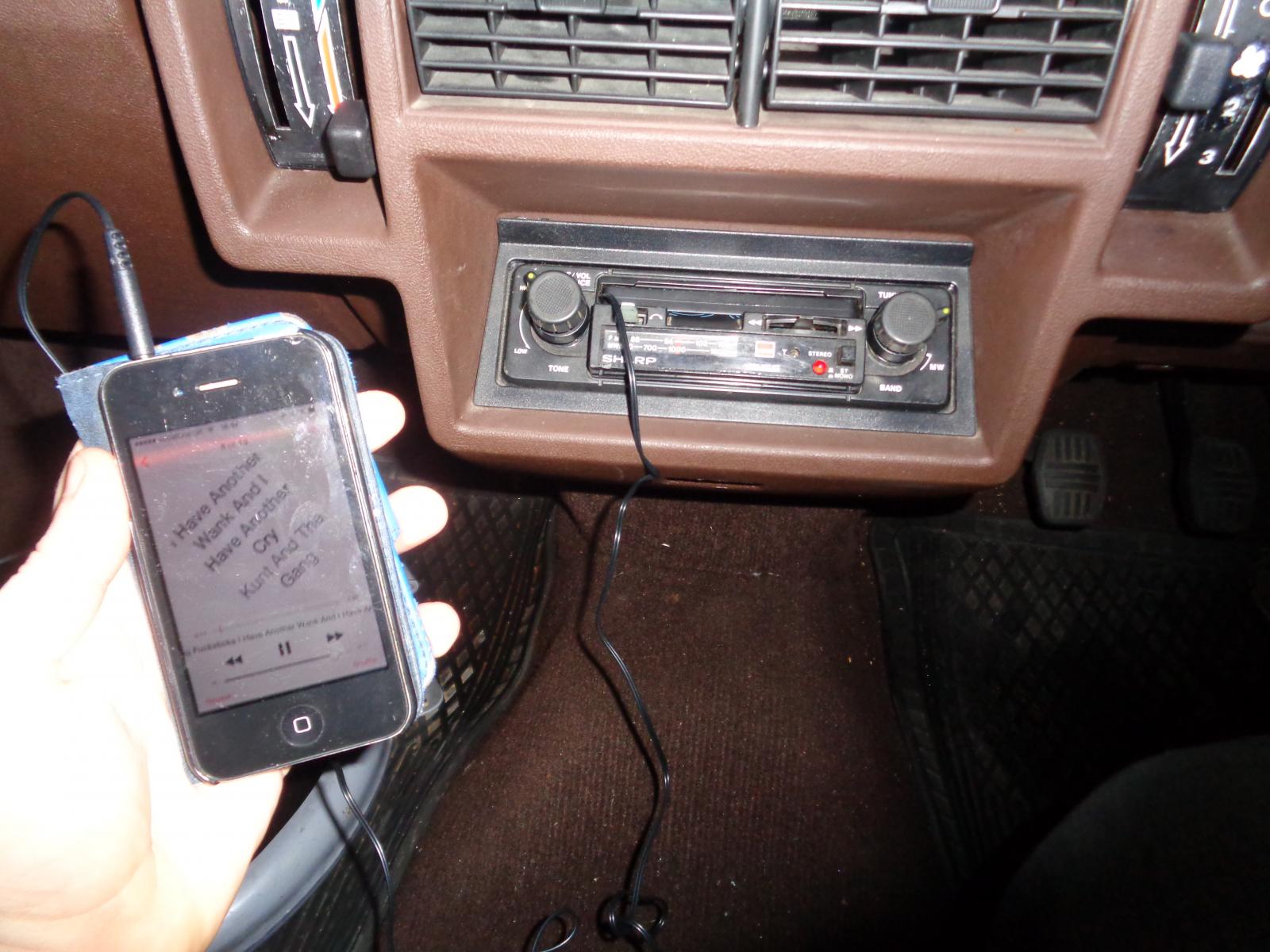

Angrydicky Posted November 24, 2015 Posted November 24, 2015 I've been meaning to do something about the radio in the Maestro for a while now. It had the original LW/MW push button one still fitted, which did work but when I replaced the ariel I simply cut the wire in the footwell and when I came to fit the new one found I couldn't get the new wire down the A pillar. So I was left with a radio that would have been fairly useless even if it was working, but all I got if I turned it on was static. So, I was at the boot sale a few weeks ago and I picked up a 1980s Sharp radio/cassette for £2 that looked like it would fit in the slot. It was a bit of a gamble, the bloke said "yeah it works fine mate" but that's what they all say! It was in a homemade wooden surround and apparently was fitted in a caravan. My reasoning behind fitting the radio cassette would be that I could then listen to my ipod via a cassette adapter, so even if I couldn't get the ariel connected without removing the dashboard I would still be able to listen to music on the move. Not fancying the job of fitting the radio, I farmed out the job to my local car spares shop, Chaucer Motor Factors of Canterbury who were pleased to see the Maestro again and equally pleased to see the radio I had lined up for it "we used to fit loads of these back in the day!"I wondered off for an hour while it was being fitted, bought a cassette adapter from Maplins and wandered back. It looked good, and fitted well in the slot. Connected up the adapter, ooh, music! Unfortunately it only lasted about four seconds before it ejected the tape. So I googled the problem, found a forum thread about how to use a cassette adapter with an auto-reverse stereo you have to take it apart and remove a small component. Which I did. And with this done, I had music for about 20 minutes before it ejected the tape. Now, it goes for anything between 4 seconds and 20 minutes before either ejecting the tape, or the music simply goes really quiet (so all you can hear is the noise of the adapter cogs whirring). Turning the radio off and back on again (then pushing the tape back in) fixes the problem for a bit. My question is, do any more knowledgeable shiters have any pointers for getting this radio to work reliably? Now I've paid to have it installed, I don't really want to rip it out again if I can help it! It was really dusty when I first got it, so I get the impression it hadn't been used in quite a while. scruff, HillmanImp, TagoraSX and 5 others 8

Pillock Posted November 24, 2015 Posted November 24, 2015 It'll have some sort of mechanism that detects when it's at the end of the tape, and ejects. This can be as simple as "I'm turning one spool, is the other one turning?" and if not, eject before the tape stretches. Some of these cassette adaptors have a band between the two spools so when you turn one, the other turns too and tricks the player into keeping going.
trigger Posted November 24, 2015 Posted November 24, 2015 I imagine it's just a case of being a bit shit like LP just said. Now it's been wired up a replacement should be a doddle to fit.
hauserplenty Posted November 25, 2015 Posted November 25, 2015 You'll have to remove it, I'm afraid, but I would check the condition of the belts and the motor. You might* be able to get away with cutting one of the motor wires, thus disabling any sort of end-of-tape detection.Or rendering the whole thing useless.You could also try simply removing the belt.Sometimes you can also remove a spring or lever somewhere which will disable the auto-reverse mechanism, which is what it sounds like is giving you trouble. Once it's stuck in Play mode with no way to cancel it you should be all right. Leave the cassette adaptor in while you do this, of course, since you won't want to undo all our hard work and then risk it not working ever again. I used to fix loads of these back in the day... * Last resort.
HH-R Posted November 25, 2015 Posted November 25, 2015 DUZ IT DO IPOD M8 Could be a dodgy adaptor? One of my autoreverse tape decks does this with real tapes but only some of them, they must be getting worn or something. The tape deck itself must be 20 years old saying that.

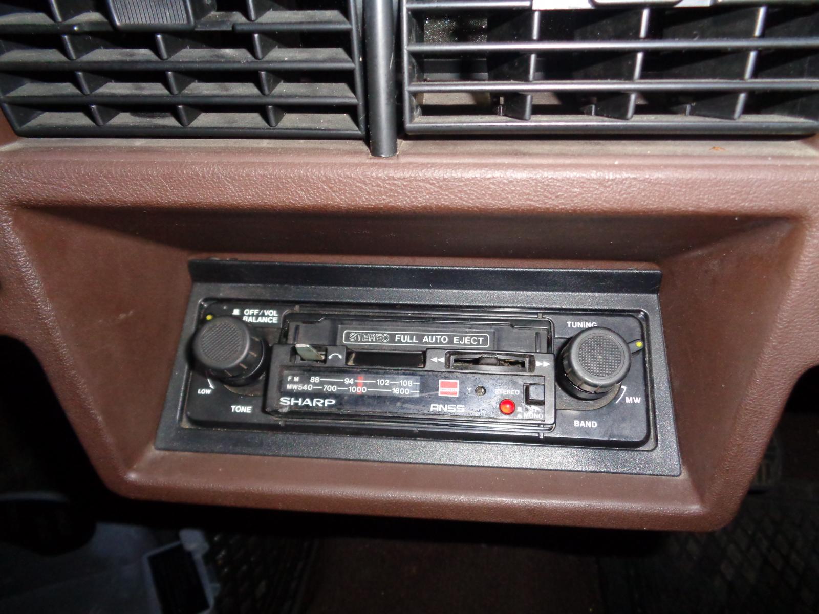

Angrydicky Posted November 25, 2015 Author Posted November 25, 2015 Oooh, interesting. I'll have to have a closer look at the dash as I didn't notice a removable panel. May have to come back to you on that one! Was it definitely on an early dash Maestro like this one, as opposed to a later one with a Montego dash? As for this cassette player, it seems to now work perfectly for about 20 minutes then start ejecting the tape every minute or so. Does anyone have a decent working period cassette player that will fit in the slot?
