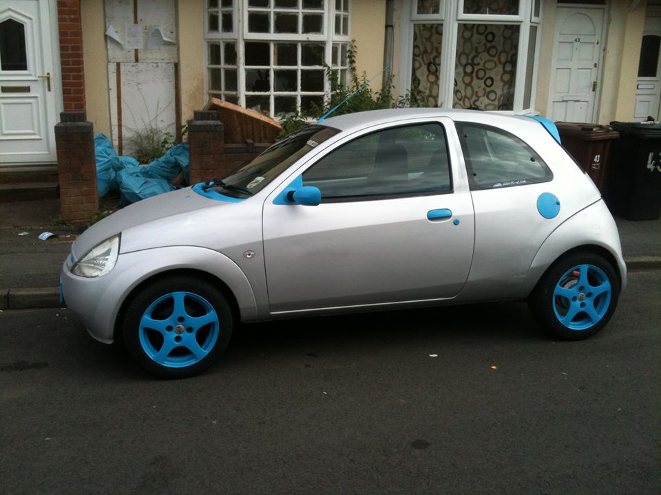

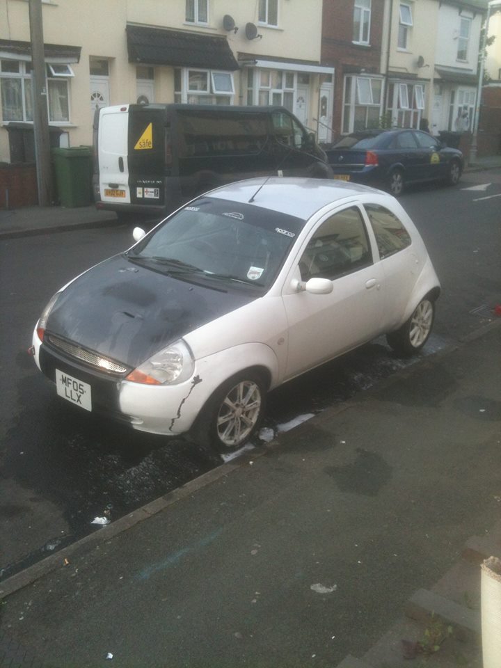

The limit of my bodywork experience was tidying up this abomination:
£60 worth of graffiti paint and 24 hours later:
I've already said I have no shame :-)
