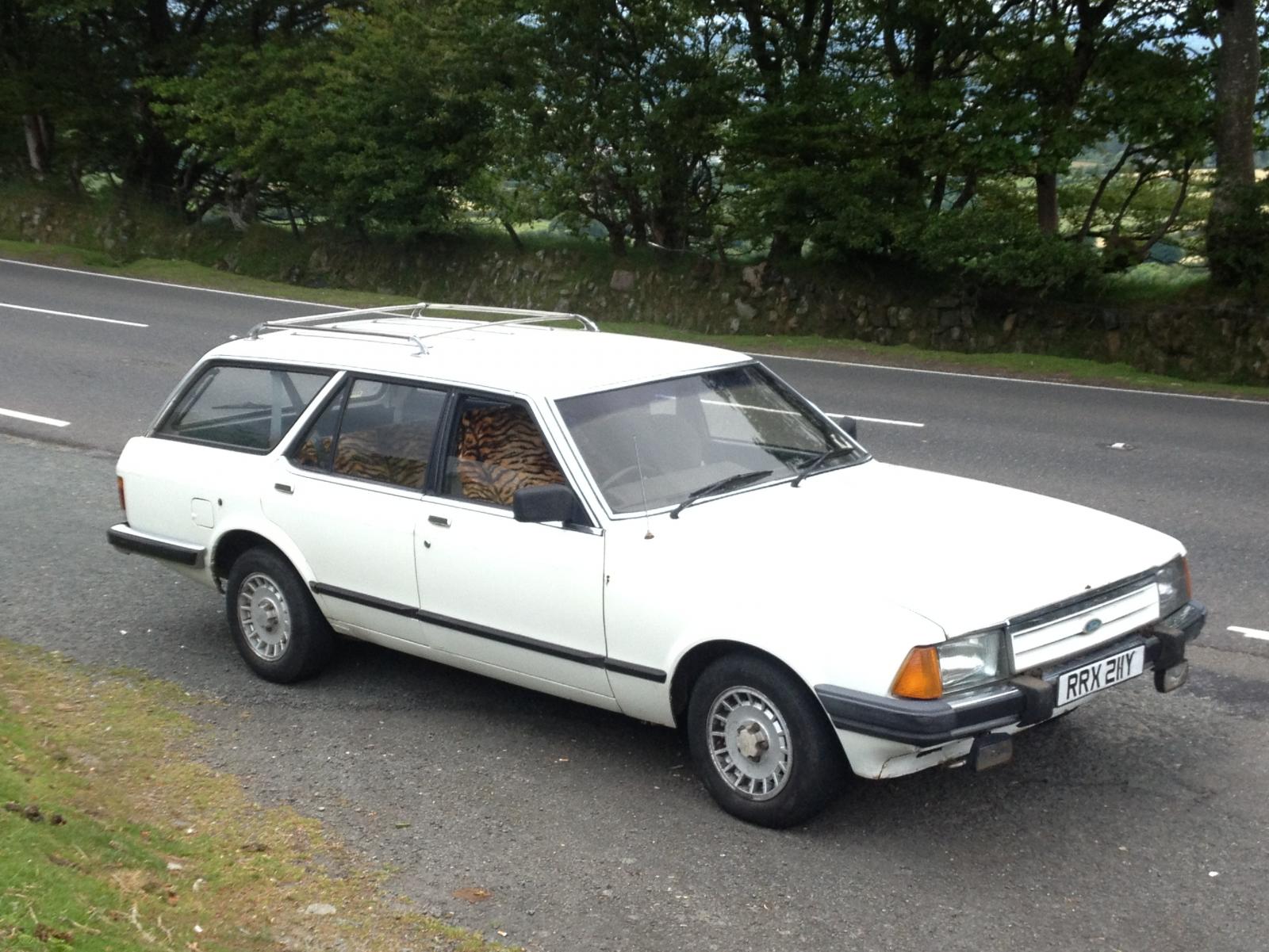

Been using this for getting about locally. It rides well over the local pock marked B-roads, although there's a klonk if your a bit careless coming on or off the throttle which wants investigating. Maybe a duff bush somewhere? combination of no PAS and the wider Ghia wheels means its harder work that it ought to be parking etc. Another example of how uncle Henry knew best in having no pas in combination with spindly steel wheels. Actually the spare looks to be the original style steel still. Handy for reference if I decide to ditch the present alloys and return it back to its povo roots.

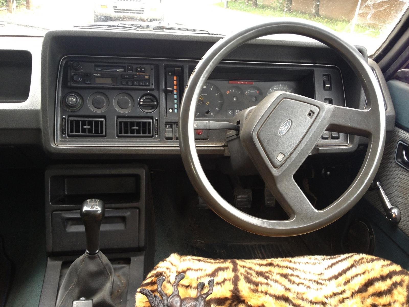

Speaking of wheels, here's the 2-spoker that needs all that non pas muscle......
Actually once your under way it's decently weighted. The stereo works, as does most things. The clocks ( no rev counter, just a massive, broken clock) have a dymo label bearing the reg- wonder if it was part of a company fleet at one point?
That looks superb! :-D
I think that the mark 2 Granada's styling lends itself well to a lack of excess adornment:

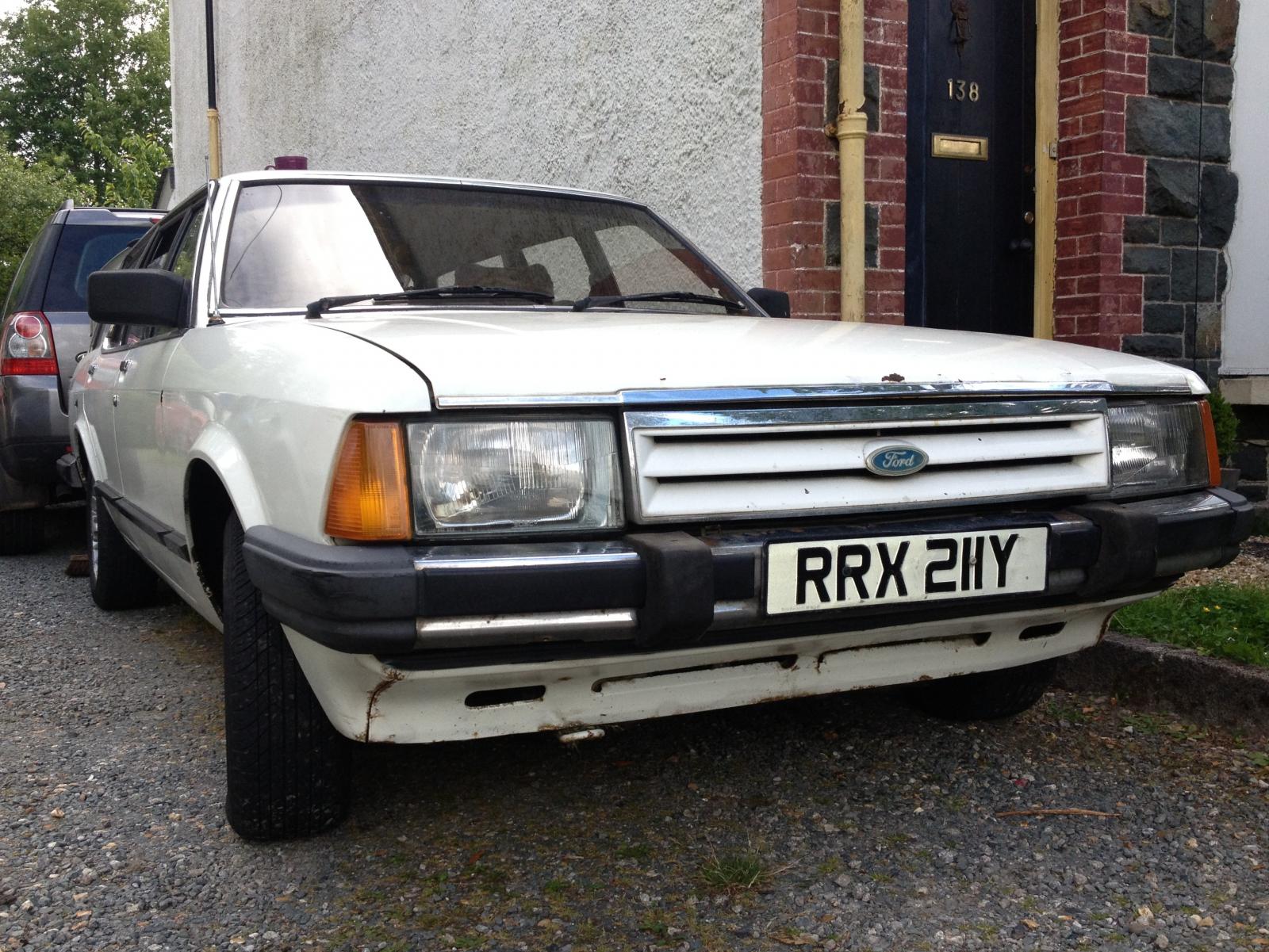

This afternoon I had a good look at the extra lighting on the front. It wasn't working and was in such a state I've binned it, I may yet need extra/ improved lighting but for now the front looks a lot cleaner.
Some leftover broken brackets for other (long since gone) lights were also on the bumper so whilst I was lying down there I whipped those off too......
I was also going to take off that Ghia chrome on the leading edge of the bonnet. That will have to wait untill later in the year as its been lobbed on to hide some rot in the bonnet edge.
The car was pulling to one side slightly on braking, but a bit of use has sorted this and it pulls up nice and straight now. One other issue is a "hunting" idle especially when warm. Any idea what that could be?

Indeed! Can't remember ever seeing that type steering wheel in a Granada before.
Interesting to compare the base spec interior and dash to the top spec ones.
Here's mine.
All those gauges and buttons blanked off, no wood (or plastic wood either!) different wheel...

If you don't want that chrome strip off the bonnet I'll happily forward you some beer tokens for it! Mines missing and I can't find one!
One thing worth checking on these if you get suspension/bush type knocks and clunks is the front track control arm where it mounts into the subframe right at the very front of the car. (Other end connects to the little link bar with rubber bushes which also fail!) the big bush at the front is made from a foam wierd stuff if they are OE and it's shit! Mine ripped out and the TCA was able to move forward and back through the sub frame mounting, causing some noises and interesting handling! If yours are the foam type (appears like an orangey yellow colour) then swap them for poly bushes, it's easy to do. Just don't alter the big nut on the inner side of the TCA as it will knock the wheels castor out of setting.
That steering wheel! I had forgotten these were briefly fitted to the poverty spec MK2 Granada around 1982/83
An 80's favorite trick for Ford.
One plastic wheel for Vans, Pop (or base) and L, another for the GL, a leather one for the Gee Har and a chunky one for the sporty version.
I wonder how much it cost to tool up and produce a design of wheel which probably only appeared on a few hundred cars?
From memory that steering wheel was used on the base Granada only. They had a misery satin black grille as well.

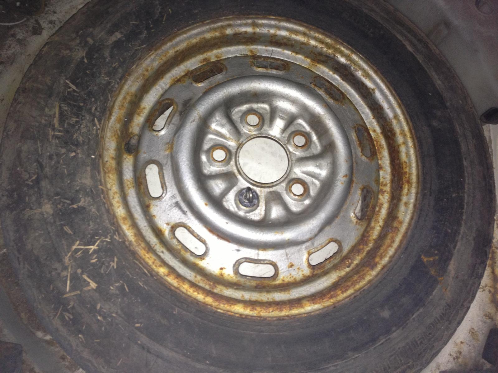

Im trying to figure out what wheels it would have had originally. Can someone ID the spare ? (5.5j/ 14in) I assumed it was the original but looking at pics made me think it might be a cortina mk5 steel wheel..........
Not a Cortina wheel because that has five bolt holes. That doesn't look right though, perhaps a Transit wheel?
The wheels it would have had originally are the same as the gold estate picture Shep Shepherd put up earlier in the thread, but without the centre cap.

Wheel looks like a MK1 Granny/Consul wheel, would have had a big chrome hubcap. Again, low-spec model stuff.

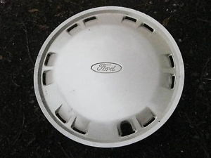

I remember other models coming with hub caps on these wheels which was something that the earlier MkIIs didn't come with, so it was a nice reversion of specs there by Ford in the 80's to let everyone truly know their place.
Yep, outlaw is correct. That style of wheel was also fitted to very early mk2 base and L versions IIRC with chrome rim embellishers and the small metal centre caps as seen on the Ford 'dartboard' sport steelies.
Post facelift base models looked like this however,
So these are what should be on this car. Small centre cap on the L and the GL had a larger stainless steel cap. Edit, beaten to it by Jon!

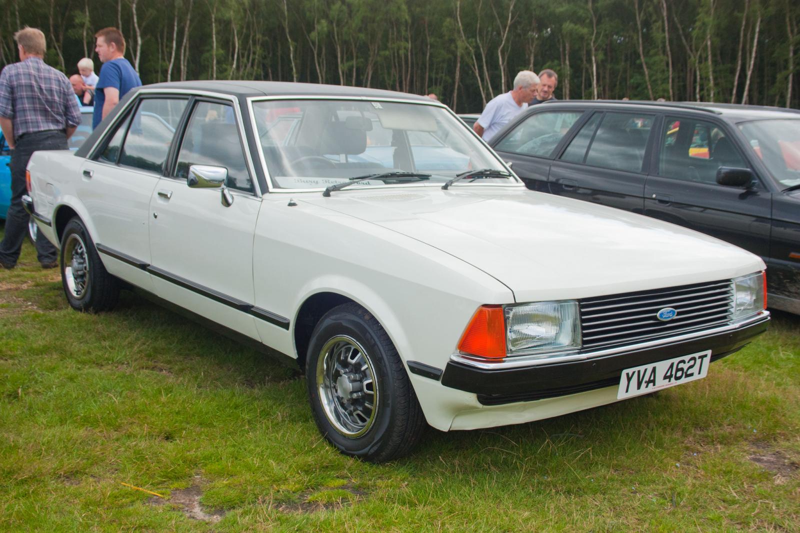

I like the pre-facelift too, especially in this shade:
