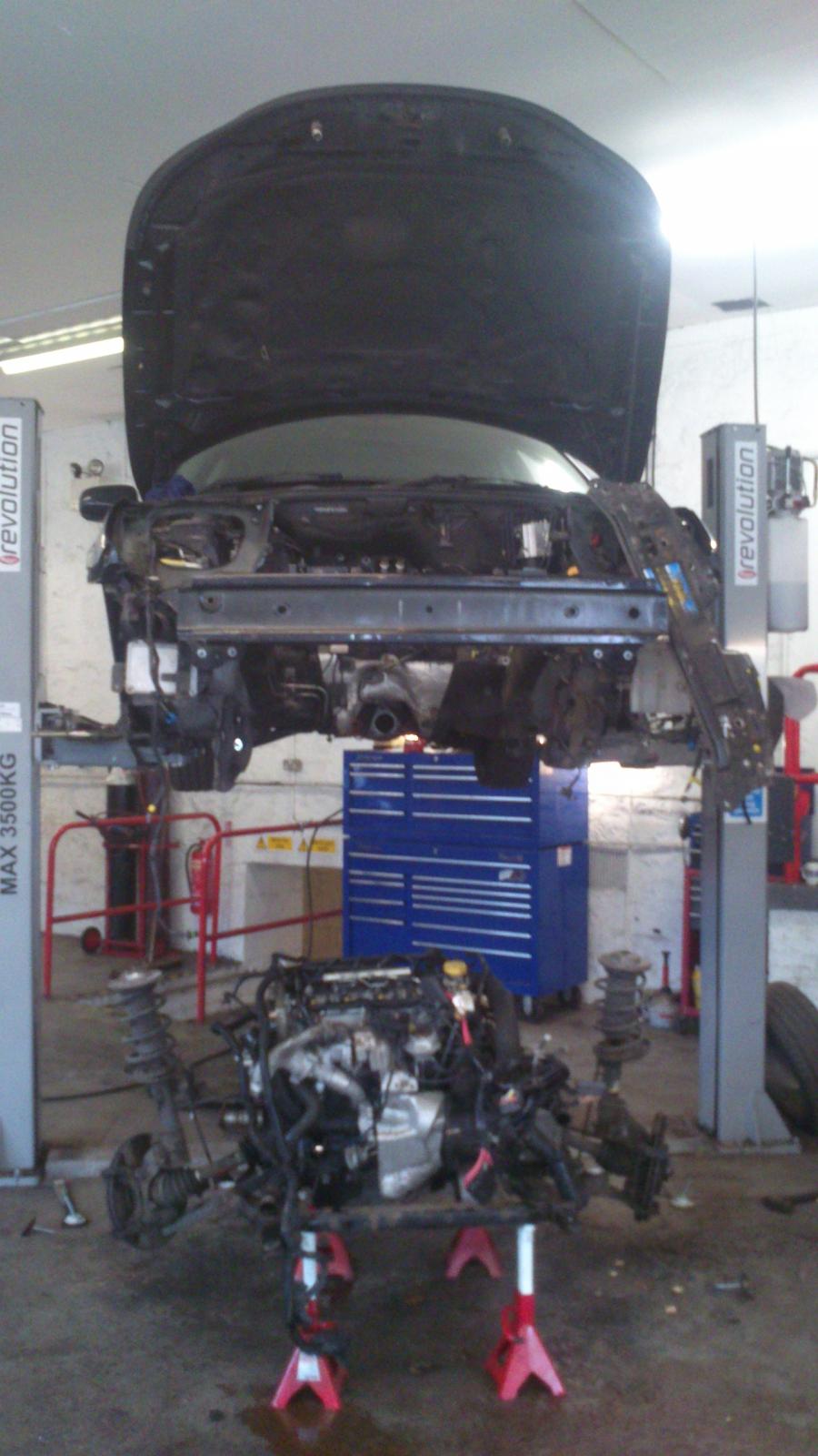

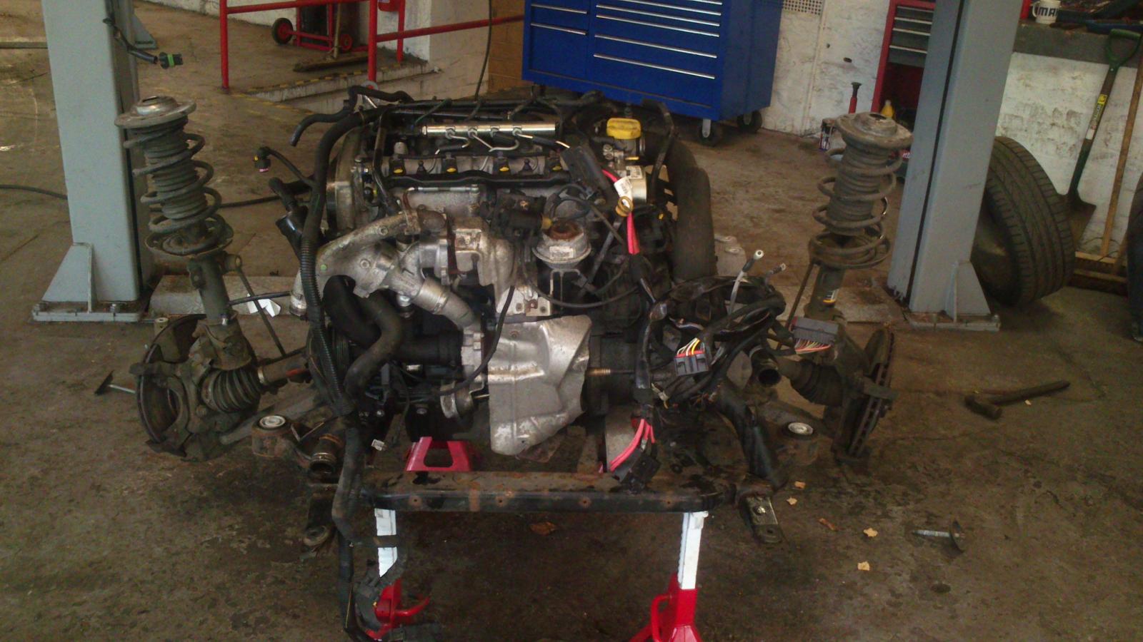

A 2008 Saab 9-3 TTiD got dragged in to work last week -customer said it had gone "BANG" and lost all power. I dragged it over to the ramp for a look see. Timing belt in place and tight. No oil trails. Hmmm. Engine locked up solid though. As this is the 180 BHP Daddy with the twin turbos it's a little tight for room. After losing a couple of digits and half a pint of blood, the reason became clear after I removed the air con compressor. The con-rod had made a break for freedom and had smashed a tidy little orifice in both the front and rear of the block. After a little research,a chat to the owner ,it was agreed to fit a BRAND NEW engine, supplied from Neo Bros for a very reasonable sum. £1500 notes for a new lump, including fuel pump,injectors,glowplugs and belts all fitted. They also do a complete ready to drop in unit,with both turbos,manifolds,wiring loom and DMF/clutch for just over £2800.
The engine was dropped out complete with rack/subframe/struts etc, and the stripdown and changeover began- the fuel pump has to be removed to fit the inlet manifold...which was found to be missing a couple of swirl flaps..and the DMF was ^&*(ed.  Inlet manifold £220 complete new, with flap motor,and DMF near on £200 notes. Both turbos seem OK with no sign of damage.

Probably more as you'd no doubt replace the cam belt and water pump, and possibly injectors and pump etc. The last JTD/CDTI thing I did with a broken belt only snapped the rockers so interested to have a look inside this one to see what's gone on, don't think a swirl flap could have broken a con rod/big end. I actually rate these engines but this is the first I've done with the two turbos.
The inlet and exhaust manifolds on these must be interesting to support the turbos.
I can see how it works on a v engine but it must be much more complex on an inline job?
