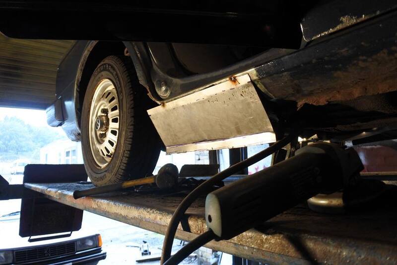

Went to visit @DodgyBastard and weld the Acclaim's sill...
It's not exactly factory fresh but it'll do the job, Acclaim sills live mostly under the car out of sight anyway... Naturally everything escalated and much rebuilding of inner panels and bits of the floor was required. I started with grand aspirations of making it look nice but as night drew in priorities were shifted more towards the "get it out of here before midnight" direction.
I can't claim much credit as FOADyBastard did the lion's share of the welding, and I ran him out of gas...

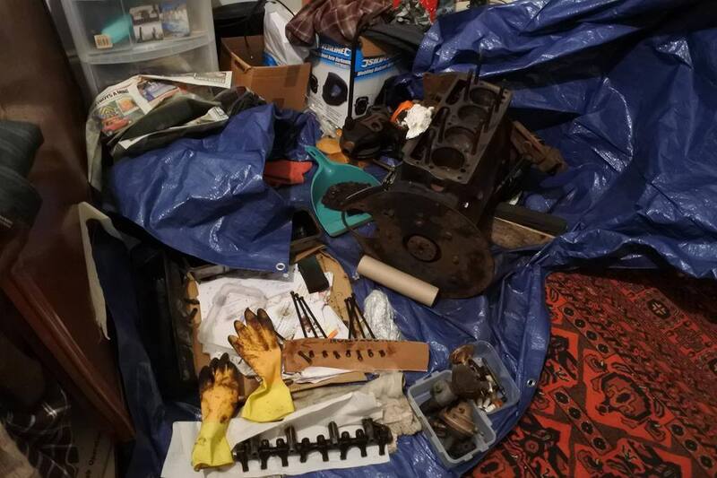

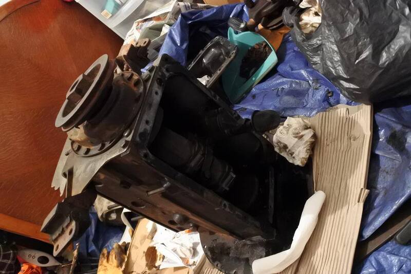

I took the sump off engine no.1 and pulled a piston. Nothing looks horrendously fucky.
People who've pulled an engine apart before feel free to comment and let me know otherwise. Regardless, I've run out of money big time, so if it'll run it'll be going in the car largely as is...
The bores look pretty good, a few very light vertical scores possibly caused by the ring gap, but still plenty of what appears to be honing marks. Inspect the piston rings for signs that they might go bad - sharp edges and cracks - and try and see if there is any slop in the small end. The bottom end bearings look useable as well for a good few miles yet, so I'd whack that bottom end back together, but make sure the bearing faces around the crank have some viscous lubricant on them, I know you have no money but a smoll bottle of engine assembly lube can be had for about a fiver and will prevent those shells getting knackered quickly - a nearby shiter may have some you can borrow or a spare workbench to do some of these jobs on.
Top end, personally I'd use the head that came with this disassembled engine; besides being original to it and matching the block etc for any wear points, I don't think the coolant passages in it are anything to worry about. Lap valves in and keep the double springs as from what I can gather these Triumph OHV engines in twin carb form can suffer from valve bounce, it's a bit belt & braces for a single carb but again it's keeping the head as it was intended to be.
